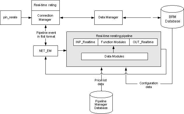

About the Real-Time Rerating Pipeline
The pin_rerate utility sends events previously rated by the batch rating pipeline to a real-time rerating pipeline to be rerated.
The pin_rerate utility routes the pipeline-rated events to the Connection Manager (CM). The CM sends the pipeline-rated events in the form of an flist to the NET_EM pipeline module. The NET_EM module transfers the event to the real-time rerating pipeline for rerating.
The real-time rating opcodes add to the flist all the enrichment data needed by the real-time rerating pipeline to rate the event. For example, if the real-time rating opcodes determine that a discount should be applied, it adds the discount information to the flist.
Real-time rerating process does not check credit limits when applying discounts. To configure rerating to check credit limits, create a custom iScript that sets the DETAIL.CREDIT_LIMIT_CHECK EDR field to 1.
Similar to a batch rerating pipeline, a real-time rerating pipeline performs both rating and discounting functions.
To rerate events, the real-time rerating pipeline gets the new pricing information from the Pipeline Manager database. Certain configuration data, such as currency and noncurrency balance element information, are obtained from the BRM database.
The real-time rerating pipeline performs the following tasks:
The INP_Realtime input module converts the flist received from the NET_EM module to event data record (EDR) format and creates an EDR container.
You can also create and run an iScript to manipulate data in the EDR container before it is sent to the pipeline modules.
The pipeline function modules calculate the new balance impacts by using the new pricing and discounting information and then adds the balance impacts to the EDR container.
The OUT_Realtime module converts the EDR back into flist format and sends the flist to NET_EM.
NET_EM sends the flist with the new balance impacts back to the CM.
BRM updates the account's balances and records the event in the BRM database.
Figure 6-1 shows the data flow for rerating events by using the real-time rerating pipeline.
Figure 6-1 Real-Time Rerating Pipeline Data Flow

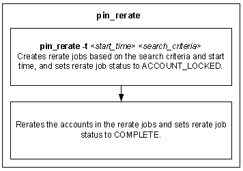

About Rerating Events When You Do Not Use Pipeline Batch Rating
If you do not use Pipeline Manager for batch rating, you can use pin_rerate to rerate only real-time-rated events.
Real-time-rated events are events that are rated by the BRM rating opcodes. Real-time-rated events include events that are loaded in batches by Universal Event (UE) Loader.
To rerate only real-time-rated events, you must configure the BatchRatingPipeline business parameter so that pin_rerate does not attempt to communicate with a batch pipeline, which will cause rerating to fail.
When rerating only real-time-rated events, the following actions are taken when you run pin_rerate:
The pin_rerate utility selects the accounts to be rerated from the BRM database based on the specified search criteria and creates rerate jobs.
Rerate jobs can also be created automatically through BRM automatic rerating or trigger-dependent rerating.
pin_rerate invokes rerating of the selected accounts in the rerate jobs.
BRM extracts the events associated with the selected accounts from the BRM database and does the following:
Rerates the real-time-rated events.
Records the new balance impacts of the rerated events in the BRM database.
After the successful completion of each step, pin_rerate updates the rerate job status so that the next step in the rerate workflow can be run.
Rerate jobs that are processed when rerating only real-time-rated events can have the statuses shown in Table 6-2.
Table 6-2 Status for Real-Time Rerate Events
| Status | Description |
ACCOUNT_LOCKED |
The initial status of rerate jobs. |
COMPLETE |
The status when rerating has completed for all the accounts in the rerate job. |
Procedure for Rerating Only Real-Time-Rated Events
To rerate only real-time-rated events when you do not use Pipeline Manager for batch rating, you select the accounts to rerate and rerate the selected accounts using a single pin_rerate command.
Figure 6-3 shows the rerating command, process flow, and job status transitions when rerating only real-time-rated events.
