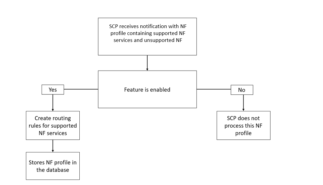

3.1 NFProfile Processing Enhancements
In the previous releases, SCP did not support custom NF services. When SCP receives a notification from NRF about an NF profile that has 3GPP-defined supported NF services along with custom, unknown, or unsupported NF services, it will reject the whole NF profile. Therefore, routing rules were not generated for 3GPP-defined supported NF services when a custom, unknown, or unsupported NF service was present in the NF profile.
With this enhancement, whenever SCP receives a notification regarding an NF profile that includes 3GPP-defined supported NF services, custom, unknown, or unsupported NF services, SCP ignores the presence of custom, unknown, or unsupported NF services within the NF profile. Routing rules are generated by SCP for 3GPP-defined SCP supported NF services that are present in the NF profile. Consequently, SCP enhanced the process of handling NF profiles by streamlining the routing process and ensuring efficient and reliable communication between NFs.
Figure 3-1 Call Flow of NFProfile Processing
  1. SCP receives a notification with an NF profile including 3GPP-defined supported NF services, custom, unknown, or unsupported NF services.
  2. If the feature is enabled, then SCP creates routing rules for the 3GPP-defined supported NF services and ignores the custom, unknown, or unsupported NF services present in the NF profile.
  3. SCP stores the NF profile in the database.
  4. If the feature is disabled, then SCP does not process that NF profile and no routing rules will be created for that NF profile.
    This call flow ensures that SCP appropriately handles notifications and routing rules procedures with supported NF services while disregarding unsupported services.

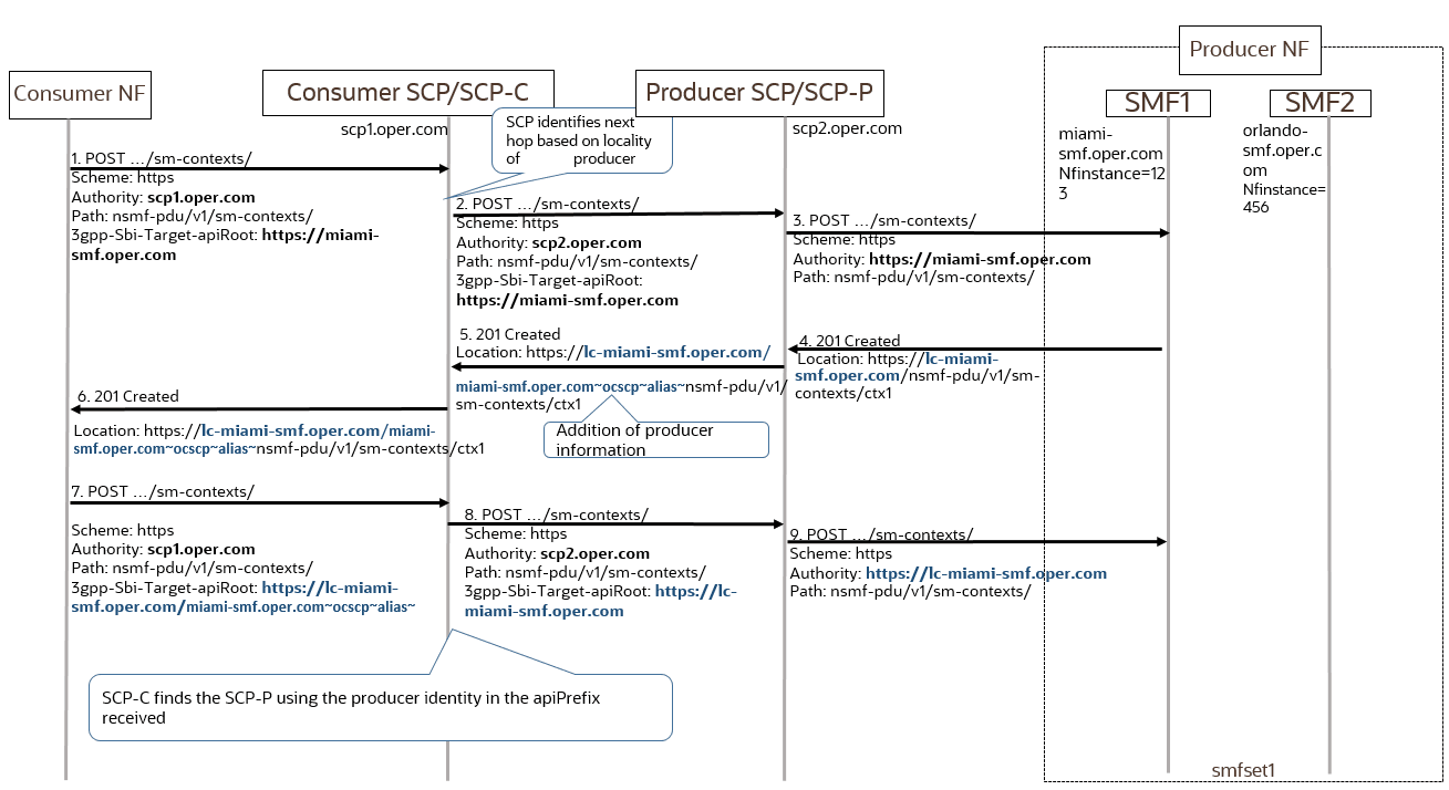

3.12 Location Header for Host Mismatch
According to 3GPP, a consumer NF is expected to use the received "Location" header content while sending subsequent message requests. After receiving a subsequent request, consumer SCP extracts the producer NF details from the API prefix in the "3gpp-Sbi-Target-Apiroot" header and selects an appropriate inter-SCP path to route the request.
SCP matches the authority (FQDN or IP) in "Location" header of the "201 Created" response with the producer's authority (FQDN or IP) where the message request was sent. If the FQDN or IP in the response is different, producer SCP provides the producer's NF details as an API prefix in the "Location" header of the "201 Created" response. If the FQDN or IP is the same, the "Location" header does not perform any modification.
This feature has been introduced to correct inter-SCP routing in the above scenario.
Figure 3-2 Initial and Subsequent Request Routing Supported at SCP
Managing Location Header for Host Mismatch

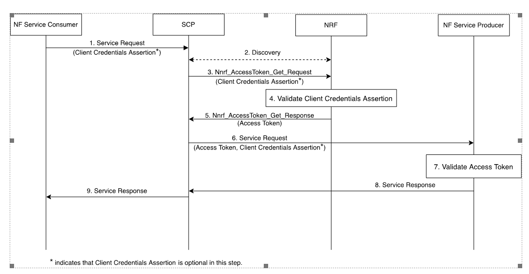

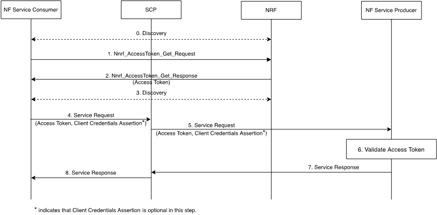

3.13 Support for the Client Credentials Assertion Header
The 3GPP introduced Client Credentials Assertion (CCA) enables the NRF or the producer NF to authenticate the consumer NF when using indirect communication through SCP. The CCAs are JSON web tokens and are secured with digital signatures based on JSON Web Signature (JWS). The consumer NF adds the 3gpp-Sbi-Client-Credentials header containing the CCA. The CCA contains the following:
  • The NF instance ID of the consumer NF (subject)
  • A timestamp (iat) and an expiration time (exp)
  • The NF type of the expected audience, such as the NRF type or the NF type of the producer NF
The consumer NF digitally signs the generated CCA based on its private key. The signed CCA contains one of the following fields:
  • The X.509 URL (x5u) to refer to a resource for the X.509 public key certificate or certificate chain used for signing the client authentication assertion
  • The X.509 Certificate Chain (x5c) includes the X.509 public key certificate or certificate chain used for signing the client authentication assertion
Table 3-4 CCA Contents
Claim Description
audience (aud) NF type of the producer NF whose services are requested and/or NRF
expiration time (exp) Timestamp of CCA expirarion
subject (sub) NF instance ID of consumer NF
timestamp (iat) Timestamp of CCA generation
Security details used for signing CCA
  • x5u - X.509 URL that refers to a resource for the X.509 public key certificate or certificate chain
  • x5c - X.509 Certificate Chain includes the X.509 public key certificate or certificate chain
The NRF, or producer NF, performs the CCA verification. It verifies that the public key certificate used to sign the CCA contains the same NF instance ID as the consumer's NF instance ID in the CCA. If the verification of the CCA fails at the receiving entity, a "403" response is returned with the cause attribute set to CCA_VERIFICATION_FAILURE.
If some rouge consumer NF acquires a valid CCA from some other consumer NF and uses it as its own CCA, then the CCA validation by the NRF or producer NF creates a security gap. Therefore, additional CCA validations on SCP are needed to mitigate this security impact. The NF instance ID of the NFs in the CCA must match the NF instance ID in the certificate used in the TLS connection by the consumer NF as part of the SCP validations.

In the 5G SBI Model D indirect communication (with delegated discovery) mode, SCP obtains access tokens from NRF for 5G SBI message requests except notification or callback messages. SCP uses the acquired access tokens to forward SBI message requests to the selected producer NFs.
The following call flow represents how SCP obtains access tokens from NRF:
Figure 3-3 SCP Obtains Access Tokens from NRF
The above mentioned call flow describes the process to use the Discovery parameter to send a request to NRF for obtaining the access token:
  1. NF Service Consumer sends a service request to SCP.
  2. If SCP does not get an access token in the service request, it uses the Discovery parameter to send the access token request to NRF.
  3. SCP sends Nnrf_AccessToken_Get_Request to NRF.
  4. NRF validates the access token request using Client Credential Assertion (CCA).
  5. NRF sends Nnrf_AccessToken_Get_Response to SCP.
  6. SCP forwards the service request, along with CCA and access token, to NF Service Producer.
  7. NF Service Producer validates the access token.
  8. NF Service Producer sends the service response to SCP.
  9. SCP relays the service response to NF Service Consumer.
In the 5G SBI Model C indirect communication (without delegated discovery) mode, consumer NFs obtain access tokens from NRF except notification or callback messages. SCP uses the access tokens received from consumer NFs and forward SBI message requests to the selected producer NFs.
The following call flow represents how NF Service Consumer obtains access tokens from NRF:
Figure 3-4 NF Consumer Obtains Access Tokens from NRF
The above mentioned call flow describes the process that NF Service Consumer uses to obtain access token from NRF and how SCP uses this access token to forward the service request.
  1. When there is no mutual authentication between NF Service Consumer and NRF, NF Service Consumer sends Nnrf_AccessToken_Get_Request to NRF.
  2. NRF sends Nnrf_AccessToken_Get_Response to NF Service Consumer.
  3. NF Service Consumer sends Discovery service requests to NRF.
  4. After receiving the discovery response with NF profiles, NF Service Consumer sends the service request to SCP.
  5. SCP uses the access token received from NF Service Consumer and forwards the service request, along with CCA and access token, to NF Service Producer.
  6. NF Service Producer validates the access token.
  7. NF Service Producer sends the service response to SCP.
  8. SCP relays the service response to NF Service Consumer.

3.25.1 5G SBI Notification Requests processing
The ApiPrefix usage in notification messages at SCP are as follows:
Table 3-12 5G SBI Notification Requests Processing
Notification Message Received at SCP Forwarded Notification Message to NextHop SCP (SCP-P) Forwarded Notification Message to Target NF Description
3gpp-sbi-target-apiRoot Header :authority header :path header 3gpp-sbi-target-apiRoot Header :authority header :path header Routing Attempt :authority header :path header
scheme://NF-C1.com:port/NF-C1ApiPrefix scp.com:port scpApiPrefix/notificationUri scheme://NF-C1.com:port/NF-C1ApiPrefix nextHopScp.com:port {nextHopscpApiPrefix}/notificationUri
  • If next hop SCP has published ApiPrefix in SCP Profile.
Primary routing
NF-C1ApiPrefix/notificationUri
While registering with NRF, the notification handling service published apiPrefix in NFProfile.
Alternate routing
scheme://NF-C2.com:port
{NF-C2ApiPrefix}/notificationUri
NF-C2ApiPrefix is used as per deployment and the apiPrefix value in the NFProfile for the service.
scheme://NF-C1.com:port/ scp.com:port scpApiPrefix/notificationUri scheme://NF-C1.com:port/ nextHopScp.com:port {nextHopscpApiPrefix}/notificationUri
Primary routing
/notificationUri NF-C2ApiPrefix is used as per deployment and the apiPrefix value in the NFProfile for the service.
Alternate routing
{NF-C2ApiPrefix}/notificationUri NF-C2ApiPrefix is used as per deployment and the apiPrefix value in the NFProfile for the service.
scheme://NF-C1.com:port/NF-C1ApiPrefix scp.com:port /notificationUri scheme://NF-C1.com:port/ nextHopScp.com:port {nextHopscpApiPrefix}/notificationUri
Primary routing
NF-C1ApiPrefix/notificationUri SCP is deployed without apiPrefix in SCP profile.
Alternate routing
scheme://NF-C1.com:port/ scp.com:port /notificationUri scheme://NF-C1.com:port/ nextHopScp.com:port {nextHopscpApiPrefix}/notificationUri
Primary routing
/notificationUri
SCP and the notification handling service are deployed without an apiPrefix in the NFProfile.
Alternate routing
Delegated Discovery notification request scp.com:port {scpApiPrefix}/
scp-default-sub-notify-uri
  • Selected target notification URI
Primary routing scheme://NF-C1.com:port {NF-C1ApiPrefix}/notificationUri Notification URI is used according to the published NFProfile based on discovery responses.
Alternate routing scheme://NF-C2.com:port {NF-C2ApiPrefix}/notificationUri Notification URI is used according to the published NFProfile based on discovery responses.
Delegated Discovery notification request scp.com:port /scp-default-sub-notify-uri scheme://NF-C1.com:port/

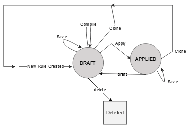

Figure 3-5 Rule Status Flow
Rule Status Flow
The following table lists the state of rules and its description
Table 3-14 Types of State
State Description
Clone To create a new rule, the values of the rule already created and stored in the database are used. This newly created rule has a name followed by a term draft. A new name must be provided as a rule.
Compile This state precompiles, takes the rule source, and builds an executable rule base.
Draft This state moves a rule from APPLIED status to DRAFT status.
Apply This state moves a rule from DRAFT status to APPLY status.
Save This state saves the changes in database.
The table lists the modifications allowed to be configured in rule status:
Table 3-15 Rule Status
Field Name DRAFT status Applied status
Rule Name Not Allowed Not Allowed
Format Not Allowed Not Allowed
Status Not Allowed Not Allowed
Mediation Mode Allowed Allowed
Code Allowed Not Allowed
State Allowed Allowed
The Rule Name must be unique. The status of a rule can be DRAFT or APPLIED. Only DRAFT status can be deleted, edited, or viewed.

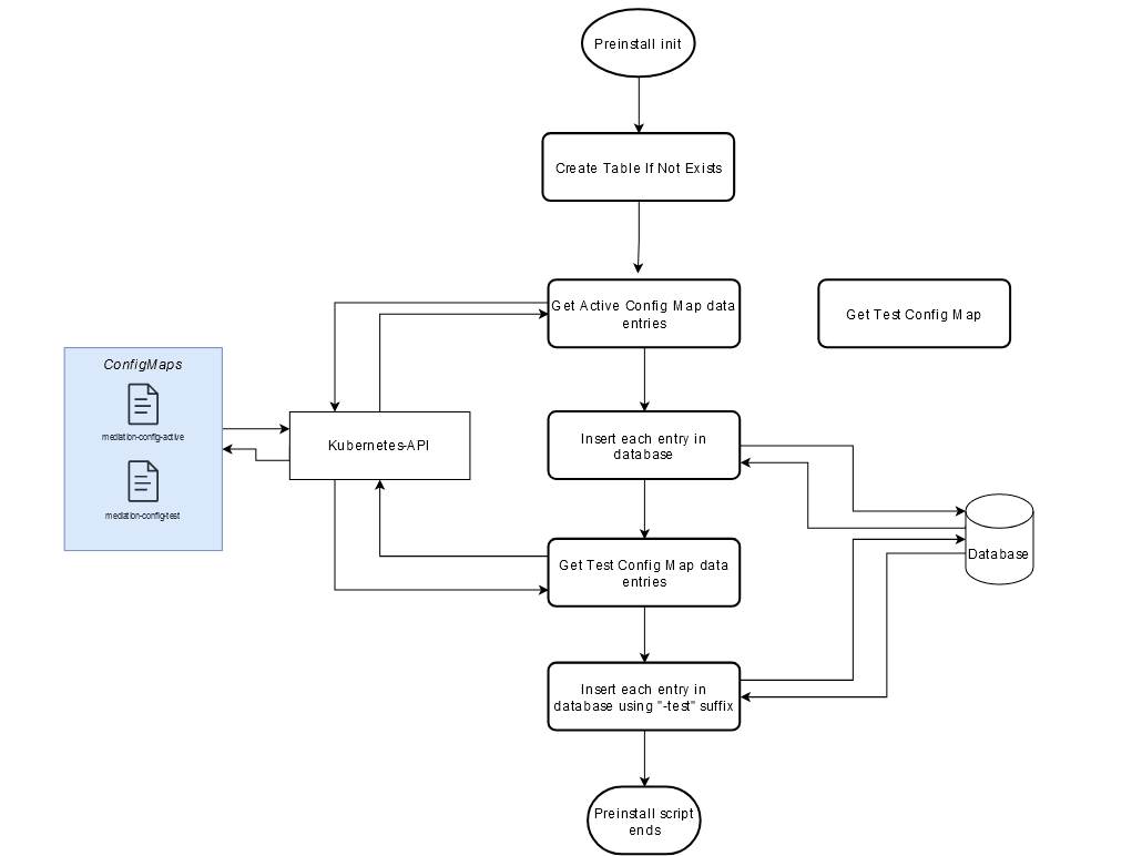

3.26.2.1 Mediation Rule Migration Process
Previously, rules were used from the Kubernetes config map. Currently, the rules present in the config map are migrated to the database table (mediation_rule table).
This section describes the procedure to execute the migration of rules from the existing config-map based implementation into the new REST API.
The following are the config-map related to mediation:
  • ocscp-nf-mediation-config-boot: It contains all the configuration related to the spring boot application and is used in both modes (test and active).
  • ocscp-nf-mediation-config-active: It contains rule entries and is only applicable to active mode.
  • ocscp-nf-mediation-config-test: It contains rule entries and is only applicable to test mode.
  • The following image illustrates the migration process:
    Figure 3-6 Migration to Database table
To successfully migrate to database table, all the rules in the Config map must be valid.
Generate Rule Entries
  1. Read ocscp-nf-mediation-config-active configuration map.
  2. For each entry in key-value map structure, create entry in Rule table with the following:
    1. Rule.name: entry.key removing .drl extension
    2. Rule.code: entry.value
    3. Rule.status: APPLIED
    4. Rule.mode: MEDIATION_ACTIVE

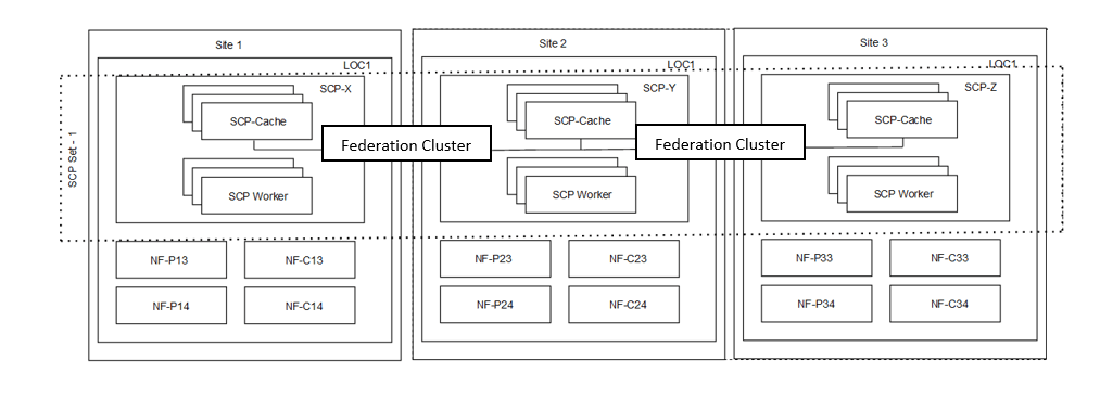

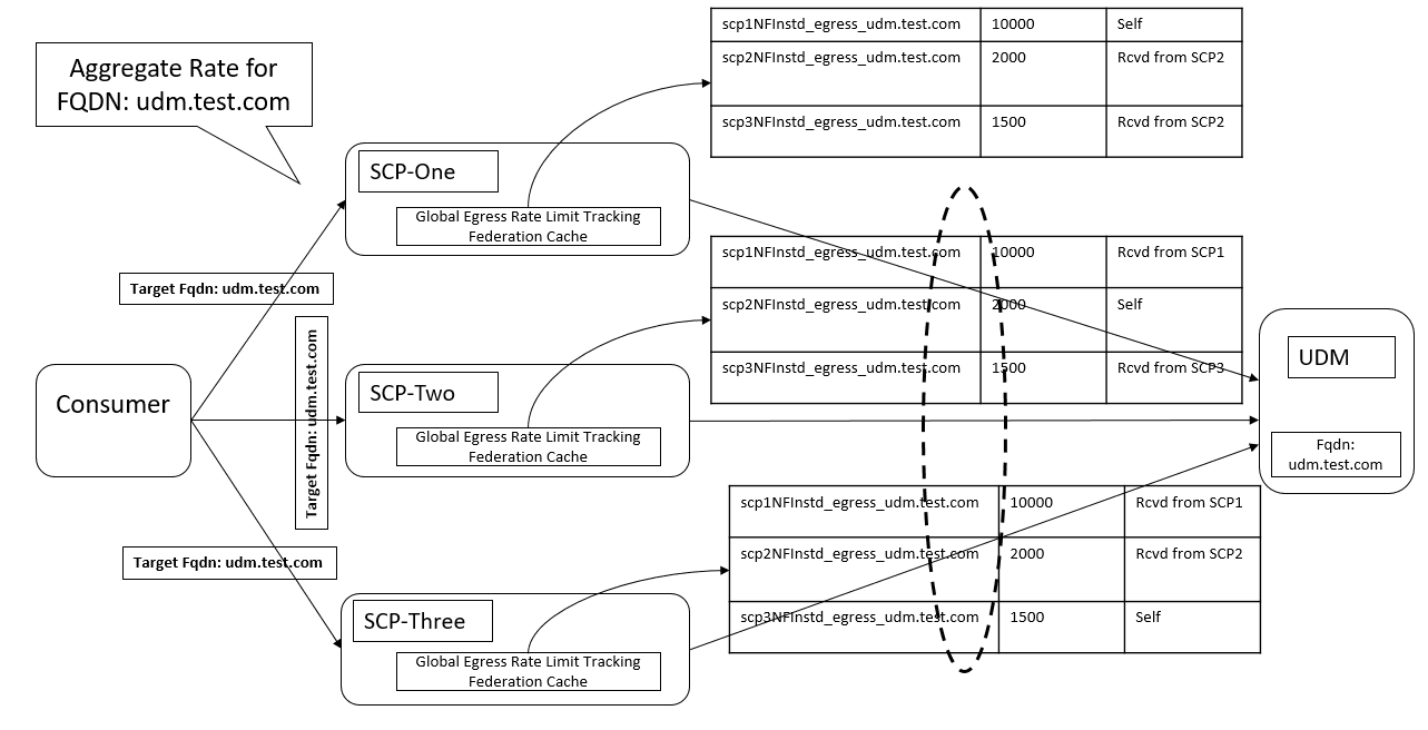

3.33.2 Global Rate Limit Feature
The global rate limit feature aggregates traffic rate data across multiple SCP instances and applies traffic rate control based on the configured aggregated rate.
The aggregated rate is configured at each SCP instance in the following way:
  1. Each SCP instance monitors its own traffic routed count against the configured NF, NFInstanceID, FQDN, and so on, and reports the same to all other SCP instances.
  2. Each SCP instance aggregates the total traffic routed against the configured NF, NFInstanceID, and FQDN from all SCP instances.
  3. Each SCP also calculates its own share of routed traffic in the aggregated total routed traffic count, as well as the status of the difference between total routed traffic and the configured aggregated rate.
  4. Global Rate Limit Control actions such as allowing or disallowing traffic are decided based on the data collected in the steps above.
Convergence of global rate data aggregation depends on network latency among the SCP instances, and higher latency can impact rate-limiting performance.
Global Rate Working Principle
The working principle are as follows:
  1. Each SCP instance has an aggregation cache, which syncs its own traffic route count with other SCP instances.
  2. In this aggregation cache, a routed traffic rate count is maintained for each SCP instance.
  3. Each SCP instance calculates the total traffic routed towards the configured NF, NFInstanceID, FQDN, and so on.
  4. For example, the diagram depicts the aggregated routed traffic count for a FQDN, "udm.test.com," across all 3 SCP instances.
    • Sample configuration 1: A global rate limit is configured in 3 SCP instances for FQDN "udm.test.com" with a rate of 15000 per sec.
    • Sample configuration 2: A global rate limit is configured in 3 SCP instances for FQDN "udm.test.com" with a rate of 13000 per sec.
  5. The global rate limit control action, such as allowing or disallowing the traffic, is decided based on the aggregated routed traffic count collected.
    • Action for configuration 1: Traffic is allowed since the total traffic routed rate is less than 15000 per sec.
    • Action for configuration 2: Traffic is throttled since the total traffic routed rate is greater than 13000 per sec.
Figure 3-8 Global Rate Limit Working Principle

3.33.4.1 Global Egress Rate Limiting
The existing egress rate limiting functionality aggregates traffic rate for a target producer NF within one SCP instance across multiple pods of SCP-worker service. It does not aggregate the overall traffic rate towards the producer NF across multiple SCP instances. Therefore, the Global Rate Limiting feature is implemented so that a group of SCP instances coordinates among each other to ensure traffic rates for common destinations, that is, producer NFs, are aggregated and the egress rate limit is applied to the overall traffic rate.
The Global Egress Rate Limiting feature synchronizes and aggregates the egress rate data for multiple producer NFs among multiple SCP instances (up to three SCP instances). Based on the aggregated rate data, each SCP controls its traffic to ensure the global configured egress rate is achieved.
The SCP-cache microservice synchronizes egress rate data among multiple SCP instances. The participating SCP instances for the egress rate limiting aggregation details are configured using Helm as described in Oracle Communications Cloud Native Core, Service Communication Proxy Installation, Upgrade, and Fault Recovery Guide. SCP uses an Oracle product called Oracle Coherence which offers federated caching to link multiple clusters so that cache data is automatically synchronized between clusters.
Figure 3-9 Role of SCP-Cache
Role of SCP-Cache
By default, the egress rate aggregation is disabled. After enabling the Global Egress Limiting feature using the global_egress_ratelimit parameter on the CNC Console, the egress rate aggregation uses remoteScpOneEnabled and remoteScpTwoEnabled parameters to enable rate data synchronization and aggregation with the corresponding remote instances of SCP. If the rate aggregation and synchronization are disabled or the communication fails with a remote SCP instance, the Global Egress Rate Limiting feature does not consider that remote SCP as part of the Global Federation cluster. Therefore, Global Rate Limit Algorithm does not consider any message rate related updates from that remote SCP while applying the rate limit.

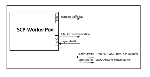

3.34 Support for Multus Container Network Interface
Multus Container Network Interface (CNI) is a plug-in that allows you to connect multiple network interfaces to pods in Kubernetes.
Each Kubernetes pod contains only one network interface. After integrating Multus CNI with SCP, you can create multiple interfaces in a pod and perform the following tasks:
  • Create multiple signaling interfaces for routing the signaling traffic
  • Create different interfaces for Operations, Administration, and Maintenance (OAM) and Signaling (SIG) traffic to enable traffic segregation
This feature configures the pods to use different network interfaces for different types of traffic. These interface IPs and routing information, such as range of IPs and gateways, are provided by Network Attachment Definition (NAD) Kubernetes custom resource. Multus CNI configures the IP routing rules based on this routing information.
For more information about Multus CNI, see https://github.com/k8snetworkplumbingwg/multus-cni.
Default Pod IPs assigned by Kubernetes are used for establishing pod-to-pod and egress communication. When Multus CNI adds other network interfaces to pods, these interface IPs can be used for egress communication.
Figure 3-10 Networking-Multus Support
The diagram shows how support for Multus helps SCP to support multiple interfaces on egress traffic from the scp-worker pod.
The Multus requirement is not applicable for SCP Control Pods.
The scp-worker pod is handling the following types of traffic:
  • 5G SBI traffic
  • Inter-pod communication traffic
  • OAM traffic is communication traffic between observability components and scp-worker
The directions of this traffic are to and fro via SCP, and hence they are present in ingress and egress directions. There is no segregated ingress traffic. Only egress traffic is separated over multiple interfaces by dedicating Virtual network interface controllers (vNICs) to manage each type of traffic:
  • Eth0 vNIC manages Egress (inter-pod communication traffic).
  • Eth1 vNIC manages Egress 5G SBI traffic.
It is not required to separate OAM traffic from signaling traffic.

3.35 Support for Model C Indirect 5G SBI Communication
5G Service Based Interface (SBI) communication models are used to establish connections among NFs and NF services. These communication models facilitate consumer NFs to route service requests to producer NFs either directly or indirectly through Service Communication Proxy (SCP). For more information about different communication models, such as Model A, Model B, Model C, and Model D, see 3GPP TS 23.501 version 16.6.0 Release 16.
With the introduction of the Model C Indirect 5G SBI Communication format in SCP, the consumer NF sends NF discovery service requests to NRF. After receiving the discovery response with NF profiles, the consumer NF does the following:
  • Selects an NF Set or a specific NF instance from the NF Set
  • Sends a service request to SCP with the address of the selected service producer NF
  • Creates multiple network interfaces for different subnet IPs
Where,
  • NF Set is a group of interchangeable NF instances of the same type that supports the same services and the same Network Slices. NF instances in the same NF Set may be geographically distributed but have access to the same context data.
  • NF instance is an instance of the NF that can be identified.
  • NF Set Identifier (NF Set ID) is a globally unique identifier of a set of equivalent and interchangeable CP NFs from a given network that provides distribution, redundancy, and scalability.
Then, SCP selects an NF service instance and routes the service requests to the selected producer NF. In case of failure if reselection is required, SCP selects the producer NF instance based on the NF Set. The reselection is based on the binding header, if available.
Support for Binding Headers in Model C Indirect 5G SBI Communication
SCP supports the following 5G SBI custom headers in Model C Indirect 5G SBI Communication:
  • 3gpp-Sbi-Binding: This header contains a comma-delimited list of Binding Indications from an HTTP server for storage and use of HTTP clients. The absence of this parameter in a Binding Indication in a service request is interpreted as "callback".
  • 3gpp-Sbi-Routing-Binding: This header contains a Routing Binding Indication to direct service request to an HTTP server which has the targeted NF service resource context.
SCP does not update the value of the "3gpp-Sbi-Binding" header in the HTTP/2 request or response. It supports reading value of the "3gpp-Sbi-Routing-Binding" header in the service request and uses the binding level in the "3gpp-Sbi-Routing-Binding" header to perform routing.
Binding level NF service Set and NF service instance are not supported.
Support for Load Balancing and Alternate Routing in Model C Indirect 5G SBI Communication
When the target producer NF is unavailable, then SCP determines the NF Set ID of the target producer NF and performs alternate routing on the NF ID set instances in a sequence until SCP completes all the configured routing attempts.
SCP uses the NF set or NF instance for load balancing and alternate routing.
Support for Reverse Lookup in Model C Indirect 5G SBI Communication
When forward routing fails due to unavailability of the producer NF or the message does not have the NF Set ID, SCP performs reverse lookup in learned NF profiles. It performs alternate routing by obtaining destination information from the Set IDs. Reverse Lookup occurs when "3gpp-Sbi-Discovery-Target-Nfset" and "3gpp-Sbi-Routing-Binding" headers are absent in the message.
Model C Indirect 5G SBI Communication Response Headers
Additional response headers supported by Model C Indirect 5G SBI Communication in case of alternate routing are as follows:
  • "3gpp-Sbi-Producer-Id"
  • Either "3gpp-Sbi-Target-apiRoot" or Location header
Load Balancing or Forward Routing from routing options can not be configured with Release 16 of Model C Indirect 5G SBI Communication because forward routing occurs based on the "3gpp-Sbi-Target-apiRoot" header. If the "3gpp-Sbi-Target-apiRoot" header is unavailable, then only load balancing occurs based on NF Set ID in the binding header.

3.39 Support for Multiple Signaling Service IPs
In the previous release, SCP supported only one signaling IP from a given network. This IP was exposed to all NFs to establish 5G Service Based Interface (SBI) communications.
With the support for multiple signaling IPs, SCP can expose multiple signaling service IPs from the same or a different network to all NFs to accept 5G SBI signaling traffic (ingress connections).
SCP supports 8 signaling IPs.
This feature provides the flexibility to achieve maximum redundancy in the IP path. 5G NFs can have more than one SCP’s destination IPs for the transport network to select different paths for each of the IPs. Therefore, a single SCP instance is available through more than one IP path if one of the transport network paths fails.
Using this feature, you can do the following:
  • Improve resiliency in 5G core network during transport failure by enabling multiple signaling paths.
  • Create dedicated signaling service paths by configuring multiple service signaling IPs.

3.48 Support for Three-site Georedundancy
Geographical Redundant (Georedundant) deployments ensure high availability and redundancy of NFs. SCP supports a three-site georedundancy deployment of cnDBTier to ensure service availability when one of the SCP sites is down.
When the primary SCP is available, NFs send service requests to the primary SCP. When SCP at the primary site is unavailable, NFs redirect service requests to the secondary SCP or tertiary SCP until the primary SCP’s active status is restored.
The SCP database consists of the following:
  • Configuration Data: The configuration data is exclusive for a given SCP instance. Therefore, an exclusive logical database is created and used by an SCP instance to store its configuration data. You can configure SCP instance specific configurations using RESTful config API exposed by SCPC-Configuration microservice through the CNC Console.
  • Routing Data: This is the routing rules data that SCP determines from NRF in 5G Core network topology.
  • Status Data: This data provides the status of upgrade or rollback.
In a three-site deployment, each SCP instance uses its database. The data gets replicated to all other sites of the cnDBTier cluster so that the data is available on all the cnDBTier cluster sites in case of a cnDBTier instance failure. SCP data gets replicated between the georedundant sites by using cnDBtier replication services. cnDBtier can be supported in the following modes:
  • Two-site cnDBtier georeplication mode: The database backup from one of the sites can be used for fault recovery of SCP.
  • Three-site cnDBTier georeplication mode: The database backup from one of the sites can be used for fault recovery of SCP.
  • One-site cnDBTier deployment mode: The georeplication is unavailable.
For more information about database replication in a georedundant environment, see Oracle Communications Cloud Native Core cnDBTier User Guide.
