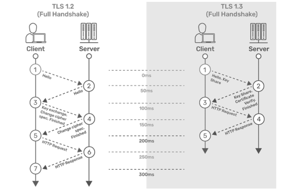

TLS Handshake
This section describes the differences between TLSv1.2 and TLSv1.3 and the advantages of TLSv1.3 over TLSv1.2 and earlier versions.
TLSv1.2
- The connection or handshake starts when the client sends a “client hello” message to the server. This message consists of cryptographic information such as supported protocols and supported cipher suites. It also contains a random value or random byte string.
- To respond to the “client hello” message, the server sends the “server hello” message. This message contains the CipherSuite that the server has selected from the options provided by the client. The server also sends its certificate along with the session ID and another random value.
- The client verifies the certificate sent by the server. When the verification is complete, it sends a byte string and encrypts it using the public key of the server certificate.
- When the server receives the secret, both the client and server generate a master key along with session keys (ephemeral keys). These session keys are used to symmetrically encrypt the data.
- The client sends an “HTTP Request” message to the server to enable the server to switch to symmetric encryption using the session keys.
- To respond to the client’s “HTTP Request” message, the server does the same and switches its security state to symmetric encryption. The server concludes the handshake by sending an HTTP response.
- The client-server handshake is completed in two round-trips.
TLSv1.3
- The connection or handshake starts when the client sends a “client hello” message to the server. The client sends the list of supported cipher suites. The client also sends its key share for that particular key agreement protocol.
- To respond to the “client hello” message, the server sends the key agreement protocol that it has chosen. The “Server Hello” message comprises the server key share, server certificate, and the “Server Finished” message.
- The client verifies the server certificate, generates keys as it has the key share of the server, and sends the “Client Finished” message along with an HTTP request.
- The server completes the handshake by sending an HTTP response.

Comparison Between TLSv1.2 and TLSv1.3
The following table provides a comparison of TLSv1.2 and TLSv1.3:
Table 4-2 Comparison of TLSv1.2 and TLSv1.3
Feature | TLS v1.2 | TLS v1.3 |
TLS Handshake |
Cipher Suites |
Round-Trip Time (RTT) | This has a high RTT during the TLS handshake. | This has low RTT during the TLS handshake. |
Perfect Forward Secrecy (PFS) | This doesn't support PFS. | TLSv1.3 supports PFS. PFS ensures that each session key is completely independent of long-term private keys, which are keys that are used for an extended period to decrypt encrypted data. |
Privacy | This is less secure, as the ciphers used are weak. | This is more secure, as the ciphers used are strong. |
Performance | This has high latency and a less responsive connection. | This has low latency and a more responsive connection. |

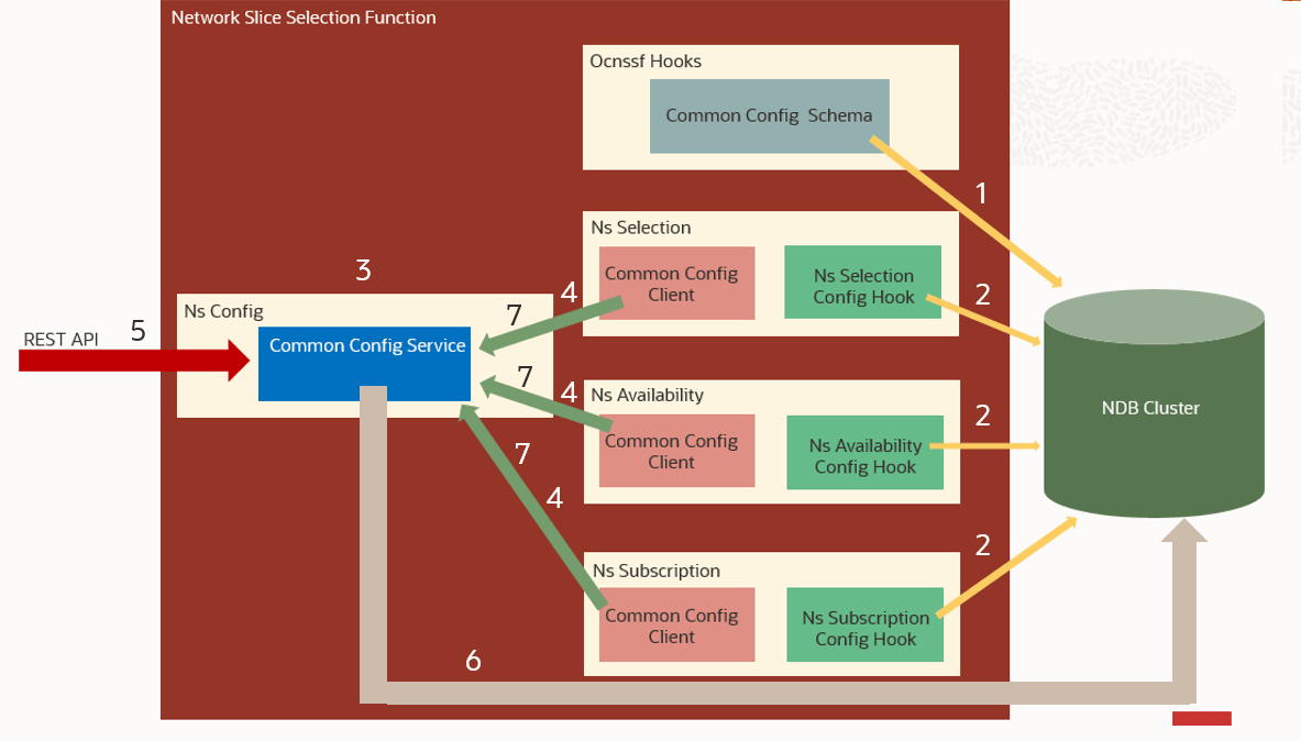

4.3 Support for Common Service APIs in CNC Console
The configuration for common service APIs was supported only using REST. With the implementation of this feature, NSSF now supports the configuration of Ingress Gateway and Egress Gateway parameters using the CNC Console. You can perform HTTP methods such as GET and PUT using the Console.
For more information about the common service APIs, see "Common Services REST APIs" section in the Oracle Communication Cloud Native Core, Network Slice Selection Function REST Specification Guide.
Managing common service APIs in the CNC Console

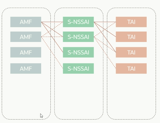

4.4 Enhanced Computation of AllowedNSSAI in NSSF
As per 3GPP specification, NSSF utilizes AMF (Access and Mobility Management Function) to manage the slice selection criteria. Here, if a newly configured NSSAI is not supported by the Radio Access Network (RAN), the AMF designates it as the Rejected-NSSAI. To allow the newly configured NSSAI, UE needs to request for a re-registration. It allows the AMF to disregard a UE's Requested NSSAI and formulate the AllowedNSSAI based on subscription details and support from the RAN
The objective of this feature is to maintain a consistent approach to handling slice subscription changes between AMF and NSSF. Recognizing the need for adaptive and subscriber centric configurations of NSSAI, this feature allows NSSF to generate AllowedNSSAI based on individual user equipment (UE) subscriptions and Tracking Area characteristics.
When this feature is enabled, NSSF generates AllowedNSSAI based on User Equipment (UE) subscription details and the supported configuration within the Tracking Area. Conversely, when the feature is disabled, the NSSF adheres to the 3GPP specification 29.531, constructing AllowedNSSAI based on the intersection of Requested and Subscribed NSSAI and also operator policy.
NSSAI Configuration (When the feature is enabled):
- Subscriber-Driven Configuration: The NSSF will dynamically build AllowedNSSAI based on the UE subscription information. This ensures that network slices are aligned with the specific requirements and preferences of individual subscribers.
- Tracking Area Considerations: The NSSF takes into account the supported configuration within the Tracking Area, optimizing the network slice selection based on the geographical location and network capabilities in real time.
Static NSSAI Configuration (When the feature is disabled):
- Compliance with 3GPP Specification 29.531: When the feature is disabled, the NSSF follows the guidelines outlined in the 3GPP specification 29.531. This involves creating AllowedNSSAI based on the intersection of Requested and Subscribed NSSAI, providing a standardized approach to network slice configuration.
- Maintaining Compatibility: Disabling the dynamic NSSAI configuration ensures compatibility with industry standards and facilitates interoperability across different network elements and vendors.

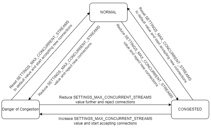

4.8 Ingress Gateway Pod Protection
This feature protects the Ingress Gateway pods from overloading due to uneven traffic distribution, traffic bursts, or congestion. During overload conditions, the Ingress Gateway pods may undergo stability issues. As a front end microservice for HTTP traffic, it is important for Ingress Gateway to have pod protection implemented.
The pod protection is performed based on the CPU consumption of the Ingress Gateway Pods as explained in the Congestion State Parameters. It is measured at different load states mentioned in the Ingress Gateway Load States.
Horizontal POD Autoscaling (HPA) at Ingress Gateway microservice and pod protection mechanism at Ingress Gateway microservice are independent features with different trigger conditions. While HPA considers microservice load, pod protection mechanism works only on the POD load. Therefore, their order of triggering cannot be predicted.In a service mesh based deployment, all incoming connections to the pod get terminated at the sidecar container, then the sidecar container creates a new connection toward the application container. These incoming connections from the peer are managed by the sidecar and outside the purview of the application container.
Hence when the Ingress Gateway container reaches DOC or Congested level, in a service mesh based deployment, the Ingress Gateway container will only be able to stop accepting new connections from the sidecar container. Also in this state, the Ingress Gateway container will reduce the concurrency of the existing connections between the sidecar container and the Ingress Gateway container. Any new request received over a new connection may get accepted or rejected based on the sidecar connection management.
In a non-service mesh based deployment, all incoming connections to the pod get terminated at the Ingress Gateway container. Hence when the Ingress Gateway container reaches DOC or Congested level, the Ingress Gateway container will stop accepting new connections. Also in this state, the Ingress Gateway container will reduce the concurrency of the existing connections between the peer and the Ingress Gateway container. Any new request received over a new connection will result in to a request timeout at the peer.
The following states are used to detect overload conditions. This ensures the protection and mitigation of pods from entering an overload condition, while also facilitating necessary actions for recovery.
The transition can occur between any states based on the congestion parameters. The threshold for these congestion parameters is preconfigured and must not be changed.- Congested State: This is the upper bound state where the pod is
congested. This means one or more congestion parameters are above the configured
thresholds for the congested state. For more information about the configuration
using REST API, see Oracle Communications Cloud Native Core, Network Repository
Function REST Specification Guide. The pod can be transitioned to the Congested
State either from the Normal State or the DoC state. When the pod reaches this
state, the following actions are performed:
- new incoming HTTP2 connection requests are not accepted.
- the pod gradually decrements the number of concurrent streams
by updating SETTINGS_MAX_CONCURRENT_STREAMS parameter in a SETTINGS frame to
the configured
maxConcurrentStreamsPerCon
value at a regular interval. The concurrent streams are decremented based on the value configured indecrementBy
parameter. And, the regular interval is configured in thedecrementSamplingPeriod
parameter.
- Danger of Congestion (DOC): This is the intermediate state where
the pod is approaching a congested state. This means if CPU is above the configured
thresholds for the DoC state.
- any new incoming HTTP2 connection requests are not accepted.
- if the pod is transitioning from the Normal State to the DoC
state, the pod gradually decrements the number of concurrent streams by
the configured
parameter. - if the pod is transitioning from the Congested State to the DoC
state, the pod gradually increments the number of concurrent streams by
the configured
value at a regular interval. The concurrent streams are incremented based on the value configured inincrementBy
parameter. And, the regular interval is configured in theincrementSamplingPeriod
parameter.
- Normal State: This is the lower bound state where all the
congestion parameters for the pod are below the configured thresholds for DoC and
Congested states. When the pod reaches this state, the following actions are
performed:
- the pod will continue accepting new incoming HTTP2 connection requests.
- the pod will continue accepting requests on the existing HTTP2 connections.
- in case the pod is transitioning from the Congested or DoC
state to Normal state, the pod gradually increments the number of concurrent
streams by updating SETTINGS_MAX_CONCURRENT_STREAMS parameter in a SETTINGS
frame to the configured
parameter.

4.17 Auto-Population of Configuration Based on NSAvailability Update
The Auto-Population of Configuration Based on NSAvailability Update feature allows the Network Slice Selection Function (NSSF) to automatically learn and adapt its configuration for supported S-NSSAIs (Network Slice Selection Service Area Identifiers) from trusted Access and Mobility Functions (AMFs). This automation minimizes manual configuration efforts for operators by filling in the gaps where the operator has not specified allowed S-NSSAIs.
Benefits- Reduces Manual Configuration: Focuses operators' efforts on restricted S-NSSAIs.
- Minimizes Errors: Reduces potential errors from manual configuration.
- Keeps Configurations Up-to-Date: Ensures NSSF configurations align with trusted AMF capabilities.
- AMF Sends Availability Update: An AMF sends a message to NSSF about the S-NSSAIs it supports in a specific Tracking Area Identifier (TAI).
- NSSF Checks Configuration: NSSF checks its provisional database to determine if the S-NSSAIs are already configured for that TAI.
- Automatic Configuration (if enabled and applicable):
- If enabled and the S-NSSAIs are not configured for that TAI:
- NSSF creates entries in the
nssai_auth
table for the S-NSSAIs and TAI. - NSSF creates an
nss_rule
for the S-NSSAIs with access type set to 3GPP (if supported in one or more TAIs). - NSSF notifies other AMFs subscribed to the TAI about the new S-NSSAIs.
- If the S-NSSAIs are already configured or if the feature is disabled, NSSF takes no action on the AMF's update.
Scenario
- The operator configures NSSF to allow S-NSSAI "S1" in TAI "1".
- A trusted AMF sends an NSAvailability Update indicating it supports S-NSSAIs "S1" and "S2" in TAI "1".
- AMF to NSSF: AMF sends the NSAvailability Update.
- NSSF:
- Stores the update in StateDB (dynamic configuration).
- Checks ProvisionDB (operator configuration) and finds only "S1" is allowed in TAI "1".
- Validates and authorizes "S1" based on ProvisionDB.
- NSSF to AMF: NSSF responds with "SNSSAI S1 is authorized in TAI-1".
- NSSF:
- Stores the update in StateDB.
- Checks ProvisionDB and finds only "S1" is allowed in TAI "1".
- Identifies "S2" as not configured in ProvisionDB for TAI "1".
- Creates an entry in the
nssai_auth
table for TAI "1" and S-NSSAI "S2" with grant set to "ALLOWED". - Creates an
nss_rule
associating thenssai_auth
entry with the PLMN level profile of TAI "1" (for 3GPP access). - Sends notification to other AMFs subscribed to TAI "1" about the new S-NSSAI "S2".
- NSSF to AMF: NSSF responds with "SNSSAI S1, S2 is authorized in TAI-1".
- With Feature Enabled: NSSF learns about "S2" from the AMF and automatically configures it for TAI "1".
- With Feature Disabled: NSSF only authorizes "S1" based on preconfigured operator settings.
- Delete S-NSSAI Entry: When an AMF sends a delete request, NSSF checks if

Support for TAI range in NSSF.
With the advent of 5G and the three types of 5G network slices (MIoT,
eMBB, and URLLC), there could be millions of TAIs ( and TACs) in a PLMN. As per
current standards, the maximum number of slice instances in a 5G network can reach
hundreds. Although the number of slice identifiers (SNSSAIs) in a PLMN is
operator-dependent, there is a scope to scale this in thousands, and corresponding
slice instance (NSI) in tens of thousands. Since there is a many-to-many mapping
between TAIs and SupportedSNSSAIs, and this information is shared and authorized
between NSSF and NF Service Consumer of nssai_availability
service, the number of TAIs supported by an AMF can range in millions. This can lead
to a massive increase in the number of messages with replicated data across NSSF
and AMF.
The support for TAI ranges reduces the memory consumption at NSSF by eliminating the need for redundant data storage. Apart from this, the size of supported NSSAI towards NF Service Consumer is also reduced, which further improves the overall network throughput.
For Example:
Consider a case with PLMN 100,101, which constitutes of 1000000 TACs; (1,10,00,000).
If the AMF Supports 300000 TACs, for TAC (1 - 300000):
- Supported SNSSAIs in TAC (1 -100000) are SNSSAI-1,SNSSAI-2,SNSSAI-3,
- supported SNSSAIs in TAC (100001 - 200000) are SNSSAI-2,SNSSAI-3,SNSSAI-4, and
- supported SNSSAIs in TAC (200001 - 300000) are SNSSAI-3, SNSSAI-4, SNSSAI-5.
Each AMF supports multiple TAIs and S-NSSAIs, as shown in the diagram below:
Figure 4-1 Association of AMF and TAI with S-NSSAI
The list of supported TAIs will be almost the same, but for different S-NSSAIs, NSSF requires huge storage space for the redundant data. This results in a substantial increase in the size of the notifications and hassles for managing such a huge configuration, as explained below:

4.30 Dynamic Log Level Update
Dynamic Log Level Update allows operator to update NSSF log level dynamically without restart.
The log level can be changed by the user at run time. NSSF use common configuration service for dynamically updating Logging Information.
Managing Dynamic Log Level Update
Enable
- Customize the
ocnssf_custom_values_24.3.2.yaml
helm file. - Set
commonCfgClient.enabled
totrue
in the helm file.
Table 4-19 Parameters Configuration
Name | Default | Description |
commonCfgClient.enabled | true | Enable/Disable Client. |
commonCfgClient.pollingInterval | 5000 | Set Polling Interval in Milliseconds |
Configure
For more information on REST APIs, see Runtime Log Level Update in Oracle Communications Cloud Native Core, Network Slice Selection Function REST Specification Guide.
Observe
No new metrics or KPIs are generated for this feature. For information on other Metrics and KPIs of OCNSSF, see OCNSSF Metrics and OCNSSF KPIs sections respectively.
Maintain
- Collect the logs: For more information on how to collect logs, see Oracle Communications Cloud Native Core, Network Slice Selection Function Troubleshooting Guide.
- Raise a service request: See My Oracle Support for more information on how to raise a service request.

Once the HTTPS handshake is complete all communications between the client and the server are encrypted. This includes the full URL, data (plain text or binary), cookies and other headers.
The only part of the communication not encrypted is what domain or host the client requested a connection. This is because when the connection is initiated an HTTP request is made to the target server to create the secure connection. Once HTTPS is established the full URL is used.
This initialization only needs to occur once for each unique connection. This is why HTTP/2 has a distinct advantage over HTTP/1.1 since it multi-plexes connections instead of opening multiple connections.
