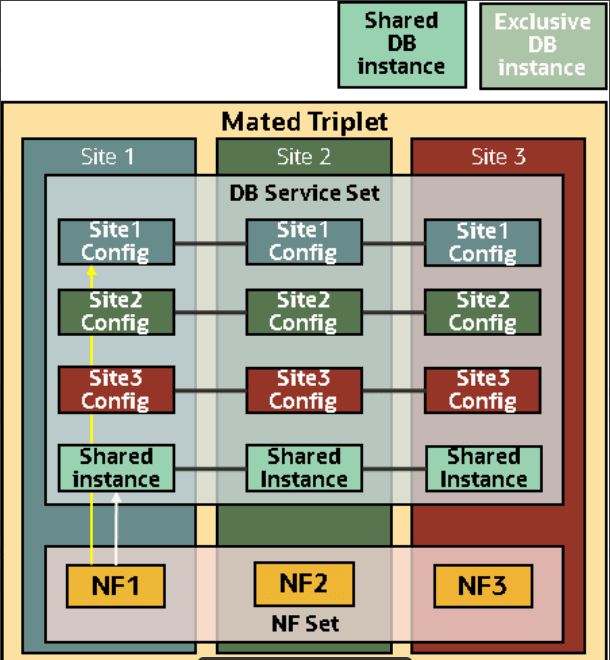

This guide describes recovery procedures to restore UDR database only. To restore all the databases that are part of cnDBTier, see Oracle Communications Cloud Native Core, cnDBTier Installation, Upgrade, and Fault Recovery Guide. available on My Oracle Support (MOS).Database Model of UDR
- Configuration Data: The configuration data is exclusive for a given site. Thus, an exclusive logical database is created and used by a site to store its configuration data. Using CNC Console and Configuration Management service, an operator can configure data in the respective site only.
- Subscribers Data: The subscribers data is shared across sites. Thus, a common logical database is created and used by all sites. The data is replicated across sites to preserve and share session with mated sites. In case of cross-sites messaging or a site failure, shared session data helps in continuity of service.
Figure 7-1 Database Model
