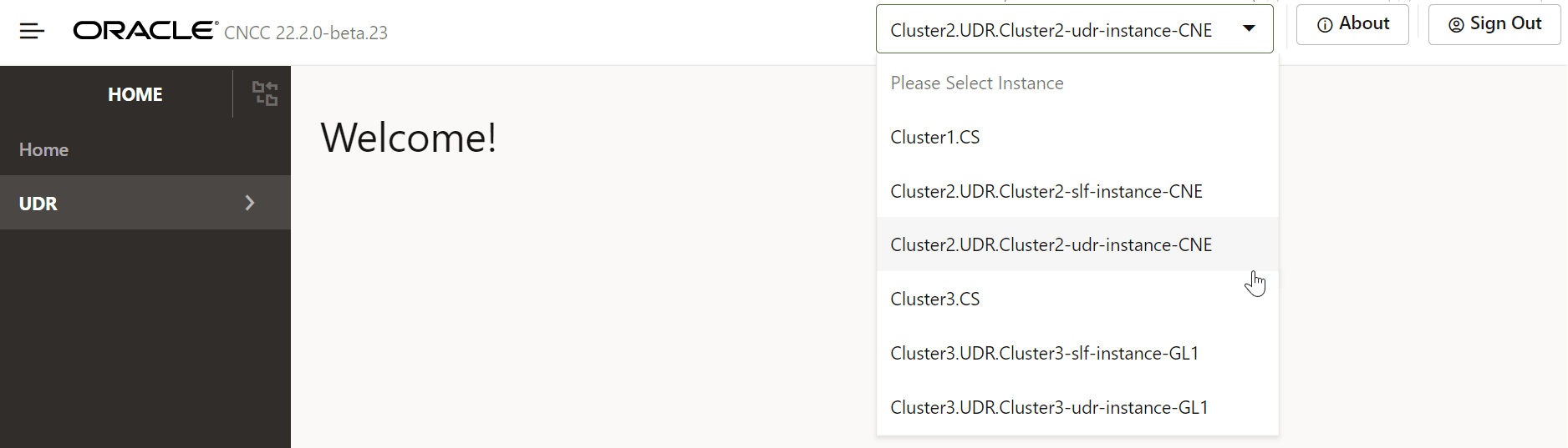

In. The CNC Console Home page appears from where a user can select
different instances in the drop down, for example, the EIR, SLF, or the UDR
instance.

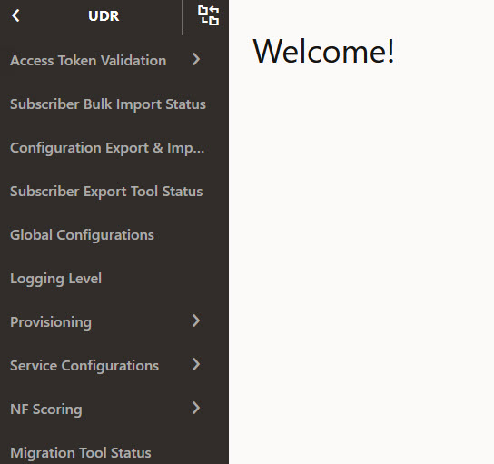

The following NF services appear in the left navigation pane for the selected instance:- Access Token Validation
- Bulk Import Status
- Configuration Export & Import
- Global Configurations
- Logging Level
- Provisioning
- Service Configurations
- NF Scoring
- Migration Tool Status
- Select the service to be used from the left navigation pane:
Figure 3-3 CNC Console Home Page with Services
The NF services appear in the left navigation pane for the EIR and SLF instance.

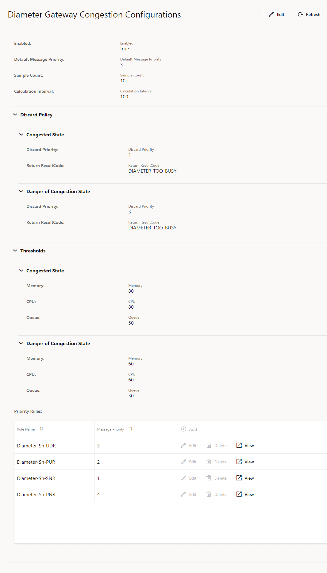

Table 3-11 Entry Action
| Field Name | Description | Details |
| Action | This attribute indicates the action for the
congestion state.
DataType: String
Constraints: MaxConcurrentStreamsUpdate, AcceptIncomingConnections Default Value: NA |
Table 3-12 Possible Arguments
| Accept | The attribute indicates if the incoming
connection should be accepted or not. Applicable when the action
is AcceptIncomingConnections.
true: The incoming connection is accepted. false: The incoming connection is rejected. The proposed value for Normal
state is |
DataType: Boolean
Constraints: true, false Default Value: NA |
| Increment by | The attribute indicates the factor by which the
current concurrent streams value will be incremented till it
reaches maxConcurrentStreamsPerCon.
Note: The proposed value for this attribute is 30 for Normal and DoC state. |
DataType: Integer
Constraints: NA Default Value: NA |
| Increment by Action Sampling Period | The attribute indicates the time interval at
which the incrementBy is applied to reach
maxConcurrentStreamsPerCon. If not
provided, the actionSamplingPeriod is used.
Note: The proposed value for this attribute is 3 for Normal and DoC state. Unit is seconds. |
DataType: Integer
| Decrement by |
current concurrent streams value will be decremented till it
reaches Note: The proposed value for this attribute is 30 for DoC and Congested state. |
DataType: Integer
| Decrement by Action Sampling Period | The attribute indicates the time interval at
which the decrementBy is applied to reach
Note: The proposed value for this attribute is 1 for DoC and Congested state. Unit is seconds. |
DataType: Integer
| Max Concurrent Streams Per Con | The attribute indicates the maximum number of concurrent streams per connection allowed. | DataType: Integer

Perform the following procedure to configure the Logging Level:
The Logging Level Configuration page allows its operators to view and edit the log level details at the application log level and package log level for each service.
To access the Logging Level Configuration page, click UDR and then Logging Level in the left navigation pane of the CNC Console application.

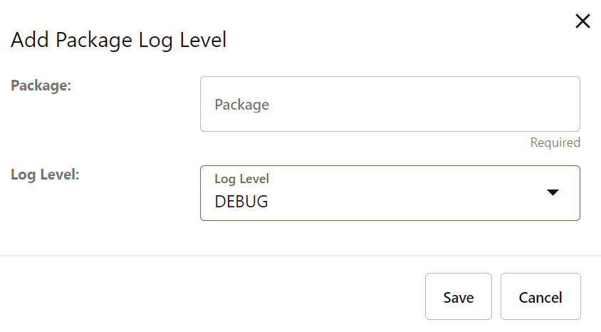

- To add the Package Log Level details:
- Click the Add button available in the Package
Log Level section. The Add Package Log Level dialog
box appears:
Figure 3-13 Add Package Log Level
- Enter the Package name and select the Log
Level from the list. The Log Level options are:
- DEBUG
- ERROR
- INFO
- TRACE
- WARN
- Click Save to add the package log level details. [OR] Click Cancel to exit the Add Package Log Level dialog box.

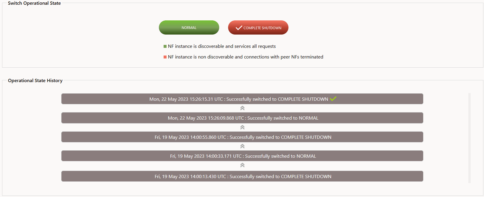

This opens the page displaying the two groups, Switch Operational State and Operational State History:
Figure 3-14 Operational State
- Switch Operational State
displays the following operational states:
- NORMAL: NF instance is discoverable and services all requests.
- COMPLETE SHUTDOWN: NF instance is non discoverable and no new session creation requests accepted.
The current state of any site can be identified with a tick mark.You can switch to a different operational state by clicking the NORMAL or COMPLETE SHUTDOWN button.
- Operational State History: It displays the history of the operational states along with the timestamp.

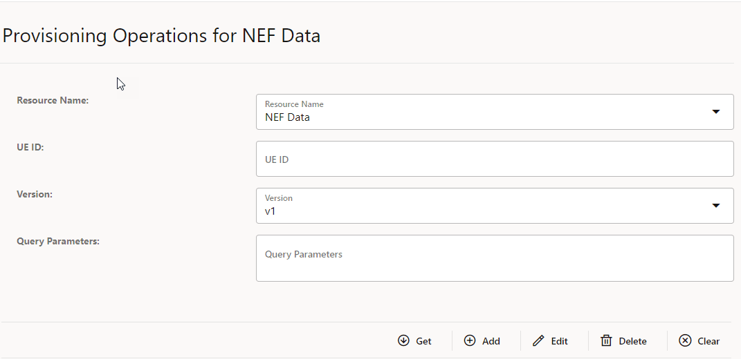

3.12.1 Provisioning - NEF Data
This section describes how to provision operations for NEF Data.
In the CNC Console application, click UDR and then Provisioning. From the Provisioning menu, select NEF Data in the left navigation pane. The Provisioning Operations for NEF Data page appears:
Figure 3-15 Provisioning Operations for NEF Data
- Extract NEF data from UDR database based on the UE ID entered
- Add new NEF data to the UDR database
- Modify an existing NEF data on the based on a UE ID
- Delete existing NEF data that is not needed in the UDR database

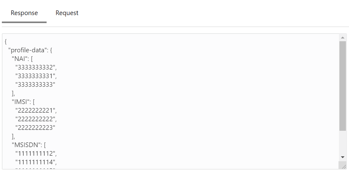

Extracting Profile Data
- Ensure Resource Name is set to 'NEF Data'
- Type an appropriate UE ID. For example: msisdn-1111111114
- Click Get. A confirmation message, 'Fetched
Successfully' appears for a second, and the result appears in the
Response text area as follows:
Figure 3-16 Sample Page: Get - NEF Data - Response

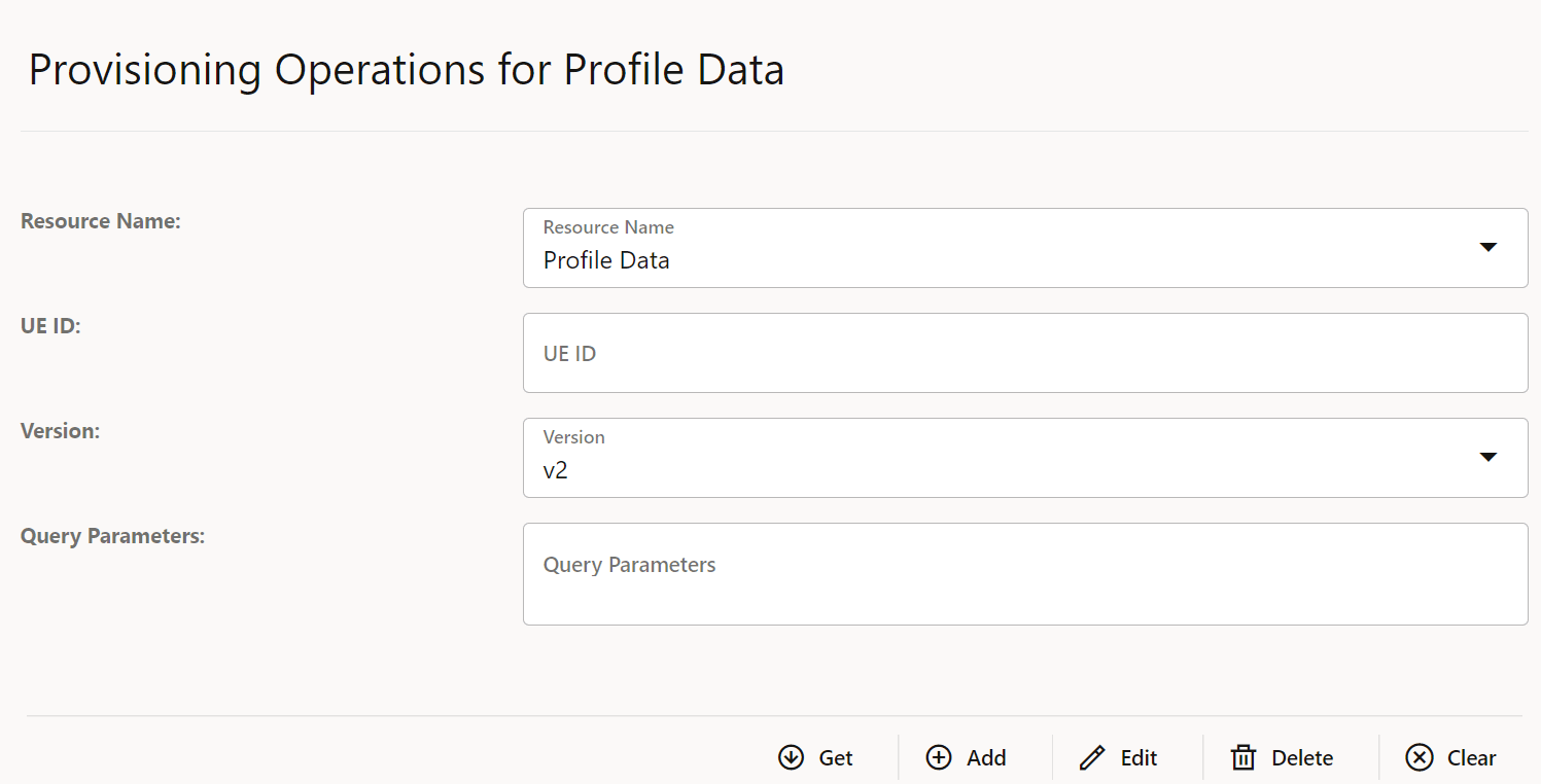

3.12.2 Provisioning - Profile Data
This section describes how to operate provisioning operations for Profile Data.
In the CNC Console application, click UDR and then Provisioning. From the Provisioning menu, select Profile Data in the left navigation pane. The Provisioning Operations for Profile Data page appears:
Figure 3-17 Provisioning Operations for Profile Data
- Extract profile data from UDR database on the basis of UE ID entered
- Add new profile data to the UDR database
- Modify an existing profile data on the basis of UE ID
- Delete an existing profile data that is no more needed in the UDR database

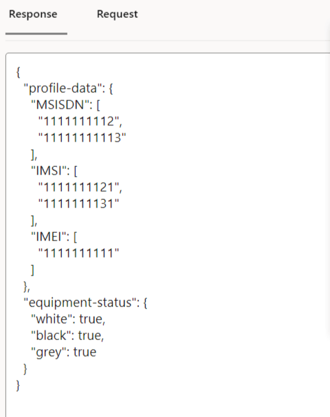

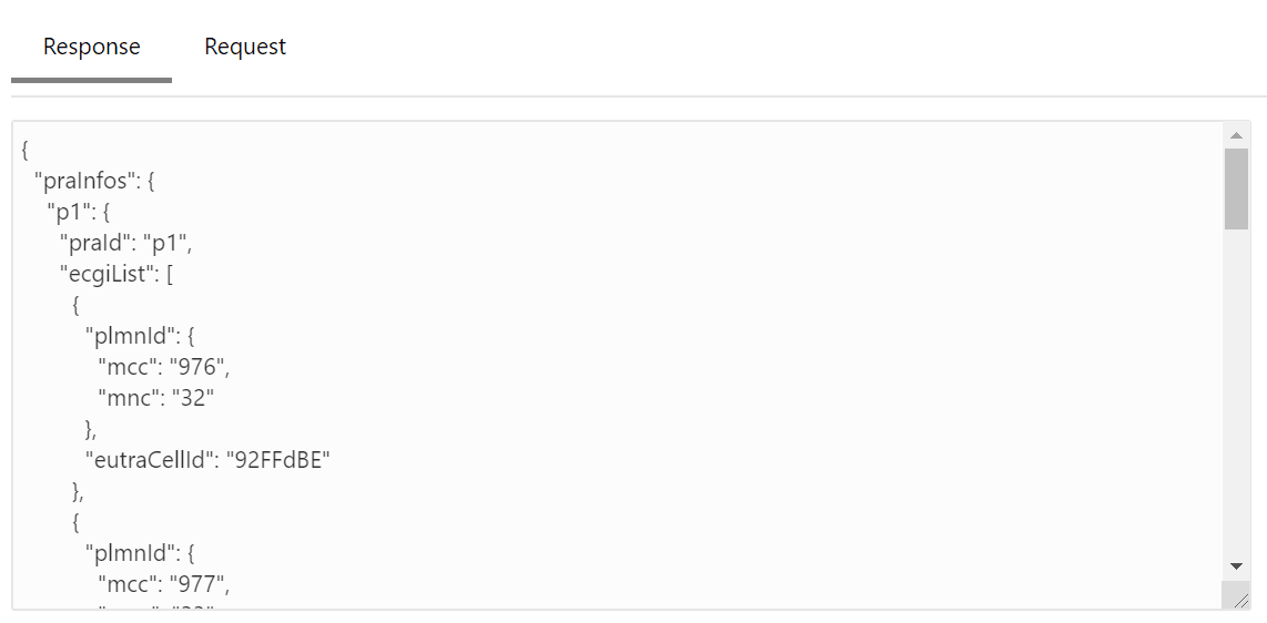

- Ensure Resource Name is set to 'Profile Data'.
- Click Get. A confirmation message, 'Fetched Successfully'
appears for a second and the result appears in the Response text area
as follows:
Figure 3-18 Sample Page: Get - Profile Data - Response
- An Error message summary appears in case of incorrect UE ID entered.
Adding a Profile Data
- Click Add. The Request text area appears.
- Type-in the profile data that you want to add to the UDR database.
- Click Submit. The 'Saved Successfully.' message
appears.
If a user enters any incorrect input, an Error message summary appears.
Editing a Profile Data
- Click Edit. The Request text area displays an existing profile data.
- Type-in the updated profile data.
appears.

- Extract EIR data from UDR database based on the UE ID entered
- Add new EIR data to the UDR database
- Modify an existing EIR data on the based on a UE ID
- Delete existing EIR data that is not needed in the UDR database
- Ensure Resource Name is set to 'EIR Data'
- Type an appropriate UE ID. For example: UE ID - imei-1111111111
Figure 3-20 Sample Page: Get - EIR Data - Response

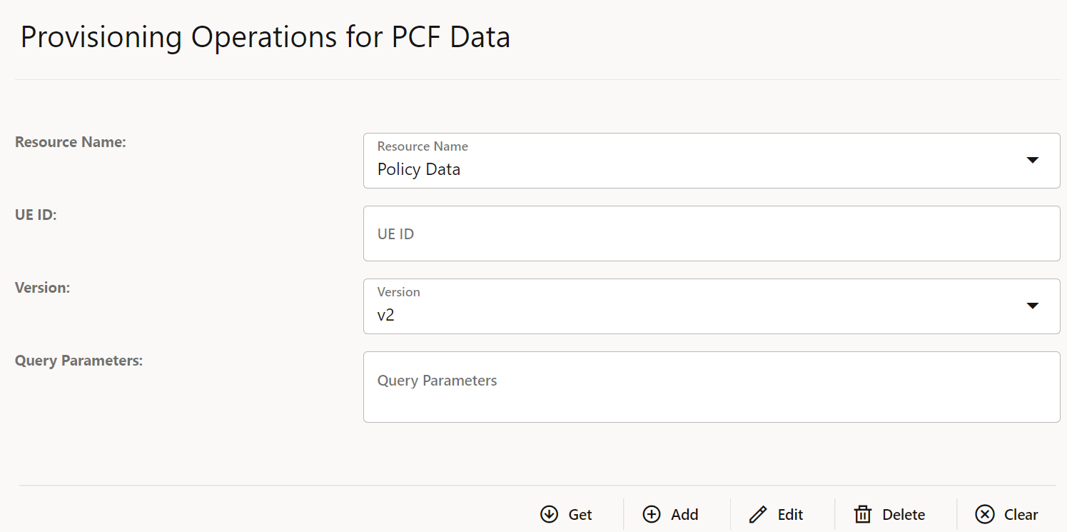

3.12.4 Provisioning - PCF Data
This section describes how to operate provisioning operations for PCF (Policy Control Function) Data.
In the CNC Console application, click UDR and then Provisioning. From the Provisioning menu, select PCF Data in the left navigation pane. The Provisioning Operations for PCF Data page appears:
Figure 3-21 Provisioning Operations for PCF Data
- Select the Resource Name from the drop-down list.
- Extract PCF data from UDR database on the basis of UE ID entered.
- Add PCF Data on the basis of payload.
- Modify the existing PCF data on the basis of UE ID.
- Delete the existing PCF data that is no more needed in the UDR database.
Extracting PCF Data
- Type an appropriate UE ID. For example: msisdn-9111111112.
- Click Get. A confirmation message, 'Fetched Successfully.'
appears and the result appears in the Response text area as
follows:
Figure 3-22 Provisioning PCF Get Response
Adding a PCF Data
- Click Add. The Request text area displays an existing PCF data.
appears.
Editing a PCF Data
- Click Edit. The Request text area displays an existing PCF data.
appears.
Deleting a PCF Data
- Select the Resource Name.
- Click Delete.
- The 'Deleted Successfully.' message appears.
Clearing a PCF Data
Click the Clear option to clear the text fields and text areas of the Provisioning Operations for PCF Data page.

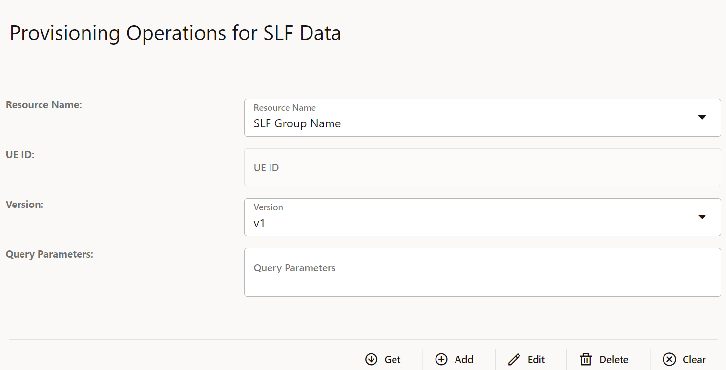

3.12.5 Provisioning - SLF Data
In this section, you will learn to operate provisioning operations for SLF (Subscriber Location Function) Data.
In the CNC Console application, click UDR and then Provisioning. From the Provisioning menu, select SLF Data in the left navigation pane. The Provisioning Operations for SLF Data page appears:
Figure 3-23 Provisioning Operations for SLF Data
SLF Group Name must be provisioned before SLF Subscriber is provisioned.- Extract SLF data from UDR database on the basis SLF Group Name (Query Parameter) or SLF Subscriber (UEID).
- Add or edit an existing SLF data on basis of SLF Group Name (Query Parameter) or SLF Subscriber (UEID).
- Delete an existing SLF data that is no more needed in the UDR database.

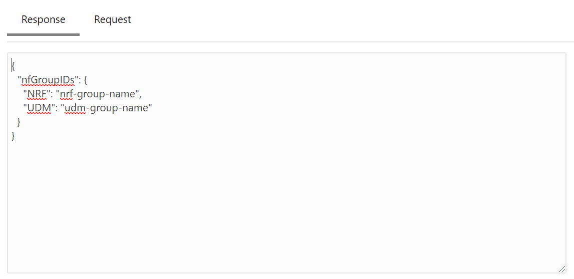

Extracting SLF Data on the basis of SLF Group Name
- Select the Resource Name as SLF Group Name.
- Enter the Query Parameters.
Successfully.' appears and the result appears in the Response
Figure 3-24 Provisioning SLF Get Response
Extracting SLF Data on the basis of SLF Subscriber
- Select the Resource Name as SLF Subscriber.
- Type an appropriate UE ID. For example: msisdn-1111111112
Figure 3-25 Provisioning SLF Get Response
- An Error message summary appears in case you enter an incorrect UE ID.
Adding SLF Data on the basis of SLF Group Name or SLF Subscriber
- Select the Resource Name as either SLF Group Name or SLF Subscriber.
- If you have selected the Resource Name as SLF Group Name
then,
- Type the SLF data.
- Click Submit. The 'Saved Successfully.' message appears.
- If you have selected the Resource Name as SLF Subscriber
then,
- Type an appropriate UE ID. For example: msisdn-1111111112.
- Type-in the SLF data.
If a user enters any incorrect input, an Error message summary appears.Editing SLF Data
then,
- Type in the Query Parameters and click Get. The result appears in the Response text area.
- Click Edit. The Request text area displays an existing SLF data. Modify the relevant details.
then,
- Type in the UE ID and click Get. The result appears in the Response text area.
- Click Edit and modify the required details. The Request text area displays an existing SLF data. Modify the relevant details.
If a user enters any incorrect input, an Error message summary appears.Deleting a SLF Data
- If you have selected the Resource Name as SLF Group Name then enter the 'Query Parameters' and if you have selected the Resource Name as SLF Subscriber then enter the 'UE ID'. For example: msisdn-1111111112
- Click Delete.

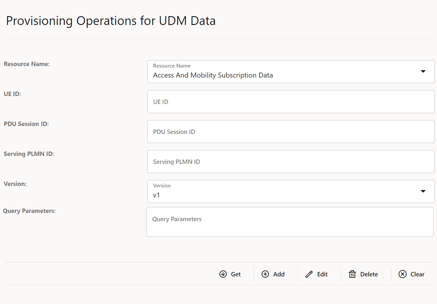

3.12.6 Provisioning - UDM Data
This section describes how to operate provisioning operations for UDM (Unified Data Management) Data.
In the CNC Console application, click UDR and then Provisioning. From the Provisioning menu, select UDM Data in the left navigation pane. The Provisioning Operations for UDM Data page appears:
Figure 3-26 Provisioning Operations for UDM Data
In the Provisioning Operations for UDM Data page, user can extract, modify and delete UDM data on the basis of Resource Name, UE ID, PDU Session ID, Serving PLMN ID, Version, and Query Parameters entered.
Extracting UDM Data
- Type an appropriate UE ID, PDU Session ID and Serving PLMN ID in their respective fields.
- Select an appropriate Version and enter Query Parameters.
- Click Get. A confirmation message, 'Fetched Successfully.' appears and the result appears in the Response text area.

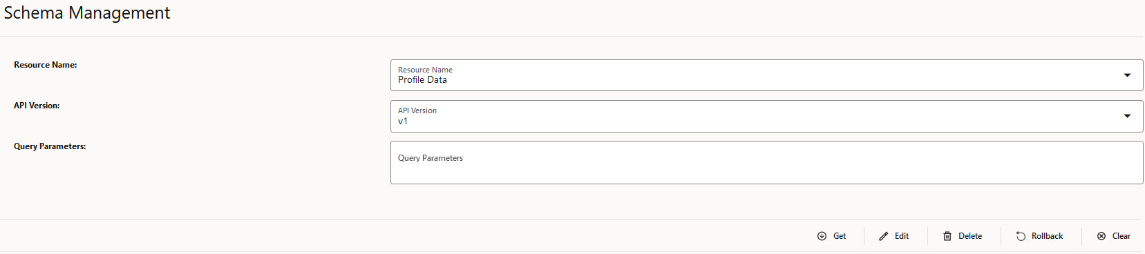

3.12.7 Provisioning - Schema Management Data
This section describes how to operate provisioning operations for schema.
In the CNC Console application, click UDR and then Provisioning. From the Provisioning menu, select Schema Management Data in the left navigation pane. The Schema Management page appears:
Figure 3-27 Schema Management
In the Schema Management page, user can extract, modify, and delete a schema on the basis of Resource Name and Query Parameters.

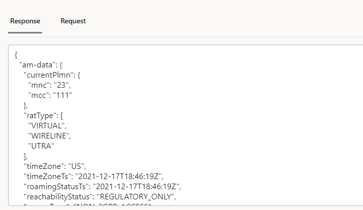

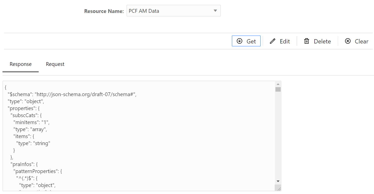

Extracting a Schema
follows:
Figure 3-28 Schema - Get - PCF AM Data
Adding or Editing a Schema
- Click Edit. The Request text area displays the selected schema.
- Edit as required and click Submit. The 'Saved
If a user edits the schema inappropriately, an Error message summary appears.
Deleting a Schema
- Click Delete.
If a user selects a schema that does not exists, an Error message summary appears.
Clearing a Schema Management Data
Click the Clear option to clear the text fields and text areas of the Schema Management page.

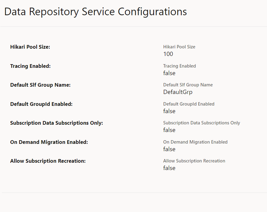

3.13.2 Data Repository Service
Click UDR and then Service Configurations. From the Service Configurations menu, select Data Repository Service. The Data Repository Service Configurations page appears:
Figure 3-30 Data Repository Service Configurations
Table 3-33 Data Repository Service Configuration Parameters
| Field Name | Default Value | Attribute | Description |
| Hikari Pool Size | 25 | Read-only | Hikari pool connection size to be created at start up. |
| Tracing Enabled | false | Read-only | Flag to enable tracing. |
| Default SLF Group Name | DefaultGrp | Editable | The default group name is provisioned. If there are any changes done to this through CNC console, then the default group must be reprovisioned with the modified group name. But if the change is done through helm values and helm upgrade is performed, then the default group will be created with the updated name. |
| Default GroupId Enabled | false | Editable | Flag to enable or disable the Default Group ID feature. |
| Subscription Data Subscriptions Only | false | Read-only | Flag to enable subscription data. |
| On Demand Migration Enabled | false | Editable | Flag to enable or disable on-demand migration. |
| Allow Subscription Recreation | false | Editable | Flag to enable or disable overwriting of existing subscription for the POST request. |
Editing Data Repository Service Configurations
- Click Edit. The Edit Data Repository Service Configurations page appears.
- Update the configuration details as required and click Save. A confirmation message, "Save successfully." appears.
- If you do not want to modify any configuration, click Cancel. You can navigate back to the Data Repository Service Configurations page.
- Click Refresh to reload the Data Repository Service Configurations page.

3.13.4 Diameter Gateway Congestion
Click UDR and then Service Configurations. From the Service Configurations menu, select Diameter Gateway Congestion. The Diameter Gateway Congestion Configurations page appears:
Figure 3-32 Diameter Gateway Congestion
The following table explains the parameters in the Diameter Gateway Congestion Configurations page in detail:
Table 3-35 Diameter Gateway Congestion Configurable Parameters
| enabled | true | Editable | Flag to enable or disable the Diameter Gateway Pod Congestion feature |
| defaultMessagePriority | 2 | Editable | Default diameter message priority which is not specifically assigned any priority |
| sampleCount | 10 | Editable | Sample request count for deciding pod state |
| calculationInterval | 100 | Editable | Congestion state calculation every configured time (in ms) |
| loadSheddingRulesMap | NA
Editable |
Indicates the decision for the pod in a particular state |
| loadSheddingRulesMap.<CONGESTED/DOC> | NA | Editable | Indicates the pod congestion state. |
| loadSheddingRulesMap.<CONGESTED/DOC>.state | NA | Editable | Indicates the name of the state. |
| loadSheddingRulesMap.<CONGESTED/DOC>.discardPriority | NA | Editable | Indicates the diameter message discard priority. |
| loadSheddingRulesMap.<CONGESTED/DOC>.ansWithResultCode | NA | Editable | Indicates the diameter return string result code when the message get discarded. |
| priorityRules | NA |
Editable | NA |
| Priority Rules.Rule Name | NA | Editable | Specifies the unique name of the message priority rule. |
| Priority Rules.Message Priority | NA | Editable | Specifies the priority assigned to the message. It can be a number from 0 to 15. |
| PriorityRules.Conditions.Request Type | NA | enum | Specifies the type of message for the selected
application. The supported request values for the application type are
as follow:
| Priority Rules.Conditions.Application | NA | enum |
Specifies the type of application. Users can select any
of the following values from the drop-down list:
| Thresholds | NA |
Editable | NA |
| Thresholds.Congested State.Memory | NA | Editable | Memory percentage of pod state |
| Thresholds.Congested State.CPU | NA | Editable | CPU percentage of pod state |
| Thresholds.Congested State.Queue | NA | Editable | Queue percentage of pod state |
| Thresholds.Danger of Congested State.Memory | NA | Editable | Memory percentage of pod state |
| Thresholds.Danger of Congested State.CPU | NA | Editable | CPU percentage of pod state |
| Thresholds.Danger of Congested State.Queue | NA | Editable | Queue percentage of pod state |
| Discard Policy.Congested State.Discard Priority | NA | Editable | Specifies the discard priority for the load shedding rule. The discard priority value can be a number from 0 to 15. Any request message with equal or lower priority is rejected. |
| Discard Policy.Congested State.Return ResultCode | NA | enum | Specifies the result code, returned in the answer response, when request message is rejected as part of congestion control. Users can select any of the following values from the drop-down list: DIAMETER_UNABLE_TO_COMPLY, DIAMETER_TOO_BUSY |
| Discard Policy.Danger of Congested State.Discard Priority | NA | Editable | Specifies the discard priority for the load shedding rule. The discard priority value can be a number from 0 to 15. Any request message with equal or lower priority is rejected. |
| Discard Policy.Danger of Congested State.Return ResultCode | NA | enum | Specifies the result code, returned in the answer response, when request message is rejected as part of congestion control. Users can select any of the following values from the drop-down list: DIAMETER_UNABLE_TO_COMPLY, DIAMETER_TOO_BUSY |
Editing Diameter Gateway Congestion Configurations
- Click Edit. The Edit Diameter Gateway Congestion Configurations page appears:
- If you do not want to modify any configuration, click Cancel. The Diameter Gateway Congestion Configurations page appears.
- Click Refresh to reload the Diameter Gateway Congestion Configurations page.

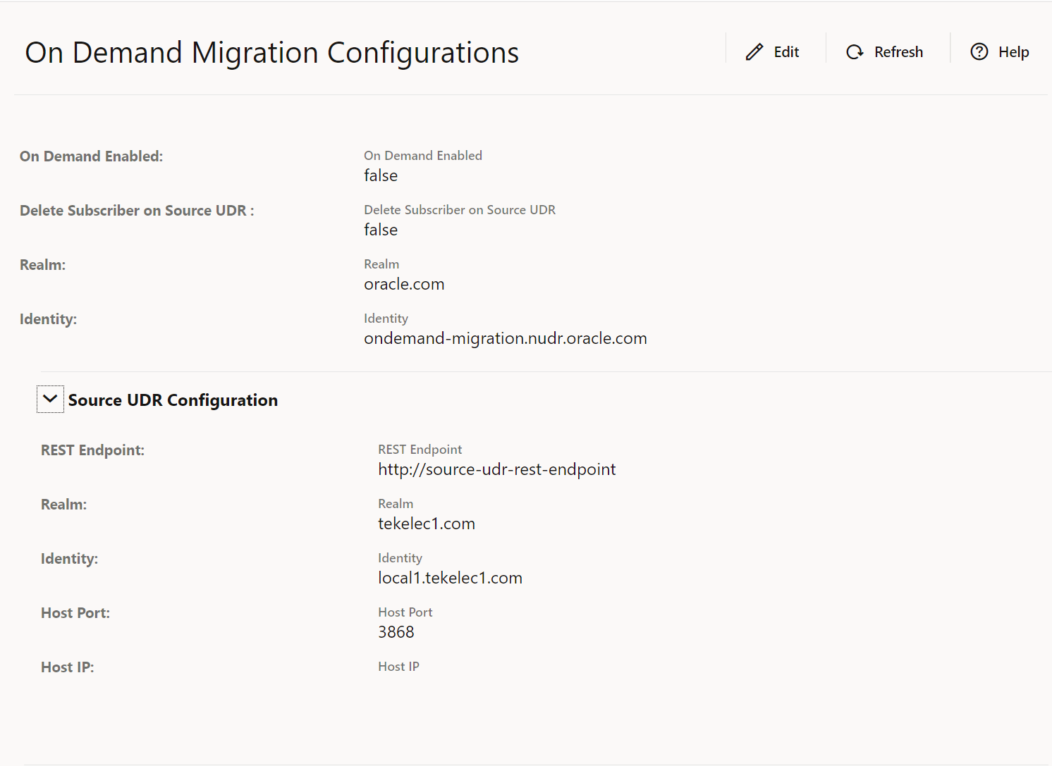

3.13.7 On Demand Migration
Click UDR and then Service Configurations. From the Service Configurations menu, select On Demand Migration. The On Demand Migration page appears:
Figure 3-35 On Demand Migration Configurations
Table 3-38 On Demand Migration Configuration Parameters
| On Demand Enabled | false | Read-only | Flag to enable on-demand migration for migrating subscriber from 4G UDR |
| Delete Subscriber on Source UDR | False | Editable | Flag to delete subscriber data when it is successfully migrated from target UDR to 5G UDR |
| Realm | NA | Editable | Diameter realm of the target UDR |
| Identity | ondemand-migration.udr.oracle.com | Read-only | Diameter client identity in ondemand-migration tool |
| Source UDR Configuration: REST Endpoint |
NA | Editable | Target UDR rest endpoint for deleting subscriber when the deleteSubcriber flag is enabled |
| Realm | udr.oracle.com | Read-only | Diameter client realm in ondemand-migration tool |
| Host Port | NA | Editable | Port number of target UDR where diameter service is running |
| Host IP | NA | Editable | IP address of target UDR |
Editing On Demand Migration Configurations
- Click Edit. The On Demand Migration Configurations page appears.
- If you do not want to modify any configuration, click Cancel. You navigate back to the On Demand Migration Configurations page.
- Click Refresh to reload the On Demand Migration Configurations page.

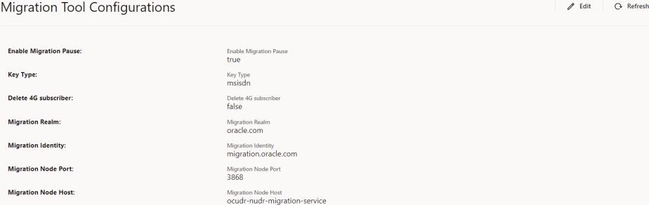

3.13.9 Migration Tool Configurations
Figure 3-37 Migration Tool Configurations
Table 3-40 Migration Tool Configurations Parameters
| Enable Migration Pause | If it is set to true the migration process is
temporarily paused.

| Key Type | Specifies the type of key used in the migration
process. The two key types are IMSI and MSISDN.
Default Value: MSISDN Attribute: Read-only |
| Delete 4G subscriber | Boolean field that determines whether 4G data should
be deleted.
Default Value: false Attribute: Read-only |
| Migration Realm | Represents the migration tool realm.
Default Value: oracle.com Attribute: Read-only |
| Migration Identity | Represents the migration tool identity.
Default Value: migration.oracle.com Attribute: Read-only |
| Migration Node Port | Represents the port number used for the migration
node.
Default Value: 3868 Attribute: Read-only |
| Migration Node Host | Specifies the host name or network address of the
migration node.
Default Value: ocudr-nudr-migration-service Attribute: Read-only |
Editing Migration Tool Configurations
- Click Edit. The Edit Migration Tool Configurations page appears.
- If you do not want to modify any configuration, click Cancel. You can navigate back to the Migration Tool Configurations page.
- Click Refresh to reload the Migration Tool Configurations page.

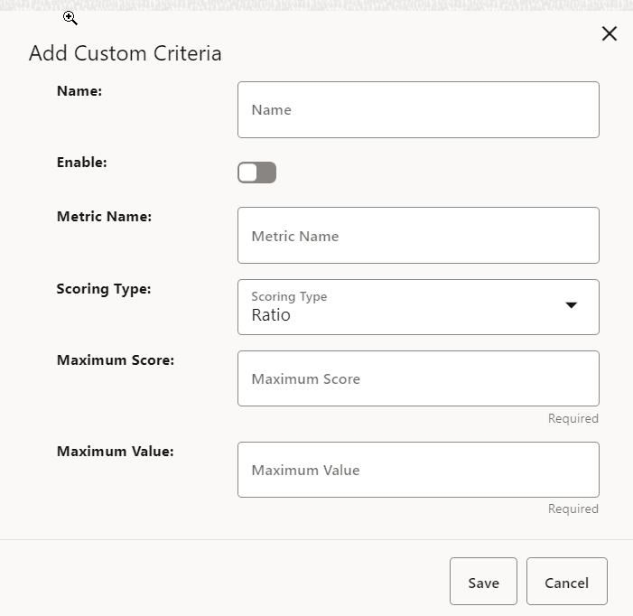

- Click Edit. The Edit Settings page appears.
- To add the Custom Criteria, click Add.
- The Add Custom Criteria dialog box appears.
Fill in the required details and click Save to add the custom criteria.
If the scoring type is selected as weightage then maximum score and minimum score fields are disabled. - Click Cancel to exit the Add Custom Criteria dialog box.
- Update the configuration details as required in the settings page and click Save. A confirmation message, "Save successfully." appears.
- Click Refresh to reload the Settings page.

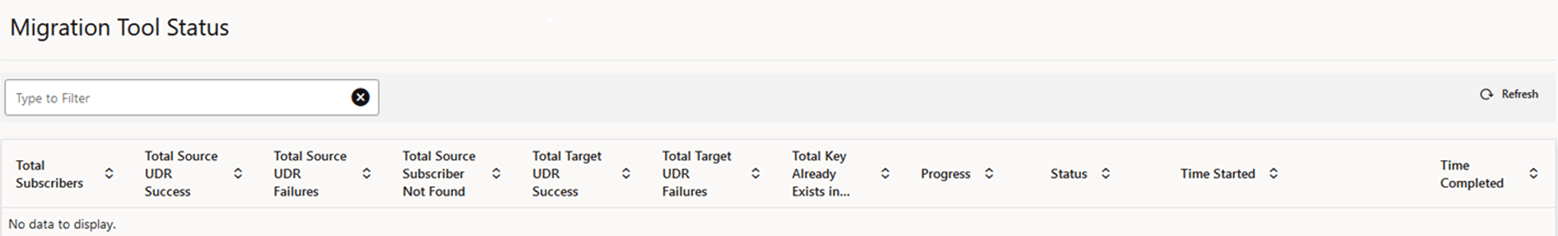

3.15 Migration Tool Status
The Migration Tool Status page is a monitoring page, which is read-only. This page allows the operator to monitor the Migration Tool Status, which initiates on running the Migration Tool. For more information, see Migration Tool.
Figure 3-39 Migration Tool Status Page
- Total Subscribers: The total number of subscribers included in the migration process.
- Total Source UDR Success: The total number of records successfully migrated from 4G UDR.
- Total Source UDR Failure: The total number of records failed during the migration from 4G UDR.
- Total Source Subscriber Not Found: The total number of subscribers not found for migration from 4G UDR.
- Total Target UDR Success: The total number of records successfully migrated to 5G UDR.
- Total Target UDR Failure: The total number of record failed during the migration in 5G UDR
- Total Key Already Exists in the Target UDR: The total number of keys that already exist in 5G UDR.
- Progress: Shows migration progress completion in percentage.
- Status: The overall status of the migration process. For example, STARTED, IN PROGRESS, PAUSED, or COMPLETED.
- Time Started: Shows the migration process start time.
- Time Completed: Shows the migration process completion time.
Using Filter option, you can filter the records you are interested in and using Refresh option, you can refresh the Subscriber Bulk Import Status page.
