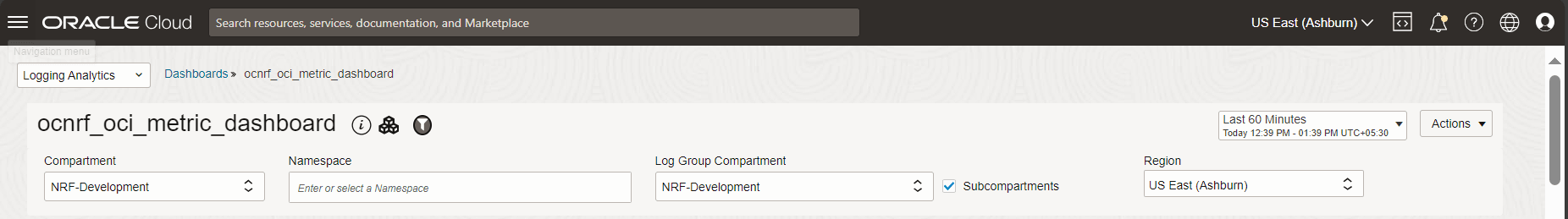

6.1.3 Configuring NRF Metrics Dashboard in OCI
This section describes the steps to upload the
ocnrf_oci_metric_dashboard_25.1.202.json
file on OCI Logging Analytics Dashboard.
As OCI doesn't support Grafana, OCI uses the Logging Analytics Dashboard Service for
visualizing the metrics and logs.
- Log in to OCI Console.
For more details about logging in to the OCI, refer to Signing In to the OCI Console. - Open the navigation menu and click Observability & Management.
- Under Logging Analytics, click Dashboards. The Dashboards page appears.
- Choose the Compartment on the left pane.
- Click Import dashboards.
- User can select and upload the
file. ##METRIC_NAMESPACE in json file must be customized to metrics namespace that the user provided while deploying OCI adaptor. - Import dashboard page appears. Click Import button on the page.
- Click filter
option in the ocnrf_oci_metric_dashboard page and select the Compartment, Namespace, Log Group Compartment, and Region from the drop-down list.
User can view the imported dashboard and can view the metrics in the dashboard.
Figure 6-1 ocnrf_oci_metric_dashboard
