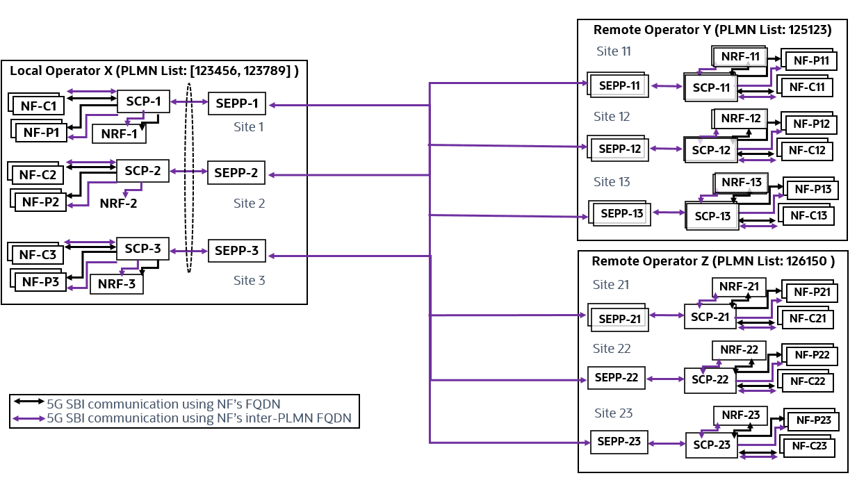

3.7 NRF Configuration Using DNS SRV Resolution
Currently, SCP supports the static configuration (helm configuration) of NRF
profiles from the custom-values.yaml
file and uses them for
registration, subscription, discovery, and audit.
With the introduction of this feature, SCP supports the configuration (RESTful) of NRF Service (SRV) FQDN at SCP. SCP uses this Domain Name System Service (DNS) SRV Resource record, known as Service Proto Name (SPN), to query the DNS server to locate the actual target NRF FQDNS (DNS SRV NRF FQDN). Thus, the user can configure primary (mandatory), secondary, and tertiary NRFs based on their priority and weights from different regions in the DNS server against a NRF SRV FQDN.
During migration, SCP deregisters and unsubscribes from static NRFs to update the NRF details stored statically at SCP with DNS SRV NRFs. Hence, it creates new rules for DNS SRV NRFs and deletes old static NRF rules. SCP instructs Audit microservice to perform an on-demand audit. The user can configure the DNS SRV and update all the data in the database for subscription, registration, discovery, and audit services. Configuration of different NRF SRV FQDN's with duplicate nfsetIds is not allowed. SCP allows users to configure multiple nfsetIDs, provided they are unique, but SCP will support only the 0th nfsetID.
- The NF set ID should match
- NF service counts should match, and NF service FQDNs should also match
Hence, if the LCI comes from NRF against a different nfinstanceID, SCP will ignore the received LCI header as unknown.
isInterPLMNfqdn
to true will enable InterPLMN request
routing coming from a foreign PLMN to SUT SCP. SCP will be able to perform intra-PLMN
routing to local NRFs based on the interplmnFQDN. If isInterPLMNfqdn
is
set to false, the above-mentioned routing will not be performed if the Inter-PLMN
request for Intra-PLMN routing is received with only 3gpp-Sbi-Target-apiRoot and no
additional information, such as a routing binding header.
SCP never performs InterPLMN routing through SEPP for NRF as a destination, which is learned through DNSSRV.Note:

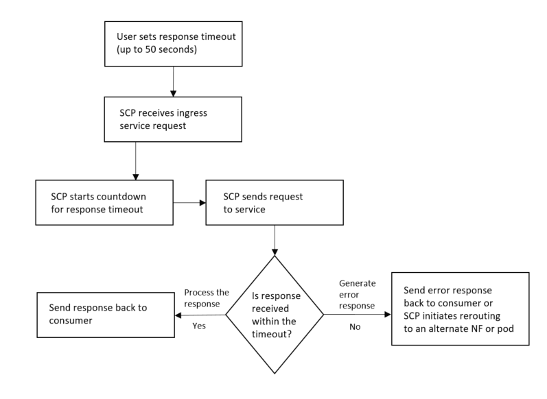

3.9 SCP Response Timeout Extension
Previously, users could configure a response timeout interval of up to 15 seconds for receiving a response from SCP.
The SCP Response Timeout Extension feature enhances the SCP's capability to manage network requests more effectively, ensuring consistent service even when Producer NFs require additional processing time.
The enhanced feature allows users to extend the maximum response timeout to 50 seconds. This improvement provides configuration options to handle response timeouts for NFs that require more time to serve a request.
The SCP allows users to configure a maximum timeout of up to 50 seconds for receiving responses from the Producer NF. If the response is not received within this timeframe, the SCP will automatically initiate rerouting to an available alternate NF or pod.
The SCP monitors the total forwarded request rate, specifically targeting requests with response times exceeding 50 seconds. The SCP supports up to 200 messages per second (MPS) for all NF Service-Based Interface (SBI) traffic through the Namf interface. An alert is raised when the traffic exceeds 200 MPS and the response delay from the Producer NF takes more than 50 seconds.
Call Flow
Figure 3-2 Call Flow for SCP Response Timeout Extension
- The user sets the response timeout with a maximum limit of up to 50 seconds for a service.
- SCP receives the ingress service request for the same service and starts the countdown for the response timeout before sending the request out.
- SCP checks if the response is received within the timeout
period:
- If the response is received within the timeout, SCP will process the response and send it back to the Consumer NF.
- If not, SCP will generate its own error response and send it back to the Consumer NF.
- If SCP receives more than 200 responses with a response time of 50 seconds or greater from the Producer NF, SCP will generate an alert.

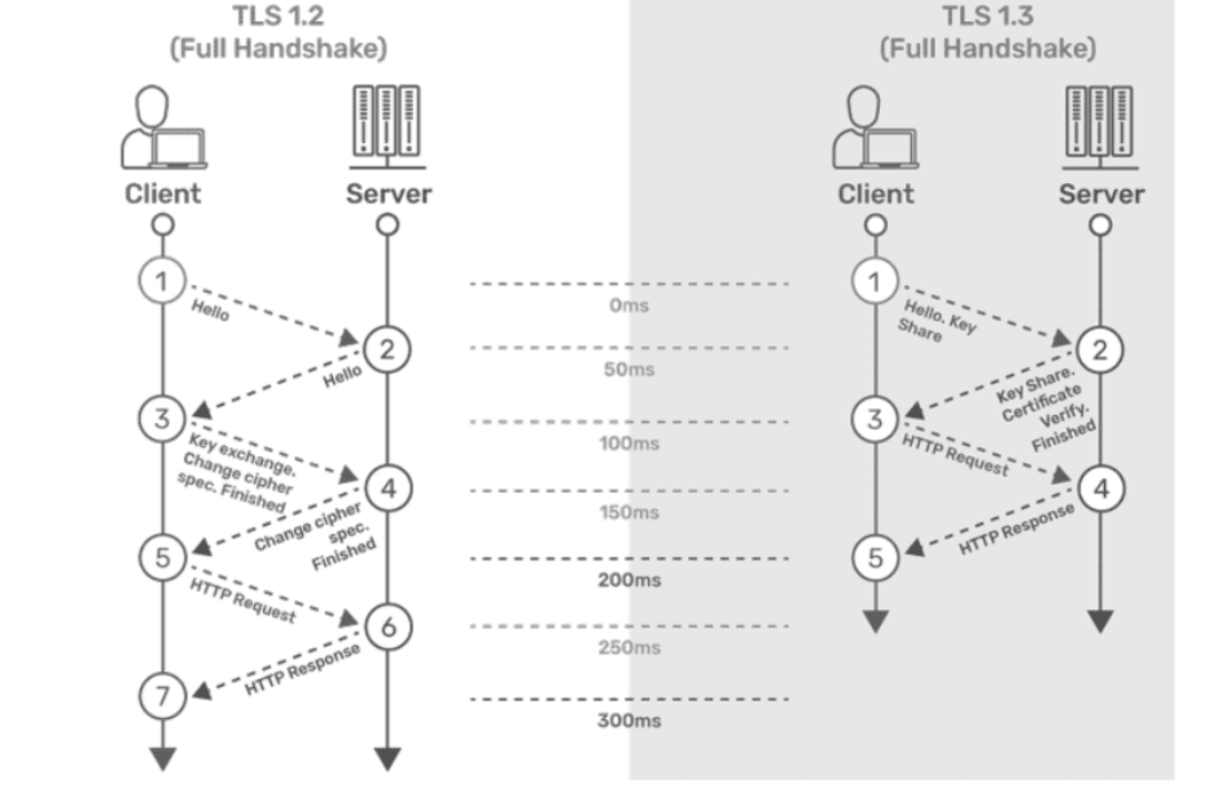

3.11 Support for HTTPS
Hypertext Transfer Protocol Secure (HTTPS) is an extension of Hypertext Transfer Protocol (HTTP). HTTPS establishes a secure connection between Network Functions (NFs) in a 5G network and uses Transport Layer Security (TLS) to encrypt the communication protocols.
With the support of HTTPS connections, SCP accepts secured ingress connection requests from a consumer NF and establishes a secured egress connection with a producer NF. HTTPS provides confidentiality and integrity protection to 5G Service Based Interface (SBI) messages.
SCP processes 5G SBI messages over HTTPS connection based on the
sbiProxySslConfigurations
parameter configuration as specified
in the custom-values.yaml
file. For more information, see Oracle Communications Cloud Native Core, Service Communication Proxy
Installation, Upgrade, and Fault Recovery Guide. The
configuration authorizes both ingress
and egress connections from consumer NFs and producer NFs, respectively with
SCP.
SCP supports a single and multiple TLS certificates to enable HTTPS as described in TLS Certificate Configuration Enhancement. SCP supports two-way TLS authentication for HTTPS connections and accesses Certificate Authority (CA) from Kubernetes secret.
- This feature supports HTTPS for inter-NF communication but not intra-NF communication, that is, communication between two microservices within SCP.
- SCP supports both HTTP and HTTPS concurrently. You can select to expose service IP for HTTP, HTTPS, or both.
- This feature supports TLSv1.2 and TLSv1.3.

3.11.2 Support for TLS
SCP uses Hypertext Transfer Protocol Secure (HTTPS) to establish secure connections with consumer NFs and producer NFs, respectively. These communication protocols are encrypted using Transport Layer Security (TLS).
TLS comprises the following components:
- Handshake Protocol: Exchanges the security parameters of a connection. Handshake messages are supplied to the TLS record layer.
- Record Protocol: Receives the messages to be transmitted, fragments the data into multiple blocks, secures the records, and then transmits the result. Received data is delivered to consumer NFs and producer NFs.
This feature enables the support for TLS 1.3 to all consumer NFs, producer NFs, the Data Director, SBI Interfaces, and any interfaces previously supporting TLS 1.2. Support for TLS 1.2 will remain available.
TLS 1.2 and TLS 1.3 Handshake
Figure 3-3 TLS 1.2 and TLS 1.3 Handshake
Step 1: The connection or handshake starts when the client sends a "client hello" message to the server. This message consists of cryptographic information such as supported protocols and cipher suites. It also contains a random value or random byte string.
Step 2: To respond to the "client hello" message, the server sends a 'server hello' message. This message contains the CipherSuite that the server has selected from the options provided by the client. The server also sends its certificate, along with the session ID and another random value.
Step 3: The client verifies the certificate sent by the server. When the verification is complete, it sends a byte string encrypted using the public key of the server's certificate.
Step 4: When the server receives the secret, both the client and server generate a master key along with session keys (ephemeral keys). These session keys are used for symmetrically encrypting the data.
Step 5: The client sends an "HTTP Request" message to the server to enable the server to transition to symmetric encryption using the session keys.
Step 6: To respond to the client’s "HTTP Request" message, the server does the same and switches its security state to symmetric encryption. The server concludes the handshake by sending an HTTP response.
Step 7: The client-server handshake is completed in two round trips.
TLS 1.3Step 1: The connection or handshake begins when the client sends a "client hello" message to the server, which includes the list of supported cipher suites and the client's key share for the specific key agreement protocol.
Step 2: To respond to the "client hello" message, the server sends the key agreement protocol that it has chosen. The "Server Hello" message includes the server key share, server certificate, and the "Server Finished" message.
Step 3: The client verifies the server certificate, generates keys since it has the server's key share, and then sends the "Client Finished" message along with an HTTP request.
Step 4: The server completes the handshake by sending an HTTP response.
Comparison Between TLS 1.3 and TLS 1.2
Table 3-15 Comparison of TLS 1.3 and TLS 1.2
Feature | TLS 1.3 | TLS 1.2 |
TLS Handshake |
Cipher Suites and Privacy |
Round-Trip Time | Efficient session resumption modes, such as
Zero Round Trip Time (0-RTT), enable clients to resume sessions
without additional round trips.
Data can be transmitted in the initial message using Pre-Shared Keys (PSK), further enhancing the efficiency of the communication process. |
TLS 1.2 does not support a 0-RTT mode for resuming sessions with reduced round-trip time. |
Perfect Forward Secrecy (PFS) | TLS 1.3 supports Provide Forward Secrecy (PFS). PFS ensures that each session key is entirely independent of long-term private keys, which are used over an extended period for decrypting encrypted data. | TLS 1.2 does not provide PFS. |
Performance | The handshake process is optimized to reduce latency by minimizing the number of required round trips, resulting in a more responsive connection. | The handshake process involves multiple round trips between the client and server, may result in increased latency and a less responsive connection. |
- The symmetric encryption algorithms are removed and Authenticated Encryption with Associated Data (AEAD) algorithms are supported.
- In TLS 1.3, all handshake messages after the ServerHello are encrypted.
- A zero round-trip time (0-RTT) mode is added in the handshake process, enabling fewer round trips compared to TLS 1.2. Additionally, it utilizes cryptographic algorithms that are faster.
- Static Rivest-Shamir-Adleman (RSA) and Diffie-Hellman cipher suites are removed, ensuring that all public-key-based key exchange mechanisms now Provide Forward Secrecy (PFS).
- TLS 1.3 has better security than TLS 1.2, addressing known vulnerabilities in the handshake process.
- TLS 1.3 eliminates data compression.
- Version Downgrade Protection in TLS 1.3 is a security mechanism that prevents attackers from using an older, potentially less secure version of the TLS protocol. This protection is achieved through the exchange of a "Finished" message between the client and server, which includes a Message Authentication Code (MAC) covering all preceding handshake messages. This mutual verification process ensures that negotiated parameters remain unaltered by potential attackers. This helps ensure that connections are established using the latest, most secure version of TLS available, reducing the risk of vulnerabilities associated with older protocol versions.
Managing Support for TLS

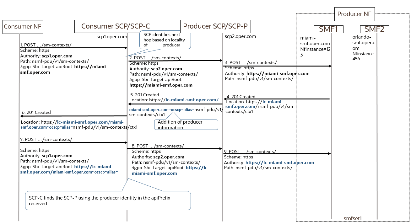

3.16 Location Header for Host Mismatch
According to 3GPP, a consumer NF is expected to use the received "Location" header content while sending subsequent message requests. After receiving a subsequent request, consumer SCP extracts the producer NF details from the API prefix in the "3gpp-Sbi-Target-Apiroot" header and selects an appropriate inter-SCP path to route the request.
SCP matches the authority (FQDN or IP) in "Location" header of the "201 Created" response with the producer's authority (FQDN or IP) where the message request was sent. If the FQDN or IP in the response is different, producer SCP provides the producer's NF details as an API prefix in the "Location" header of the "201 Created" response. If the FQDN or IP is the same, the "Location" header does not perform any modification.
This feature has been introduced to correct inter-SCP routing in the above scenario.
Figure 3-4 Initial and Subsequent Request Routing Supported at SCP
Managing Location Header for Host Mismatch

- Timeout at SCP: When the producer NF fails to reply to SCP within
the specified time as configured in the
responseTimeout
REST API parameter or if the configuredtotalTransactionLifetime
expires. - Service unavailable: When the connection is unavailable between SCP and producer NF.

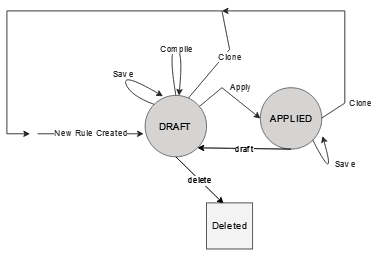

rule "RuleS1"
agenda-group "groupId1-requestIngress"
when
req : Request(headers.get("3gpp-sbi-routing-binding") == "bl=nf-set;nfset=set1.chfset.5gc.mnc012.mcc345")
then
req.variable.add("x-original-path",req.headers.get("x-original-path"))
req.variable.add("x-original-scheme",req.headers.get("x-original-scheme"))
req.variable.add("x-original-method",req.headers.get("x-original-method"))
req.variable.add("x-scp-authority",req.headers.has("x-scp-authority"))
req.variable.add("x-message-type","response")
req.variable.add("authorityValue","http://chf2svc.default.svc.cluster.local:8080/USEast/nchf-convergedcharging/v1/chargingdata/"))
req.variable.add("supi",req.body.get("$.subscriberIdentifier.supi").toString())
req.variable.add("fqdn","http://chf1svc.default.svc.cluster.local:8080/USEast")
end
The following sample represents pseudo header values that can be updated and set based on the user-defined variables or any other conditions in the mediation rule:

3.27.1 Mediation Rules Configuration
Mediation rules stored in the database can be retrieved, new rules can be added, and existing rules can be modified using the CCNC GUI and RESTful API. In addition, the storage capacity has improved.
Figure 3-7 Rule Status Flow
Table 3-29 Types of State
State | Description |
Clone | To create a new rule, the values of the rule already created and stored in the database are used. This newly created rule has a name followed by a term draft. A new name must be provided as a rule. |
Compile | This state precompiles, takes the rule source, and builds an executable rule base. |
Draft | This state moves a rule from APPLIED status to DRAFT status. |
Apply | This state moves a rule from DRAFT status to APPLY status. |
Save | This state saves the changes in database. |
Table 3-30 Rule Status
Field Name | DRAFT status | Applied status |
Rule Name | Not Allowed | Not Allowed |
Format | Not Allowed | Not Allowed |
Status | Not Allowed | Not Allowed |
Mediation Mode | Allowed | Allowed |
Code | Allowed | Not Allowed |
State | Allowed | Allowed |
The Rule Name must be unique. The status of a rule can be DRAFT or APPLIED. Only DRAFT status can be deleted, edited, or viewed.This section describes APIs that are used to define Mediation rules.

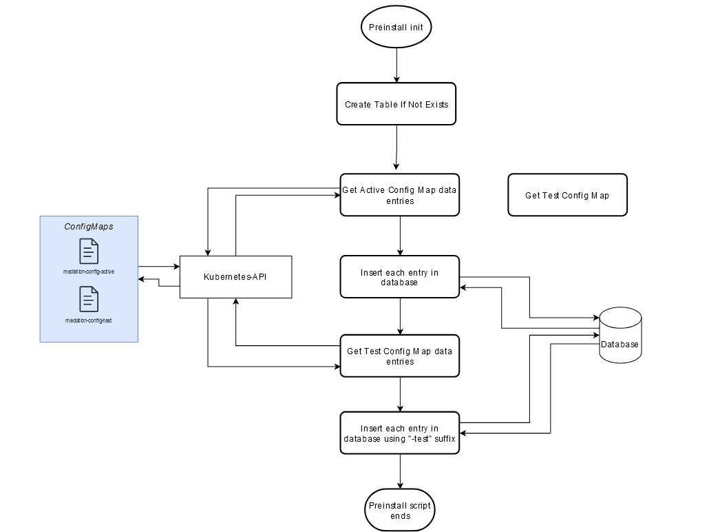

3.27.1.1 Mediation Rule Migration Process
Previously, rules were used from the Kubernetes config map. Currently, the rules present in the config map are migrated to the database table (mediation_rule table).
This section describes the procedure to execute the migration of rules from the existing config-map based implementation into the new REST API.
- ocscp-nf-mediation-config-boot: It contains all the configuration related to the spring boot application and is used in both modes (test and active).
- ocscp-nf-mediation-config-active: It contains rule entries and is only applicable to active mode.
- ocscp-nf-mediation-config-test: It contains rule entries and is only applicable to test mode.
- The following image illustrates the migration process:
Figure 3-8 Migration to Database table
To successfully migrate to database table, all the rules in the Config map must be valid.
Generate Rule Entries
- Read ocscp-nf-mediation-config-active configuration map.
- For each entry in key-value map structure, create entry in Rule table with the
following:
- Rule.name: entry.key removing .drl extension
- Rule.code: entry.value
- Rule.status: APPLIED
- Rule.mode: MEDIATION_ACTIVE
- Read ocscp-nf-mediation-config-test configuration map.
- Create entry in Rule table with the following:
- Rule.name: entry.key removing .drl extension adding "-test" as sufix to avoid name conflicts with active configmap
- Rule.mode: MEDIATION_TEST
Migration of Rule Entries
