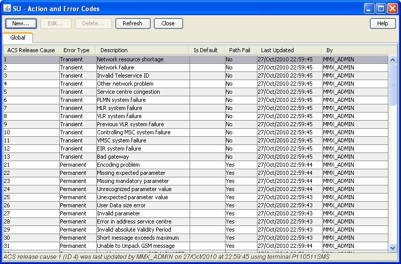

Global Action and Error Codes
The Global tab displays the global list of action and error codes which define ACS Release Cause values and corresponding error types which may be mapped to protocol-specific error codes.
Topics:
Global tab
Here is an example Global tab.
Global fields
This table describes the content of each editable column.
| Field | Description |
| ACS Release Cause |
The release cause value posted to Messaging Manager by ACS. Note: The maximum allowed value is 118. Higher values are internal system defaults that cannot be changed. |
| Error Type | The type of error this cause number represents. Values are Permanent, Transient, Abort. |
| Description | What the error cause number represents. |
| Is Default |
Indicates if the cause is the default for the Reject, Discard, or Accept actions. Note: You are able to modify only the default Reject action. The other actions are predefined. |
| Path Fail |
Whether or not the error code causes a bypass of retires on the current path. The default for:

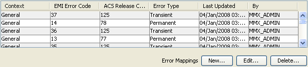

EMI
The EMI tab defines, for this protocol, the:
Error codes returned to the caller for each ACS release cause
ACS release cause for each error code
Topics:
EMI fields
This table describes the content of each column.
| Context | The circumstances in which this mapping will be applied. |
| EMI Error Code |
The error code to map against the ACS release cause. Note: Must be a unique release code for this protocol. |
| ACS Release Cause |
The release cause number used by Messaging Manager to pass back to ACS. Note: This is defined on the Global tab. |
| Error Type |
The type of error the ACS release cause number represents. Note: This is defined on the Global tab. |

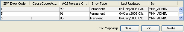

MAP
The MAP tab defines, for this protocol, the:
Topics:
MAP fields
| GSM Error Code |
The GSM MAP error code to map against the ACS release cause. Note: Must be a unique release code for this protocol. |
| CauseCode/Access Denied Reason | The cause value for an SM Delivery Failure. |
| ACS Release Cause |
| Error Type |

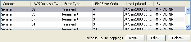

Adding release cause mapping - IP
Adding release cause mapping - MAP, IS-41
Editing release cause mapping - IP
In this example the SMPP protocol has been used. Apart from the different error code names, the add procedure is identical for the following protocols:
SMPP
EMI
SIP
Follow these steps to add a release mapping to a protocol.
From the Action and Error Codes screen, click the required protocol tab to add the release mapping to.
Result: The Protocol tab shows all the release cause and error mappings currently defined for the protocol. The top table on the tab displays the release cause mappings.
To the right of Release Cause Mappings label at the top of the release cause mappings panel, click New....
Result: The New Release Cause Mapping screen opens.
Note: The New Release Cause Mapping screen for the EMI protocol also has a Context field not shown in this screen shot. For more information, see EMI fields.
If you are creating an EMI release cause mapping, enter a context into the Context field.
From the ACS Release Cause drop down list, select the global release cause number to map with.
Result: The error type and description of the release cause are displayed below the fields. For more information about how to configure what text displays here, see Global fields.
Description of the illustration mmxnewreleasecausemappingsmppcrop_4-1-1.jpg -
Enter the protocol error code to map to in the bottom field. The name of the field varies according to the protocol:
Protocol Field name More information SMPP SMPP command status See SMPP fields. EMI EMI error code See EMI fields. SIP SIP Status See SIP fields. Note: Must be a unique release code for this protocol.
Click Save to save the new release cause mapping record in the configuration database.
Related topic

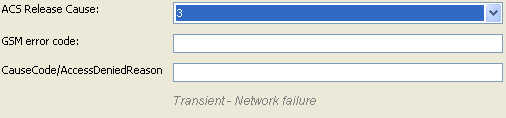

In this example the MAP protocol has been used. Apart from the different error code names, the add procedure is identical for the following protocols:
MAP
IS-41
Description of the illustration mmxactionerrorcodesmap_rel_cause_ex_4-0.jpg -
To the right of Release Cause Mappings, click New.
Select the global release cause number to map with from the ACS Release Cause drop down list.
Result: The error type and description of the release cause are displayed below the fields. Refer to Global fields.
Description of the illustration mmxnewreleasecausemappingmapex_3-2.jpg -
Enter the protocol error codes to map to in the bottom fields. The names of the fields vary according to the protocol:
MAP - see MAP fields.
IS-41 - see IS-41 fields.
Click Save to save the cause mapping record in the configuration database.

In this example the EMI protocol has been used. The delete release mapping procedure is identical for all protocols.
Follow these steps to delete a release mapping from a protocol.
From the Action and Error Codes screen, click the required protocol tab to delete the release cause mapping from.
Result: The Protocol tab shows all the release cause and error code mappings currently defined for the protocol. The top table on the tab displays the release cause mappings.
Description of the illustration mmxactionerrorcodesemireleasecausemappingsex_4-0.jpg -
In the Release Cause Mappings table on the tab, select the record to delete.
To the right of Release Cause Mappings, click Delete.
Result: The Delete Release Cause Mapping 'Cause_Number' screen opens.
Click Delete to delete the record from the configuration database.
Note: This does not delete the error code, just the release mapping.

Adding error mapping - MAP, IS-41
MAP
IS-41
Follow these steps to add an error mapping to a protocol.
Result: The Protocol tab shows all the release cause and error mappings currently defined for the protocol. The bottom table on the tab displays the error mappings.
Description of the illustration mmxactionerrorcodesmap_error_ex_4-0.jpg -
To the right of Error Mappings, click New.
Result: The New Error Mapping screen opens.
Enter the protocol error codes to map to in the top two fields. The names of the fields vary according to the protocol:
Select the global release cause to map to from the ACS Release Cause drop down list.
Result: The error type and description of the release cause are displayed below the field. Refer to Global fields.
Description of the illustration mmxnewerrormappingexreleasecause_3-2.jpg -
Click Save to save the error mapping record in the configuration database.
Related topic

In this example the EMI protocol has been used. Apart from the different error code names, the edit procedure is identical for the following protocols:
SMPP
EMI
SIP
Follow these steps to edit a release mapping for a protocol.
From the Action and Error Codes screen, click the required <protocol> tab to edit the release mapping for.
Description of the illustration mmxactionerrorcodesemi_error_ex_4-0.jpg -
In the Error Mappings table on the tab, select the record to edit.
To the right of Error Mappings, click Edit.
Result: The Edit Error Mapping screen opens.
Note: The name of the field varies according to the protocol:
Protocol Field name More information SMPP SMPP command status See SMPP fields. EMI EMI error code See EMI fields. SIP SIP Status See SIP fields. -
Change the ACS Release Cause, if required.
Related topic

In this example the EMI protocol has been used. The delete error mapping procedure is identical for all protocols.
Follow these steps to delete an error mapping from a protocol.
Result: The Protocol tab shows all the release cause and error code mappings currently defined for the protocol. The bottom table on the tab displays the error mappings
In the Error Mappings table on the tab, select the record to delete.
To the right of Error Mappings, click Delete.
Result: The Delete Error Mapping 'Cause_Number' screen opens.\
Note: This does not delete the error code, just the error mapping.
Related topic
