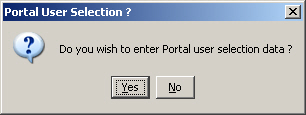

Result: You see the following dialog box.
Description of the illustration ussdgportaluserselection_2-4-0.jpg -
The UPC package must be loaded to create menus for the User Selection nodes. If the UPC package is loaded, you can enter Portal Selection data.
To continue, click Yes.
Result: You see the Step 4 screen.
Note: This branch-keyword mapping table is the same as the one accessed on the User Selection screen.
Otherwise, click No to go to the Final Step screen.

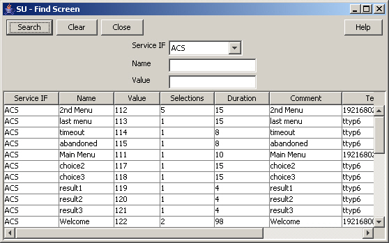

Find Screen - Menu Info tab
Here is an example Find Screen for the Menu Info tab.
Related topic
Using the find screen - Menu Info tab
You can search on:
Service IF
Name
Value
For more information about searching and editing records, see Using the Find Screens.

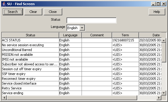

Find Screen - Status Info tab
Here is an example Find Screen for the Status Info tab.
Related topic
Using the find screen - Status Info tab
You can search on:
Service IF
Name
Value

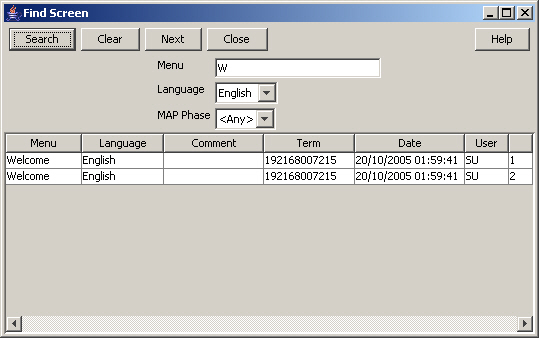

Find Screen - Menu Language tab
Here is an example Find Screen for the Menu Language tab.
Related topic
Using the find screen - Menu Language tab
You can search on:
Menu
Language
MAP Phase
Status Language Display
The Status Language tab allows you to set language specific status text for a given status.

Find Screen - Status Language tab
Here is an example Find Screen for the Status Language tab.
Related topic
Using the find screen - Status Language tab
You can search on:
Status
Language
