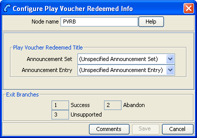

Configuration screen
Here is an example Configure Play Voucher Redeemed Info node screen.
This is image alt text.
Configuration fields
This table describes the function of each field in the Configure Play Voucher Redeemed Info screen.
Field Description
Announcement Set List of all the available announcement sets.
Announcement Entry List of all the announcements belonging to the selected announcement set.
Note: You can set the node to use the system currency using the PAVRBalancesUseSystemCurrency parameter. For more information, see CCS Technical Guide.
Configuring the node
Follow these steps to configure the node.
Step Action
1
Use the drop down lists to select the pre-recorded announcements that are to be played as prompts to the caller.
Select the specific Announcement Set to which the Announcement Entry belongs. Only valid announcements are available from the lists.
2
Click Save.
Note: This will be greyed out until all the announcement sets have been selected.

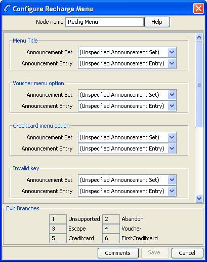

Here is an example Configure Recharge Menu node screen.
This table describes the function of each field in the Configure Recharge Menu node screen.
Field Description
Step Action
1
For each relevant announcement, use the drop down lists to select the pre-recorded announcements that are to be played as prompts to the caller.
2
Click Save.

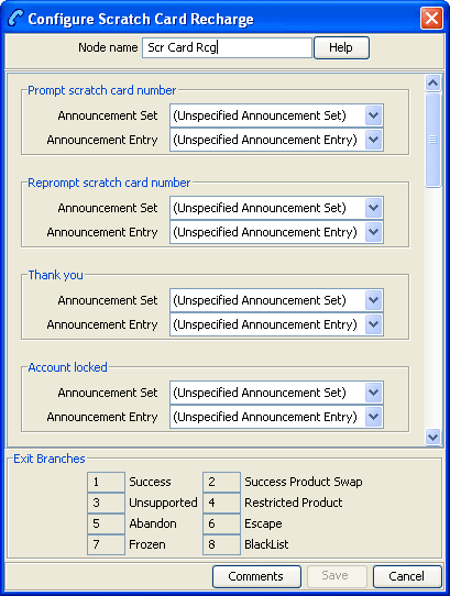

Here is an example Configure Scratch Card Recharge node screen.
This table describes the function of each field in the Configure Scratch Card Recharge node screen.
Field Description

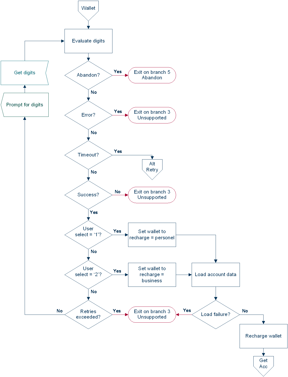

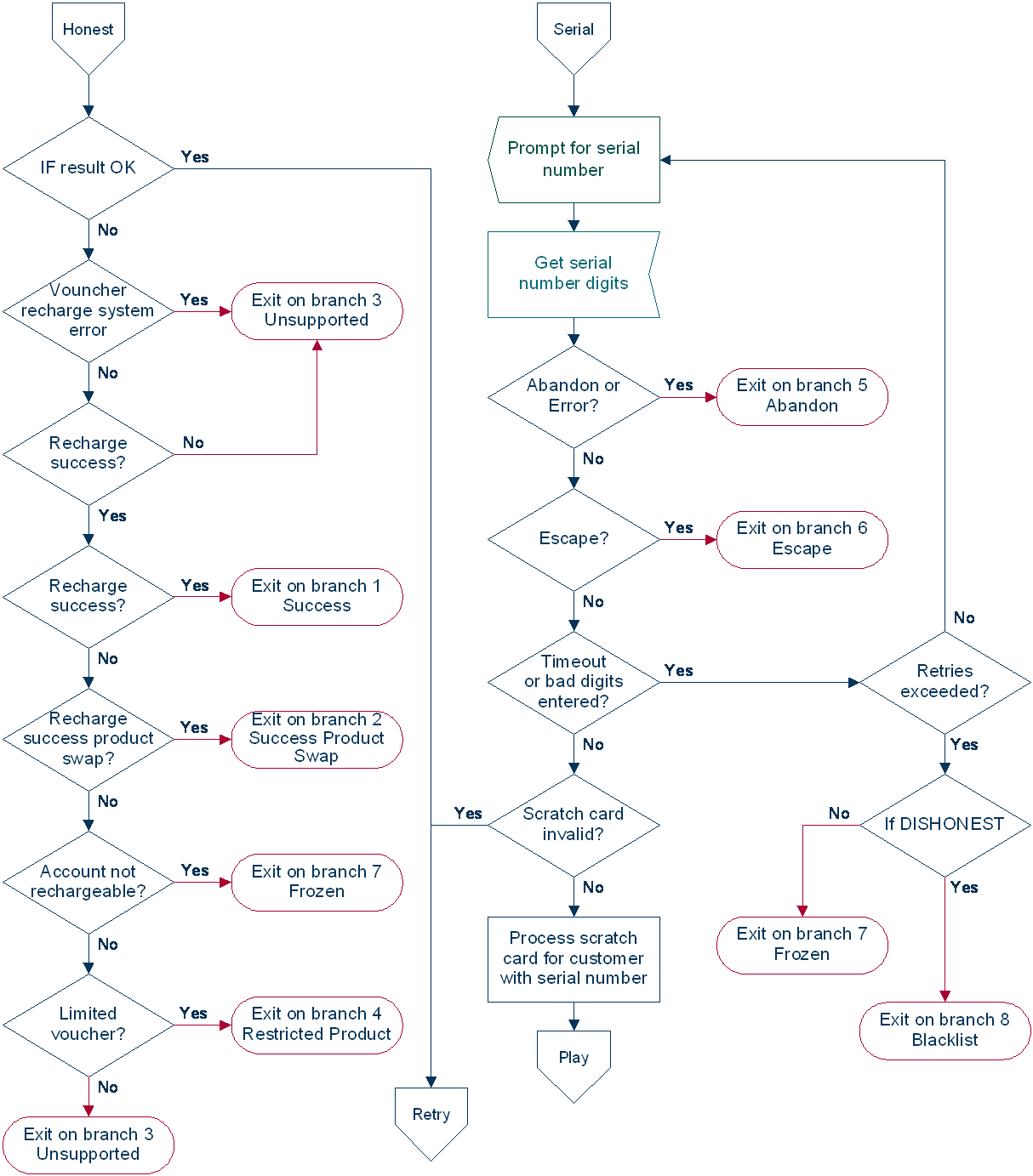

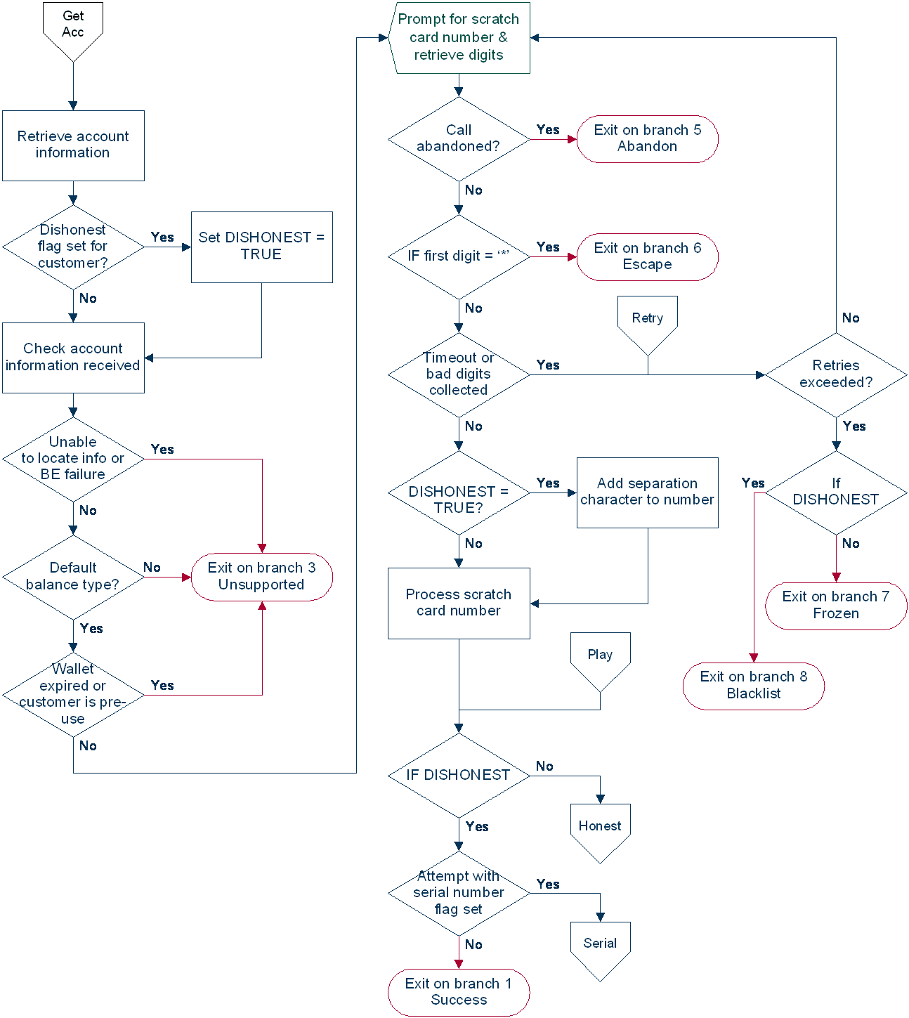

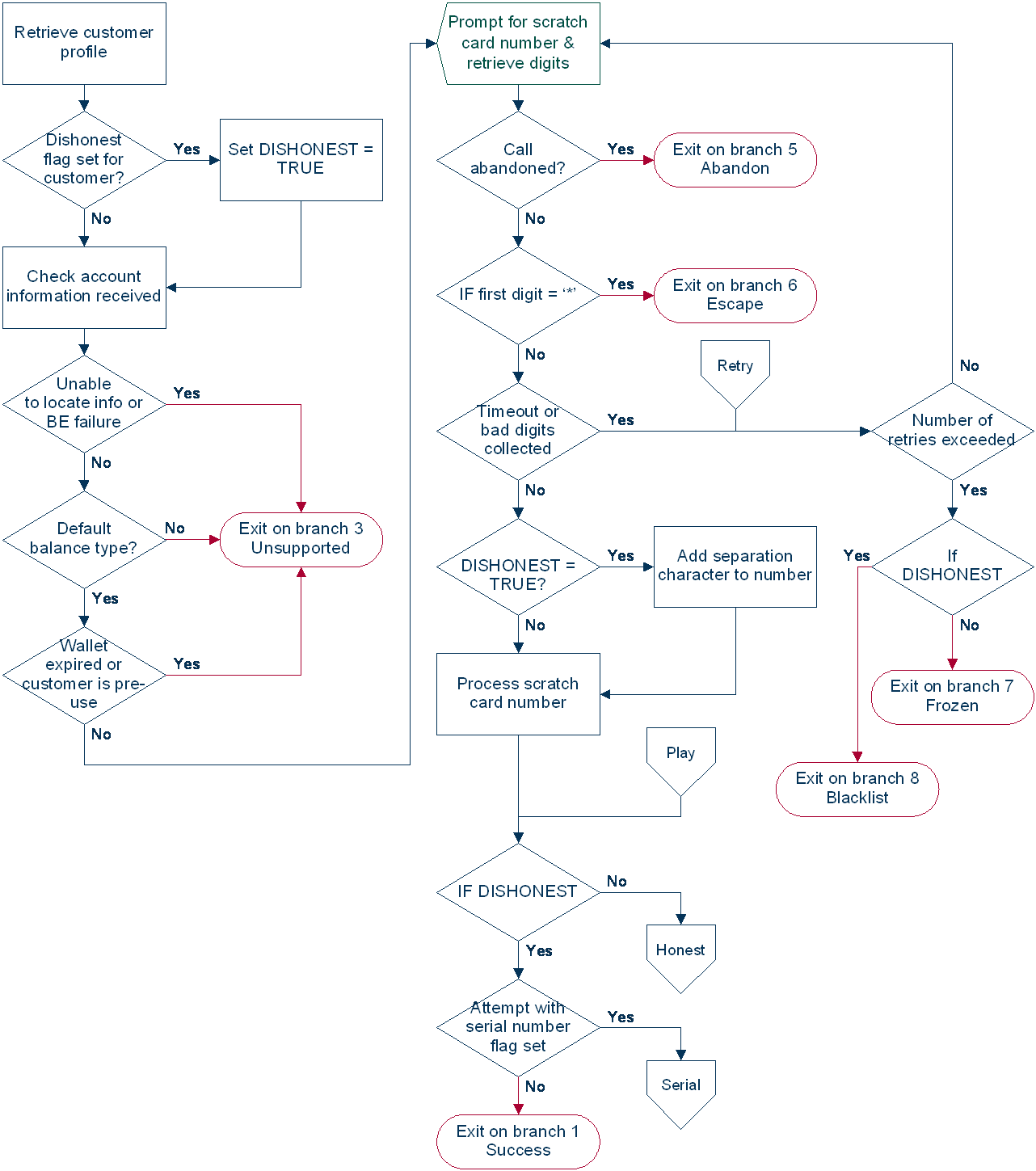

Node logic
This diagram shows the internal logic processing of the node.
Figure 6-1 Node logic
alt text
Figure 6-2 Node logic
alt text

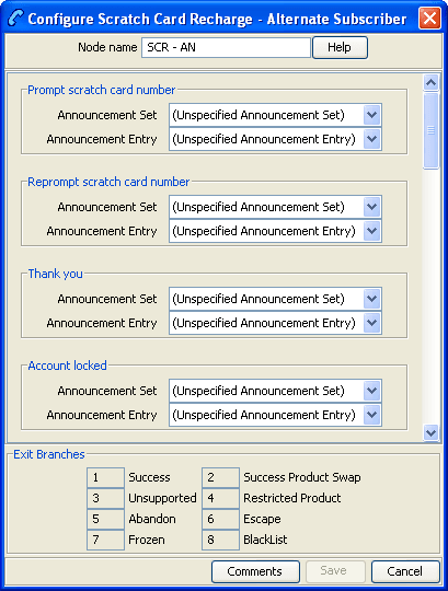

Scratch Card Recharge Alternate Subscriber
Warning: This feature node has now been deprecated and should no longer be used. This feature node will still function in existing control plans.
Node description
The Scratch Card Recharge Alternative Subscriber node enables a caller to use a scratch card to recharge another user's account, and to change the product type if required.
The caller is prompted to enter the MSISDN of the account, and re-enter for confirmation, that they wish to recharge. They are then prompted to enter the scratch card number. The caller has three attempts to enter a valid scratch card number.
Note: If the Set Wallet Type feature node is used prior to the Scratch Card Recharge - Alternate Subscriber node, then the product type of the alternative wallet is changed when the voucher is redeemed.
Node description
If the caller:
  • Does not enter a valid scratch card number at any attempt (and is not already Blacklisted), then they are set to Blacklisted and exited down the Blacklist branch.
  • Has been blacklisted, they will also be required to enter the serial number of the scratch card (voucher). The caller has three attempts to enter a valid serial number.
  • Is blacklisted and does not enter a valid scratch card number and serial number during any attempt they are then exited down the Failure branch.
  • Enters a valid scratch card number and serial number, then the voucher is redeemed.
When the voucher is redeemed, the product type may also be changed if the rules defined for product type changes are met. The product type is only changed if:
  • the 'from' and 'to' product types are current product types for the account's service provider,
  • the default wallet for the account is using one of the 'from' product types, and
  • the 'to' product type is listed in the swap configuration for the 'from' product type.
A successful product type change is replicated back through the SMP.
Note: When a voucher recharge attempt is made, the voucher's redeemed date is set to the current system date and time. The redeemed field for the voucher is set to one of:
  • True for successful attempts
  • False for unsuccessful attempts
This allows you to check if a voucher has been redeemed, or if a failed redeem attempt has been made.
Node icon
If the CPE has been configured to use the static panel CPE palette style, the CPE displays the icon shown below to represent the feature node.
Restrictions
This node may be used any number of times within a control plan.
This node deals only with the wallet type currently set in the call context. If a different wallet is required, a Set Wallet Type node must be invoked before this node.
For more information, see Set Wallet Type.
Warning: This feature node is unusable when the account details are held on a BRM. That is, when the charging domain of the subscriber is of type BCD. See Charging Control Services User's Guide for further details on charging domains.
Node exits
This node has one entry and eight exits. The number of exits cannot be changed.
Exit Cause Description
1 Success The caller has successfully recharged the voucher and exited the node, but a product type swap, if requested, was unsuccessful.
Here is an example Configure Scratch Card Recharge - Alternative Subscriber node screen.
This table describes the function of each field in the Configure Scratch Card Recharge - Alternate Subscriber node screen.
Field Description
Step Action
1
2
Click Save.
Node logic
Figure 6-3 Node logic
alt text
Figure 6-4 Node logic
alt text
Figure 6-5 Node logic
alt text
Figure 6-6 Node logic
alt text
Figure 6-7 Node logic
alt text

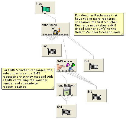

Select Voucher Scenario
Node description
The Select Voucher Scenario node enables a subscriber to select from amongst the different ways the voucher can be redeemed, by choosing a particular scenario.
Note: It is possible for a scenario to increment a balance or extend the expiry date for the balance, or both. In addition, a scenario may also possibly change the overall account expiry date.
Node icon
Restrictions
A control plan may contain as many Select Voucher Scenario nodes as required.
To work correctly, this node must be placed between two Voucher Recharge nodes in a working control plan.
Node exits
This node has one entry and five exits. The number of exits cannot be changed.
1 Success A scenario has been selected by the subscriber.
2 Failure
Any of a number of failures, for example:
  • Profile that should have contained the scenario list is missing or empty
  • Subscriber pressed escape
3 Unsupported An unknown response was received from Voucher Management.
4 Abandon The caller has disconnected the call before completing the scenario selection.
5 Timeout The subscriber failed to respond within the configured timeout period

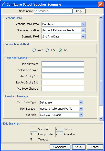

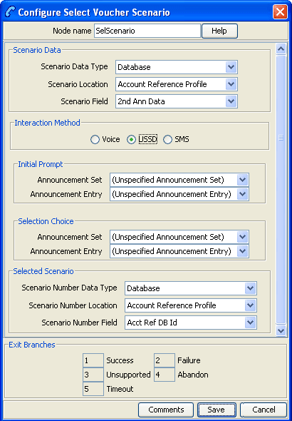

Here is an example Configure Select Voucher Scenario screen showing the fields for an SMS interaction.
Here is an example Configure Select Voucher Scenario screen, showing the fields for a Voice or USSD interaction.
The configuration fields are used to establish the variable part message/announcement that the subscriber receives.
Review the examples before proceeding with the node configuration.
Follow these steps to configure the node configuration.
Step Action
1
Select the Scenario Data from the Data Type, Location and Field drop down lists.
Note: This where the valid scenarios are located.
2
Select the Interaction Method to use with the subscriber.
Either of:
  • Voice
  • USSD, or
  • SMS
Result: The lists and fields for the selected option are made available.
3 Follow the relevant instructions for the method selected.
Voice or USSD
Voice or USSD method
4
Select the announcement from each of the announcement Set and Entry drop down lists:
  • Initial Prompt: Select the first message.
  • Selection Choice: Select the scenario selection choices message.
  • Balance Expiry Ext: Select the balance expiry will be extended message.
  • No Bal Expiry Ext: Select the balance expiry will not be extended message.
  • Account Expiry Ext: Select the account expiry will be extended message.
  • No Account Exp Ext: Select the account expiry will not be extended message.
  • Account Type Change: Select the account type will be changed message.
  • Final Prompt: Select the last message to the subscriber.
5
Select the Selected Scenario profile from the Data Type, Location and Field drop down lists.
Note: This is where the scenario number to use for the voucher redemption will be saved.
6 Click Save.
SMS
SMS method
4
In the Text Notifications panel, enter the text fields which will be used to construct a short message to the subscriber.
Type the text for the initial prompt to the subscriber in the Initial Prompt field.
5 Type the text for the response choices available to the subscriber in the Selection Choice field.
6 Type the text for any extension on account expiry available to the subscriber in the Acc Expiry Ext field.
7 Type the text for no extension on account expiry available to the subscriber in the No Acc Expiry Ext field.
8 Type the text for any account type change available to the subscriber in the Acc Type Change field.
9
Select the Resultant Message profile from the Data Type, Location and Field drop down lists.
Note: This is where the subscriber returned SMS containing the scenario number to use will be saved.
10 Click Save.

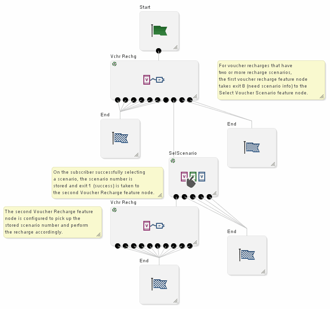

Example use of node
Voucher redeem options can be varied, for example:
  • Voucher redeems for 120 minutes of international calling (180 minutes during our “Talk-Fest July” promo special)
  • Voucher redeems for 200 short messages made within a 30 day period (300 SMS during our “Text-Fest August” promo special), or
  • Gold customers receive an additional 10% on top of their chosen option.
The potential scenarios are complex enough that CCS cannot be expected to know beforehand what scenarios apply, nor what the final values to the subscriber might be. There may be only one scenario that applies, or two, or three.
CCS requires some guidance from Voucher Management, as shown in the following example interaction for redeeming a voucher:
Step Action
1 Subscriber requests CCS to redeem a voucher for them.
2 CCS passes request to Voucher Management, indicates no particular scenario.
3 Voucher Management determines that this voucher has multiple scenarios, informing CCS that this is the case, along with some information to help prompt the subscriber.
4
For Voice/USSD interactions:
  • CCS prompts the subscriber to choose the scenario they prefer.
For SMS interactions:
  • CCS constructs a short message containing all the scenario options and sends this back to the subscriber.
5 The subscriber re-requests CCS to redeem the same voucher and includes their preferred scenario option.
6 CCS passes request to Voucher Management, this time with scenario selection information.
7 Voucher Management performs redeem and updates balance values.
8
CCS notifies subscriber of success, and announces updated balance values by using the Send Short Message Notification node.
Note: If you recharge successfully on a UBE domain which has real-time wallet notifications configured for balance changes, CCS will send a notification for the balance change as well as the notification sent from the Send Short Message Notification node. For more information about the real-time wallet notifications, see Real-Time Wallet Notifications.
Note: If there is only one scenario, then steps three to five can be skipped.

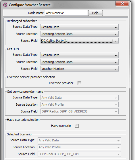

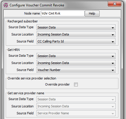

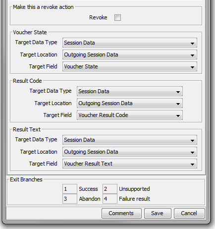

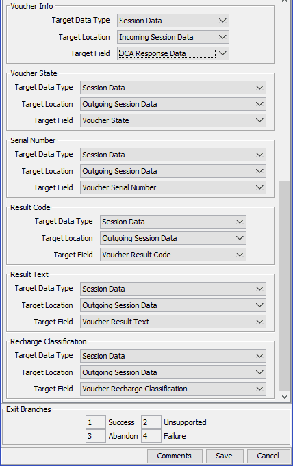

Configuration screen (top)
Here is an example top section of the Configure Voucher Commit Revoke screen.
Configuration screen (bottom)
Here is an example of the bottom section of the Configure Voucher Commit Revoke node screen.
Step Action
1 Select the source data for the recharged subscriber.
2 Select the source data for the human readable voucher number (HRN)
3 If you need to overide the service provider, check the Override provider checkbox. The result is that the next section becomes available to select the source data for the alternative service provider.
4 If this is a revoke action (rather than a commit) then check the Revoke checkbox.
5 Select the profile where the Voucher State shall get stored to.
6 Select the profile where the Voucher Result Code shall get stored to.
7 Select the profile where the Voucher Result Text shall get stored to.
8 Click Save .

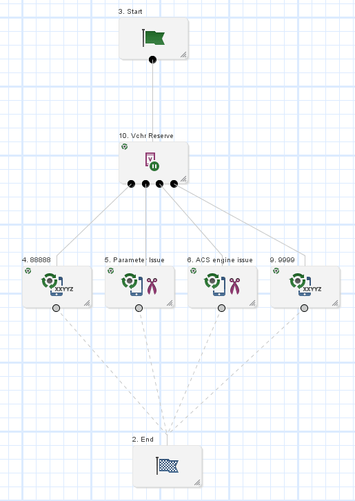

Example Control Plan
This example is used for SOAP to be able to issue a Voucher Reserve request. In this example the control plan for Voucher Commit Revoke would look the same (albeit with the node replaced). Unconditional termination nodes are used to allow the SOAP message to be generated and make use of the fields that are set in Voucher Reserve for success and for failure. Unsupported and Abandoned make use of disconnected nodes as there is no further information required for the SOAP to generate a failure message.

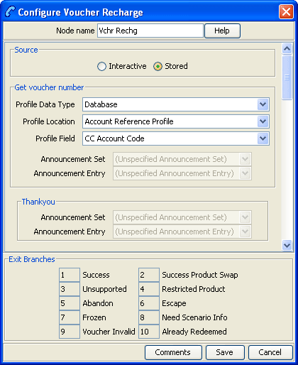

Here is an example Configure Voucher Recharge node screen (top part).
Here is an example Configure Voucher Recharge node screen (bottom part).
Step Action
1
Select the Source for the voucher recharge. Either of:
  • Interactive, or
  • Stored.
Result: The related source fields for the selected option become available.
2
Select the Get voucher number options:
  • If Interactive: Select from the announcement drop down lists the announcement to play to prompt the subscriber for the voucher number.
  • If Stored: Select from the profile Data Type, Location and Field drop down lists containing the voucher number.
3
If Interactive: Select the from the Announcement drop down lists the various announcements to play to the subscriber:
  • Thankyou announcement to play when the redeem process is concluded.
  • Account Locked announcement to play when the subscriber either is currently frozen, or has become frozen as a result of the voucher redeem.
  • Invalid Attempt - Created announcement to play when the voucher being redeemed has been created, but is not yet available for redemption.
  • Invalid Attempt - Used announcement to play when the voucher being redeemed has already been redeemed.
  • Invalid Attempt - Unavailable announcement to play when the voucher being redeemed is no longer available (i.e. has been stopped by the telco, or expired).
  • Invalid Attempt - Invalid Number announcement to play when the subscriber has provided an incorrect voucher number.
  • Maximum Iterations Reached announcement to play when the number of retries a subscriber is allowed has been reached.
  • Redeem System Error : Please try later announcement to play when the voucher redeem system is unavailable.
  • Limited Product Type Failure announcement to play when the subscriber product type is invalid for, or would become invalid due to, the voucher recharge.
Note: If Stored selected, these options are all grayed out.
4
If the voucher redeem scenario is known, tick the Have scenario selection check box.
Result: The Selected Scenario profile fields become available.
5 If available, from the Selected Scenario Data Type, Location and Field drop down lists, select the profile containing the scenario number to use for the voucher redemption.
6 From the Scenario Data Data Type, Location and Field drop down lists, select the profile containing the currently available scenarios for voucher redemption.
7
Click Save.
Note: This will be greyed out until all the required fields have been completed.
Note: The list of data types is fixed at installation time for each feature node or screen.
Further reference:
  • For information about profile blocks (data type, location, and field) and how to use them, see Profile Blocks and Tags .
  • The primary tag lists are configured in the SMS > Services > ACS Service > Configuration > Profile Tag Details and Profile Tag Mapping tabs (see ACS User's Guide, Profile Tag Details for more information).

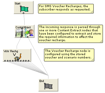

Example for SMS
Here are example control plans showing a basic method of voucher recharge when there are more than one way to redeem the voucher.
These control plans relate to SMS invoked recharge usage.
The first control plan sets up the request to the subscriber to supply the redeem scenario by a further SMS.
The second control plan uses the supplied information to extract the scenario number and then to redeem the voucher.

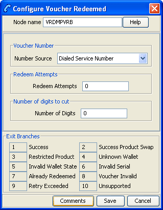

Here is an example Configure Voucher Redeemed node screen.
This table describes the function of each field in the Configure Voucher Redeemed node screen.
Field Description
Number Source The ACS number buffer containing the voucher number.
Redeem Attempts Maximum number of voucher number attempts before taking the retry exceed branch.
Number of Digits The number of digits to remove from the front of the voucher number prior to redemption.
Step Action
1 Select the ACS buffer that contains the voucher number digits from the Number Source drop down list.
2 Type the maximum number of voucher number entry retries in the Redeem Attempts field.
3 Type the number of digits to remove from the front of the voucher digits before attempting to redeem in the Number of Digits field.
4 Click Save.
Voucher Reservation
Node description
The voucher reservation process can be handled at a fine-grained level by using the Voucher Reserve node. The Voucher Reserve node takes the voucher identification information, retrieves the set of information that is required to make wallet updates, and sets aside a voucher reservation to wait for a commit or revoke action to occur. This prevents the voucher from being used again until either the commit or revoke action is received or a timeout occurs and the voucher is either indefinitely held, or committed or revoked automatically based on the configuration. A revoked voucher enables a voucher redemption to be attempted again.

Node exits
This node has one entry and four exits.
1 Success A voucher reservation has been created and the information needed to be able to credit a caller's account has been retrieved.
2 Unsupported
The voucher reserve action has not been successful for any of the following reasons:
  • Insufficient capabilities
  • Failed to validate configuration
  • Failed to set voucher balances in profile
  • Failed to store in profile
3 Abandon
  • Call processing not allowed
  • Possible interface timeout
4 Failure
The voucher reserve action has not been successful and a specific failure is identified. If the state of the voucher was able to be retrieved, then it is returned. Otherwise, the state is set to Unknown. A failure code and failure text are set.
2001 - Voucher batch state not active
2002 - Invalid voucher value
2003 - Invalid serial number
2004 - Voucher not found
2007 - Limited voucher product match
2008 - Scenario required
2009 - Voucher already redeemed
2010 - Voucher already reserved
2012 - Voucher in frozen state
2013 - Voucher in deleted state
3000 - System error
4000 - Service provider not found
4001 - Invalid voucher number length
4002 - Incorrect voucher balances tag count
4003 - Incorrect voucher balances tag type
4004 - No voucher balances
4005 - Invalid scenario number
4006 - Missing subscriber identifier
4007 - Missing voucher number
Here is an example top section of the Configure Voucher Reserve node screen.
Here is an example of the bottom section of the Configure Voucher Reserve node screen.
Step Action
1 Select the source for the recharged subscriber.
2 Select the source data for the human readable voucher number (HRN).
3
If you need to override the service provider, select the Override provider checkbox.
Result: The next section becomes available to select the source data for the alternative service provider.
4
If you need to provide a scenario number, select the Have scenario checkbox.
Result: The next section becomes available to select the source data for a scenario number.
5 Select the profile where the per balance Voucher Info shall get stored to.
6 Select the profile where the Voucher State shall get stored to.
7 Select the profile where the Voucher Serial Number shall get stored to.
8 Select the profile where the Voucher Result Code shall get stored to.
9 Select the profile where the Voucher Result Text shall get stored to.
10 Select the profile where the Voucher Recharge Classification shall get stored to.
11 Click Save.

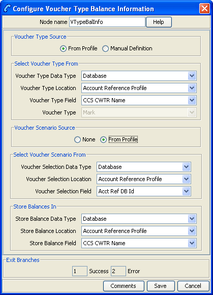

Voucher Type Balance Information
Node description
The Voucher Type Balance Information node retrieves the balances associated with a Voucher Type and stores them in a selected profile.
Node icon
Restrictions
A control plan may contain as many Voucher Type Balance Information nodes as required.
Node exits
This node has one entry and two exits. The number of exits cannot be changed.
1 Success The voucher type balance information has been successfully stored in a profile.
2 Error The voucher type could not be found or the balance information could not be extracted.
Here is an example Configure Voucher Type Balance Information screen.
This table describes the function of each field in the Configure Voucher Type Balance Information node screen.
Field Description
Voucher Type Source options
Controls what the voucher source will be. The options are:
  • From Profile
  • Manual Definition
Select Voucher Type From area
Either:
  • Specifies the profile to use when From Profile is selected, or
  • The voucher type that balance information will be retrieved for when Manual Definition is selected.
Voucher Scenario Source options
Controls what the voucher scenario source will be. The options are:
  • None
  • From Profile
Select Voucher Scenario From area
Either:
  • The default voucher scenario will be used when None is selected, or
  • Specifies the profile to use when From Profile is selected.
Store Balance In area Specifies the profile to use to store the balance information.
Note: For more information on the Voucher Type Balance Information node configuration fields see Configuration fields.
Step Action
1
In the Voucher Type Source area select either:
  • From Profile, or
  • Manual Definition.
2
Select the Voucher Type for which balance information will be retrieved. If you selected:
  • From Profile, select from the profile Data Type, Location and Field drop down lists that contains the Voucher Type you want, or
  • Manual Definition, select the voucher type from the Voucher Type drop down list.
3
In the Voucher Scenario Source area select either:
  • None, or
  • From Profile.
4 If you selected From Profile, in the Select Voucher Scenario From area, select the profile Data Type, Location and Field drop down lists that contains the Voucher Scenario you want.
5 In the Store Balances In area select the profile Data Type, Location and Field drop down lists where the balance information will be stored.

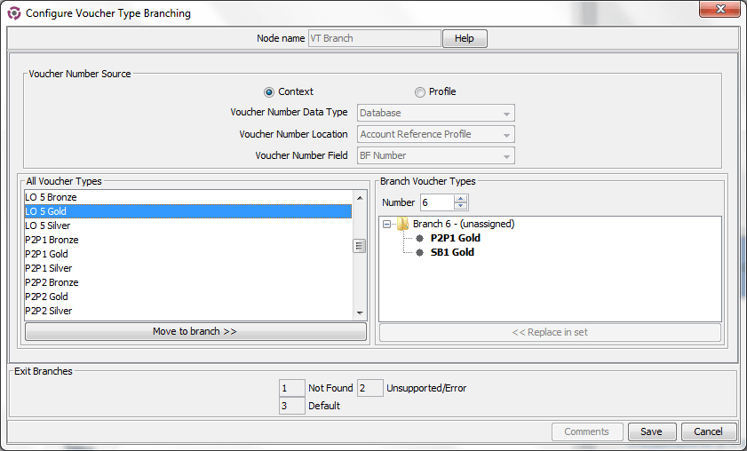

Here is an example Configure Voucher Type Branching screen.
This table describes the function of each field.
Field Description
Context Select to branch based on the voucher type of the voucher retrieved from the control plan context.
Profile Select to branch based on the voucher type of the voucher retrieved from the specified profile location.
Voucher Number Data Type Specifies the data type of the voucher number profile block.
Voucher Number Location Specifies the profile block that contains the voucher number profile field.
Voucher Number Field Specifies the profile field where the voucher number is stored. Must be a STRING, NSTRING, or LNSTRING profile field type.
All Voucher Types Lists all the voucher types defined in the Voucher Management > Voucher Type screens for the current service provider.
Branch Voucher Types Displays the branch number being configured and the associated voucher types.
Not Found Provides the branch to take when the voucher number from the profile location does not exist.
Unsupported/Error Provides the branch to take when an internal error occurs.
Default Branch Provides the branch to take when the voucher type of the retrieved voucher is not included in any of the branch voucher type rules.
Follow these steps to configure the Voucher Type Branching feature node.
Step Action
1 Configure the required number of additional exits. The maximum number of additional exits is 20. See Editing node exits.
2
In the Configure Voucher Type Branching window, select the source for the voucher number on which to base branching. Select:
  • Context to branch based on the voucher type of the voucher number in the control plan context.
  • Profile to branch based on the voucher type of the voucher number in the specified profile field.
3 If you selected Profile in step 2, select the profile field location where the voucher number is stored from the Voucher Number Data Type, Voucher Number Location, and Voucher Number Field lists.
4
In the Branch Voucher Types area, use the Number up and down arrows to select the exit branch to configure.
The voucher types configured for the selected branch appear in the panel below.
5 Add the required voucher types to the selected branch by selecting the voucher types in the All Voucher Types area, and clicking Move to branch >>.
6 To remove a voucher type from the selected branch; for example if you want to make the voucher type available to another branch, select the voucher type and then click << Replace in set.
7 Repeat steps 4 to 6 for each branch.
8 Click Save.

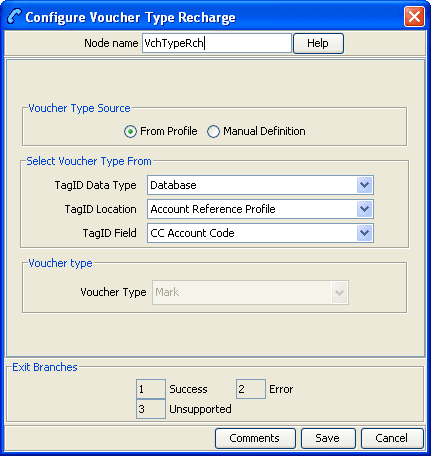

Voucher Type Recharge
Node description
The Voucher Type Recharge node invokes the voucher type recharge billing engine action using the configured name of the voucher type. See CCS User's Guide for details on configuring voucher type recharges.
Node icon
Restrictions
A control plan may contain as many Voucher Type Recharge feature nodes as required.
Node exits
This node has one entry and three exits. The number of exits cannot be changed.
1 Success The billing engine returned a successful voucher type recharge indication.
2 Error The billing engine returned a failed voucher type recharge indication.
3 Unsupported The voucher type recharge capability is not supported.
Here is an example Configure Voucher Type Recharge screen.
Follow these steps to configure the Voucher Type Recharge feature node.
Step Action
1
In the Voucher Type Source area select one of:
  • From Profile
  • Manual Definition
2
Select the voucher type to be recharged. If you selected:
  • From Profile, select the profile field that holds the voucher type from the Data Type, Location and Field lists.
  • Manual Definition, select the name of the voucher type to recharge from the Voucher Type list.
Note: The feature node always recharges vouchers against the default scenario for the voucher type.
3 Click Save.
For more information about profile blocks (data type, location, and field) and how to use them, see Profile Blocks and Fields.
For more information about profile field configuration, see the discussion on profile tag configuration in Convergent Charging Controller Advanced Control Services User's Guide.
