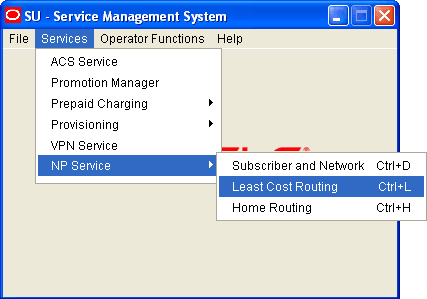

Accessing the Least Cost Routing screen
Follow these steps to access the Least Cost Routing screen.
Step Action
1 Select Services from the SMS main screen.
2
Select NP Service.
Result: You see the list of NP Service menu options.
This is image alt text.
3
Select Least Cost Routing.
Result: You see the Rule Set tab in the NP/Least Cost Routing screen in Find mode.

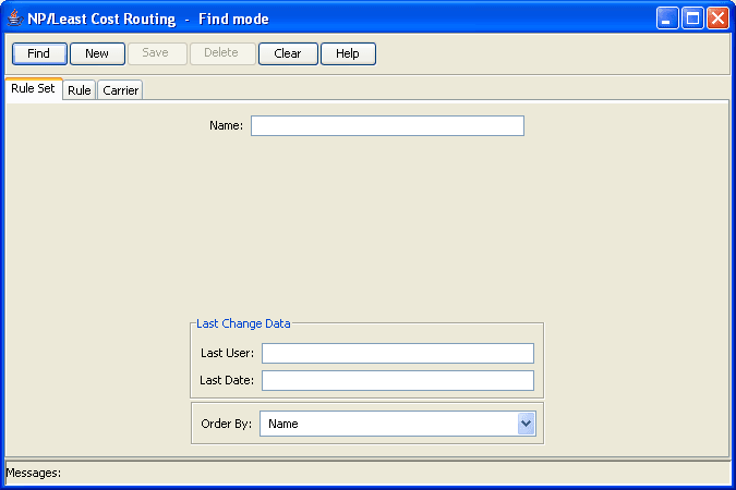

Here is an example Rule Set tab in Find mode in the NP/Least Cost Routing screen.

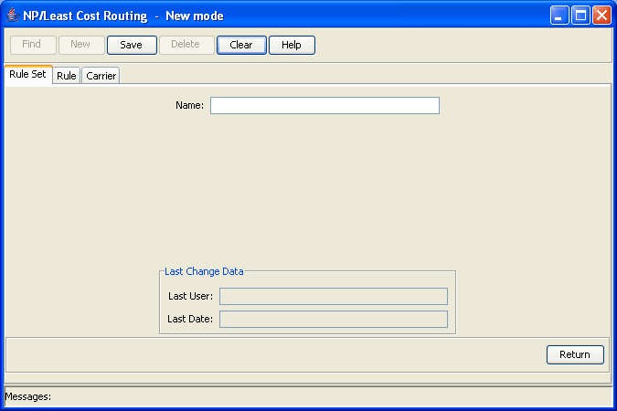

Adding a rule set
Follow these steps to Add a new rule set.
Step Action
1
Select the Rule Set tab in the NP/Least Cost Routing - Find mode screen, and click New.
Result: You see the Rule Set tab in New mode.
2 In the Name field, enter a unique name for the new rule set. The rule set name can be up to 30 alphanumeric characters long and is required.
3 Click Save.
4
Repeat steps 2 to 3 for each rule set to add.
Note: When you click Save, the saved values remain on the screen. You can create another new record by typing over these values and clicking Save again.
5 Click Return to go back to the previous screen.

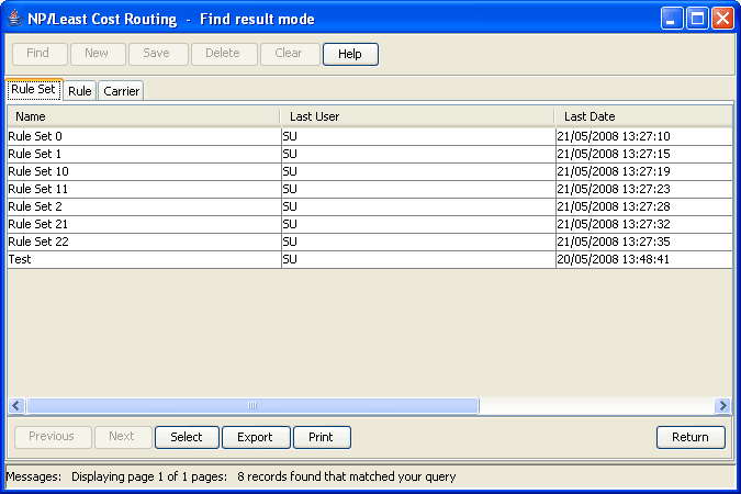

Finding a rule set
Follow these steps to search the database for a specific rule set.
Step Action
1 Ensure you are in Find mode on the Rule Set tab.
2
Enter the selection criteria in one or more query fields and click Find.
If a field is left empty, the search retrieves all instances of that field.
Result: This triggers an Oracle Like% query that returns the first 100 records that begin with the selection criteria. For example, if you enter 123 in a query field, the system returns records such as 123, 1234, 12345.
The results appear in the table on the Find result mode screen for the type of record you are querying.
Note: The first 100 records entered in the database are displayed in no particular order. If you do not find the record you are searching for, conduct a more specific search.
3 To view a record in Update mode, highlight the record line and click Select.
4 To delete a record, highlight the record line and click Delete.

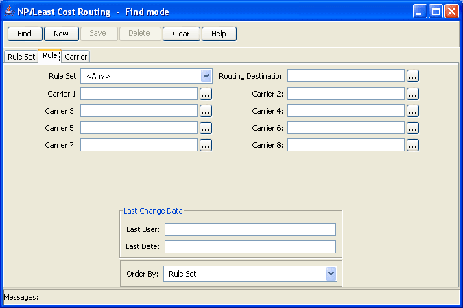

Here is an example Rule tab in Find mode in the NP/Least Cost Routing screen.

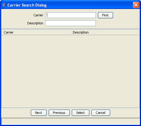

On the Rule tab, click the button to the right of the relevant Carrier field.
Result: You see the Carrier Search Dialog.
2

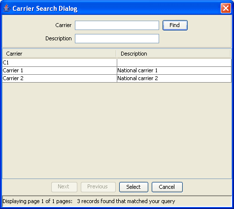

Enter the search criteria in the Carrier and Description query fields and click Find.
If a field is left empty, then the search retrieves all instances of that field.
Result: The search finds all the carriers that match the search criteria and displays them in a table in the Carrier Search Dialog.
3
To select the carrier you want, highlight it in the table and click Select.
Result: You are returned to the Rule tab and the selected carrier name is inserted into relevant Carrier field.

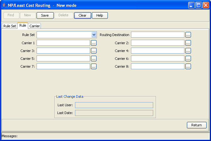

Select the Rule tab in the NP/Destination Selection - Find mode screen, and click New.
Result: You see the Rule tab in New mode.
2 In the Rule Set field, select the rule set to assign the rule to.
3
In the Routing Destination field, enter the routing destination for the rule. You must enter a valid routing destination (one that already exists in the database).
Note: If you do not know the routing destination, you can click the button to the right of this field to search for it using the Routing Destination Search Dialog. See Using the Routing Destination Search Dialog for details.
4
In the Carrier 1 field, enter the first carrier to try when the rule is invoked. This is a required field.
Note: You must enter a valid carrier (one that already exists in the database). To search for a carrier, click the button to the right of the Carrier field. See Using the Carrier Search Dialog for details.
5
In the other Carrier fields, enter the carriers to try, in the sequence in which they should be tried, if the first carrier is unavailable.
Note: You must supply at least one carrier.
6 Click Save.
7
Repeat steps 2 to 6 for each rule to add.
8 Click Return to go back to the previous screen.

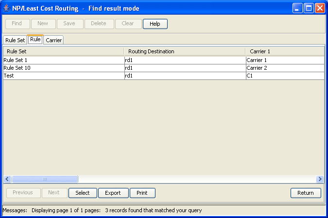

Finding a rule
Follow these steps to search the database for a specific rule.
Step Action
1 Ensure you are in Find mode on the Rule tab.
2
If a field is left empty, then the search will retrieve all instances of that field.
Result: This triggers an Oracle Like% query that returns the first 100 records that begin with the selection criteria. For example, if you enter 123 in a query field, the system will return records such as 123, 1234, 12345, ...
The results appear in the table on the Rule tab in Find result mode.
Note: These are the first 100 records entered in the database, and they display in no particular order. If you do not find the record you are searching for, you need to conduct a more specific search.

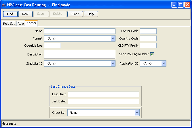

Here is an example Carrier tab in Find mode in the NP/Least Cost Routing screen.

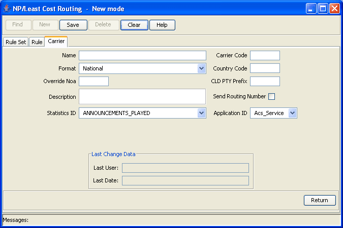

Adding a carrier
Follow these steps to add a new carrier.
Step Action
1
Select the Carrier tab in the NP/Least Cost Routing - Find mode screen, and click New.
Result: You see the Carrier tab in New mode.
2 In the Name field, enter a unique name for the new carrier. The carrier name can be up to 30 alphanumeric characters long and is required.
3 In the Format field select the preferred format for the carrier.
4 In the Override Noa field, enter the appropriate value. Valid values are a single digit in the range 0 through 7.
5 In the Description field, enter a description for the carrier, if required. The description can be up to 64 alphanumeric characters long.
  In the Statistics ID field, select the relevant statistic.
4 In the Carrier Code field, enter the carrier code. The carrier code must be four characters long and is required.
5 In the Country Code field, enter the country code for the carrier. The country code can be up to four decimal digits long and is required.
6 In the CLD PTY Prefix field, enter the CLD PTY prefix if required. The CLD PTY prefix can be up to four hexadecimal digits long.
7 Select the Send Routing Number check box to send the routing number when using this carrier.
8 In the Application ID field, select the ID of the application used by the carrier.
9 Click Save.
10
Repeat steps 2 through 9 for each carrier to add.
11 Click Return to go back to the previous screen.

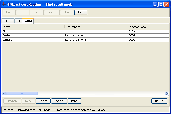

Finding a carrier
Follow these steps to search the database for a specific carrier.
Step Action
1 Ensure you are on the Carrier tab in Find mode.
2
The results appear in the table on Carrier tab in Find result mode.
