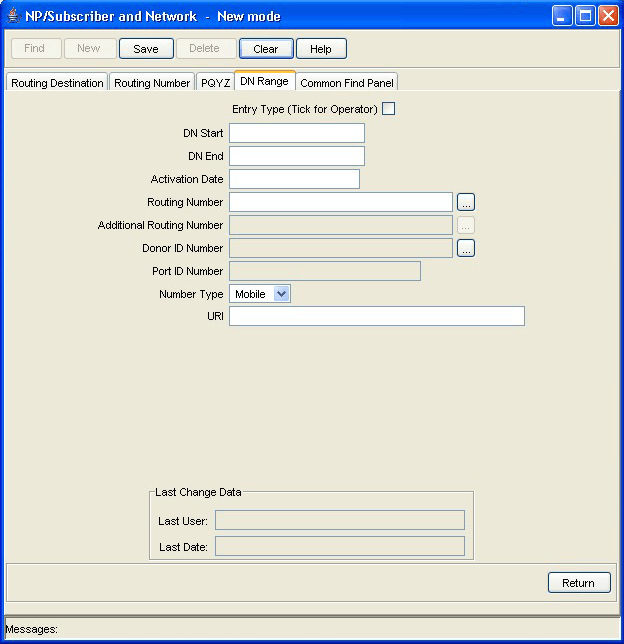

The NP/Subscriber and Network screen allows you to define:
  • Logical operator names
  • The network routing numbers associated with operators
  • The operator ranges associated with operators (through prefixes or ranges)
  • Ported subscriber information.
It also allows you to map operator names and ported subscribers to routing numbers. It contains the following tabs:
  • Routing Destination
  • Routing Number
  • PQYZ
  • DN Range
  • Common Find Panel

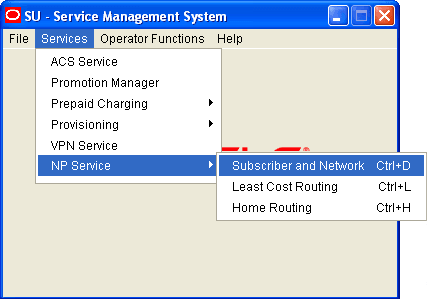

Accessing the Destination Selection screen
Follow these steps to access the Subscriber and Network screen.
Step Action
1 Select the Services menu from the SMS main screen.
2
Select NP Service.
Result: You see the list of NP Service menu options.
This is image alt text.
3
Select Subscriber and Network.
Result: You see the Routing Destination tab on the NP/Subscriber and Network screen in Find mode.

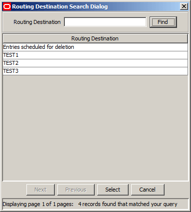

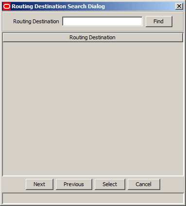

Using the Routing Destination Search Dialog
You can use the Routing Destination Search Dialog to find an existing Routing Destination record on any tab that has a search button next to the Routing Destination field.
Follow these steps to search for a Routing Destination in the Routing Destination Search Dialog.
Step Action
1
Click the button to the right of the Routing Destination field.
Result: You see the Routing Destination Search Dialog.
2
Enter the search criteria in the Routing Destination query field and click Find.
If the field is left empty, the search retrieves all Routing Destinations.
Result: All routing destinations that match the search criteria are displayed.
3
To select the Routing Destination you want, highlight it in the table and click Select.
Result: Your selection is inserted into the Routing Destination field.

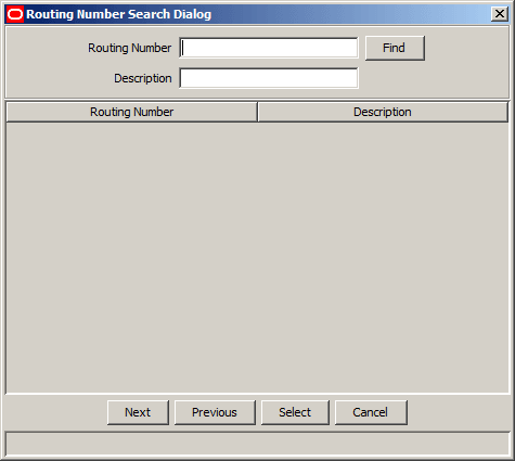

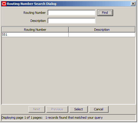

Using the Routing Number Search Dialog
You can use the Routing Number Search Dialog to find an existing Routing Number record on any tab that has a search button next to the Routing Number field.
Note: If the Routing Destination field is also present on the tab, the available Routing Numbers depend on the Routing Destination selected.
Follow these steps to search for a Routing Number in the Routing Number Search Dialog.
Step Action
1
Click the button to the right of the Routing Number field.
Result: You see the Routing Number Search Dialog.
2
Enter the search criteria in the query fields and click Find.
If the field is left empty, the search retrieves all instances of that field.
Result: All routing numbers that match the search criteria are displayed.
3
To select a Routing Number, highlight it in the table and click Select.
Result: Your selection is inserted into the Routing Number field.

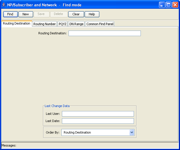

Here is an example Routing Destination tab in Find mode on the NP/Subscriber and Network screen.

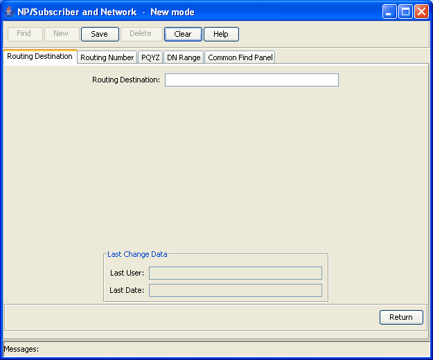

Adding a routing destination
Follow these steps to Add a new routing destination.
Step Action
1
Select the Routing Destination tab in the NP/Subscriber and Network - Find mode screen, and click New.
Result: You see the Routing Destination tab in New mode.
2 In the Routing Destination field, enter a unique value for the routing destination to add. It can be up to 64 alpha-numeric characters long.
3 Click Save.
4
Repeat steps 2 to 3 for each routing destination to add.
Note: When you click Save, the saved values remain on the screen. You can create another new record by typing over these values and clicking Save again.
5 Click Return to go back to the previous screen.

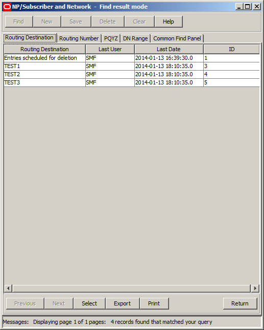

Finding a routing destination
Follow these steps to search the database for a specific routing destination.
Step Action
1 Ensure you are in Find mode on the Routing Destination tab.
2
Enter the selection criteria in one or more query fields and click Find.
If a field is left empty, the search retrieves all instances of that field.
Result: This triggers an Oracle Like% query that returns the first 100 records that begin with the selection criteria. For example, if you enter 123 in a query field, the system will return records such as 123, 1234, 12345, ...
The search results appear in the table on the Routing Destination tab in Find result mode.
Note: The first 100 records entered in the database are displayed in no particular order. If you do not find the record you are searching for, conduct a more specific search.
3 To view a record in Update mode, highlight the record line and click Select.
4 To delete a record, highlight the record line and click Delete.

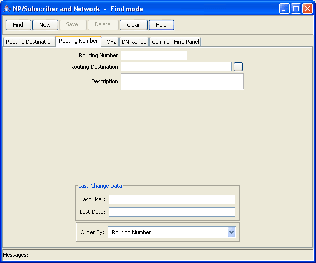

Routing Number tab
Here is an example Routing Number tab in Find mode on the NP/Subscriber and Network screen.

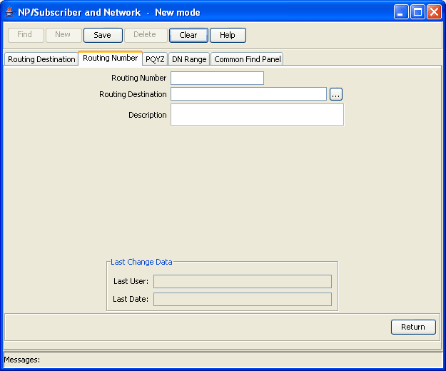

Adding a routing number
Follow these steps to Add a new routing number.
Step Action
1
Select the Routing Number tab in the NP/Subscriber and Network - Find mode screen, and click New.
Result: You see the Routing Number tab in New mode.
2 In the Routing Number field, enter a unique value for the routing number to add. It can be up to eight hexadecimal characters long.
3
In the Routing Destination field, enter the routing destination for the routing number. You must enter a valid routing destination (one that already exists in the database).
Note: If you do not know the routing destination, you can click the button to the right of this field to search for it using the Routing Destination Search Dialog. See Using the Routing Destination Search Dialog for details.
4 If required, in the Description field enter a description for the routing number.
5 Click Save.
6
Repeat steps 2 to 5 for each routing number to add.
7 Click Return to go back to the previous screen.

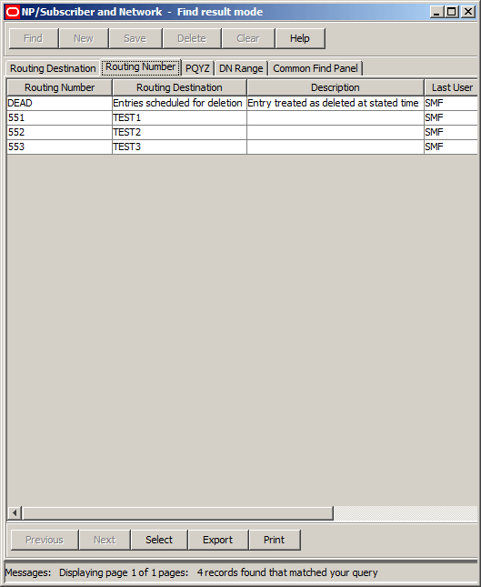

Finding a routing number
Follow these steps to search the database for a specific routing number.
Step Action
1 Ensure you are in Find mode on the Routing Number tab.
2
Result: This triggers an Oracle Like% query that returns the first 100 records that begin with the selection criteria. For example, if you enter 123 in a query field, the system returns records such as 123, 1234, 12345.
The search results appear in a table on the Routing Number tab in Find result mode.

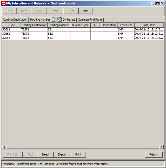

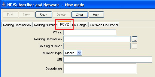

PQYZ
Introduction
You use the PQYZ tab to map operator range prefixes to the operator names configured in routing destinations.
You can map one or more prefixes to the same routing destination. The routing destination must have been previously defined on the Routing Destination tab.

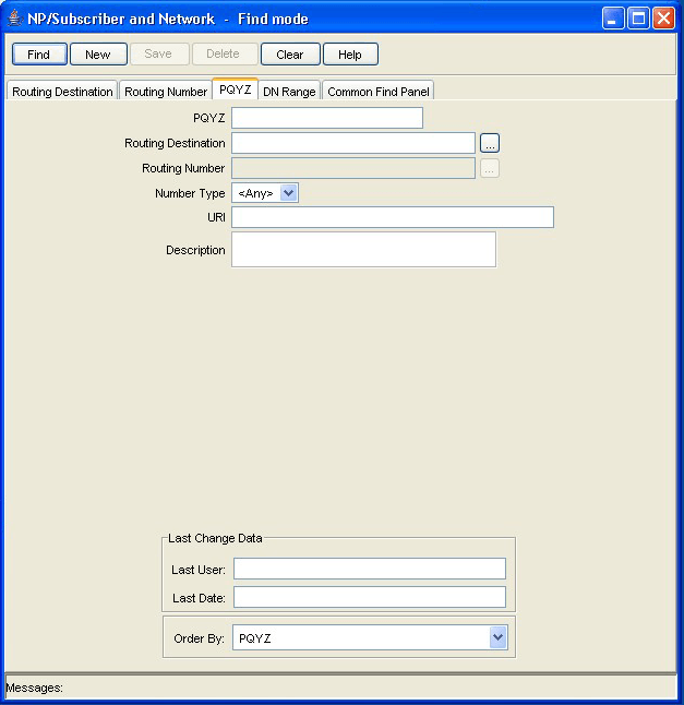

PQYZ tab
Here is an example PQYZ tab.
Adding a PQYZ mapping
Follow these steps to Add a new PQYZ routing destination mapping.
Step Action
1
On the PQYZ tab in the NP/Subscriber and Network - Find mode screen, click New.
Result: You see the PQYZ tab in the NP/Subscriber and Network screen in New mode.
2 In the PQYZ field, enter the international called number prefix to map to a routing destination.
3
In the Routing Destination field, enter the routing destination for the PQYZ prefix. You must enter a valid routing destination (one that already exists in the database).
4
If required, click the button to the right of the Routing Number field to search for and select the routing number for the PQYZ prefix. See Using the Routing Number Search Dialog for details.
Note: You cannot enter in the routing number directly.
5 From the Number Type drop down list, select the number type for the PQYZ entry
6 If required, enter a URI to associate with the PQYZ entry.
7 Click Save.
8
Repeat steps 2 to 7 for all the PQYZ routing destination mappings you require.
9 Click Return to go back to the previous screen.

Finding a PQYZ mapping
Follow these steps to search the database for a specific PQYZ record.
Step Action
1 Ensure you are on the PQYZ tab in Find mode.
2
Result: This triggers an Oracle Like% query that returns the first 100 records that begin with the selection criteria. For example, if you enter 123 in a query field, the system returns records such as 123, 1234, 12345, ...
The search results appear in the table on the PQYZ tab in Find result mode.

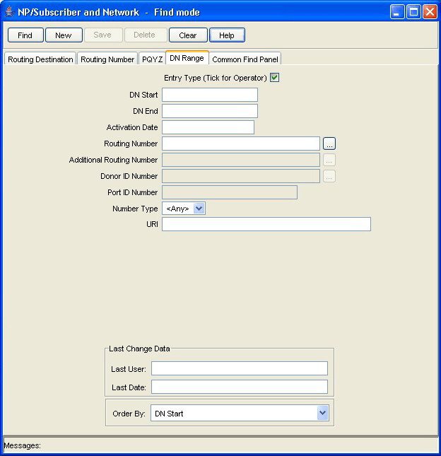

Adding a DN range
Follow these steps to add a new DN range.
Step Action
1
On the DN Range tab in the NP/Subscriber and Network - Find mode screen, click New.
Result: You see the DN Range tab in the NP/Subscriber and Network screen in New mode.
2
If this DN range provides additional routing for external operator ranges then select the Entry Type (Tick for Operator) check box. Leave deselected if this is a subscriber DN range.
Note: When this check box is selected you will not be able to specify an:
  • Additional Routing Number
  • Donor ID Number
  • Port ID Number
3 In the DN Start field, enter the starting number for the DN range. The number must be between four and 18 digits long.
4 In the DN End field, enter the end number for the DN range. The number must be greater than or equal to the DN Start number and must be the same length.
5
In the Activation Date field, enter the activation date using this format: DD/MM/YYYY HH:MM:SS.
Example: "01/15/2008 10:00:00"
6
In the Routing Number field, enter the routing number associated to the recipient network that the subscriber is being ported to. You must enter a routing number that has been previously defined in the database.
Note: If you do not know the routing number, you can click the button to the right of this field to search for it using the Routing Number Search Dialog. See Using the Routing Number Search Dialog for details.
7
If required, in the Additional Routing Number field, specify the additional routing number the DN range maps to. This is the logical routing number for the network element that holds the subscriber information in the recipient network.
Note: You cannot enter in an additional routing number directly. Click the button to the right of this field to search for it using the Additional Routing Number Search Dialog. See Using the Additional Routing Number Search Dialog for details.
8
If required, in the Donor ID Number field specify the donor ID number.
Note: To search for a valid number using the Donor ID Search Dialog, click the button to the right of this field. See Using the Donor ID Search Dialog for details.
9
If required, in the Port ID Number field enter the number of the port ID for the DN range.
Note: This field is used for auditing purposes (if available) to hold the administrative ID for the port request.
10 From the Number Type drop down list, select the number type for the DN range.
11 If required, enter a URI to associate with the DN Range.
12
Click Save.
Note: If the DN range rules are broken, a "Save operation failed" error message detailing the problem will be displayed.
13
Repeat steps 2 to 12 to add all the DN ranges you require.
14 Click Return to go back to the previous screen.

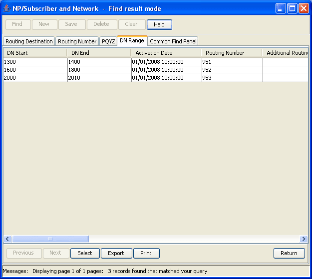

Finding a dn range
Follow these steps to search the database for a specific DN range.
Step Action
1 Ensure you are on the DN Range tab in Find mode.
2
Enter selection criteria in one or more query fields and click Find.
The results appear in the table on the DN Range tab in Find result mode.
Note: Te first 100 records entered in the database are displayed in no particular order. If you do not find the record you are searching for, conduct a more specific search.

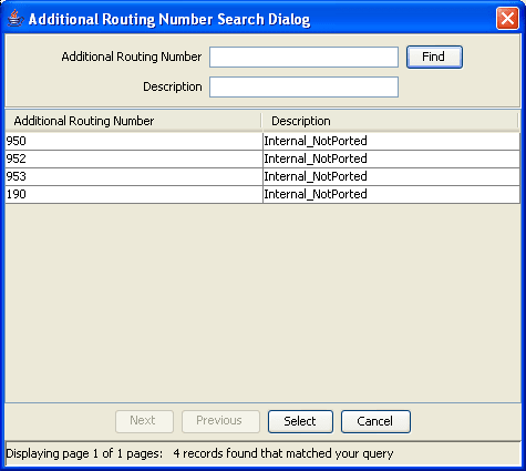

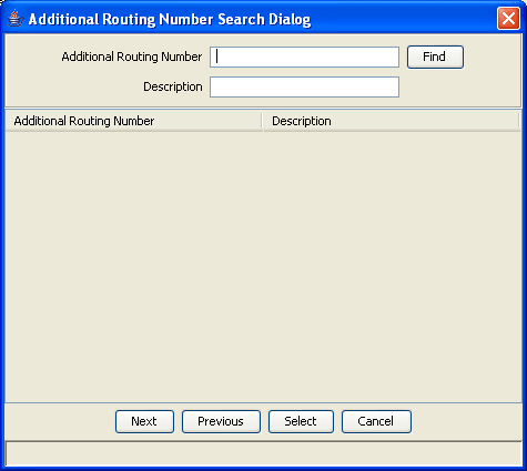

You can use the Additional Routing Number Search Dialog to find an additional routing number record on any tab that has a search button next to the Additional Routing Number field.
Note: The additional routing numbers listed in the search results will depend on the value previously specified in the Routing Number field.
Follow these steps to search for an additional Routing Number in the Additional Routing Number Search Dialog.
Step Action
1
Click the button to the right of the Additional Routing Number field.
Result: You see the Additional Routing Number Search Dialog.
2
If the field is left empty, then the search retrieves all instances of that field.
Result: The search finds all the available additional routing numbers for the previously specified routing number and that match the search criteria. The results are displayed in the grid in the Additional Routing Number Search Dialog.
3
To select an additional routing number, highlight it in the grid and click Select.
Result: Your selection is inserted into the Additional Routing Number field.

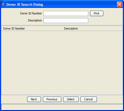

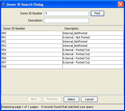

You can use the Donor ID Search Dialog to find a donor id number record on any tab that has a search button next to the Donor ID Number field.
Follow these steps to search for a donor ID number in the Donor ID Search Dialog.
Step Action
1
Click the button to the right of the Donor ID Number field.
Result: You see the Donor ID Search Dialog.
2
Result: The search finds all the donor id numbers that match the search criteria and displays the results in the table in the Donor ID Search Dialog.
3
To select a donor ID number, highlight it in the table and click Select.
Result: Your selection is inserted into the Donor ID Number field.

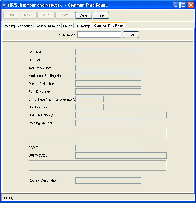

Common Find Panel
Introduction
The Common Find Panel allows you to look for commonly required data from the following tables and view the results on the same screen:
  • DN Range
  • Routing Number
  • PQYZ
Common Find Panel logic
The search is based on the prefix you enter in the Find Number field. If it:
  • Matches at least one defined DN range with an Activation Date in the past, then the following data will be displayed:
  • Start and End of the matched DN range with the newest Activation Date
  • Activation Date of the matched DN range
  • Additional Routing Number, Donor ID Number, Port ID Number and Routing Number that is linked to the matched DN range
  • Entry Type of the matched DN Range
  • Number Type of the matched DN Range
  • Routing Destination that is linked to this Routing Number
  • PQYZ information shall be displayed as “Not Applicable”
  • URI of the matched DN Range
  • Does not match any range in the conditions described above (because there is no range match or because the matched ranges have their Activation Date in the future), then the PQYZ is queried. If a match is found the following data will be displayed:
  • PQYZ of the matching PQYZ entry
  • Routing Destination that is linked to the matching PQYZ entry
  • DN range information shall be displayed as “Not found”
  • Activation Date information shall be displayed as “Not found”
  • Routing Number information shall be displayed as “Not applicable”
  • Number Type of the matching PQYZ entry
  • URI of the matching PQYZ entry
In any other case all the information fields will be displayed as “Not found”
Common Find Panel tab
Here is an example Common Find Panel tab in the NP/Subscriber and Network screen.
Common Find Panel fields
This table describes the function of each field in the Common Find Panel.
Field Description
Find Number The number to look for in the PQYZ, DN Range, Routing Number and Routing Destination tables.
DN Start Displays the start of the matched DN range with the newest activation date.
DN End Displays the end of the matched DN range with the newest activation date.
Activation Date Displays the activation date of the matched DN range.
Additional Routing Num Displays the additional routing number of the matched DN range.
Donor ID Number Displays the donor id of the matched DN range.
Port ID Number Displays the port id of the matched DN range.
Displays the entry type for the matched DN range. Valid values are:
O - external operator range
S - subscriber range
Number Type
Displays the number type for the matched DN range or PQYZ entry. Valid values are:
  • F - fixed
  • M - mobile
  • E - empty (not used)
URI (DN Range) Displays the URI of the matched DN range.
Routing Number Displays the Routing Number that is linked to the matched DN range and shows its description in the text box below.
PQYZ Displays the PQYZ prefix that matches the Find Number value and shows its description in the text box below.
URI (PQYZ) Displays the URI of the matching PQYZ entry.
Routing Destination Displays the routing destination for the matching PQYZ prefix or Routing Number.
Using the Common Find Panel
Follow these steps to find and view data using a common number prefix.
Step Action
1 Select the Common Find Panel in the NP/Subscriber and Network screen.
2
In the Find Number field, enter the number to search for, and click Find.
Result: A list of the records that match the Find Number value displays.
