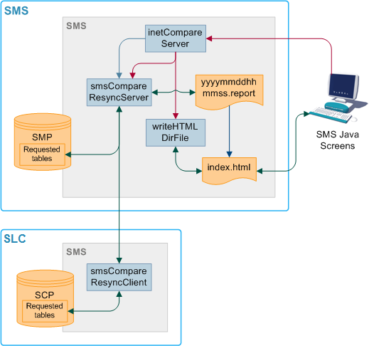

Replication Checks
SMS provides a replication check mechanism to enable operators to check the replication of data across their services network.
A replication check will perform a comparison of the SMF data on each replication node. Once the comparison is complete a report will be generated detailing any discrepancies. No data is changed.
Depending on the size of the data set there may be sizable performance impact on the client node and care should be taken to perform such a check outside of peak times.
Replication Check Diagram
Here is a diagram that shows the elements involved in replication checks.
Figure 3-1 Elements of Replication Check Process
Replication check diagram.
Replication Check Components
This table describes the components involved in replication check process.
Table 3-1 Components of Replication Check Process
Process Role Further information
SMF
The main database on the SMS.
N/A
SCP
The databases on the SLCs. They hold a subset of the data on the SMF.
N/A
writeHTMLDirFile
Updates index.html to include new replication, comparison and resynchronization reports.
N/A
smsCompareResyncServer
Performs database resynchronizations and comparisons on the superior node.
"smsCompareResyncServer"
smsCompareResyncClient
Performs database resynchronizations and comparisons on the inferior node.
"smsCompareResyncClient"
inetCompareServer
Accepts Replication Check requests from the Replication Check screen.
"inetCompareServer"
The replication check process follows these stages.
  1. The run all command starts inetCompareServer as configured in the replication check report.
  2. inetCompareServer configures and starts "smsCompareResyncServer" and writeHTMLDirFile.
  3. "smsCompareResyncClient" handles the other end of the replication check.
  4. writeHTMLDirFile updates index.html to include the new report for display in the screens.

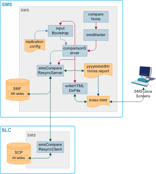

Database Comparisons
compareNode is used to initiate a full database comparison of an SCP database with the definitive copy in SMF db. This ensures that an SCP's data is consistent with the SMF database. Under normal conditions, this should always be the case, but there may be a time (for example, after multiple failures) where the system administrator wants to check an SLC is consistent.
compareNode tool requests a comparison between the contents of SMF and one other node, by invoking comparisonServer. Comparisons are a more time-efficient method than resyncs. compareServer compares all the entries of all tables which are defined to be replicated to specified updateLoader node.
Database Comparison Diagram
Here is a diagram that shows the elements involved in a database comparison process.
Figure 3-2 Elements of Database Comparison Process
Database comparison diagram.
Database Comparison Components
This table describes the components involved in database comparison process.
compareNode Initiates a full database comparison of an SCP with the definitive copy in SMF. Starts comparisonServer. "compareNode"
inputBootstrap Creates configuration files for smsCompareResyncServer from replication.config. "inputBootstrap"
smsMaster Receives update requests and forwards them to the SMF. "smsMaster"
comparisonServer Creates configuration files for smsCompareResyncServer from replication.config.
N/A
smsCompareResync
Client
Performs database resynchronizations and comparisons on the inferior node. "smsCompareResyncClient"
writeHTMLDirFile Updates index.html to include new replication, comparison and resynchronization reports.
N/A
The database comparison process follows these stages.
  1. compareNode sends a comparison request to smsMaster.
  2. smsMaster configures and starts comparisonServer.
  3. inputBootstrap provides configuration for comparisonServer from replication.config.
  4. comparisonServer configures and starts smsCompareResyncServer and writeHTMLDirFile.
  5. smsCompareResyncClient handles the other end of the comparison.
  6. writeHTMLDirFile updates index.html to include the new report for display in the screens.
