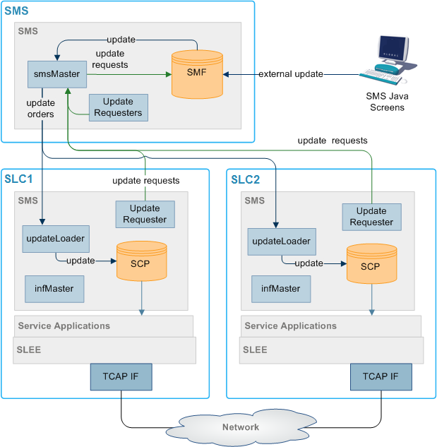

Data Flow
The SMF database on the SMS holds the full set of authoritative data within the system. Data required for call processing and resilience is forwarded to the SCP database on the SLCs using SMS replication. Updates are received from processes on the SMSs and the SLCs and from the Service Management System administration screens.
Figure 2-1 Data Flow
Replication Process
- Update Requests come from one of the following:
- The administration screens
- An event on the SMS or SLCs
- If the update comes from the administration screens, one of the following
occurs:
- Forwarded to the smsTaskAgent, and then through to an smsMaster
- Inserted directly into the SMF database
- When an smsMaster (parent) receives an update request, it:
- Sends an update order to all configured destination replication groups (there may be no relevant groups, in which case no order is sent)
- Spawns a local smsMaster (child) process to insert the updated data into the SMF database.
- updateLoader on the relevant SLCs reads the update order from the socket and inserts the data into the SCP database.
- If requested to do so, updateLoader sends a confirmation to smsMaster that the update completed successfully.

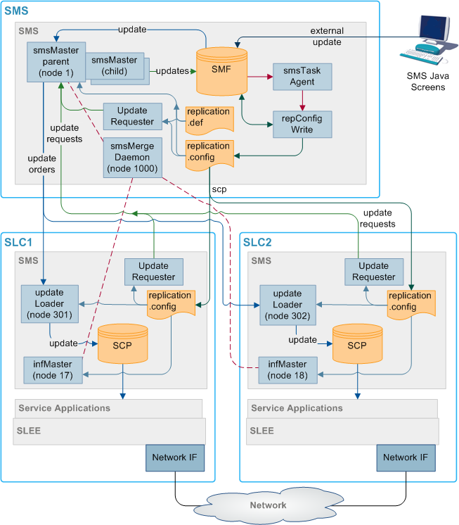

Replication Components
Table 2-1 describes the components of replication in an unclustered installation.
Table 2-1 Components of Replication
| Process | Role | Further Information |
| smsMaster | Runs on the SMS handling updates throughout SMS. This is the superior master for all connected nodes. | smsMaster |
| infMaster | An infMaster runs on each SLC. If it becomes the node with the highest number of all connected nodes, it stands in as the superior master until a higher node number becomes available again. | infMaster |
| updateLoaders |
An updateLoader runs on each SLC. It manages all incoming update orders and inserts updated data into the SCP. At any point in time, an updateLoader is connected to a specific superior master. |
updateLoader |
| update requesters | update requesters may run on any machine. They send update requests to the Superior Master. | Update Requester Nodes |
| smsMergeDaemon | The smsMergeDaemon runs on the SMS and monitors the connections between the SMS and the SLCs. If it notices a break in the connection, it may start a merge to update the disconnected nodes. | smsMergeDaemon |
| smsTaskAgent | The smsTaskAgent accepts instructions from the SMS Administration screens and produces instructions for the smsMaster. It generates the replication config file and copies it to the SLC nodes. | smsTaskAgent |
| smsNamingServer | The smsNamingServer enables non-SMS components to connect to elements within the SMS. | smsNamingServer |
| SMF | This Oracle database holds authoritative data for all SLCs. | |
| SCPs | These Oracle databases hold the subset of SMF data required to route calls. |

| 1 | This node number must assigned to the smsMaster process on the SMS. |
| 17-255 | These node numbers are available to infMaster processes on the SLCs. |
| 256-511 | These node numbers are available to updateLoaders on the SLCs. |
| 512-999 |
These node numbers are available to updateRequesters. They are usually configured in the following pattern:
| 1000 | In an unclustered installation, this node number is used for the smsMergeDaemon. |

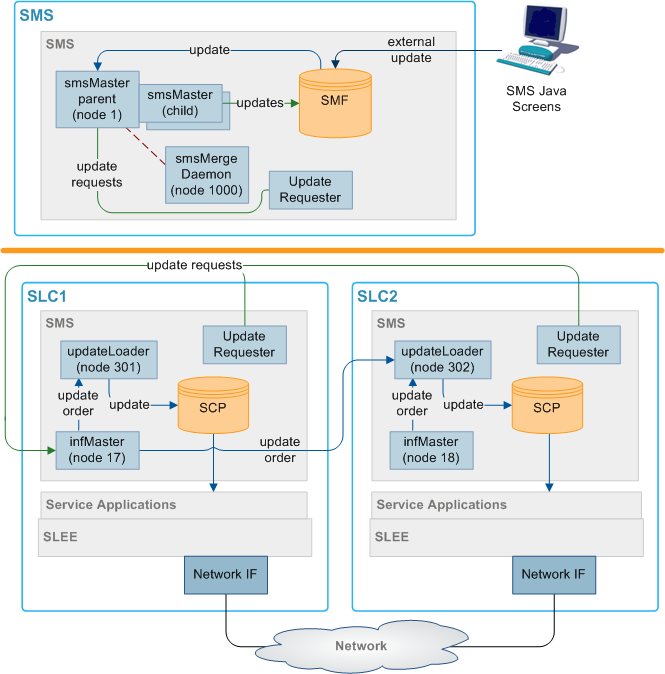

Node numbers are unique.Failover
If a node becomes disconnected from the smsMaster node (due to network failure or a problem with the SMS), it attempts to contact the other nodes in descending node number order until it locates a node it can connect to.
An infMaster on one of the SLCs becomes the acting superior master until the failure is resolved. After the smsMaster becomes available again, smsMergeDaemon instructs the infMaster to merge its updates with the smsMaster.
If the infMaster that is the acting superior master becomes unavailable before the smsMaster is available again, the infMaster with the next node number is used instead.
All Nodes Connected
Here is an example showing all nodes in an unclustered configuration connected to the smsMergeDaemon.
Figure 2-3 All Nodes Connected

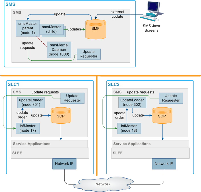

Isolated SLC
Figure 2-4 depicts an isolated SLC in an unclustered environment.
Figure 2-4 Isolated SLC
Where an SLC has been isolated from the master it looks for and connects to the master in the network, which has the next lowest node number. In the diagram above, SLC1 has been isolated from the network and the update loader cannot find Master 1, so it looks for the master with the lowest node number it can see (in this case it is Inferior Master 2 on SLC1) and connects to that.
The Master 1 queues all updates for SLC1 until such time as it comes back on line. When SLC1 comes back on line, the smsMergeDaemon queries the infMaster process to see if there are any connections to it. If there are any processes connected to the infMaster, the smsMergeDaemon sends a start merge message to the smsMaster. The smsMaster then updates the rest of the network with the information received from SLC1.
If the smsMergeDaemon is not running, the startMerge process may be used instead. startMerge copies the data from SLC1 to the smsMaster. The smsMaster then updates the rest of the network with the information received from SLC1.
Isolated SMS
Figure 2-5 depicts an isolated SMS.
Figure 2-5 Isolated SMS
Where the master is isolated from the network, each update loader looks for the inferior master with the lowest node number and connects to that.
In the above case the Master 1 on the SMS has been isolated. The update loader on each node looks for the inferior master with the lowest node number it can find, in this case the update loaders on both SLC1 and SLC2 finds and connects to inferior master 2 on SLC1. When the SMS comes back into the network, the smsMergeDaemon checks each SLC infMaster process to see if there are any connections to them. In this case, there are connections to the SLC1 infMaster process (node 2) from the SLC2 (node 3). The smsMergeDaemon runs startMerge against SLC1. startMerge copies SLC1's data across to the SMS. The smsMaster then attempts to update both SLCs with the new data from SLC1.
