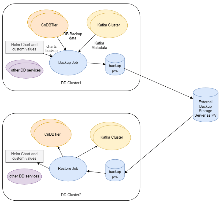

Figure 7-1 OCNADD Backup and Restore

  1. The OCNADD backup is managed using the backup job created at the time of installation. The backup job runs as a cron job and takes the daily backup of the following:
    • OCNADD databases for configuration, alarms, and health monitoring
    • OCNADD Kafka metadata including topics and partitions, which are previously created
  2. The automated backup job spawns as a container and takes the backup at the scheduled time. The backup file OCNADD_Backup_DD-MM-YYYY_hh-mm-ss.tar.bz2 is created and stored in the PV mounted on the path /work-dir/backup by the backup container.
  3. On-demand backup can also be created by creating the backup container. For more information, see Performing OCNADD Manual Backup.
  4. The backup can be stored on external storage.

  1. The OCNADD restore job must have access to the backups from the backup PV/PVC.
  2. The restore uses the latest backup file available in the backup storage if the BACKUP_FILE argument is not given.
  3. The restore job performs the restore in the following order:
    1. Restore the OCNADD database(s) on the cnDBTier.
    2. Restore the Kafka metadata.
