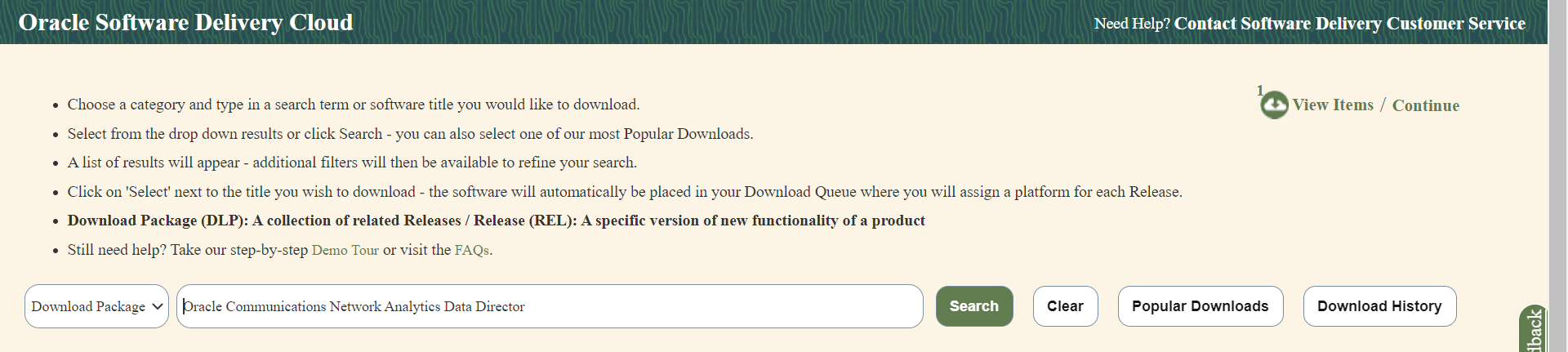

To download the Oracle Communications Network Analytics Data Director package from the edelivery portal, perform the following steps:
  1. Login to the edelivery portal with your credentials. The following screen appears:
    Figure 2-1 edelivery portal
    edelivery portal
  2. Select the Download Package option, from All Categories drop down list.
  3. Enter Oracle Communications Network Analytics Data Director in the search bar.
    Figure 2-2 Search
    Search
  4. List of release packages available for download are displayed on the screen. Select the release package you want to download, the package automatically gets downloaded.
