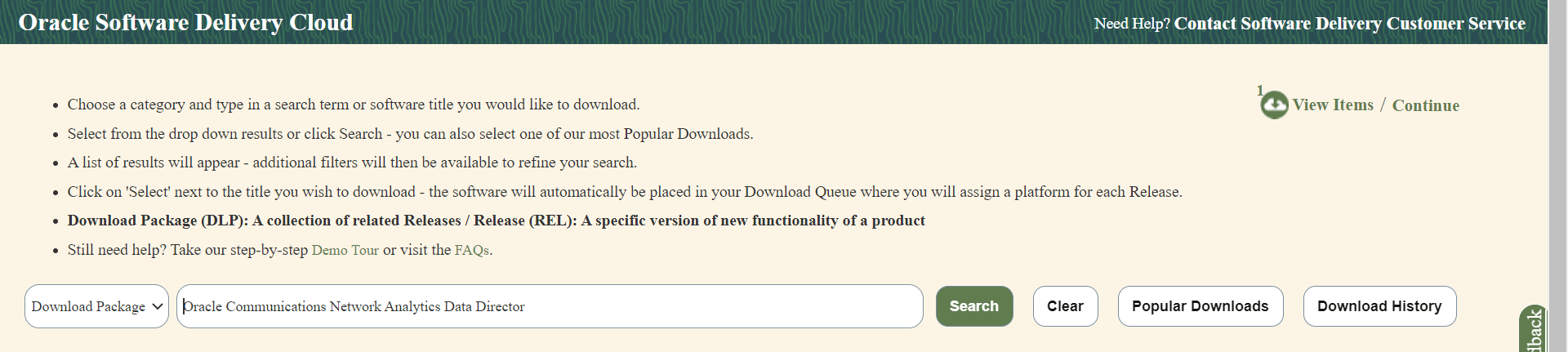

To download the Oracle Communications Network Analytics Data Director package from the edelivery portal, perform the following steps:
- Login to the edelivery portal with your credentials. The following screen appears:
Figure 2-1 edelivery portal
- Select the Download Package option, from All Categories drop down list.
- Enter Oracle Communications Network Analytics Data Director in the search bar.
Figure 2-2 Search
- List of release packages available for download are displayed on the screen. Select the release package you want to download, the package automatically gets downloaded.
