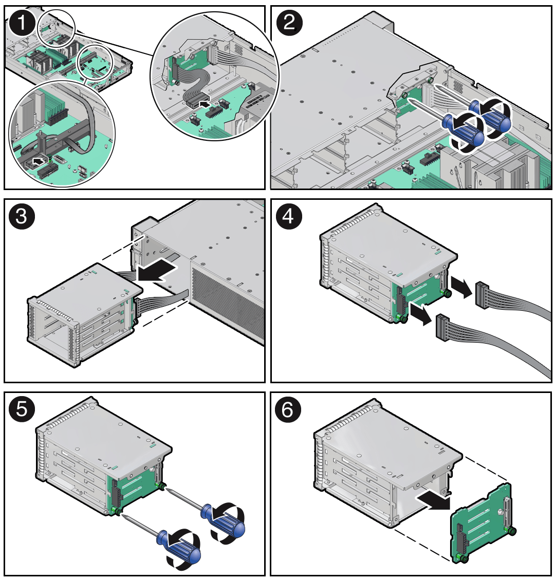

  11. Remove the storage drive cage from the chassis.
    remove
  12. Disconnect the DBP power cable and the DBP auxiliary signal cable from the motherboard connectors, and remove the DBP auxiliary signal cable from the left-side cable trough [1]. Do not disconnect the DBP power cable and DBP auxiliary signal cable from the disk backplane at this time.
  13. Using a Torx T15 screwdriver, loosen the two spring-mounted screws that secure the storage drive cage in to the chassis [2].
  14. Ensure that the DBP power cable and DBP auxiliary signal cable are free from snagging motherboard components and gently pull the storage drive cage with cables attached through the front panel of the chassis [3]. See also Remove the Disk Backplane Signal Cable.
  15. Remove the 4-Drive disk backplane from the storage drive cage.
  16. Disconnect the DBP power cable and the DBP auxiliary signal cable from the disk backplane and set them aside [4]. Press and hold the button on the connector to disengage the locking mechanism, then gently pull the connector from the disk backplane.
  17. Using a Torx T15 screwdriver, loosen the two spring-mounted screws that secure the disk backplane to the storage drive cage [5].
  18. Gently remove the disk backplane from the storage drive cage [6].
  19. Place the disk backplane on an antistatic mat.

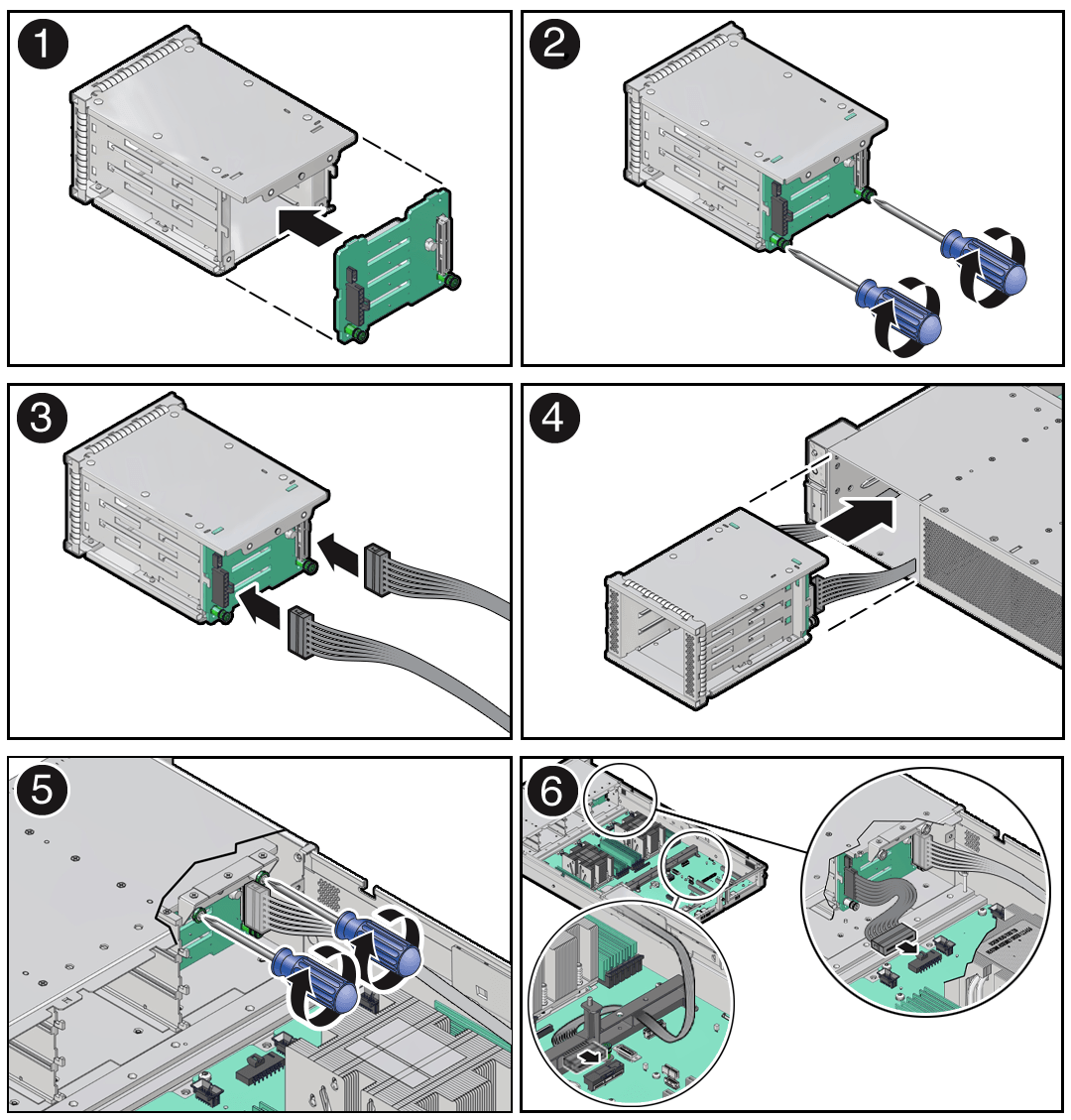

  1. Install the 4-Drive disk backplane on to the storage drive cage.
  2. Align the replacement disk backplane with the rear of the storage drive cage. Using a Torx T15 screwdriver, tighten the two spring-mounted screws to secure the disk backplane to the storage drive cage [1, 2].
    install
  3. Reconnect the DBP power cable and the DBP auxiliary signal cable to the disk backplane [3].
  4. Install the storage drive cage in to the chassis.
  5. Align the storage drive cage with the opening in the front panel of the server. Pull the attached DBP power cable and DBP auxiliary signal cable through the opening while gently pushing the storage drive cage in to the chassis until it is fully seated in the chassis [4].
  6. Using a Torx T15 screwdriver, tighten the two spring-mounted screws to secure the storage drive cage to the chassis [5].
  7. Gently insert the DBP auxiliary signal cable in to the left-side cable trough. Reconnect the DBP auxiliary signal cable and DBP power cable to the motherboard connectors [6]. See also Install the Disk Backplane Signal Cable.

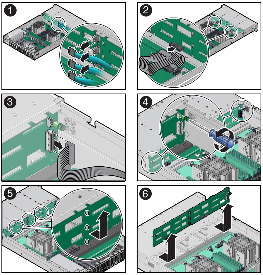

  11. Disconnect the cables from the disk backplane. Ensure all cables are moved out of the way so they do not interfere with the disk backplane removal procedure.
  12. Disconnect the three SAS cables from the 12-Drive backplane [1]. See also Remove SAS Storage Drive Cables.
  13. Disconnect the two power cables from the 12-Drive backplane [2]. Press and hold the button on the connector to disengage the locking mechanism, then gently pull the connector from the disk backplane. Note the cabe connections in order to ease proper reconnection of the cables.
    12 drive
  14. Disconnect the DBP auxiliary signal cable from the 12-Drive backplane [3]. See also Remove the Disk Backplane Signal Cable.
  15. Using a Torx T15 screwdriver, loosen the right-side and left-side spring-mounted screws that secure the 12-Drive backplane to the chassis [4].
  16. Lift the 12-Drive backplane up to release it from the standoff hooks and out of the chassis [5 and 6].
  17. Place the 12-Drive backplane on an antistatic mat.

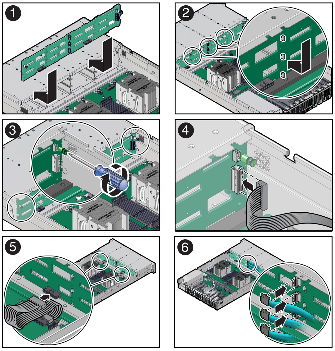

  1. Lower the 12-Drive backplane into the server, and position it to engage the standoff hooks [1 and 2].
    install
  2. Using a Torx T15 screwdriver, tighten the right-side and left-side spring-mounted screws to secure the 12-Drive backplane to the chassis [3].
  3. Reconnect the cables to the disk backplane.
  4. Reconnect the DBP auxiliary signal cable to the 12-Drive backplane [4]. See also Install the Disk Backplane Signal Cable.
  5. Reconnect the two power cables to the disk backplane [5].
  6. Reconnect the three SAS cables to the 12-Drive backplane [6]. To ensure proper SAS cable connections, see the SAS cabling reference table in Step 3 in Install SAS Storage Drive Cables.

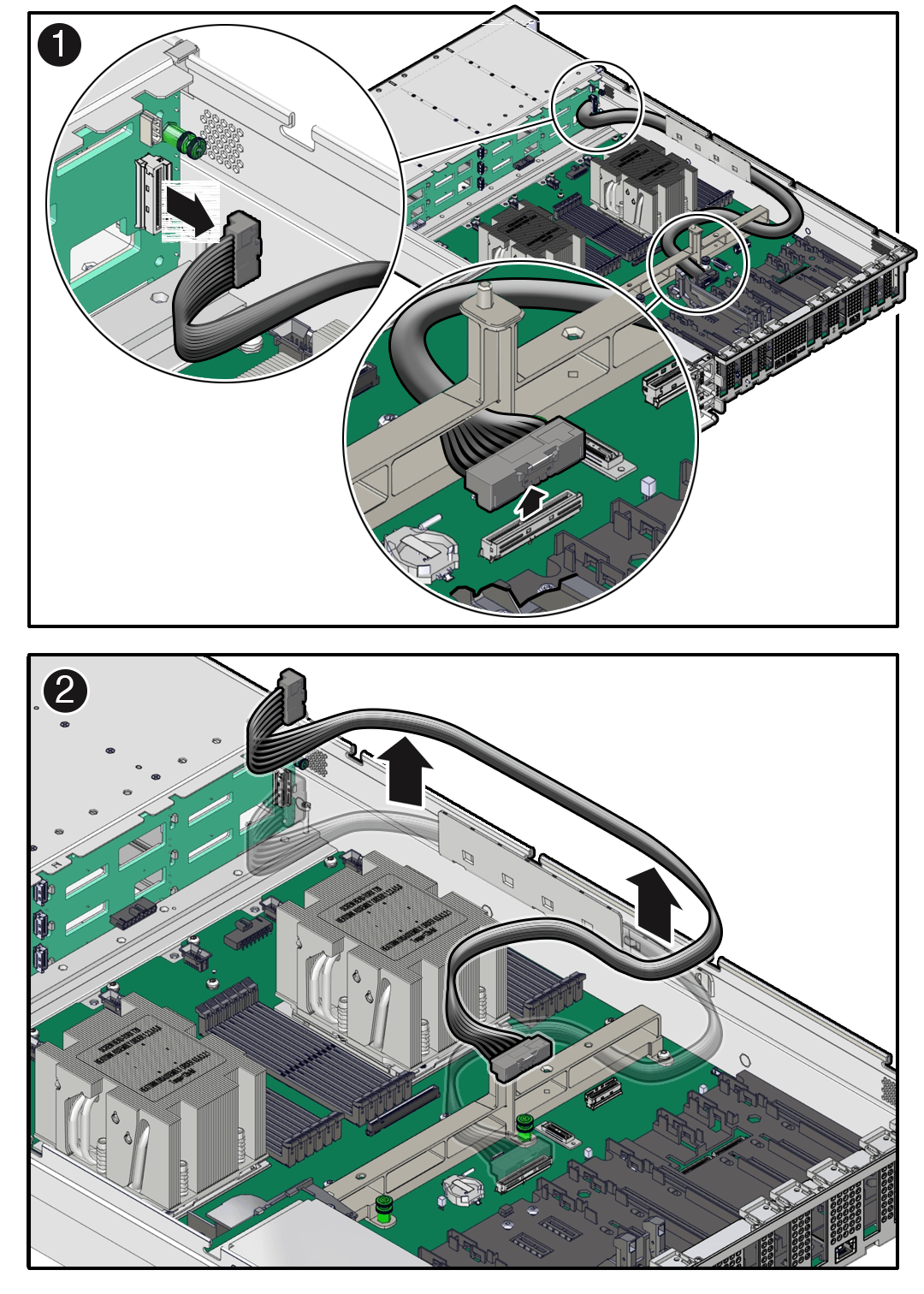

  10. Locate the disk backplane signal cable. The disk backplane signal cable is connected between the 4 or 12 disk backplane and the motherboard connector, which is located between PCIe slot 4 and the motherboard handle. The signal cable is routed from the disk backplane, through the left-side cable trough, and then through the motherboard handle before connecting to the motherboard [1, 2].
    backplane
  11. Disconnect and remove the disk backplane signal cable from the server.
  12. Disconnect the signal cable from the disk backplane and the motherboard [1]. At each end of the signal cable, press and hold the connector to disengage the locking mechanism, then gently lift the connector from the disk backplane and motherboard.
  13. For information on disconnecting the disk backplane signal cable from the 4-disk backplane, see Remove the 4-Drive Backplane.
  14. Remove the cable from the server. Gently direct the cable through the motherboard handle and then lift the cable from the left-side cable trough [2]. Ensure that the disk backplane signal cable is free from snagging motherboard components and other cables in the server. You might need to remove the SAS cables from the left-side cable trough before removing the disk backplane signal cable. See Remove SAS Storage Drive Cables.

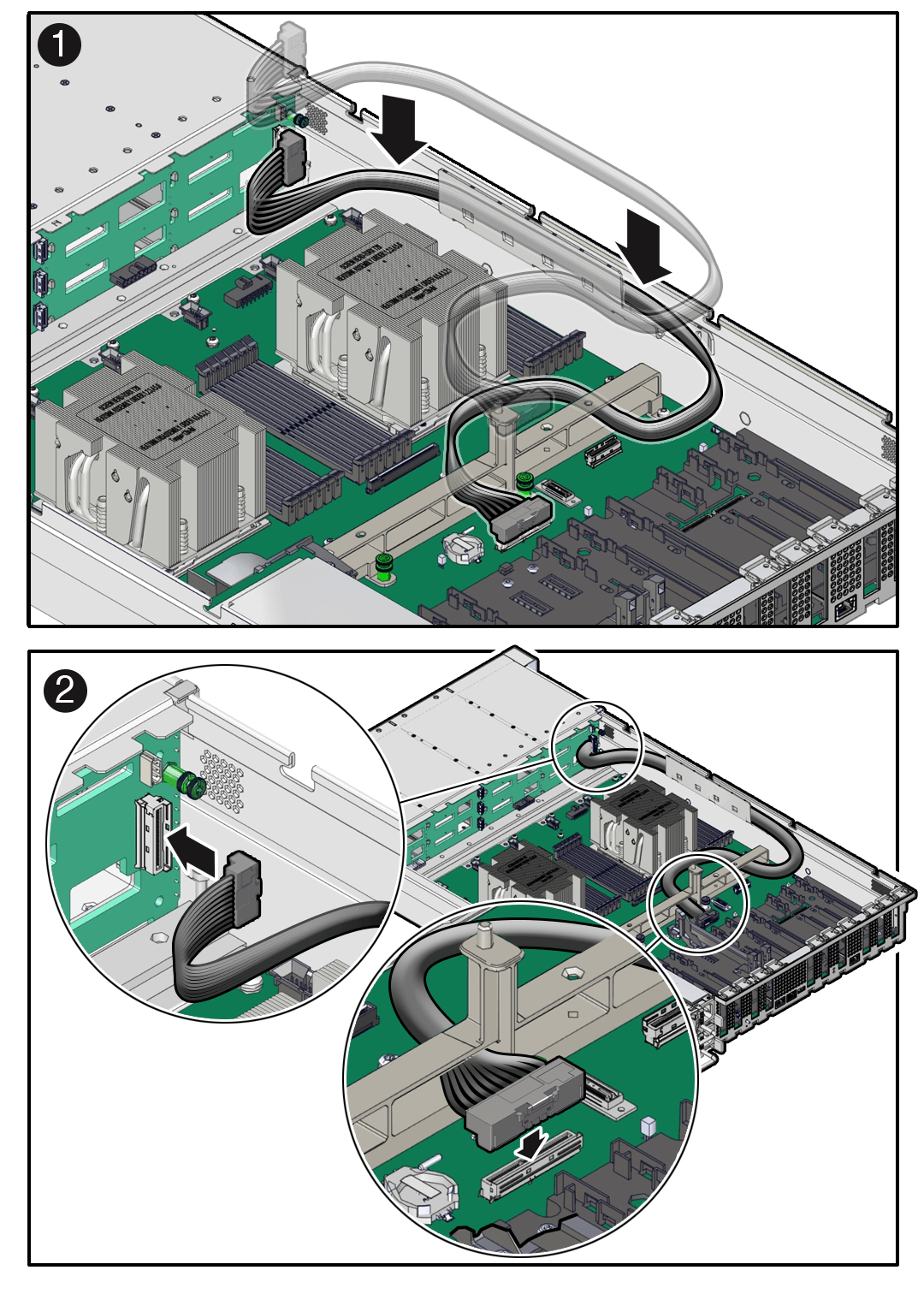

  2. Install the disk backplane signal cable between the disk backplane and motherboard connectors [1]. Route the signal cable through the left-side cable trough and then through the motherboard handle.
    install
    Ensure that the disk backplane signal cable is free from snagging motherboard components and other cables in the server. You might need to remove the SAS cables from the left-side cable trough before installing the disk backplane signal cable. See Remove SAS Storage Drive Cables.
  3. Reconnect the disk backplane signal cable to the disk backplane and the motherboard. Plug each end of the cable into its connector until you hear an audible click [2]. For information on reconnecting the disk backplane signal cable to the 4-disk backplane, see Install the 4-Drive Backplane.
