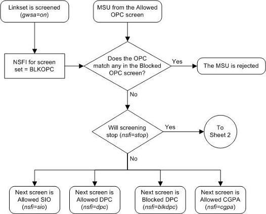

Blocked OPC Screening Actions
Figure 11-1 through Figure 11-3 show the screening actions of the blocked OPC screen.
Figure 11-1 Blocked OPC Screening Actions - Sheet 1 of 3
img/blocked_opc-1_231.jpg

Figure 11-5 Add a Blocked OPC Screen - Sheet 1 of 5
Figure 11-6 Add a Blocked OPC Screen - Sheet 2 of 5
Figure 11-7 Add a Blocked OPC Screen - Sheet 3 of 5
Figure 11-8 Add a Blocked OPC Screen - Sheet 4 of 5
Figure 11-9 Add a Blocked OPC Screen - Sheet 5 of 5

Figure 11-11 Change a Blocked OPC Screen - Sheet 1 of 5
Figure 11-12 Change a Blocked OPC Screen - Sheet 2 of 5
Figure 11-13 Change a Blocked OPC Screen - Sheet 3 of 5
Figure 11-14 Change a Blocked OPC Screen - Sheet 4 of 5
Figure 11-15 Change a Blocked OPC Screen - Sheet 5 of 5
