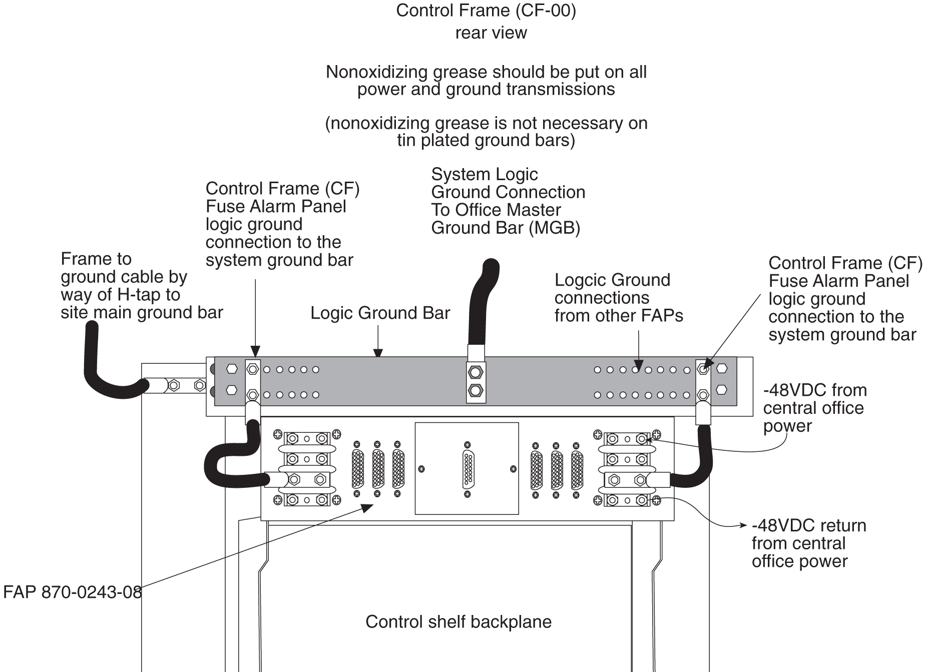

Grounding
The system operates as a digital isolated ground plane system in a central office environment and requires a single connection to the central office ground window. The system’s ground bars and ground cables must provide the sole grounding connection between the entire system and the central office grounding.
The system uses three types of grounding paths:
  • Battery return
  • Frame/chassis ground
  • Logic ground
Non-oxidizing grease will be applied to all lugs terminated on a copper system ground bar. Refer to Figure 5-1.
The power return grounding path is the return path for all –48VDC loads in the system. This path is isolated from other system grounds and connects to the rest of the central office through the –48VDC return connections located on the Fuse and Alarm Panel (FAP) of each frame.
The frame/chassis ground path provides a low impedance connection for all metal parts of the entire system, including the frame, doors, card cages, and end panels. Each frame/chassis connection within the system lineup terminates to the frame and connects to the main ground bar by way of Htaps, #6 American Wire Gauge (AWG) to 1/0 cable.
The logic ground path provides a common voltage reference point between all circuit boards of an system. Each connection terminates to the system ground bar on the control frame.
The frame/chassis and logic ground paths are both noncurrent carrying paths.

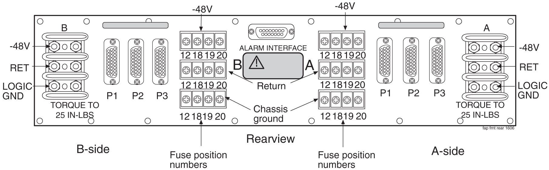

warning:
The power (-48 VDC) and return connections of FAP (P/N 870-0243-08) and (P/N 870-1606-xx) are physically reversed at the input terminal. See Figure 5-1 and Figure 5-2 for wiring information.
Figure 5-1 Logic Grounding with FAP (P/N 870-0243-08)

Figure 5-2 Logic Grounding with FAP (P/N 870-1606-xx/870-2320-xx)
img/r_grounding_hws-fig2.jpg
The doors installed are grounded to the frame through a double lug ground wire (see Figure 5-3) and through a screw-down latch.

Each frame requires that power be provided from two fuses/breakers at –48VDC. Additional peripherals that require alternating current (for example but not limited to, terminals, printers, and modems) must be compatible with the system and have a separate ground from the frames.
Each frame is divided into A and B power buses. In the event of loss of power on one of the buses, the other bus must be able to supply current for the entire frame. Therefore, each bus requires wiring sized to handle up to the maximum amps at –48VDC, with a maximum voltage drop of 0.5 volts. To meet this specification you must:
  • For new installations of Control and Extension Frames (as of Release 34.0) use 60 amp breakers (see note), the ELAP frames use 30 amp and 60 amp breakers, and the EPAP frames use 30 amp breakers. Local Alarms for the Frame’s Power Distribution System are provided at each frame.
    Existing frames that are fused at 40 amps can be upgraded to support 60 amps with a FAP upgrade kit. 60 amps is required for frames that contain HC-MIMs.
  • Use #6, two-hole, #10 Bolt, 5/8" on center lug with windows (P/N 502-0085-01) for fuse and alarm panel connectors.
    If breakers are tripped by an overload, they must be switched completely OFF and then ON to reset.

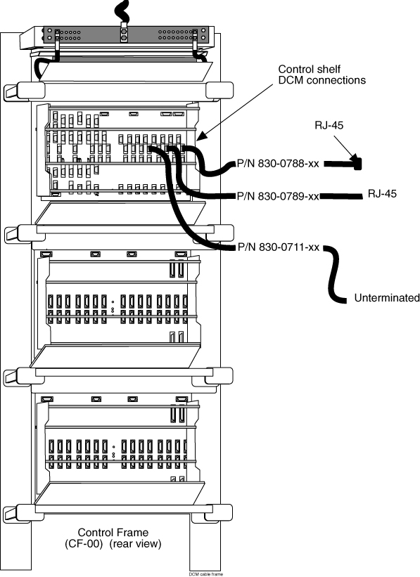

Cabling DCM, Double-Slot EDCM, and E5-SM8G Cards
The DCM and E5-SM8G cards support only Category 5 (100-Ohm) shielded twisted pair cables. In order to meet Electromagnetic Interference (EMI) requirements, the cards may require a point-to-point connection or a connection to a hub/router. This must be identified to the customer who may be preparing the location. The figure that follows shows the cable types and part numbers.
The maximum cable length has not been determined but will be less than 100 meters.
Three specific DCM cables are required:
  • Customer patch panel “straight through” (P/N 830-0788-xx)
  • Customer patch panel “crossover” (P/N 830-0789-xx)
  • 100-BASETX interface to unterminated (P/N 830-0711-xx)
Figure 5-4 Database Communications Cabling in System
img/c_dcm_cable_frame_x.jpg
