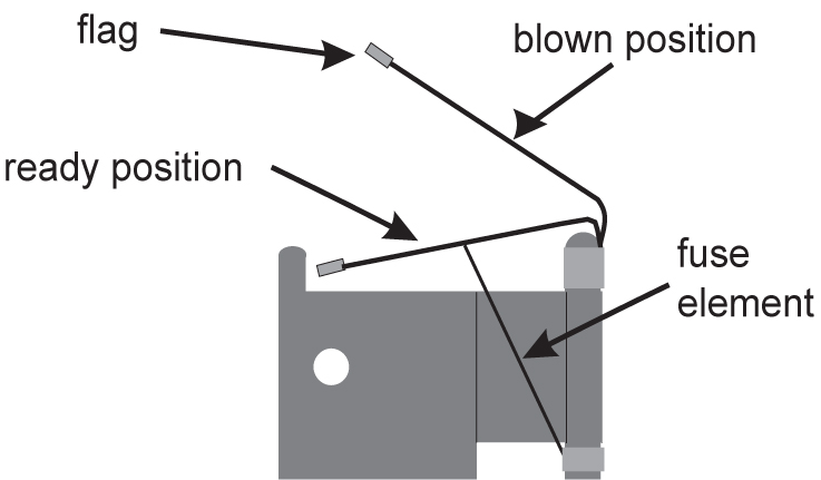

Fuses
The fuse and alarm panel uses GMT-type fuses of different amperage ratings for individual circuit protection. If a frame circuit fuse is blown the alarm is indicated by an LED on the front panel and a small colored flag on the fuse shows the fuse that has failed (refer to Figure 5-1. Refer to Maintenance for procedures on replacing fuses and the FAP assembly.
Caution:
Always use a fuse of the same type and amperage rating when replacing a failed fuse.
Figure 5-1 Fuse (GMT Brand Shown)
img/r_fuses_hws-fig1.jpg
Table 5-1 Fuse Color Codes of Alarm Flags

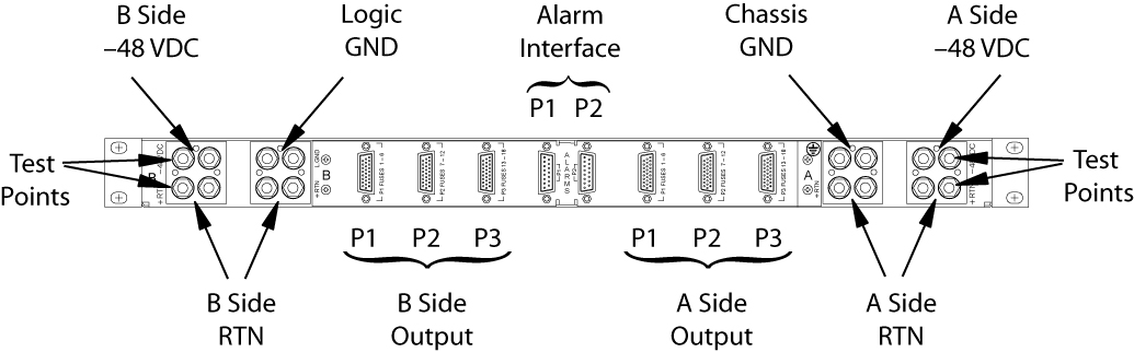

Figure 5-3 and Table 5-4 describes the rear panel configuration. Refer to Installation for cabling connection information.
Figure 5-3 Fuse and Alarm Panel Rear (P/N870-2804-01).
img/r_fuse_and_alarm_panel_1u_im-fig21.jpg
Table 5-4 Fuse and Alarm Panel Rear Items (P/N870-2804-01).
Fuse Panel Item Description
Input Terminal Block A
Input and Return for power source A and FAP Chassis Ground
Input Terminal Block B
Input and Return for power source B and FAP Logic Ground
–48VDC Outputs A
26-pin “D” connectors for A-side outputs:
  • P1 - Fuses 1 through 6
  • P2 - Fuses 7 through 12
  • P3 - Fuses 13 through 18
–48VDC Outputs B
26-pin “D” connectors for B-side outputs:
Alarm Interface
15-pin “D” connectors:
  • P1 to the EAGLE
  • P2 to a power distribution breaker panel

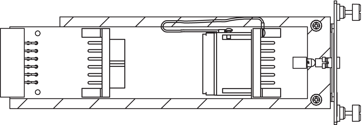

Shorting Board
The Shorting board allows the removal of the diode board without taking down the system. This permits periodic maintenance of the diodes without having to power down or remove the unit from the shelf. The Shorting board has an LED which is off when the board is in normal operational mode and is green when in the bypass mode of operation. With the Shorting Board in the maintenance mode, the Diode Board can be removed for maintenance while still allowing the FAP to operate. No OR'ed power is available in this mode. After installing the Diode Board, the Shorting Board must be reset to normal mode.
Maintenance Mode
This section describes how to place the Shorting Board into maintenance (bypass) mode. Maintenance mode allows the removal of the Diode Board without taking down the system.
Procedure — Shorting Board Maintenance Mode
  1. Check to verify the Shorting Board LED is not on, indicating the FAP is in normal mode.2.
  2. Locate two screws securing the Shorting Board in its slot (see Figure 5-4). Note the orientation of the Shorting Board LED. Turn the screws at each corner of the board to the left until they disengage.
    Figure 5-4 Shorting Board Faceplate, Normal Mode
    img/c_jumper_board_1u_sbops_mode_im-fig1.jpg
  3. Pull the board straight out of the FAP until the board is clear of the frame.
  4. Turn the Shorting Board over and reinsert the board into its slot. Note the orientation of the Shorting Board LED (see Figure 5-5).
    Figure 5-5 Shorting Board Faceplate, Maintenance Mode
    img/c_jumper_board_1u_sbmtc_mode_im-fig1.jpg
    The Shorting Board LED turns green and the fuse alarm LEDs turn red.
  5. Ensure the board is seated properly and tighten the two screws to secure the board.
  6. The Shorting Board is now in the maintenance (bypass) mode of operation.
Normal Mode
Use this procedure to place the Shorting board into normal mode. This mode of operation allows one bus to pick up the entire load when there is a loss of input power on the other bus.
Procedure — Shorting Board Normal Mode
  1. Check to verify the Shorting Board LED is green, indicating the FAP is in maintenance mode.
  2. Locate two screws securing the Shorting Board in its slot. Note the orientation of the Shorting Board LED (Figure 5-6). Turn the screws at each corner of the board to the left until they disengage.
    Figure 5-6 Shorting Board Faceplate, Maintenance Mode
  4. Turn the Shorting Board over and reinsert the board into its slot. Note the orientation of the Shorting Board LED (see Figure 5-7).
    Figure 5-7 Shorting Board Faceplate, Normal Mode
    The Shorting Board LED is off and the fuse alarm LEDs turn green.
  6. The Shorting Board is now in the normal mode of operation.

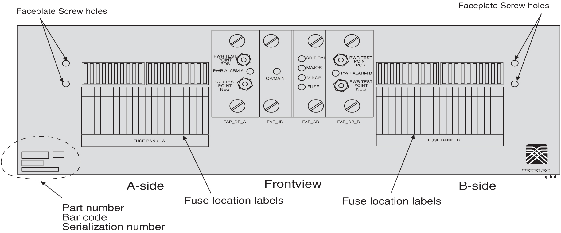

Fuse and Alarm Panel (P/N 870-1606-xx/870-2320-xx)
The FAP P/N 870-1606-xx can be installed in standard frames. The FAP P/N 870-2320-xx can be installed in heavy duty frames.
The FAP contains an alarm board, two diode boards, and a jumper board. These boards are located at the front center of the FAP. The fuse holders are to the left and right of these boards as shown in Figure 5-8.
The alarm board contains a FUSELED to indicate a failed fuse (for either bus A or B) and LEDs to indicate Critical, Major, and Minor alarms generated by the system that are applicable to that frame which the FAP is installed.
There are two diode boards in the FAP, one for bus A and one for bus B. Each diode board contains power diodes and circuitry which allow one bus to pick up the entire load when there is a loss of input power on the other bus. An LED indicates the input power state to the FAP. The LED is green when input power is applied to that bus of the FAP and is red when there is no input power to that bus of the FAP.
The Maintenance (Jumper) board allows the removal of one or both diode boards without taking down the system. The Jumper board has two connectors and a connector plug. During normal operation, the connector plug is seated on the first connector. For maintenance operation, the jumper board has to be removed and the connector plug moved to the second connector. In the maintenance position, the connector plug connects both A and B power feeds to the fuse panels so one or both diode boards can be safely removed. The OP/MAINTLED is green when the Jumper board is in normal operational mode and is red when in the maintenance mode of operation. Refer to Maintenance.
Figure 5-8 and Table 5-6 describes the front panel configuration of the fuse and alarm panel (P/N 870-1606-xx/870-2320-xx).
Figure 5-8 Fuse and Alarm Panel (P/N 870-1606-xx/870-2320-xx) Front
img/r_fuses_hws-fig6.jpg
Table 5-6 Fuse and Alarm Panel Front Items
Fuse Panel Item
Description
Fuse Positions
Two groups of 20 GMT fuses
PWR ALARM
LED indicator for A or B diode board input power
  • Green - input power applied
  • Red - no input power to board
OP/MAINT
LED indicator for mode of operation
  • Green - normal
  • Red - maintenance
FUSE
LED indicator for fuse fail alarm
  • Green - normal
  • Red - blown fuse
CRITICAL
LED indicator for frame critical alarm
MAJOR
LED indicator for frame major alarm
MINOR
LED indicator for frame minor alarm

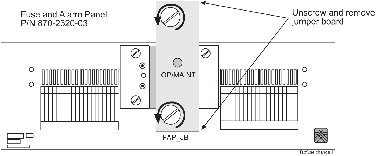

Jumper Board
The Jumper board has two connectors and a connector plug. During normal operation, the connector plug is seated on the first connector. For maintenance operation, the jumper board has to be removed and the connector plug moved to the second connector. In the maintenance position, the connector plug connects both A and B power feeds to the fuse panels so one or both diode boards can be safely removed. The OP/MAINT LED is green when the Jumper board is in normal operational mode and is red when in the maintenance mode of operation.
Maintenance Mode
Use this procedure to place the jumper board into maintenance mode. Maintenance mode allows the removal of one or both diode boards without taking down the system.
Procedure — Maintenance Mode
  1. Locate the jumper board on the Fuse and Alarm Panel (FAP). See Figure 5-10.
    Figure 5-10 Jumper Board FAP
    img/c_jumper_board_mode_im-fig1.jpg
  2. Remove the Jumper Board (FAP_JB) by turning the top and bottom screws to the left until they disengage.
  4. On the jumper circuit board, unclip the 12-pin connector jumper from P71 and re-attach it to P72. Insert it until the plastic retaining clips “snap”. See Figure 5-11. Note that the jumper has a retaining strap so it will not get dropped or lost. This repositioning overrides the diodes, establishing a direct connection between the input and fuse panels.
    Figure 5-11 Jumper Connector - Maintenance Mode.
    img/c_jumper_board_mode_im-fig2.jpg
  5. Slide the jumper board back into the FAP and verify both of the following alarms display:
    • the OP/MAINT LED lights red on the FAP
    • an EAGLE fuse alarm displays on the terminal
    You may now remove either or both diode circuit boards without affecting EAGLE service.
    Using the jumper override negates the backpower protection usually provided by the diode board.
    The jumper board maintenance mode procedure is completed.
Procedure — Operational Mode
  2. Unscrew the two thumbscrews securing the FAP jumper board and remove the board.
  3. On the jumper circuit board, unclip the 12-pin connector jumper from P72 and re-attach it to P71. Insert it until the plastic retaining clips “snap”. See Figure 5-12. Note that the jumper has a retaining strap so it will not get dropped or lost. This repositioning establishes a connection between the diode boards with the input and fuse panels.
    Figure 5-12 Jumper Connector - Operational Mode.
    img/c_jumper_board_mode_im-fig3.jpg
  4. Slide the jumper board back into the FAP. Verify the OP/MAINT LED lights green. The fuse alarm LED returns to green.
    The jumper board operational mode procedure is completed.

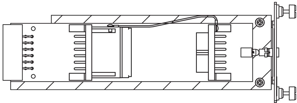

Use this procedure to place the jumper board into operational mode. This mode of operation allows one bus to pick up the entire load when there is a loss of input power on the other bus.
  3. On the jumper circuit board, unclip the 12-pin connector jumper from P72 and re-attach it to P71. Insert it until the plastic retaining clips “snap”. Note that the jumper has a retaining strap so it will not get dropped or lost. This repositioning establishes a connection between the diode boards with the input and fuse panels.
    Figure 5-13 Jumper Connector - Operational Mode.

    Figure 5-15 1U Fuse and Alarm Panel Rear (P/N 870-2804-01)
    img/r_fuse_and_alarm_panel_1u_im-fig2.jpg
    Figure 5-16 3U Fuse and Alarm Panel Rear (P/N 870-2320-03))
    img/r_fuse_and_alarm_panel_870_2320_01_03_im-fig11.jpg
    Tighten the lugs to:
    • 1U FAP, torque to 50 inch-pounds
    • 3U FAP, torque to 25 inch-pounds
  10. Verify correct connection with a multimeter by running continuity check.
  11. Replace the clear plastic cover on the back of the fuse and alarm panel.

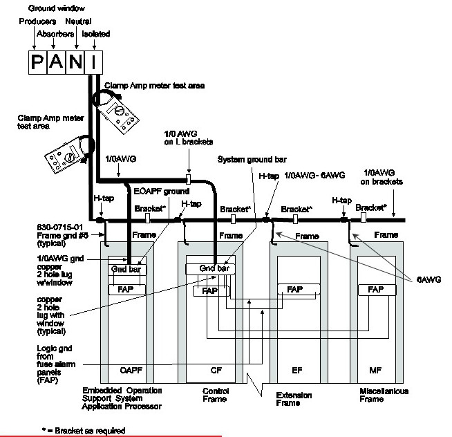

  1. Install the continuous ground conductor to the Ground Window. Run the conductor the length of the equipment lineup (see the figure below).
    The separate #6 American Wire Gauge (AWG) cable ground that runs to each frame will allow removal of a frame from the lineup without interrupting the grounding of other frames in the lineup.
  2. Install the branch ground conductor to the frame using screws and washers.
    The continuous aisle ground conductor will be H-tapped to the branch (see the figure below). Torque screws to 45 inch-pounds.
    Figure 5-17 System Frame Grounding
    img/t_system_frame_grounding.jpg
  3. Secure the cable to the cable brackets with lacing cord.
  4. Cables must be labeled, 145P tags should have “TO” and “FROM” location information.
    Example: FROM MGB (Main Ground Bar), TO system ground bar Control Frame, CF00.

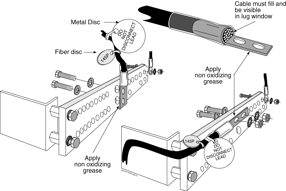

  5. DO NOT “double lug”: The practice of using one bolt through a lug and the ground bar, and through another lug on the other side of the ground bar, held in place by one nut.
  6. A bolt through any nut must show at least two threads beyond the nut but no more than four threads should be showing.

    System Ground: 1/0 cable from the system ground bar to the “I” section of the ground window. If no ground window exists, the customer will designate the termination point.
    Frame Ground: A cable #6 AWG from a frame is H-tapped into 1/0 cable and also terminates on the “I” section of the ground window.
    The size of the cable is determined by the overall length of the cable run. Refer to the Site File Book.

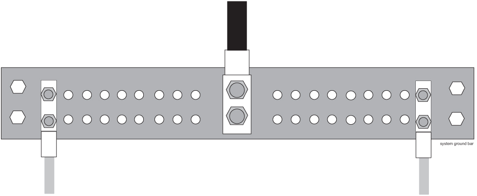

Logic Ground Connections to the System Ground Bar
It is a requirement that when mating dissimilar metals non oxidizing grease is used between them as a corrosion inhibitor.
  1. Place a clear heat-shrink on the cable.
  2. Butt, strip the end of the cable, and apply a small amount of non oxidizing grease to the conductor.
    The stripped cable must fill lug completely to the end of the barrel of the lug and be visible in the end window of the lug.
  3. Crimp #6 American Wire Gauge (AWG) lug with window on the cable, using an embossing crimper.
  4. Apply a small amount of non oxidizing grease to the mounting holes on a copper system ground bar, Non oxidizing grease is not needed on a tin ground bar, where the lug contacts the ground bar.
  5. Crimp a #6 AWG lug with a window on the cable.
    Use an embossing crimper. The stripped cable must fill lug completely to the end of the barrel of the lug and be visible in the end window of the lug.
    warning:
    All logic ground connections must be made to the system ground bar.
    Figure 5-20 System Logic Ground Bar and Cable
    img/t_logic_ground_connections_to_the_system_ground_bar_im-fig1.jpg
    It may be necessary to drill the central office ground window bar to accept the 3/8-inch bolts on one-inch centers. Apply the 145P cable tags (see Figure 5-24) provided to both ends of the ground cable, including the “Do Not Disconnect”.
  6. Install the logic ground cable lugs P/N 804-0817-R02 using the 1/4-inch 20 copper-plated hardware provided (refer to Figure 5-20).
    Tighten the bolts to 68 inch-pounds.
    Figure 5-21 System Logic Grounding
    img/t_logic_ground_connections_to_the_system_ground_bar_im-fig2.jpg
    The only ground cables that are terminated to the system ground bar are the logic grounds from the fuse and alarm panel.

    Figure 5-22 1U Fuse and Alarm Panel Rear (P/N 870-2804-01)
    Figure 5-23 3U Fuse and Alarm Panel Rear (P/N 870-2320-03))
  9. Tighten the nuts on the fuse and alarm panel.
    • 1U FAP, torque to 50 inch-pounds.
    • 3U FAP, torque to 25 inch-pounds.

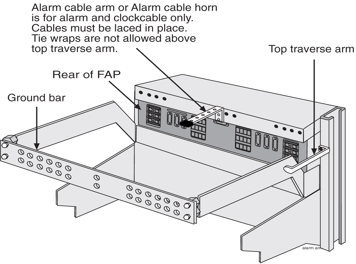

    Figure 5-26 Alarm Cable Arm
    img/t_logic_ground_cables_im-fig3.jpg
    The alarm cable arm is for alarm cable which maybe a clock cable.

Table 5-10 Fuse Color Codes of Alarm Flags
Fuse Amp Fuse Flag Color Fuse Amp Fuse Flag Color
0.18A
Orange-Red
2A
Orange
0.2A
Black-Red
2.5A
White-Orange
0.25A
Violet
3A
Blue
0.33A
Yellow-Green
3.5A
White-Blue
0.375A
White-Green
4A
White -Brown
0.5A
Red
5A
Green
0.65A
Black
7.5A
Black-White
0.75A
Brown
10A
Red-White
1A
Gray
12A
Yellow-Green
1.33A
White
15A
Red-Blue
1.5A
White-Yellow
Procedure - Verify Individual Fuse Positions
  1. Ensure that all fuses have been removed.
  2. Ensure that all circuit cards have been removed.
  3. Confirm that the system is receiving power from the –48VDC power source.
    (Ensure that voltage is present by checking it with a volt ohm meter.)
  4. Install a fuse of the rating specified for that position.
  5. Install circuit cards appropriate for the slots powered by that fuse.
  6. Check that LEDs of the applicable cards are on.
    For each fuse position, perform Steps 7 through 16.
  7. Pull the fuse for the A-side position.
  8. Check that the Fuse Alarm LED for the A-side is red.
  9. Check that the LEDs of the cards in the specified locations are illuminated after the removal of the fuse.
  10. Replace the fuse for the A-side position.
  11. Check that the Fuse Alarm LED for the A-side is green.
  12. Check that the LEDs of the cards in the specified locations are illuminated.
  13. Pull the fuse for the B-side position.
  14. Check that the Fuse Alarm LED for the B-side is red.
  15. Check that the LEDs of the cards in the specified locations are illuminated after the removal of the fuse.
  16. Pull the fuse for the A-side position.
  17. Check that the Fuse Alarm LED for the A-side is red.
  18. Check that the LEDs of the cards in the specified locations are not illuminated after the removal of the fuse.
  19. Replace the fuse for the A-side and B-side position.
  20. Check that the Fuse Alarm LED for the A-side and B-side is green.
  21. Check that the LEDs of the cards in the specified locations are illuminated after the replacing of the fuses.
This completes individual fuse position testing of the FAP. Return the frame to service.

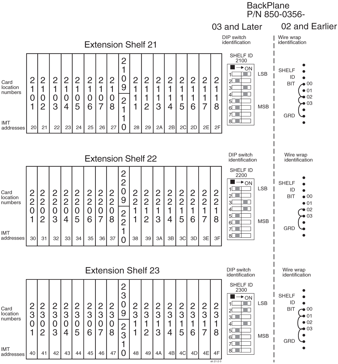

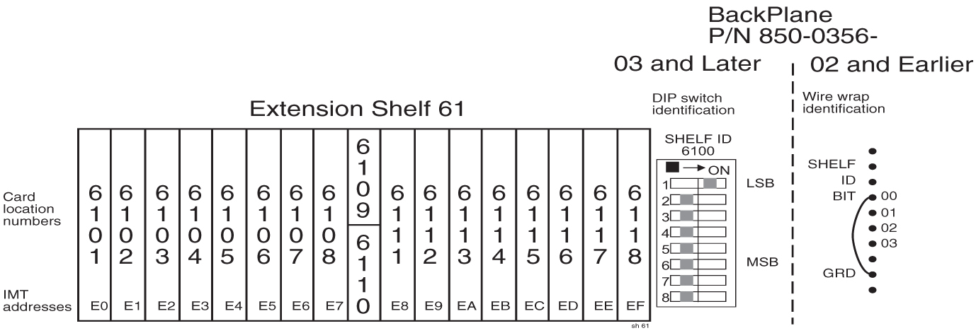

Fuse and Card Locations
This section describes fuse assignments for the Control Frame (CF-00) and five Extension Frames (EF-00 through EF-04) are shown.
Table 5-11 Fuses and Card Locations

Card Locations in Control and Extension Shelves
Figure 5-30 through Figure 5-35 show the card locations in Control and Extension shelves.
Figure 5-30 shows the numbering of the shelves, with the shelf identification DIP switch settings and backplane wiring, and card locations on theControl Frame (CF) and Extension Frame (EF).
Figure 5-30 Control Frame CF-00 Numbering Plan
img/r_card_locations_in_control_and_extension_shelves_im-fig1.jpg
The Extension Frame (EF) accommodates up to three extension shelves, each shelf capable of supporting up to 16 Link Interface Module (LIMs) or Translation Service Module (TSMs) in any combination.
The system is delivered with customer-specific locations for the Database Communications Module (DCM.
For EAGLE only, the insertion of a DCM card requires an odd-numbered slot.
The entire system can have up to five Extension Frames, EF-00 to EF-04. EF-04 supports only one extension shelf.
Figure 5-31 through Figure 5-35 show the numbering of the card locations on the extension frames. Along with shelf DIP switch settings and ID wire wrap.
Figure 5-31 Extension Frame EF-00 Numbering Plan
img/r_card_locations_in_control_and_extension_shelves_im-fig2.jpg
Figure 5-32 Extension Frame EF-01 Numbering Plan
img/r_card_locations_in_control_and_extension_shelves_im-fig3.jpg
Figure 5-33 Extension Frame EF-02 Numbering Plan
img/r_card_locations_in_control_and_extension_shelves_im-fig4.jpg
Figure 5-34 Extension Frame EF-03 Numbering Plan
img/r_card_locations_in_control_and_extension_shelves_im-fig5.jpg
Figure 5-35 Extension Frame EF-04 Numbering Plan
img/r_card_locations_in_control_and_extension_shelves_im-fig6.jpg
