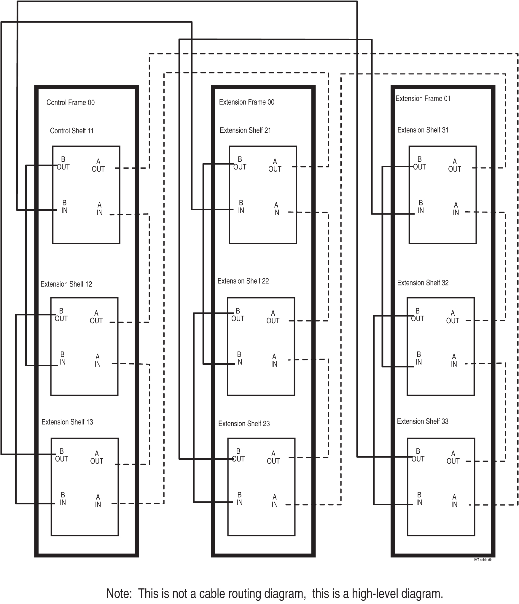

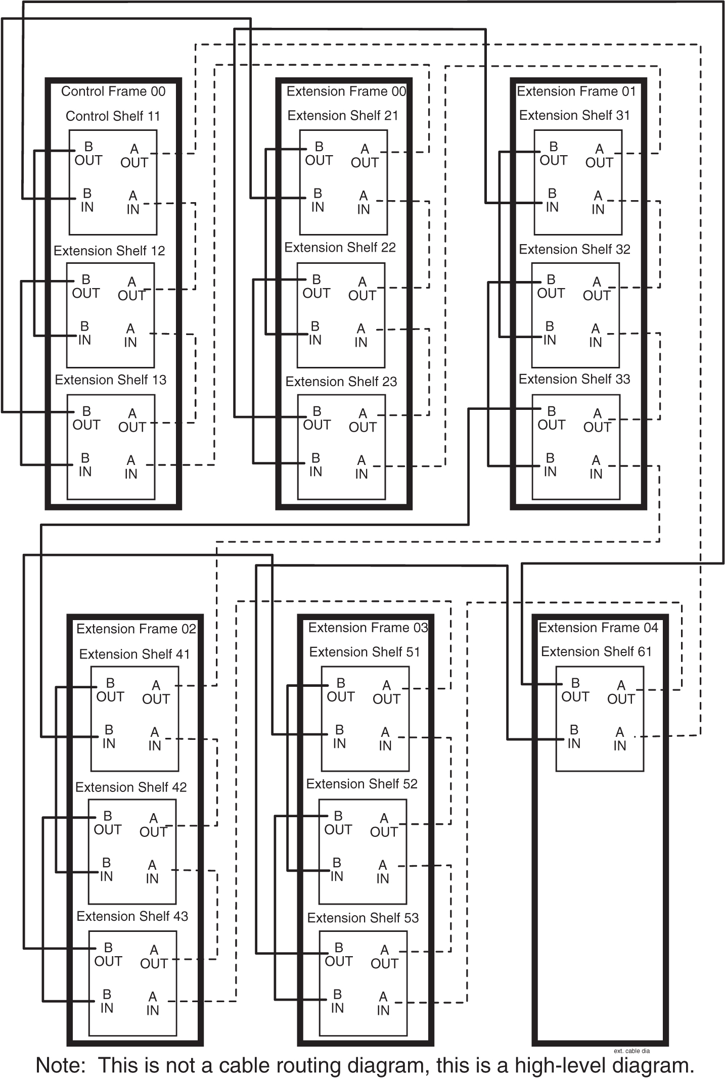

Install IMT Cables
The Interprocessor Message Transport (IMT) cables are specific lengths, based on their application. Termination information is furnished on the cable labels. Refer to Cables and Adapters and Part Numbers
danger:
Always wear a wrist strap or other electrostatic protection when handling printed circuit cards and other electrostatic-sensitive devices.
Procedure — Install IMT Cables

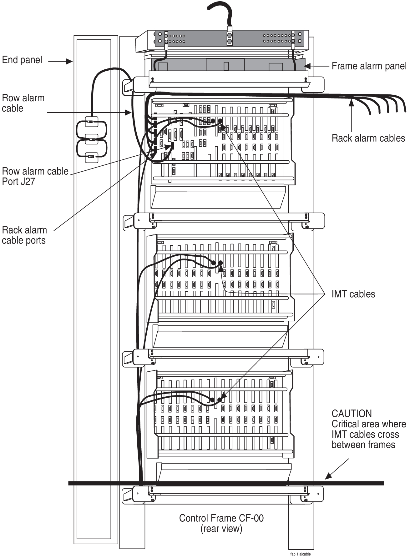

  1. Route the cable and connect to the backplane connector specified on the cable label.
    The IMT cables route down the left side of the frames, see Figure 6-4.

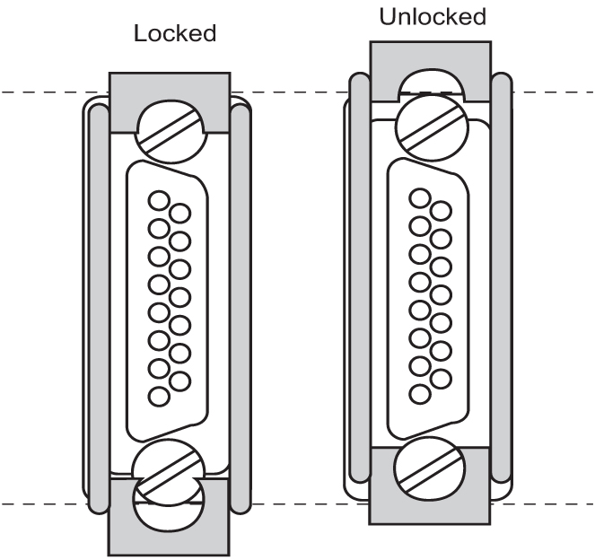

  2. For the IMT cables, tighten the barrel securely on each connector.
    Figure 6-1 Interprocessor Message Transport Cables
    img/t_install_imt_cables_im-fig1.jpg
  3. Dress each cable and secure with cable ties.
    Ensure that each cable tie strap is cut flush with the cable tie head so that no sharp edges are exposed.
    Figure 6-2 Three-Frame Configuration
    img/t_install_imt_cables_im-fig2.jpg
    Figure 6-3 Six-Frame Configuration
    img/t_install_imt_cables_im-fig3.jpg

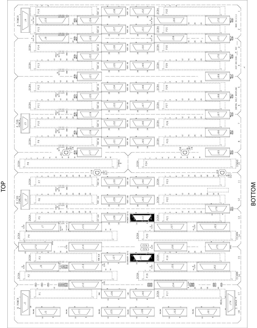

Rack Alarm and Row Alarm Cable Routing
The rack alarm cable leads from ports in the control backplane and connects up to six frames in the row. See Figure 6-4 and A Clock and B Clock Cable Replacement.
The row alarm cable leads from J34 on backplane 850-0330-06/07 or 7333412 on the control shelf backplane and terminates in the control frame end panel.
The clocking and fan control signals used to support frame 6 and frame 7 are eliminated in the 850-0330-06 or -07 version and later of the Control Shelf Backplane because those frames are no longer supported in the EAGLE STP system.
Figure 6-4 Control Shelf Cabling
img/c_rack_alarm_and_row_alarm_cable_routing_im-fig1.jpg

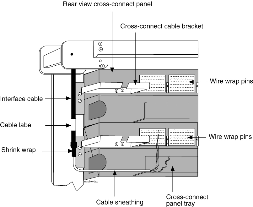

Procedure — Preparing Cables for Wire-Wrap
  1. Remove the insulation from the cable where it is even with the bracket of the associated cross-connect panel as shown in Figure 6-5.
    Do not remove the inner sheath.
  2. Attach the label for the cross-connect end of the cable approximately two inches above the end of the insulation.
  3. Apply a 1-1/2-inch length of 1/4-inch shrink-wrap tubing, taking care to center the tubing on the end of the cable insulation.
    Use heat gun to shrink tubing.
    Do not overheat the cable.
  4. Run the interface cable wires through the cross-connect panel cable tray.
  5. Remove the cable sheathing directly below the cross-connect jack.
  6. Cut the wires to length, strip and wire-wrap to the cross-connect panel.
  7. Cut the cable tie strap flush with the cable tie head.
    Figure 6-5 Interface Cable Cross-Connect Panel Connection
    img/t_recommended_tools_6_im-fig1.jpg
  8. Label DSX panel

    Backplane (P/N 850-0356-03) Connector
    Extension Shelves (XX is shelf location)
    XX01
    J24
    XX02
    J23
    XX03
    J22
    XX04
    J21
    XX05
    J20
    XX06
    J19
    XX07
    J18
    XX08
    J17
    XX11
    J16
    XX12
    J15
    XX13
    J14
    XX14
    J13
    XX15
    J12
    XX16
    J11
    XX17
    J10
    XX18
    J9

    1. Plug the 26-pin side of the adapter into the backplane interface connector.
    2. Start one of the adapter connector screws, and then alternately tighten the two adapter screws.
    3. Ensure the adapter slide latch is in the unlocked (up) position see to Figure 6-6.
    4. Plug the single port MAU into the adapter.
    5. Move the adapter slide latch to the locked (down) position.
    6. For the 10BASE-2 MAU, push the BNC connector on the coax cable onto the MAU and lock the connector in place by twisting the connector clockwise.
      For a 10BASE-T MAU, push the RJ45 connector into the MAU until it snaps into place.
      Figure 6-6 Adapter Slide Latch

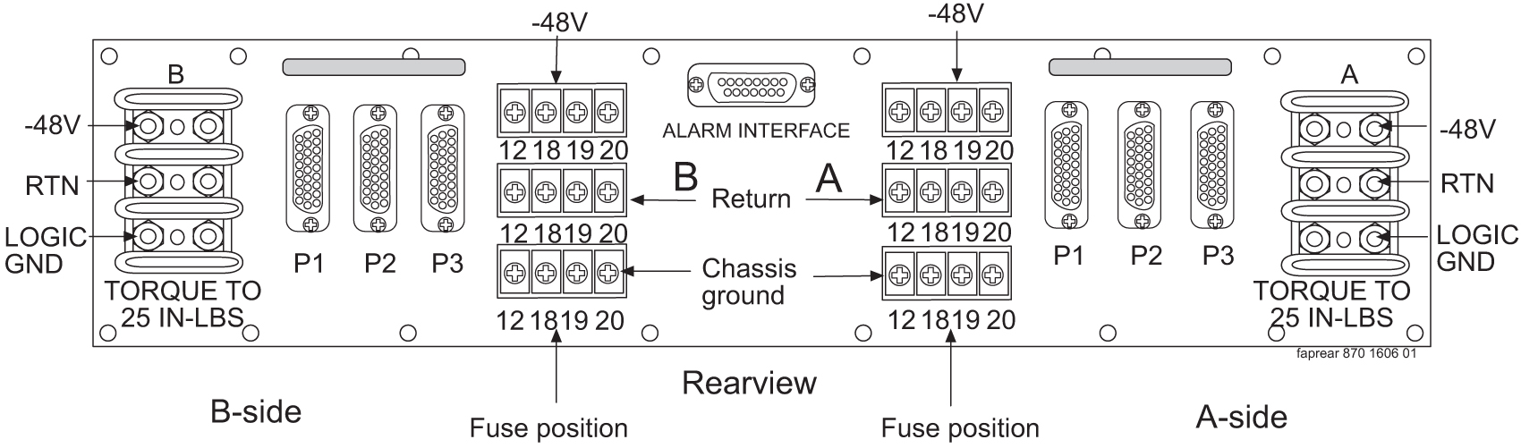

  3. Make sure to pull both dummy fuses from the appropriate fuse locations for the A and B fan power. Use the following guidelines to determine fuse locations:
    • The fuse card located on the Fuse and Alarm Panel is marked FAN A and FAN B. Fuse positions 6, 12, and 18 are the correct locations on the FAP faceplate.
    • Fuse position 6 is for the fan unit directly below the x100 shelf.
    • Fuse position 12 is for the fan directly below the x200 shelf.
    • Fuse position 18 is for the fan directly below the x300 shelf.
    • All fans are to be fused at 3As, with blue flags, per feed. Fill out the fuse card completely.
    • Ensure the FAP fuse location for the fan is properly labeled.

    • The fuse card located on the Fuse and Alarm Panel are marked FAN A and FAN B, fuse positions 6, 12, and 18 are marked correct locations on the FAP faceplate.
    • Fill out the fuse card completely.

All fans are fused at 2A (orange) per feed.
  1. After the fan assembly is installed, the powering up process depends on the shelf location.
    1. The fuse card located on the Fuse and Alarm Panel are marked FAN A and FAN B, fuse positions 6, 12, and 18 are marked correct locations on the FAP faceplate.
    2. Fuse position 6 is for the fan unit directly below the x100 shelf.
    3. Fuse position 12 is for the fan directly below the x200 shelf.
    4. Fuse position 18 is for the fan directly below the x300 shelf.
    5. All 890-1038-xx fans are to be fused at 2As, with orange flags, per feed.
    6. Fill out the fuse card completely.

  1. Before starting the cable replacement, physically locate the:
    • primary and secondary composite clock and high‑speed clock connections at the backplane of the customer composite clock source (customer will provide positions).
    • existing composite clock cables (P/N 830‑0226‑xx) that are routed from the primary and secondary composite clock connections of the customer clock source to the Primary BITS and Secondary BITS clock connectors J49 and J48 on the control shelf. Figure 6-31 shows the location of these connectors on the control shelf backplane.
    Figure 6-31 Control Shelf (P/N 850-0330-06 or -07) BITS Connectors
    img/t_replacing_a_and_b_frame_clock_cables_im-fig7.jpg

  3. Before starting the cable replacement, physically locate the:
    • two new HS clock cables (P/N 830‑0873‑xx) to be connected to the customers HS clock source.
    • adapter cables (P/N (830‑0846‑01).
    • the existing composite clock cables (P/N 830‑0226‑xx) connected to the primary and secondary BITS clock sources and connectors (J42 and J41) on the control shelf backplane.
    • any existing ACLK cables connected to ACLK3 and ACLK4 (J57 and J56) on the control shelf backplane.
      Depending on the amount of extension shelves in the system the cables connecting ACLK3 and ACLK4 to extension frames may not be installed. If these cables are not installed the P2 (DB25) end of the adapter cables (P/N 830‑0846‑01) are not used. Secure the unused P2 end of the adapter cables with tie‑wraps.
    assemblies1.html shows the location of these connectors on the control shelf backplane.
    Figure 6-34 Control Shelf (P/N 850-0330-03 or -04) BITS Connectors
    img/850-0330-04.jpg
Proper support for HMUX and alarm reporting require that all A and B clock cables be of P/N 830-0398-xx (domestic) or P/N 830-1150-xx (international). Clock cables of P/N 830-0404-xx must be replaced. The A and B clock cables typically are from the control shelf and those coming in from an extension shelf. These cables contain proper alarm alert capabilities and support HMUX. See Figure 6-37 and Figure 6-38.
This procedure can also be used for regular clock cable replacement.
Perform the replacement during a maintenance window and prior to fan assembly installation.
Figure 6-37 Cable (P/N 830-0404-xx)
img/t_replacing_a_and_b_frame_clock_cables_im-fig1.jpg
Figure 6-38 Cable 830-0398-xx or 830-1150-xx
img/t_a_b_clock_cable_830_0398_1150.jpg
Procedure — Replacing A Frame Clock Cables
This procedure explains the replacement of one A frame clock cable. The steps show the replacement of one frame clock cable and are repeated for every frame clock cable that is to be replaced.

  7. For the B frame clock cable being replaced remove all tie wraps or lacing cord securing the cable in the frame.
  8. Remove the B frame cable from the shelf’s B CLKOUT connector.
    Figure 6-41 Backplane P/N 850-0330-06 or -07 Control Shelf
    img/t_replacing_a_and_b_frame_clock_cables_im-fig3.jpg
    Figure 6-42 Backplane P/N 850-0356-04 Extension Shelf
    img/t_replacing_a_and_b_frame_clock_cables_im-fig4.jpg
  9. Remove the other end of the frame clock cable from the next shelf’s B CLKIN connector.
  10. Select a new frame clock cable and connect it to the B CLKOUT connector, refer to 8.
  11. Route the clock cable in the frame following the routing directions in this manual.
  12. Connect the other end of the new frame clock cable from B CLKOUT, refer to 10, to the next shelf’s B CLKIN connector.

The rack alarm cables lead from ports in the system control backplane and connect with other frames in the row.
The backplane alarm ports are:
  • FAP (Frame and Alarm Panel) in the control frame J13 on 850-0330-06 or -07
  • FAP extension frame 00 J15 on P/N 850-0330-06 or -07
  • FAP extension frame 01 J32 on P/N 850-0330-06 or -07
  • FAP extension frame 02 J46 on P/N 850-0330-06 or -07
  • FAP extension frame 03 J61 on P/N 850-0330-06 or -07
  • FAP extension frame 04 J68 on P/N 850-0330-06 or -07
  • End panel J34 on P/N 850-0330-06 or -07 (use cable row alarm cable 830-1145-01)
  • J35 and J66 o 850-0330-06 or -07 to holdover clock
  • J69 on 850-0330-06 or -07 to OAPF
  • LMC J47 on850-0330-06 or -07
  • RMC J33 on 850-0330-06 or -07
From the rear of the frame these cables should be routed from the connector around the left side of the frame. Route the cables up the side of the frame to the FAP and secure the cables with lacing cord to the cross arms on the side of the frame. Across the top of the frame secure the cables to the cross arms above the FAP with lacing cord also.
Alarm cables should not be formed with power cables and should have a lacing cord approximately every three inches. There should be no less than two lacing cord ties between frames.
If the end panel does not mount on the control frame, the cable will route the same as alarm rack cables, from port J34 on backplane 850-0330-06 or -07 from the rear of the frame, up the left side of the frame, across the top of the FAP, and formed and dressed with the alarm rack cables to the end panel.

  1. See the “Cable Running List” in the Equipment Specification to determine how to connect the external cables.
    All cable ends must be labeled with “TO” and “FROM” location information from Port to Backplane.
  2. Place the cables on the cable rack.
    Feed the cable ends (with connectors) down the side of the system, outside the cable tie bars, around the top or bottom edge of the control shelf and fan out to the connectors.
  3. Secure each connector to the designated receptacle on the control shelf backplane.
    Plug the connector in, start one of the connector screws, fully tighten the second screw, then fully tighten the first screw.
  4. Tie-wrap each cable to the cable tie bar at the rear of the shelf.
  5. Dress the cables neatly and tie-wrap to the cable tie bars at the side of the frame.
    Pull the slack in the cable back toward the other end of the cables and lace to the cable rack.
  6. Ensure that each tie-wrap strap is cut flush with the tie-wrap head so sharp edges are not exposed.
  7. Attach any necessary adapter to the end of the cable, see 1 of this procedure; then attach cable or cable plus adapter to the device.
    Connect terminal cable adapter 830-0535-xx or 830-1154-xx to modem adapter 830-0535-xx or 830-1153-04.

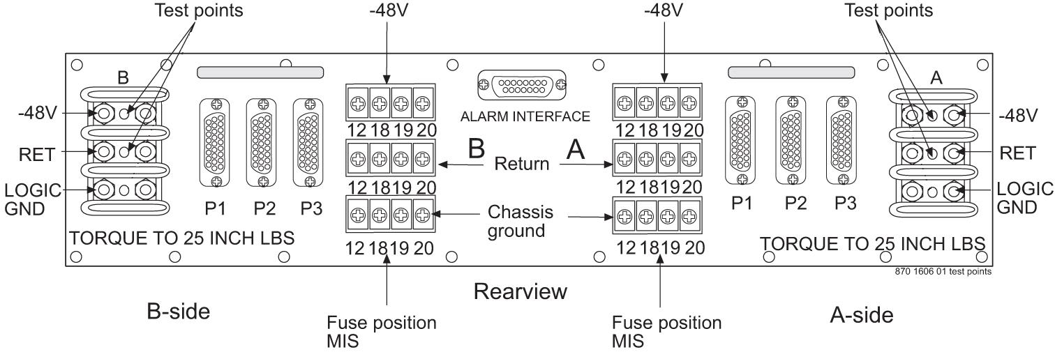

Check that the holdover clock power connections are installed according to Table 6-3 for holdover clock and fuse and alarm panel connections.
See Figure 6-45 and Figure 6-46 for holdover clock connector locations.
See Figure 6-47 and Figure 6-48 for fuse and alarm panel connector locations.
Table 6-3 Holdover Clock Wire Colors and Connections
Holdover Clock Connector Wire Color FAP Connection
TB1 –48VDC
Red
 B side –48VDC #1
TB1 RTN
Black
 B side –48VDC return #1
TB2 –48VDC
Red
 A side –48VDC #1
TB2 RTN
Black
 A side –48VDC return #1
TB1 GND
White
 A side Chassis GND
TB2 GND
White
 B side Chassis GRD
Figure 6-45 Holdover Clock Power Connector
img/c_output_panel_connections_im-fig2.jpg

Verify -48VDC
The following procedure verifies –48VDC.
  1. Turn on breaker, or insert fuse for control frame A side –48VDC power source.
  2. Check for nominal –48VDC at the control frame fuse and alarm panel A side test point.
    For test points used see Figure 6-56 and Figure 6-57.
    Input voltage range is -40 VDC to -57.5 VDC.
    Figure 6-56 Test Points 1U FAP (P/N 870-2804-01)
    img/r_fuse_and_alarm_panel_1u_im-fig2.jpg
    Figure 6-57 Test Points 3U FAP (P/N 870-2320-03)
    img/c_48vdc_power_source_im-fig2.jpg
