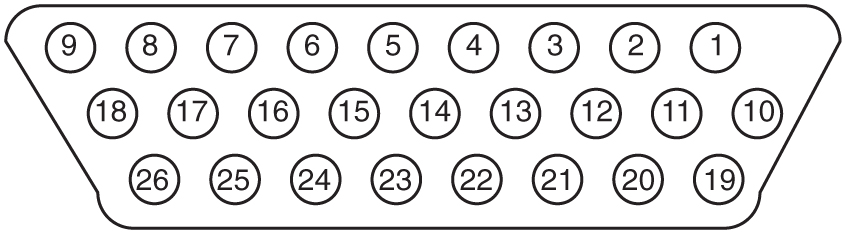

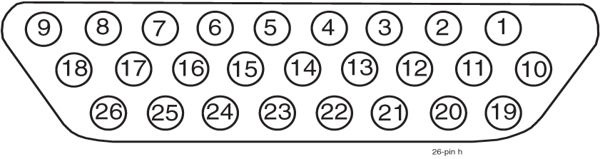

Power Connectors
The control shelf backplane provides –48VDC power and ground to all card positions. The power is distributed into two parts, A and B. Power is brought to the shelf from the Fuse and Alarm Panel (FAP) using two cables. The connectors on the control shelf backplane are DB-26 high density connectors. The power is distributed over two separate pins per power connection to handle the current load.
J1, J4 on Control Shelf backplane 04 J1, J11 Primary and J2, J10 Secondary on Control Shelf backplane 06/07
Figure B-3 Power Connector
Table B-2 Power Connector
Pin | Signal | Pin | Signal |
1 |
P5$48VDC |
14 |
LGND |
2 |
P5$48RTN |
15 |
P3$48RTN |
3 |
P4$48VDC |
16 |
P3$48VDC |
4 |
P4$48RTN |
17 |
P2$48RTN |
5 |
LGND |
18 |
P2$48VDC |
6 |
P3$48RTN |
19 |
P1$48RTN |
7 |
P3$48VDC |
20 |
P1$48RTN |
8 |
P2$48RTN |
21 |
P1$48VDC |
9 |
P2$48VDC |
22 |
P1$48VDC |
10 |
P5$48VDC |
23 |
PF$48RTN |
11 |
P5$48RTN |
24 |
PF$48RTN |
12 |
P4$48VDC |
25 |
PF$48VDC |
13 |
P4$48RTN |
26 |
PF$48VDC |
$= A or B, A POWER (J4) or B POWER (J1) |

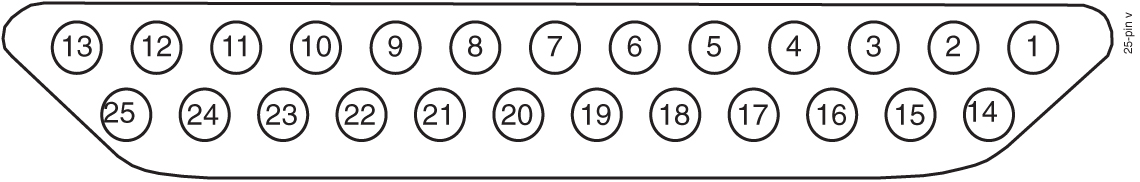

Fuse and Alarm Panel 870-2320-01/03
The FAP provides protected distribution of power to the system. Protection is provided by fuses placed in fuse holders on the front panel. The FAP contains a fuse fail alarm circuit that operates when one or more fuses fail.
Figure B-4 Control/Extension FAP Rear View
Figure B-5 Alarm Interface Connector
Table B-3 Alarm Interface Connector
Pin |
Circuit Descriptions |
1 / 2 / 3 / 4 |
5 |
Critical Alarm |
6 / 7 |
8 |
Fuse Normally Closed |
9 |
10 |
Minor Alarm |
11 |
Major Alarm |
12 |
Common |
13 |
14 |
Test |
15 |
Fuse Normally Open |
Shelf Power
The Fuse and Alarm Panel powers up to three shelves in the frame through the FAP connectors P1, P2, and P3.
Figure B-6 Shelf Power Connector
Table B-4 Shelf Power Connector
Connector | Fuse Position | Pin Numbers | Circuit Descriptions |
P1 (to top shelf in frame) |
1 |
3 and 12 |
+48VDC |
2 and 11 |
48VDC return |
2 |
1 and 10 |
+48VDC |
19 and 20 |
48VDC return |
3 |
21 and 22 |
+48VDC |
4 and 13 |
48VDC return |
4 |
23 and 24 |
+48VDC |
6 and 15 |
48VDC return |
5 |
9 and 18 |
+48VDC |
8 and 17 |
48VDC return |
6 |
7 and 16 |
+48VDC |
25 and 26 |
48VDC return |
P2 (to middle shelf in frame) |
7 |
3 and 12 |
+48VDC |
2 and 11 |
48VDC return |
8 |
1 and 10 |
+48VDC |
19 and 20 |
48VDC return |
9 |
21 and 22 |
+48VDC |
4 and 13 |
48VDC return |
10 |
23 and 24 |
+48VDC |
6 and 15 |
48VDC return |
11 |
9 and 18 |
+48VDC |
8 and 17 |
48VDC return |
12 |
7 and 16 |
+48VDC |
25 and 26 |
48VDC return |
P3 (to bottom shelf in frame) |
13 |
3 and 12 |
+48VDC |
2 and 11 |
48VDC return |
14 |
1 and 10 |
+48VDC |
19 and 20 |
48VDC return |
15 |
21 and 22 |
+48VDC |
4 and 13 |
48VDC return |
16 |
23 and 24 |
+48VDC |
6 and 15 |
48VDC return |
17 |
9 and 18 |
+48VDC |
8 and 17 |
48VDC return |
18 |
7 and 16 |
+48VDC |
25 and 26 |
48VDC return |
P1, P2, and P3 |
5 and 14 |
logic ground |
NOTES: A side and B side connectors, fuse positions, and pins are identical.     All return pins are common. |

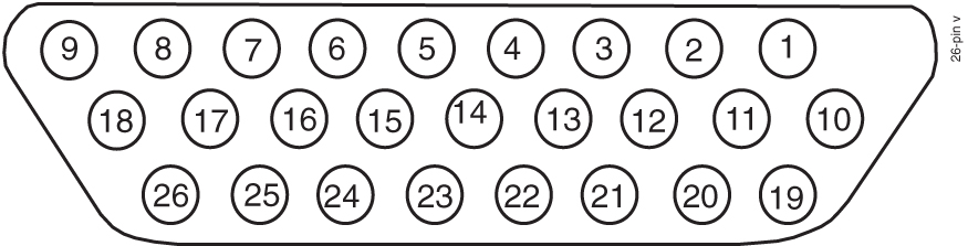

Fan Power
J2, J3 on Control Shelf backplane 04 and J8, J9 on Control Shelf backplane 06/07
Figure B-8 Fan Power Connector
Table B-6 Fan Power Connector
1 |
PF$48RTN |
6 |
FAN$ALM- |
2 |
PF$48RTN |
7 |
3 |
8 |
CHASSIS GND |
4 |
PF$48VDC |
9 |
FANCNTRL |
5 |
PF$48VDC |
$= A or B, A fan power (J3) or B fan power (J2) |

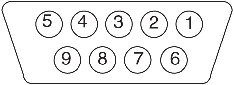

Alarm Connectors

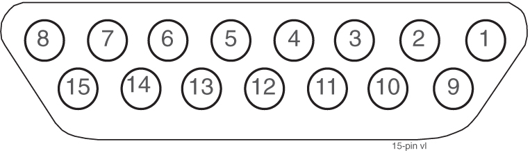

Local Maintenance Center Alarm Connector
Local Maintenance Center Alarm Connector connector provides the system’s alarm condition indicators to the local maintenance center.
J40 on Control Shelf backplane 04 and J47 on Control Shelf backplane 06/07
Figure B-9 Local Maintenance Center Alarm Connector
Table B-7 Local Maintenance Center Alarm Connector
Pin | Signal |
1, 3, 4, 5, 11, 12 |
Not used |
2 |
LMCANC - Local Maintenance Center Audible Alarm, Normally Closed |
6 |
LMCVMJNC - Local Maintenance Center Major Alarm, Normally Closed |
7 |
LMCVMNNC - Local Maintenance Center Minor Alarm, Normally Closed |
8 |
LMCVCRNC - Local Maintenance Center Critical Alarm, Normally Closed |
9 |
LMCACOM - Local Maintenance Center Audible Alarm Common |
10 |
LMCANO - Local Maintenance Center Audible alarm, normally Open |
13 |
LMCVCOM - Local Maintenance Center Common |
14 |
LMCVMJNO - Local Maintenance Center Major Alarm, Normally Open |
15 |
LMCVMNNO - Local Maintenance Center Minor Alarm, Normally Open |

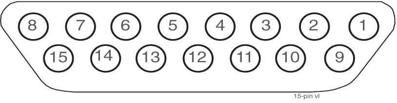

Remote Maintenance Center Alarm Connector
The Remote Maintenance Center Alarm connector provides system alarm condition indicators to the remote maintenance center.
J26 on Control Shelf backplane 04 and J33 on Control Shelf backplane 06/07
Figure B-10 Remote Maintenance Center Alarm Connector
Table B-8 Remote Maintenance Center Alarm Connector
Pin | Signal |
1, 3, 4, 5, 9, 11, 12 |
not used |
2 |
RMCANC - Remote Maintenance Center Audible Alarm, Normally Closed |
6 |
RMCMJNC - Remote Maintenance Center Major Alarm, Normally Closed |
7 |
RMCMNNC - Remote Maintenance Center Minor Alarm, Normally Closed |
8 |
RMCCRNC - Remote Maintenance Center Critical Alarm, Normally Closed |
10 |
RMCANO - Remote Maintenance Center Audible Alarm, Normally Open |
13 |
RMCCOM - Remote Maintenance Center Common |
14 |
RMCMJNO - Remote Maintenance Center Major Alarm, Normally Open |
15 |
RMCMNNO - Remote Maintenance Center Minor Alarm, Normally Open |

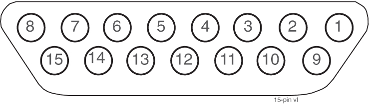

Rack Alarm Connectors
The output of the Rack Alarm Connectors control the alarm condition indicators on each control or extension frame fuse and alarm panel.
J5, J11, J25, J39, J53, J61 on Control Shelf backplane 04 and J13, J15, J32, J46, J61, J68 on Control Shelf backplane 06/07
Figure B-11 Rack Alarm Connector
Table B-9 Rack Alarm Connector
Pin | Signal |
1, 2, 6, 7, 9, 13, 14 |
Not used |
3 |
R$MNNC - Rack Alarm, Minor, Normally Closed |
4 |
R$MJNC - Rack Alarm, Major, Normally Closed |
5 |
R$CRNC - Rack Alarm, Critical, Normally Closed |
8 |
R$FA+ - Rack Fuse Alarm (+) |
10 |
R$MNNO - Rack Alarm, Minor, Normally Open |

Row Alarm Connector
Row Alarm Connector controls the alarm condition indicators on an end panel at the end of a set of the frames.
J27 on Control Shelf backplane 04 and J34 on Control Shelf backplane 06/07
Figure B-12 Row Alarm Connector
Table B-10 Row Alarm Connector

External Alarm Connector
External Alarm Connector is also used for alarm condition inputs from an optional holdover clock.
J28 on Control Shelf backplane 04 External Alarm J35 on Control Shelf backplane 06/07 CUST ALM 1 J66 on Control Shelf backplane 06/07 CUST ALM 2 (not supported by software)
Figure B-13 External Alarm Connector
Table B-11 External Alarm Connector

OAP Alarm Connector
The OAP alarm connector controls the alarm condition indicators on an OAP frame.
J74 on Control Shelf backplane 04 and J69 on Control Shelf backplane 06/07
Figure B-14 OAP Alarm Connector
Table B-12 OAP Alarm Connector

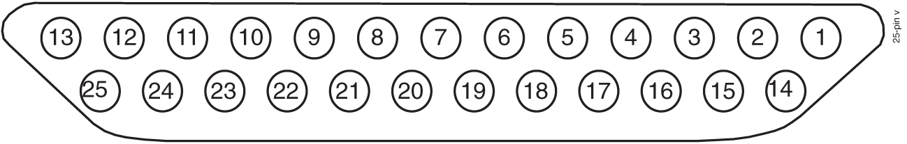

Shelf Clock Connectors (for Control Shelf Backplane -04 only)
Connectors for both A and B clocks are provided using 25 pin D type connectors at J9, J10, J59, and J60 on Control Shelf backplane 04.
System clock connectors are used on Control Shelf backplane 06/07.
Clock A In Connector
J9 on backplane (P/N 850-0330-04).
Figure B-17 Clock A In Connector on Backplane
Table B-15 Clock A In Connector on Control Shelf Backplane 04
1 |
14 |
MA56KHZ+_50 |
2 |
MBUSSTX-_50 |
15 |
MA56KHZ-_50 |
3 |
MBUSSTX+_50 |
16 |
MA8KHZ+_50 |
4 |
MBUSSRX-_50 |
17 |
MA8KHZ-_50 |
5 |
MBUSSRX+_50 |
18 |
SH2A56KHZ+_50 |
6 |
SH2MBUSTX-_50 |
19 |
SH2A56KHZ-_50 |
7 |
SH2MBUSTX+_50 |
20 |
SH2A8KHZ+_50 |
8 |
SH2MBUSRX-_50 |
21 |
SH2A8KHZ-_50 |
9 |
SH2MBUSRX+_50 |
22 |
SH3A56KHZ+_50 |
10 |
SH3MBUSTX-_50 |
23 |
SH3A56KHZ-_50 |
11 |
SH3MBUSTX-_50 |
24 |
SH3A8KHZ+_50 |
12 |
SH3MBUSRX-_50 |
25 |
SH3A8KHZ-_50 |
13 |
SH3MBUSRX+_50 |

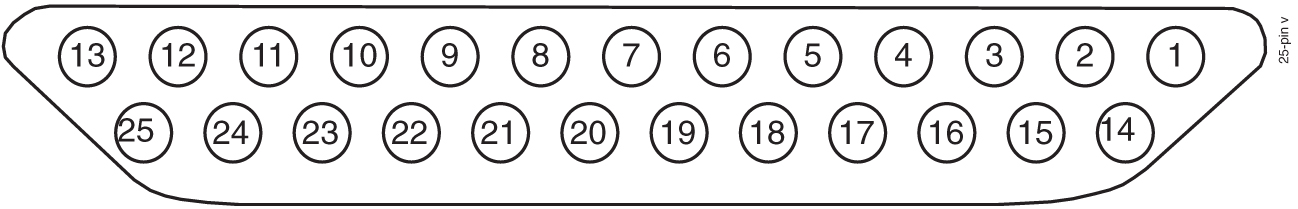

Clock A Out Connector
J10 on Control Shelf backplane 04.
Figure B-18 Clock A Out Connector
Table B-16 Clock A Out Connector
1 |
14 |
SH2A56KHZ+_50 |
2 |
SH2MBUSTX-_50 |
15 |
SH2A56KHZ-_50 |
3 |
SH2MBUSTX+_50 |
16 |
SH2A8KHZ+_50 |
4 |
SH2MBUSRX-_50 |
17 |
SH2A8KHZ-_50 |
5 |
SH2MBUSRX+_50 |
18 |
SH3A56KHZ+_50 |
6 |
SH3MBUSTX-_50 |
19 |
SH3A56KHZ-_50 |
7 |
SH3MBUSTX+_50 |
20 |
SH3A8KHZ+_50 |
8 |
SH3MBUSRX-_50 |
21 |
SH3A8KHZ-_50 |
9 |
SH3MBUSRX+_50 |
22 |
10 |
23 |
11 |
24 |
12 |
25 |
13 |
Clock B In Connector
J59 on Control Shelf backplane 04
Figure B-19 Clock B In Connector on Backplane
Table B-17 Clock B In Connector on Control Shelf backplane 04
1 |
FANAALM- |
14 |
MB56KHZ+_50 |
2 |
15 |
MB56KHZ-_50 |
3 |
16 |
MB8KHZ+_50 |
4 |
17 |
MB8KHZ-_50 |
5 |
18 |
SH2B56KHZ+_50 |
6 |
19 |
SH2B56KHZ-_50 |
7 |
FANCNTRL |
20 |
SH2B8KHZ+_50 |
8 |
21 |
SH2B8KHZ-_50 |
9 |
22 |
SH3B56KHZ+_50 |
10 |
23 |
SH3B56KHZ-_50 |
11 |
24 |
SH3B8KHZ+_50 |
12 |
25 |
SH3B8KHZ-_50 |
13 |
FANBALM- |
Clock B Out Connector
Figure B-20 Clock B Out Connector on Backplane
Table B-18 Clock B Out Connector on Control Shelf backplane 04

BITS Clock Connectors
The system connects to the Building Integrated Timing System (BITS) clocks using two DB-15 style connectors. The two clocks are labeled Primary and Secondary and are supplied from the central office clock. Both clocks go to both TDMs, where one is selected to provide the system clocks used to provide system timing.
J41, J42 on Control Shelf backplane 04 and J48, J49 on Control Shelf backplane 06/07
Figure B-21 BITS Clock Connector
Table B-19 BITS Clock Connector
1 |
9 |
2 |
10 |
3 |
11 |
4 |
12 |
$BITSIN-_60 |
5 |
$BITSIN+_60 |
13 |
6 |
14 |
7 |
15 |
8 |
$= P for primary BITS clock (J42), S for secondary BITS clock (J41) |
Serial Port Connectors
The control shelf backplane provides an interface for 16 separate serial port connections from the TDMs. These connections provide RS-232 interfaces for terminals, printers, and modems. The system is set up as Data Terminal Equipment (DTE).
J17 - J24, J65 - J72 on Control Shelf backplane 04 and J24 - J31, J76 - J83 on Control Shelf backplane 06/07
Figure B-22 Serial Port Connector
Table B-20 Serial Port Connector

Interface Connectors
For slots 1 through 8, 11, and 12 on the control shelf backplane, there are two associated DB-26 interface connectors for each slot. These provide interfacing to the outside world in the form of Ethernet networks or SS7 links networks.
J29 - J38, J43 - J52 on Control Shelf backplane 04 and J36 - J45, J50 - J59 on Control Shelf backplane 06/07
Figure B-23 Interface Connector
Table B-21 Interface Connector Pins and Signal
DB-26 Pin | DS0A/ OCU Signal | DB-26 Pin | DS0A/OCU Signal ATM |
1 |
14 |
2 |
15 |
3 |
16 |
4 |
17 |
5 |
18 |
6 |
19 |
7 |
20 |
TX-RING |
8 |
21 |
TX-TIP |
9 |
22 |
RX-RING |
10 |
23 |
RX-TIP |
11 |
24 |
12 |
25 |
13 |
26 |

Figure B-31 General Purpose Relay Connector 01
Table B-31 General Purpose Relay Connector 01
Pin |
Signal |
4, 8, 10, 15 |
not used |
1 |
GPRNO0 - General Purpose Relay 0, Normally Open |
2 |
GPRCOM0 - General Purpose Relay 0, Common |
3 |
GPRNC0 - General Purpose Relay 0, Normally Closed |
5 |
GPRNO1 - General Purpose Relay 1, Normally Open |
6 |
GPRCOM1 - General Purpose Relay 1, Common |
7 |
GPRNC1 - General Purpose Relay 1, Normally Closed |
9 |
Logic ground |
11 |
OAP1_RST+ - OAP 1 reset, + |
12 |
OAP1_RST- - OAP 1 reset, - |
13 |
OAP2_RST+ - OAP 2 reset, + |
14 |
OAP2_RST- - OAP 2 reset, - |
GP02
J73 on Control Shelf backplane 04 and J75 on Control Shelf backplane 06/07
Figure B-32 General Purpose Relay Connector 02
Table B-32 General Purpose Relay Connector 02
Pin | Signal |
1, 2, 13, 14, 18, 25 |
not used |
3 |
GPRNC2 - General Purpose Relay 2, Normally Closed |
4 |
GPRCOM2 - General Purpose Relay 2, Common |
5 |
GPRNO2 - General Purpose Relay 2, Normally Open |
6 |
GPRNC2 - General Purpose Relay 3, Normally Closed |
7 |
GPRCOM2 - General Purpose Relay 3, Common |
8 |
GPRNO2 - General Purpose Relay 3, Normally Open |
9 |
GPRNC2 - General Purpose Relay 4, Normally Closed |
10 |
GPRCOM2 - General Purpose Relay 4, Common |
11 |
GPRNO2 - General Purpose Relay 4, Normally Open |
12 |
Logic ground |
15 |
GPRNC2 - General Purpose Relay 5, Normally Closed |
16 |
GPRCOM2 - General Purpose Relay 5, Common |
17 |
GPRNO2 - General Purpose Relay 5, Normally Open |
19 |
GPRNC2 - General Purpose Relay 6, Normally Closed |
20 |
GPRCOM2 - General Purpose Relay 6, Common |
21 |
GPRNO2 - General Purpose Relay 6, Normally Open |
22 |
GPRNC2 - General Purpose Relay 7, Normally Closed |
23 |
GPRCOM2 - General Purpose Relay 7, Common |
24 |
GPRNO2 - General Purpose Relay 7, Normally Open |

J76 on Control Shelf backplane 04 and J73 on Control Shelf backplane 06/07
Figure B-33 General Purpose Serial Interface Connector 01, GPSI
Table B-33 General Purpose Serial Interface Connector 01, GPSI
Pin | Signal |
1, 2, 3, 8, 9, 10, 11, 12, 13, 14, 15 |
Not used |
4 |
RX_HO - Holdover Clock Receive Data |
5 |
TX_HO - Holdover Clock Transmit Data |
6 |
DTR_HO - Holdover Clock Data Terminal Ready |
7 |
Logic ground |

Each extension shelf receives and passes along Clock signals A (J5 and J6) and B (J41and J42).
Clock A In Connector J5
Figure B-36 Clock A In Extension Shelf Connector
Table B-35 Clock A In Extension Shelf Connector
1 |
14 |
MA56KHZ+_50 |
2 |
MBUSSTX-_50 |
15 |
MA56KHZ-_50 |
3 |
MBUSSTX+_50 |
16 |
MA8KHZ+_50 |
4 |
MBUSSRX-_50 |
17 |
MA8KHZ-_50 |
5 |
MBUSSRX+_50 |
18 |
SH2A56KHZ+_50 |
6 |
SH2MBUSTX-_50 |
19 |
SH2A56KHZ-_50 |
7 |
SH2MBUSTX+_50 |
20 |
SH2A8KHZ+_50 |
8 |
SH2MBUSRX-_50 |
21 |
SH2A8KHZ-_50 |
9 |
SH2MBUSRX+_50 |
22 |
SH3A56KHZ+_50 |
10 |
SH3MBUSTX-_50 |
23 |
SH3A56KHZ-_50 |
11 |
SH3MBUSTX-_50 |
24 |
SH3A8KHZ+_50 |
12 |
SH3MBUSRX-_50 |
25 |
SH3A8KHZ-_50 |
13 |
SH3MBUSRX+_50 |

Clock B In Extension Shelf Connector J41
Figure B-38 Clock B In Extension Shelf Connector
Table B-37 Clock B In Extension Shelf Connector
Pin Number | Signal | Pin Number | Signal |
1 |
FANAALM- |
14 |
MB56KHZ+_50 |
2 |
15 |
MB56KHZ-_50 |
3 |
16 |
MB8KHZ+_50 |
4 |
17 |
MB8KHZ-_50 |
5 |
18 |
SH2B56KHZ+_50 |
6 |
19 |
SH2B56KHZ-_50 |
7 |
FANCNTRL |
20 |
SH2B8KHZ+_50 |
8 |
21 |
SH2B8KHZ-_50 |
9 |
22 |
SH3B56KHZ+_50 |
10 |
23 |
SH3B56KHZ-_50 |
11 |
24 |
SH3B8KHZ+_50 |
12 |
25 |
SH3B8KHZ-_50 |
13 |
FANBALM- |
Behind each slot on the extension shelf backplane are two DB-26 connectors. These provide connection to the outside world in the form of TCP/IP networks or SS7 links networks. The interface connectors are designated as J9 through J40.
Extension Shelf Interface Connectors J9 through J40
Figure B-40 Extension Shelf Interface Connector
Table B-39 Extension Shelf Interface Connector Pins and Signals
Pin | DS0A/OCU Signal ATM | Pin | DS0A/OCU Signal ATM |
1 |
14 |
2 |
15 |
3 |
16 |
4 |
17 |
5 |
18 |
6 |
19 |
7 |
20 |
TX-RING |
8 |
21 |
TX-TIP |
9 |
22 |
RX-RING |
10 |
23 |
RX-TIP |
11 |
24 |
12 |
25 |
13 |
26 |
