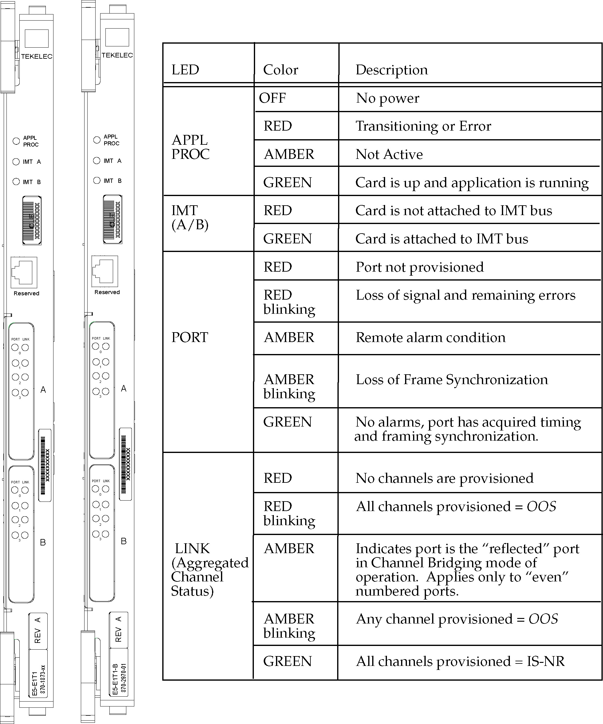

E5-E1T1-B Interface Module
Figure A-3 E5-E1T1-B Interface Module
img/r_e5_e1t1-b_leds.jpg

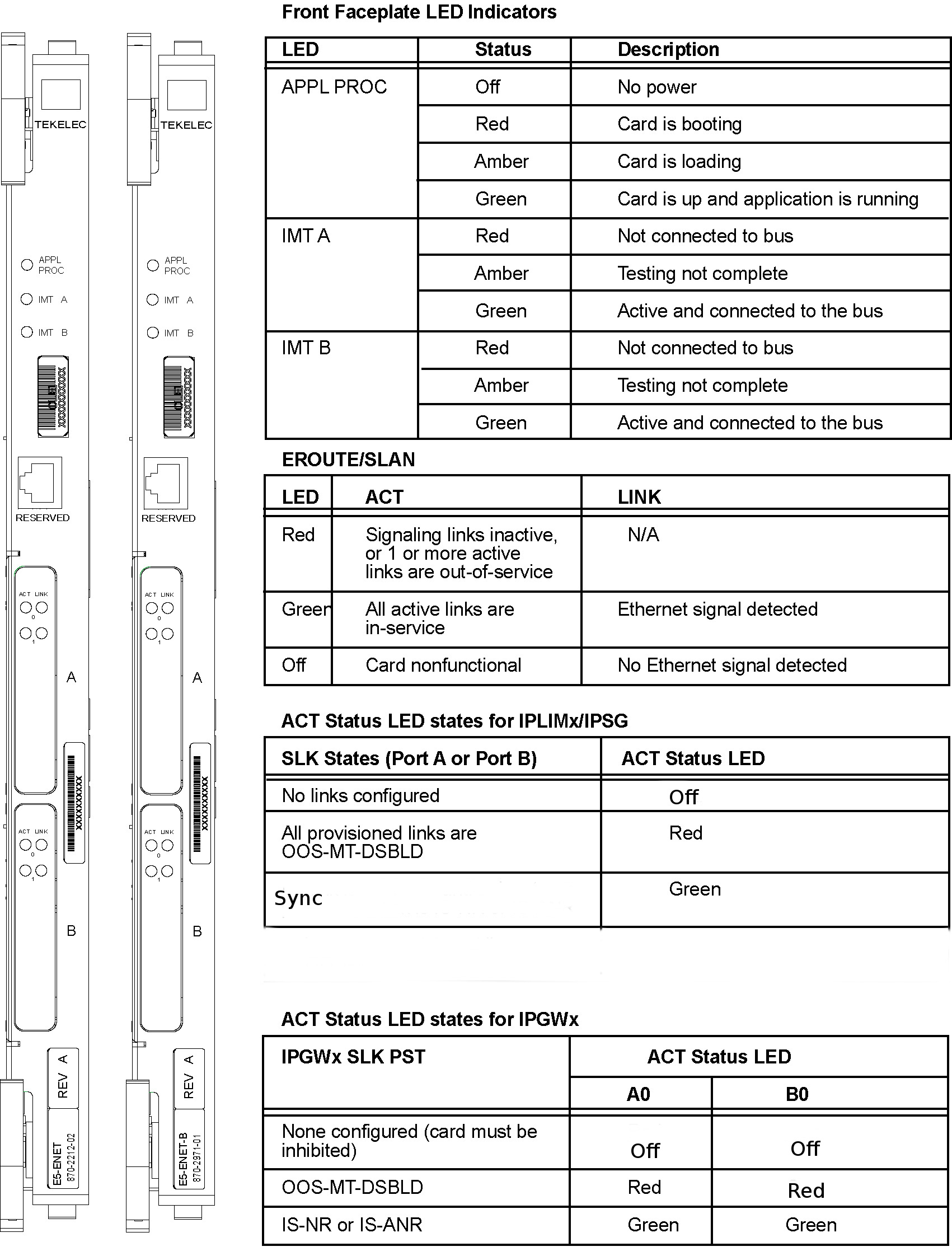

E5-ENET-B Interface Module
Figure A-4 E5-ENET-B Interface Module
img/r_e5_enet-b_leds.jpg
Must be used with the E5-MASP card.
The E5-ENET-B is provisionable for multiple functions, but does not support multiple functions on a single card simultaneously.

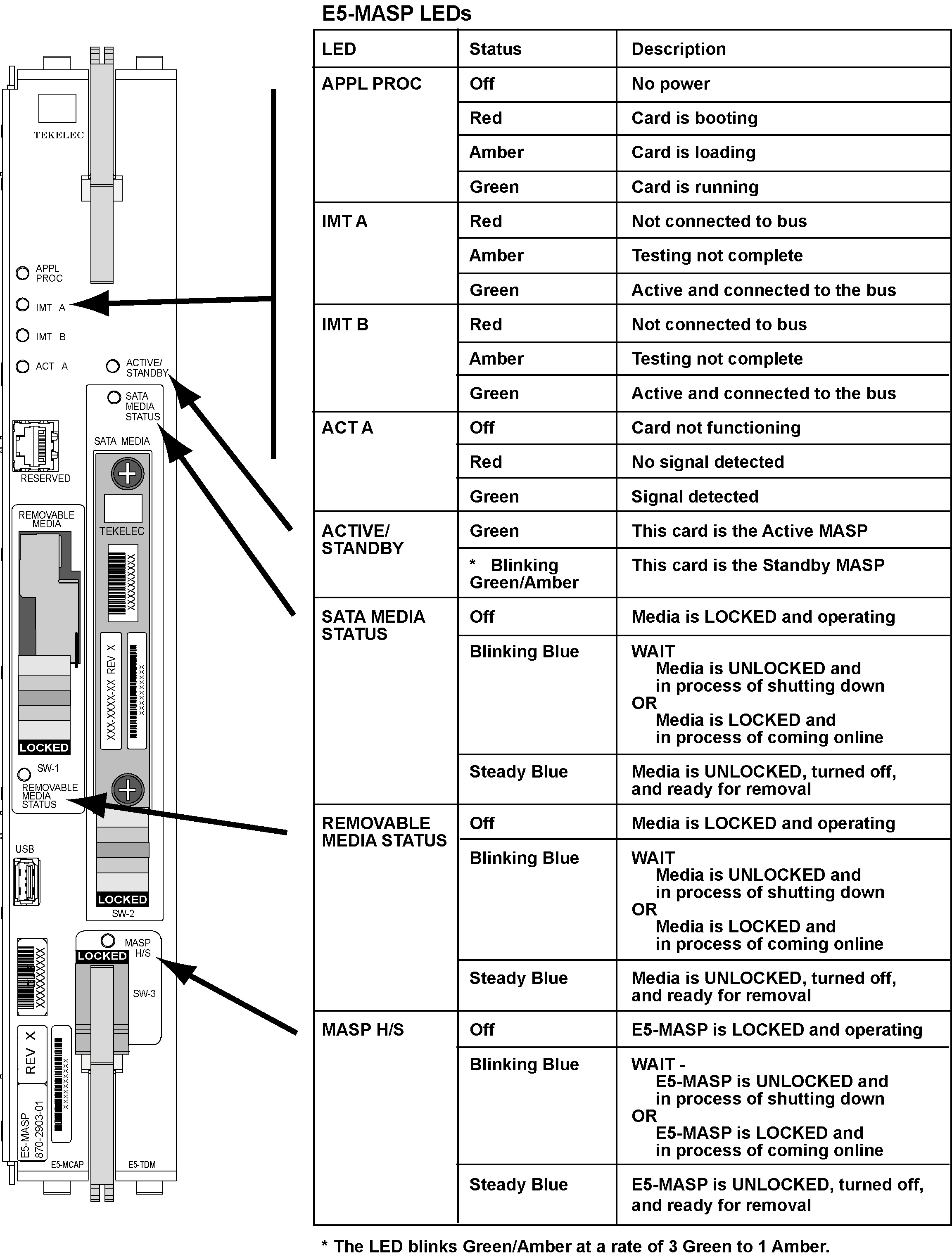

E5-MASP Card
Figure A-5 E5-MASP Card
img/870-2903-xx_e5_masp_led_table.jpg

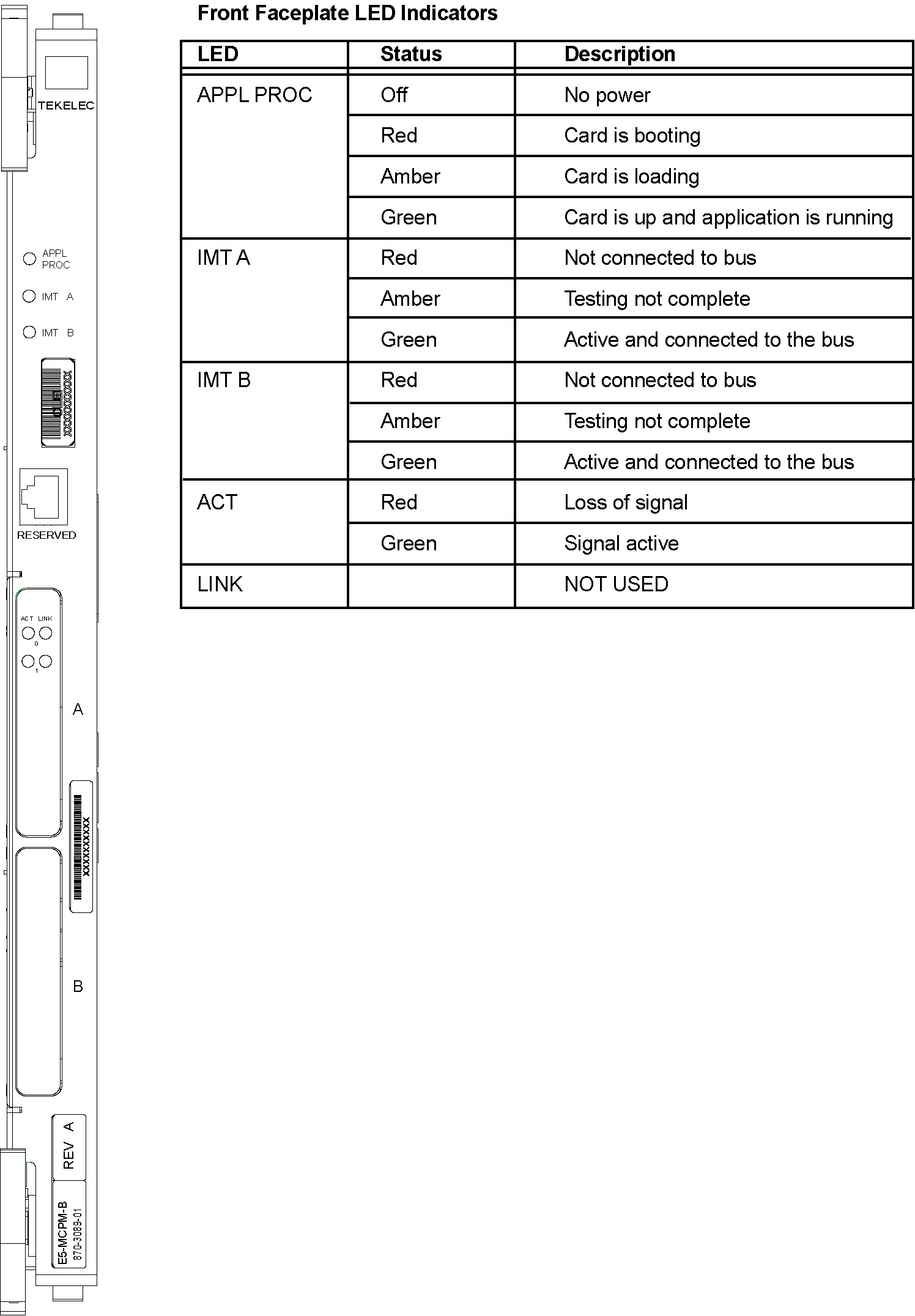

E5-MCPM-B Module
Figure A-6 E5-MCPM-B Module
img/r_e5_e1t1_e5_e1t1_interface_module_im-fig1.jpg
img/r_e5_mcpm-b_leds.jpg

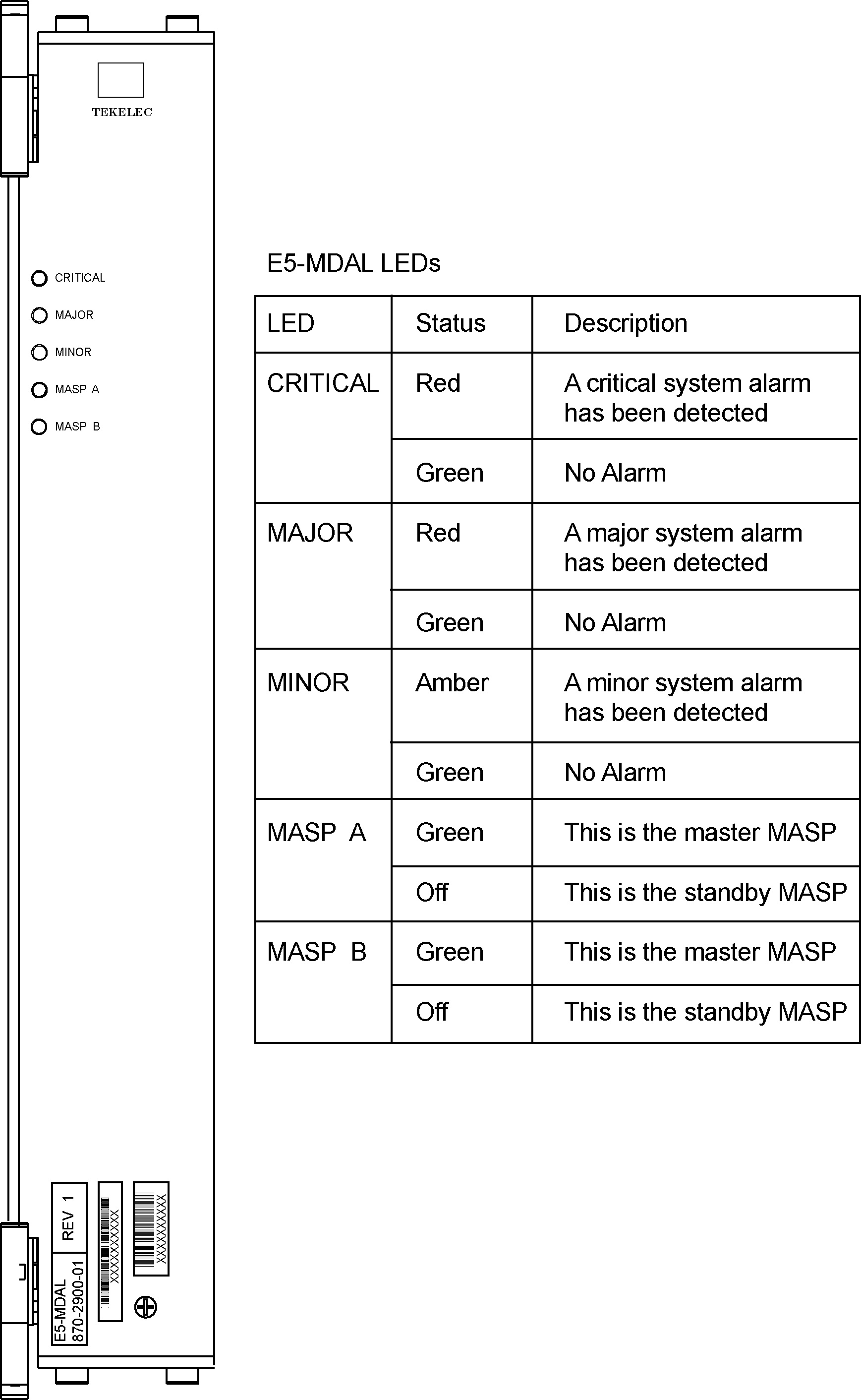

E5-MDAL Card
Figure A-7 E5-MDAL Card
img/870-2903-xx_e5-mdal.jpg

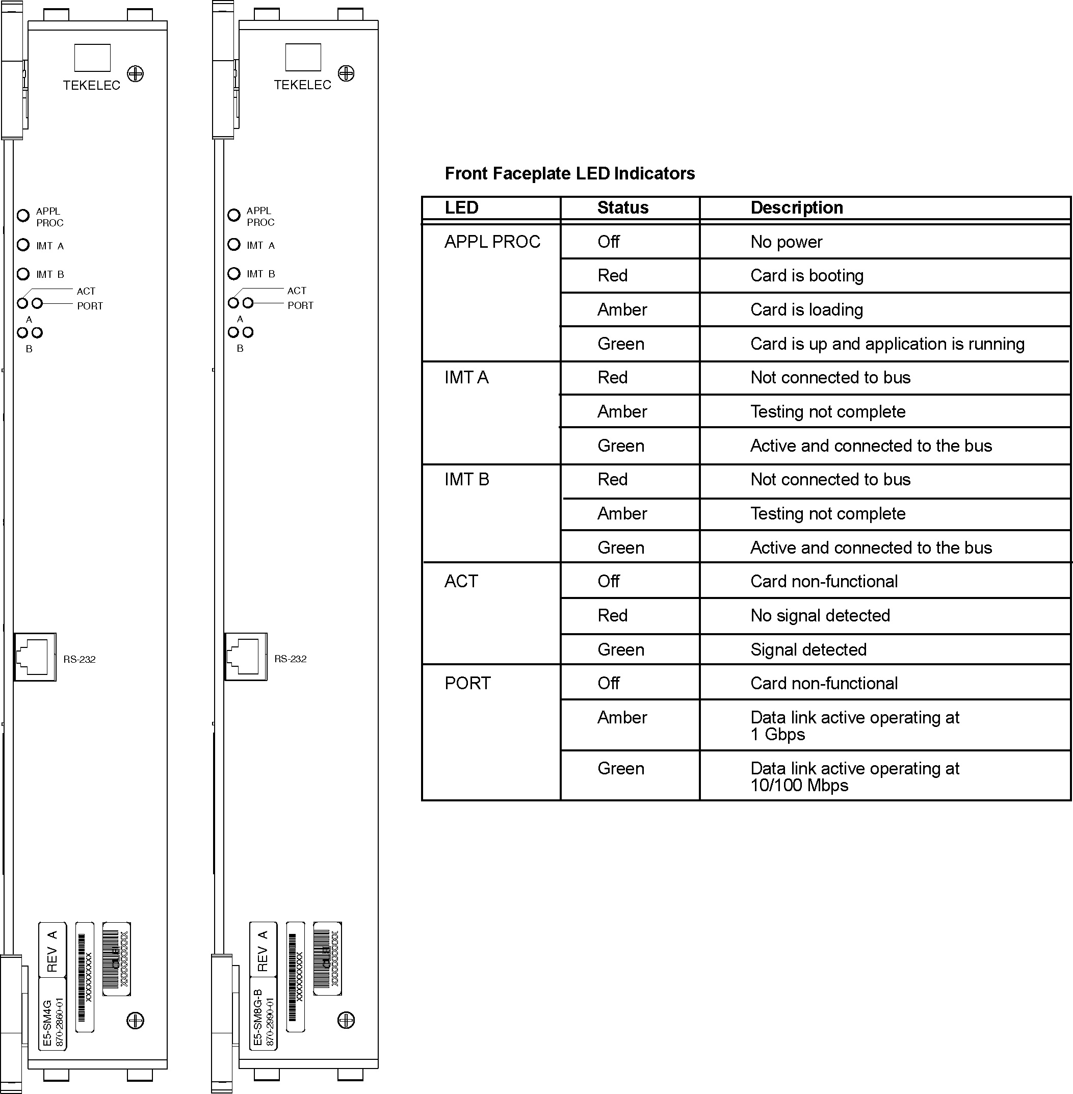

E5-SM8G-B Module
Figure A-8 E5-SM8G-B Interface Module
img/r_e5_sm8g-b_leds.jpg
Table A-1 E5-SM8G Interface Module LEDs
LED Color Descriptions
APPL
PROC
Red
Application processor is not running or is failing diagnostics.
Amber
Card is loading an application or is being polled (may be prevented from loading by maintenance-out-of-service condition)
Green
Card is running an application.
IMT
Red
Card is off IMT bus
Amber
Card is on IMT bus, but testing is not complete.
Green
Card is on IMT bus
Blank
Communication processor is not operating.
ACT
Red
No signal detected
Green
Signal detected
Off
Card nonfunctional
PORT
Amber
Data link active operating at 1 Gbps
Green
Data link active operating at 10/100 Mbps
Off
Card non-functional

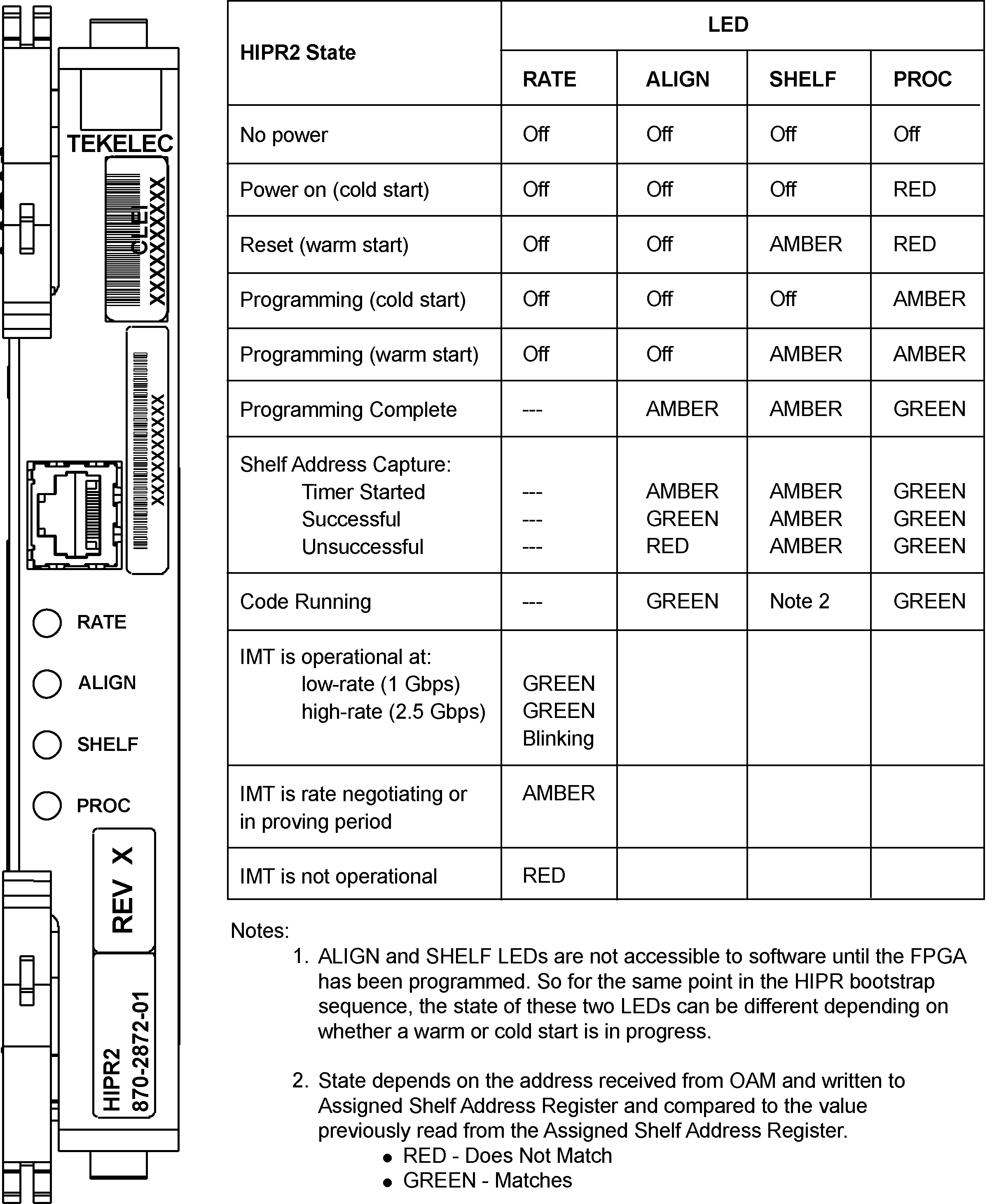

HIPR2, High-Speed IMT Packet Router 2 Module
Figure A-9 HIPR2 LEDs
img/870-2879-01_hipr2.jpg

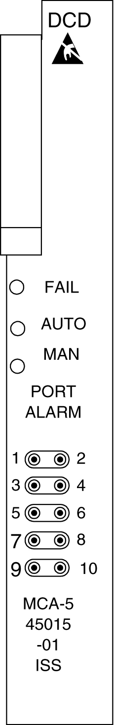

MCA, Matrix Controller Assembly Card, Holdover Clock
Figure A-11 Holdover Clock MCA Card LEDs
img/r_mca_matrix_controller_assembly_card_holdover_clock_im-fig1.jpg
Table A-3 MCA LEDs
LEDs Descriptions
FAIL
RED – This card has failed or there is a loss of all input references to this card.
BLANK – No card or input reference failure detected.
AUTO
GREEN – Indicates output failure was protected automatically.
BLANK – No failures detected.
MAN
GREEN – Indicates output failure was protected manually.
