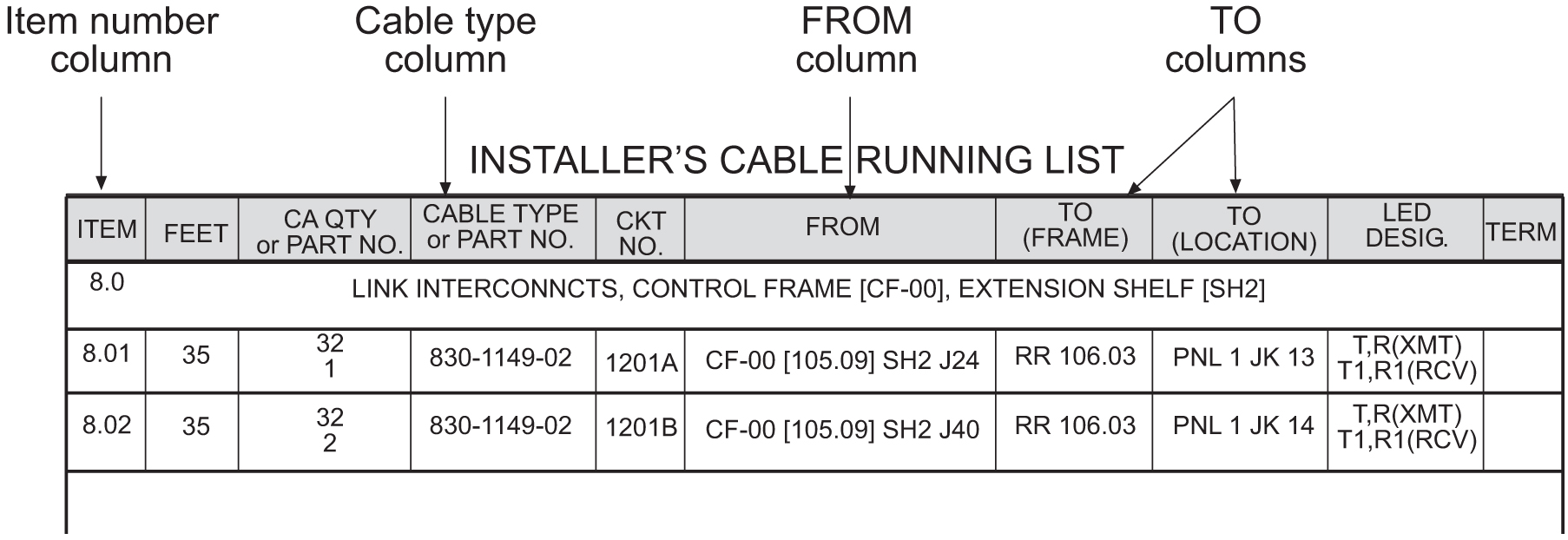

  1. Locate the Installer’s Cable Running List in the Equipment Specification for the site.
    Refer to for an example.
    Figure 3-2 Installer’s Cable Running List Example
    img/t_cable_labeling_im-fig1.jpg
  2. Locate the labels included with the cable shipment.
  3. Take one cable and identify the cable’s part number in the Cable Type column of the cable running list.
  4. Match the cable with its corresponding pair of labels:
    1. Go to the cable’s From column of the cable running list.
    2. Match the From column information to the From information on one label.
    3. Match the From column information to the To information on the other label.
    The label for the connector end of these cables can be identified by the presence of a “J” number, for example: J32, that appears in the “From” area of the label.
    Make sure that all cables specific to an A or B side are clearly labeled as A cable and B cable.
  5. Repeat 4for each cable to ensure that all labels are present and that originations and destinations of all cables are clearly identified.
  6. For cables that come from the factory with connectors already installed, apply the appropriate label onto each end of the cable approximately two inches from the connector.
    Ensure that the labels are positioned so they are still readable after the cables are installed.
  7. For cables that need to be cut to the appropriate length: After the cable is cut to the appropriate length, affix labels with the item number approximately two inches from the end of the cable insulation.
  8. For cables not ordered through Oracle, confirm source, part number, and origination/destination points before labeling them.
    All cables must be labeled “TO” and “FROM”
    After you have labeled all cables, you are ready for cable installation.
