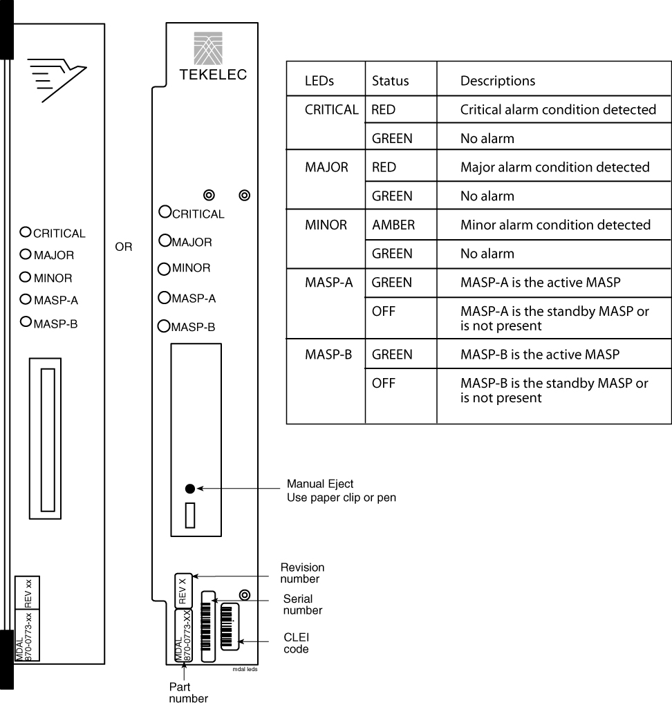

MDAL LEDs
Following are the five alarm LEDs on the face of the obsoleted MDAL card. Although the card is obsolete, the functionality remains uniform. See Figure 3-1:
  • Critical
  • Major
  • Minor
  • MASP-A
  • MASP-B
When the system detects an alarm, the appropriate alarm level and location (MASP-A or MASP-B) LEDs illuminate. See Figure 3-1.
Verify the state of the MDAL card by observing the LEDs on the face of the MDAL card. The fuse and alarm panel do not reflect any alarms caused by the MDAL card.
Figure 3-1 MDAL Alarm LEDs

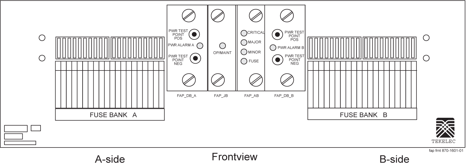

Alarm LEDs on the Fuse and Alarm Panel (FAP)
There are six alarm LEDs on the FAP that indicate:
  • Power alarm LEDs (A and B)
  • A critical alarm
  • A major alarm
  • A minor alarm
  • A fuse alarm
The FAP provides protected distribution of power to the system. Protection is provided by the fuses placed in the GMT fuse holders used in the panel. The FAP contains a fuse fail alarm circuit that operates when one or more of the panel’s fuses fail. An LED changes from green to red when a fuse has failed. The LED remains red until the fuse has been replaced.

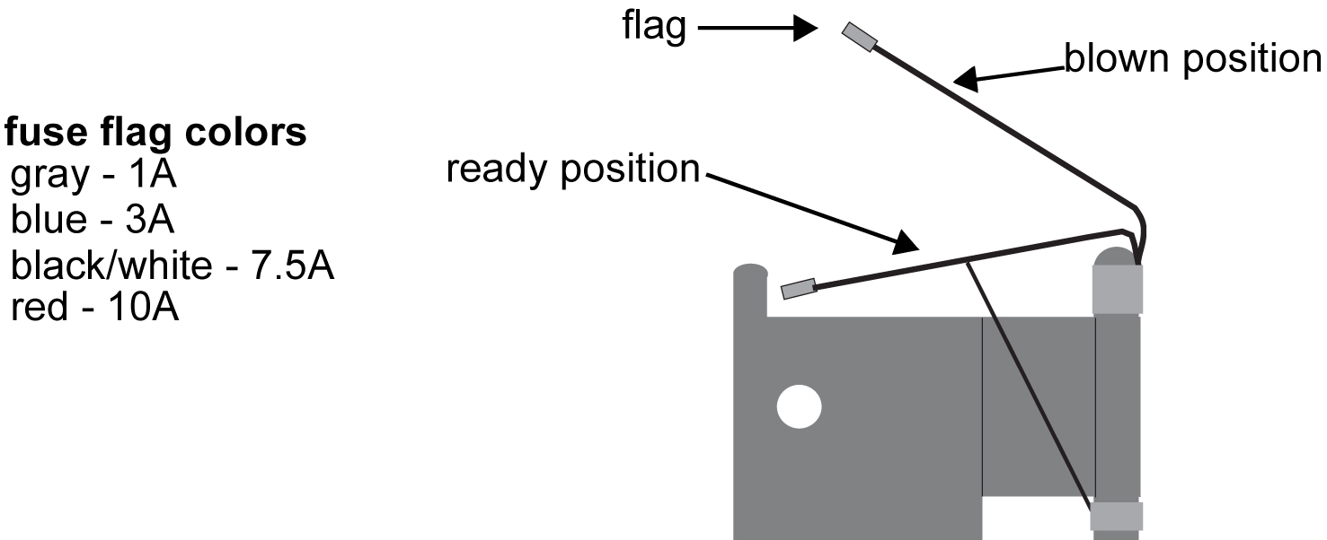

The fuse and alarm panel uses GMT fuses for individual circuit protection (see Figure 3-2). The EAGLE uses 3A and 1A fuses, depending on the application. When a fuse fails due to an overload condition, a small colored flag on the fuse shows the position of the fuse that has failed. The flag is gray on 1A fuses, blue on 3A fuses, black/white on 7.5A fuses, and red on 10A fuses.
Figure 3-2 GMT Fuse
img/c_trouble_detection_maintmanual-fig2.jpg
The panel contains two separate circuits, A and B. Current flows from the input terminals to the fuse bus. When a fuse is installed in a fuse holder, the circuit is completed to the output connector. The Fuse Fail Alarm LED on the front panel indicates the condition of the panel. Green is indicated if power is applied to the panel and there are no failed fuses. The green LED changes to red when a fuse fails. An unlit LED indicates a failed LED or no power to the fuse and alarm panel.
The fuse and alarm panel is also equipped with frame alarm LEDs that display the critical, major, and minor alarms generated by the EAGLE system.
The fuse and alarm panels have the A and B buses connected through diodes to allow one bus to pick up the entire load when the other bus loses power.

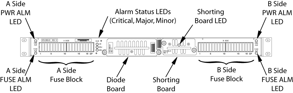

Table 3-1, Table 3-2 and Table 3-3 describe the front panel configuration of the fuse and alarm panels.
Table 3-1 Fuse and Alarm Panel Front Items (870-2804-01)
Fuse Panel Item Description
Fuse Positions
2 groups of 20 GMT fuses
PWR ALM
LED indicator for A or B diode board input power
  • Green - input power applied
  • Red - no input power to board
FUSE ALM
LED indicator for fuse fail alarm
  • Green - normal
  • Red - blown fuse
CR
LED indicator for frame critical alarm
MAJ
LED indicator for frame major alarm
MIN
LED indicator for frame minor alarm
Shorting Board
LED indicator for mode of operation
  • Off - normal
  • Green - maintenance
Figure 3-3 Fuse and Alarm Panel Front Layout (870-2804-01)
img/c_trouble_detection_maintmanual-1u-front-unipwr.jpg

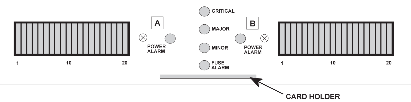

Table 3-2 Fuse and Alarm Panel Front Items (870-0243-xx)
Fuse Positions
Card Holder
slide-card holder with 2 designation cards for 20 fuse positions each
Fuse Alarm
Critical Alarm
LED indicator for critical alarm
Major Alarm
LED indicator for major alarm
Minor Alarm
LED indicator for minor alarm
Power Alarm
LED indicator for lose of power on either A bus or B bus
Figure 3-4 Fuse and Alarm Panel Front Layout (870-0243-xx)
img/c_trouble_detection_maintmanual-fig3.jpg
Table 3-3 Fuse and Alarm Panel Front Items (870-1606-xx/870-2320-xx)
Fuse Positions
Two groups of 20 GMT fuses
PWR ALARM
OP/MAINT
Green - normal
Red - maintenance
FUSE
Green - normal
Red - blown fuse
CRITICAL
MAJOR
MINOR
Figure 3-5 Fuse and Alarm Panel Front Layout (870-1606-xx/870-2320-xx)
img/c_trouble_detection_maintmanual-fig4.jpg

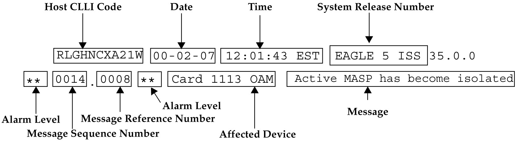

The location of a card with a fault is displayed with the event/error message. The location is displayed as a card number. Card numbers are used to locate the card in the EAGLE system. Refer to Installation Guide for card locations.
Following is an example of an event/error message displaying the card location:
     RLGHNCXA21W 00-02-07 12:01:43 EST  EAGLE 35.0.0
**  0014.0008  ** CARD 1113 OAM        Active MASP has become isolated
The card location always follows the word “CARD” in the message. In this example, the card number is 1113.

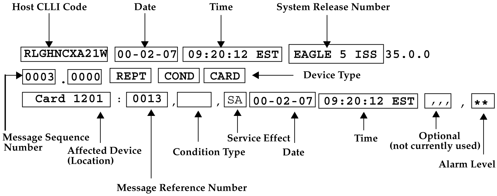

Output Messages
The EAGLE generates output messages in response to command input or fault conditions in the EAGLE or in the network. The format for these messages is generally uniform. Some messages include additional data.
Network messages provide the text description of the event, and on the lines below the text line, any additional information.
The following example shows the general format of an output message.
Figure 3-6 Output Message Format
img/r_output_messages_maintmanual_fig1.jpg
The fields in an output message (shown in the figure above) are described next:
  • Host CLLI code - a maximum of one alpha character and ten alphanumeric characters. The CLLI code uniquely identifies the system in terms of its physical location. The CLLI code must be unique among all elements in the system.
    The CLLI code consists of the following:
    • City = 4 characters
    • State = 2 characters
    • Building = 2 characters
    • Equipment type = 3 characters
  • Date - The date the message was generated, in the format year-month-day.
  • Time - The time the message was generated with time zone, in the format hour: minutes: second time zone.
  • System Release Number - contains a system identifier and the version ID number. The system identifier, can be EAGLE or EAGLE5 depending on the product key enabled on the system. The version ID number has the software release specific GPL set that is expected to be installed on the system as approved loads. The format of the version ID number is in the form of maj.min.maint, defined as follows:
    • maj - the major release ID
    • min - the minor release ID
    • maint - the maintenance release ID
  • Alarm Level - a one or two character indicator of the alarm level, defined as follows:
    • *C = Critical Alarm
    • ** = Major Alarm
    • * = Minor Alarm
    • blank = No Alarm
  • Message Sequence Number - This number is an index for all output messages. The number increments sequentially for every message. The output messages originating from the card in location 1113 has a range from 0001 through 4999. The range for location 1115 is 5000 through 9999.
  • Message Reference Number - Messages that are associated with a specific action are numbered for reference. These messages are defined in this chapter, along with a corrective action.
  • Affected Device - The device that caused the message to be generated. This generally describes the card type.
Network messages with additional data display the additional lines below the text string and message reference number (MRN). See individual messages for examples of output.

   RLGHNCXA21W 00-07-16 12:20:12 EDT EAGLE 35.0.0
   1240.0000 REPT COND CARD
   “CARD 1101:0013,,SA,00-07-16,10:03:29,,,,**”
   “CARD 1107:,SCMMA,,00-07-16,10:03:29,,,,”
   “CARD 1113:0143,,NSA,00-07-16,10:03:29,,,*”

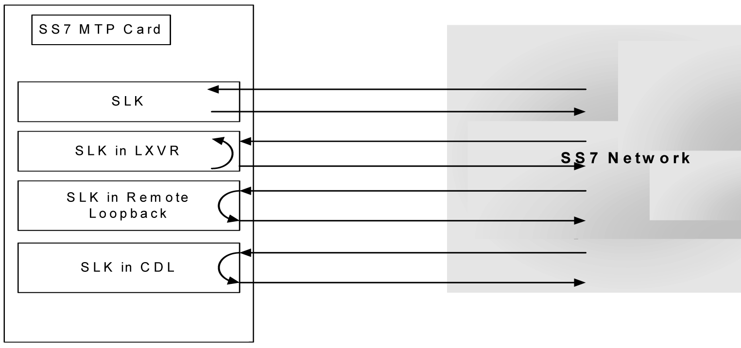

Command Driven Loopback (CDL) is the ability to locally drive a signaling link into a manual line loopback. The data received on the signaling link is echoed (transmitted) back. Commands are used to provide this capability on an individual signaling link basis. CDL allows loopback testing of a signaling link when either far-end initiated loopbacks are prevented or when a constant loopback state is desired. This command driven setting of loopback is similar in functionality to a remote initiated loopback. Table 3-11 shows a breakdown of support for Command Driven Loopback based on the MTP card type. Figure 3-8 shows a conceptual view of a signaling links network connections. Local transceiver (LXVR) is a tst-slk initiated test in which the line transmit is looped back to the line receive internal to the card. CDL is "LXVR in reverse", the line receive is looped back to the line transmit.
Table 3-11 Command Driven Loopback Support
MTPCard Type Supported MTPCard Type Supported
MPL (DSO)
Yes
T1-ATM
Yes
E1-ATM
Yes
T1MIM (Channel)
Yes
E1MIM (Channel)
Yes
IPLIM
No
IPGTWY
No
Test Indicators
If an MTP card boots, then all links on this card, by default, are not in CDL. A link in CDL is persistent across an OAM switchover. Signaling links must be inhibited (OOS-MT-DSBLD) to perform command driven loopback. Signaling links in CDL have the following conditions:
  • The primary state (PST) isOOS-MT-DSBLD.
  • The secondary state (SST) is LPBK .
  • The associate state (AST) is CDL .
    Figure 3-8 Signaling Link Network Connections

tst-slk and tst-e1/t1 Loopback Test Details
  • SLTC Loopback Test Details
    Loopback Test Type: SLTC (EAGLE initiated Level 3 SS7SLT).
    Link State: Link is up.
    Equipment tested: Near and far end up to Level 3.
    Purpose: Test the entire path to the far end at Level 3.
    Description: Valid only for tst-slk This will send an SLTM out and expects an SLTA back.
    Typical use: To validate connectivity of a signaling path.
    Testing Limits: 1024 concurrent link tests per system.
  • OAM Loopback Test Details
    Loopback Test Type: OAM (EAGLE initiated Level 1 ATM test).
    Link State: Link is down.
    Equipment tested: Near and far end level 1 S/W and H/W including all hardware on the cards.
    Purpose: Test the entire near and far end level 1 H/W by exchanging ATM cells.
    Description: Valid only for tst-slk Sends OAM cells out to far end for 60 seconds if no errors, 2 minutes when errors are received.
    Typical use: Verifies ATM cells can be exchanged between 2 signaling points.
  • LINE/FELINE> Loopback Test Details
    Loopback Test Type: LINE/FELINE (EAGLE initiated Level 1-2 ATM test)
    Equipment tested: Near end H/W up to level 2 (LXVR) and far end H/W level 1 interface.
    Purpose: H/W continuity check between near and far end.
    Description: This detail sequence is valid for tst-slk:loopback=line and tst-t1:loopback=feline.
    tst-t1:loopback=line installs the local line loopback (receive to transmit) similar to an act-cdl:loopback=line.
    The following steps occur:
    1. Device under test (DUT) sends T1 bit oriented code (BOC) to remote device.
    2. Remote device receives BOC and programs hardware.
    3. DUT attempts level 2 alignment.
    4. If link aligns (level 2), test passes, else test fails.
    5. DUT sends BOC to remote device to remove loopback.
    6. Remote device receives BOC and re-programs hardware.
      If the DUT boots in the middle of the sequence, the remote device needs to have the link activated/de-activated and it will return to the original programming.
    Typical use: Used for a link in line timing to check continuity from the near end level 2 H/W to the level 1 interface at the far end.
  • PAYLOAD/FEPAYLOAD Loopback Test Details
    Loopback Test Type: PAYLOADFEPAYLOAD (EAGLE initiated Level 1-2 ATM test)
    Description: This detail sequence is valid for tst-slk:loopback=payload and tst-t1:loopback=fepayload.
    tst-t1:loopback=payload installs the local payload loopback (receive to transmit) similar to an act-cdl:loopback=payload.
    6. remote device receives BOC and re-programs hardware.
      If the DUT boots in the middle of sequence, the remote device needs to have the link activated/de-activated and it will return to the original programming
    Typical use: Used for a link in source timing to check continuity from the near end level 2 H/W to the level 1 interface at the far end.
  • LXVR Loopback Test Details
    Loopback Test Type: LXVR (EAGLE initiated Level 1 Internal card loopback)
    Equipment tested: Local card.
    Purpose: Test the near end card only.
    Description: Valid for both tst-slk and tst-t1. This tests the near end card up through level 2.
    Typical use: To validate the Card on the Eagle as good.
