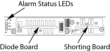

Diode Testing and the Shorting Board

Diode Board
This section describes how to remove and test the Diode Board.
Procedure — Remove the Diode Board
Use this procedure to remove the Diode Board for diode testing.
  1. Check to verify the Shorting Board LED is on, indicating the FAP is in maintenance (bypass) mode.
  2. Locate two screws securing the Diode Board in its slot. Turn the screws to the left until they disengage.
    Figure 2-4 Diode Board Faceplate
    img/c_1ufap_diode_board_location_maintmanual.jpg
  3. Pull the board straight out of the FAP until the board is clear of the frame.

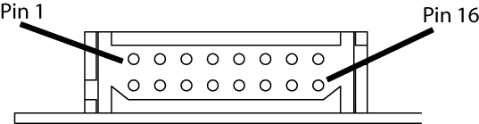

Procedure - Diode Testing
Use this procedure to test the power diodes on the Diode Board. A Digital Volt/Ohm Meter (DVM) with a Diode Setting is required. All testing is performed at the edge connector (J1) on the board.
Figure 2-5 Diode Board Edge Connector J1
img/c_1ufap_location_j1_maintmanual.jpg
  1. Set the DVM to test diodes.
  2. Connect the DVM positive (+) lead and negative (-) lead to the pins indicated for each power diode.
    Table 2-4 Power Diode Test Points
    Diode J1 Pin Positive (+) Lead J1 Pin Negative (-) Lead
    CR1 #1
    3
    16
    CR1 #2
    6
    16
    CR2 #1
    14
    1
    CR2 #2
    11
    1
    CR3 #1
    4
    16
    CR3 #2
    5
    16
    CR4 #1
    13
    1
    CR4 #2
    12
    1
    The DVM should indicate a short circuit (>0.1V, <0.2V). Record the measurement.
  3. Reverse the leads.
    The DVM should indicate an open circuit (OL). Record the measurement.
  4. If any measurements are in error, the diode board must be replaced.
  5. If the measurements are within acceptable parameters, reinstall the Diode Board.

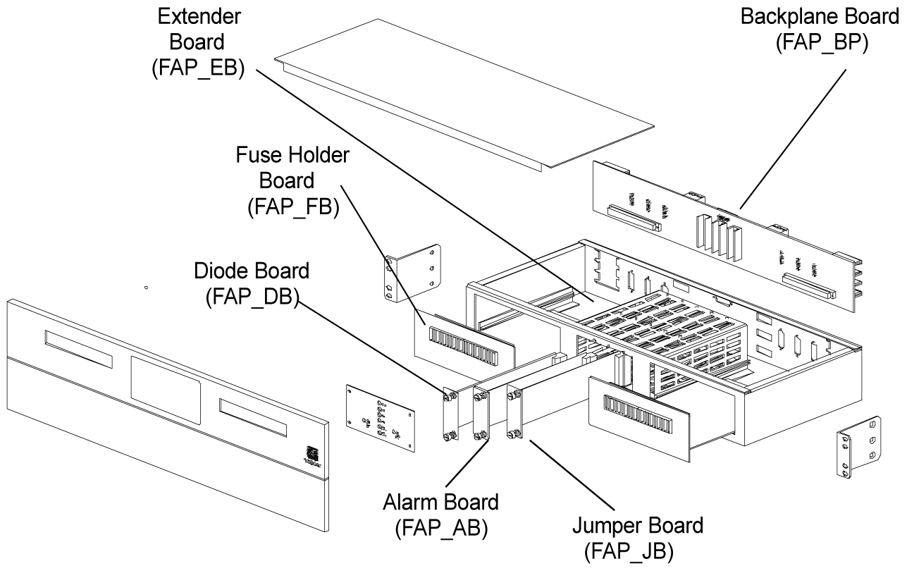

The FAP consists of nine printed circuit boards, each identified by an acronym on its label (see Figure 2-8):
  • Backplane (FAP_BP): Located inside the FAP unit, parallel to the back side of the FAP box.
  • Alarm board (FAP_AB): Located on the center-right of the front panel, set vertically inside the FAP unit, perpendicular to the front panel.
  • Diode boards (FAP_DB): Two boards located on the front panel, flanking the Alarm and Jumper boards on the left and right, and perpendicular to the front panel. Set vertically inside the FAP unit.
  • Extender boards (FAB-EB): Two boards located inside the FAP unit, parallel to the bottom of the FAP box, on the far right and left of the unit.
  • Fuse holder boards (FAP_FB): Two boards located inside and parallel to the front panel, on the far right and left of the FAP unit.
  • Jumper board (FAP_JB): Located on the center-left of the front panel, set vertically in the unit, perpendicular to the front panel.
Figure 2-8 Location of FAP Components

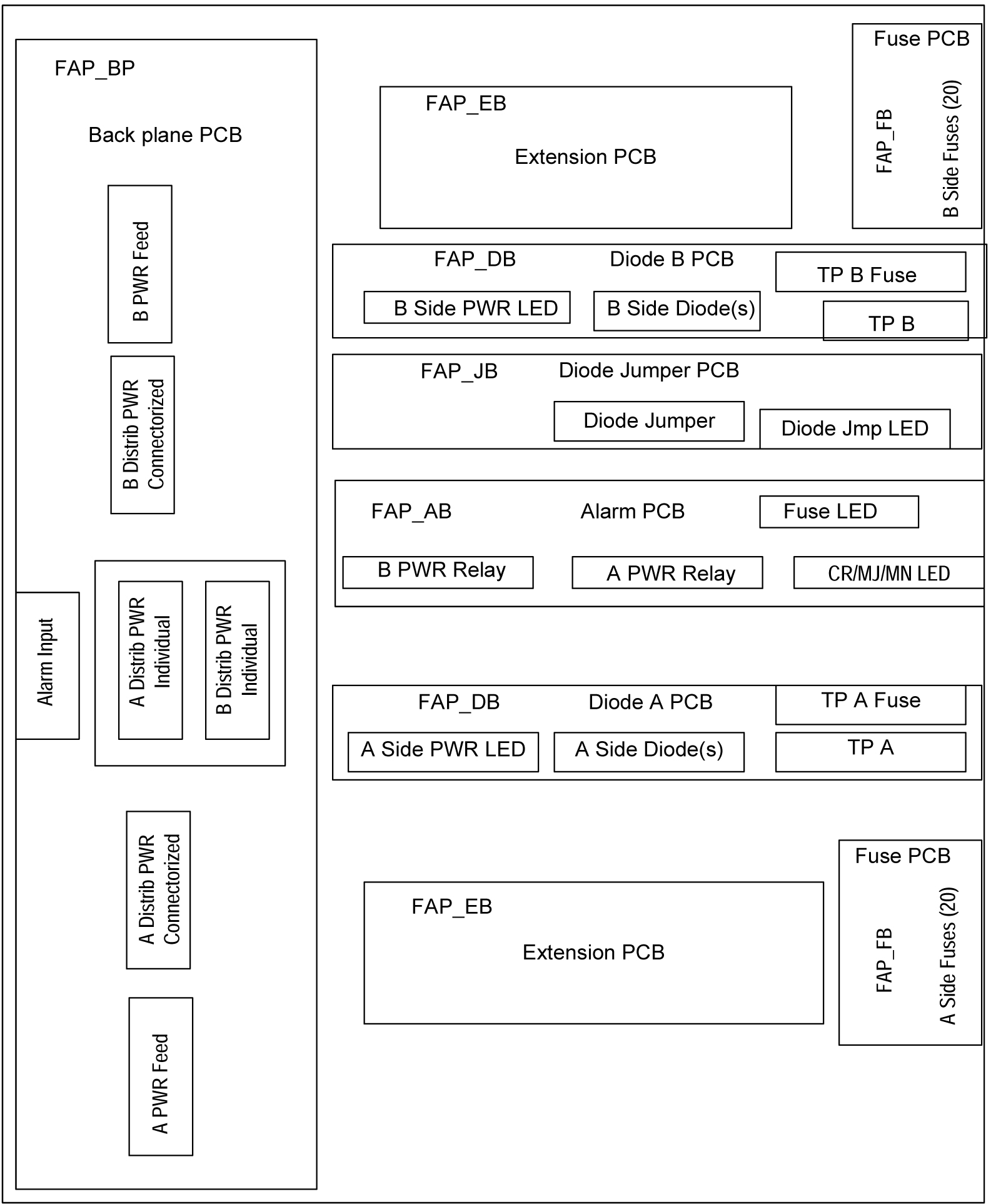

Each of the FAP components has associated functions.
Figure 2-9 FAP Component Functions
img/c_fap_components_maintmanual-fig2.jpg
The FAP is composed of nine circuit boards. Eight of these circuit boards are field replaceable, and can be hot-swapped.

The following sections describe each type of circuit board:
Backplane Board (FAP_BP)
The backplane circuit board provides all of the external connections for the FAP. It consists primarily of circuit routing and connectors, but also has one pull-down resistor, which provides a default alarm signal for the Fuse Alarm in the event the alarm board is removed from the FAP.
Alarm Board (FAP_AB)
The alarm circuit board provides indicators and relays for the EAGLE status and fuse alarms. This board includes a jumper (JMP50) for future use. This jumper is installed for all existing configurations.
Diode Boards (FAP_DB)
The diode circuit boards provide power diodes and power input test points. Four diode footprints are included: two for Assembly A and two for Assembly B. Only one of the four positions is intended to be populated; the second footprint is provided for future part rating changes or additional heat-dissipation capabilities.
Extender Boards (FAP_EB)
The extender board provides connection between the backpanel board and the fuse holder boards.
Fuse Holder Boards (FAP_FB)
The fuse holder boards provide 20 fuses with a common alarm.
Jumper Board (FAP_JB)
The jumper board provides the capability to by-pass the diode boards with a fuse. Use this board only for maintenance operations.

Table 2-7 Additional Alarm Indicators
Indicator Alarm Condition
Fuse alarm and fuse flag down
Blown fuse
Fuse alarm and PWR A LED
Input power loss on A
Fuse alarm and PWR B LED
Input power loss on B
Fuse alarm and OP/MAINT LED is red
Diode jumper is installed (by-passing diodes)

  2. Unscrew the two thumbscrews securing the FAP jumper board and remove the board.
  3. On the jumper circuit board, move the jumper (the DB-26 male connector) from P71 to P72. Tighten the thumbscrews connecting the jumper to its mate, to ensure a good connection. This repositioning overrides the diodes, establishing a direct connection between input and fuse panels.

  6. Slide the jumper board back into the FAP and verify both of the following alarms display:
    • the OP/MAINT LED lights red on the FAP
    • an EAGLE fuse alarm displays on the terminal
      You may now remove either or both diode circuit boards without affecting EAGLE service.

  7. Locate diode board A and unscrew the two thumbscrews securing the board. Remove the board from the FAP.
  8. Locate the diode to be tested. It has three pins and is attached to the large heat sink. The diode is labeled CR43.

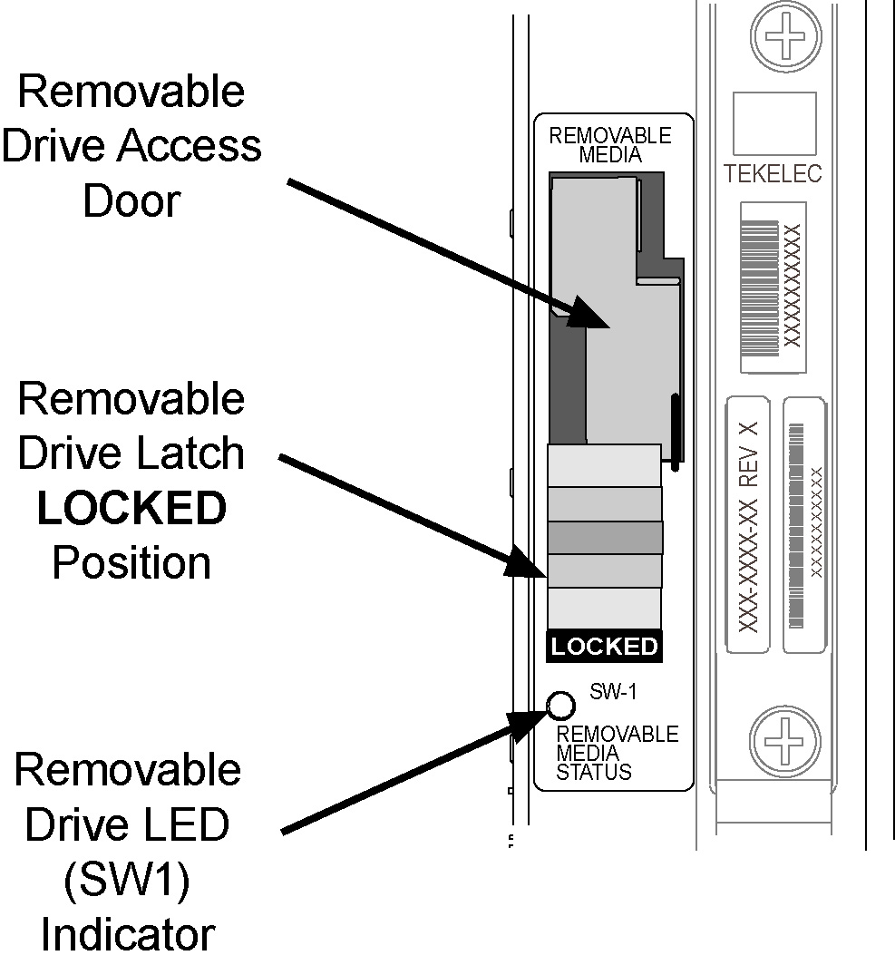

  1. Verify that the removable USB drive is locked in position and in use.
    The removable drive latch (SW1) is in the LOCKED position and the Removable Media Status LED on the E5-MASP is Off. Refer to Figure 2-10.
    Figure 2-10 Removable USB Drive LOCKED
    img/870-2903-xx_e5-masp_removable_drive_latch_locked.jpg
  2. Move SW1 from the LOCKED to the unlocked position and wait for the LED to indicate a steady blue state. See Figure 2-11.
    When SW1 is transitioned from locked to unlocked, the LED will flash blue to indicate the drive is unlocked and in process of shutting down.

  3. Insert the removable USB drive labeled “Daily Backup” into the removable USB media slot.
    Reference: Removable Drives
  4. Enter the following command to create a backup of the database on the removable USB drive:
    chg-db:action=backup:dest=remove
    During command execution, these messages should appear.
    BACKUP (REMOVABLE) : MASP A - Backup starts on active MASP.
    BACKUP (REMOVABLE) : MASP A - Backup to removable USB drive complete.
  5. Verify that the databases on the removable USB drive (RDBKUP) and the current partition of the active MASP (FDCRNT) are coherent by entering the following command:rept-stat-db
    If necessary, refer to Commands User's Guide to interpret the output.
  6. Remove the removable USB drive from the removable USB media slot.
  7. Make an entry in the site maintenance log that a backup was performed.
    Place the removable USB drive in a safe place, easily accessible in the event of a catastrophic failure.

Database Archive (Quarterly)
Purpose:
The purpose of this routine is to create an archive copy of the EAGLE database. This archive copy should be stored off-site and saved for emergency recovery when all other procedures have failed. This routine will reuse the same removable USB drive each quarter.
Requirements
This procedure requires a removable USB drive formatted for system data.
Interval
Quarterly
Procedure _Database Archive (Quarterly)
  1. Enter the following command to check the operational status of the database:
    rept-stat-db
  2. Insert the removable USB drive labeled “Archive” into the removable USB drive media slot.
  3. Enter the following command to create a backup of the database on the removable USB drive:
  4. Verify that the databases on the removable USB drive (RDBKUP) and the current partition of the active MASP (FDCRNT) are coherent by entering the following command:
    rept-stat-db
  5. Remove the removable USB drive from the removable USB drive media slot.
  6. Make an entry in the site maintenance log that a backup was performed on the “Archive” removable USB drive.
    Place the removable USB drive in a safe place off-premise. This copy is for emergency recovery in the event all other methods of database recovery failed.
