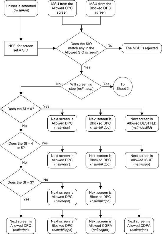

The allowed signaling information octet (SIO) screen identifies the type of MSUs (ISUP, TCAP, etc.) that are allowed into the network. The gray shaded areas in Figure 10-4 shows the fields of the SS7 message that are checked by the allowed SIO screening function.
Gateway Screening Actions
If a match is not found, the message is discarded.
If a match is found, the nsfi is examined to determine the next step in the screening process. If the nsfi value is any value other than stop, the next screening reference (nsr) is identified and the screening process continues to the next screen identified by the nsfi and nsr parameter values.
nsfi is equal to stop, the screening process stops and the message is processed. If a gateway screening stop action set is specified with the screen, shown by the actname parameter value, the message is processed according to the gateway screening stop actions that are assigned to the gateway screening stop action set.

Allowed SIO Screening Actions
The value of the
nsfi parameter is based on the value of
the service indicator (si) parameter.
Table 10-1
shows the valid combinations of
nsfi values and service indicator
values.
Table 10-1 Valid Parameter Combinations for the Allowed SIO Screening Function
| Service Indicator (SI) Values | Nest Screening Function Identifier (NSFI) Values |
| 0 | DPC, BLKDPC, DESTFLD |
| 3 | DPC, BLKDPC, CGPA, CDPA |
| 4, 5 | DPC, BLKDPC, ISUP |
| All other values (1, 2, 6-15) | DPC, BLKDPC |
Messages containing the service indicator value 4 are TUP messages, and messages containing the service indicator value 5 are ISUP messages. Both types of messages are screened using the allowed ISUP screen. TUP messages can be screened for point codes, after the SIO screen, with the allowed and blocked DPC screens. However, if the screen set does not contain an allowed SIO screen that screens for TUP messages (messages with the service indicator value of 4), the message will be treated by the allowed ISUP message type screen as an ISUP message, even if the message contains the service indicator value of 4.
Figure 10-1 through Figure 10-3 shows the screening actions of the allowed SIO screen.
Figure 10-1 Allowed SIO Screening Actions - Sheet 1 of 3
Figure 10-2 Allowed SIO Screening Actions - Sheet 2 of 3
Figure 10-3 Allowed SIO Screening Actions - Sheet 3 of 3
Figure 10-4 Allowed SIO Screening Function

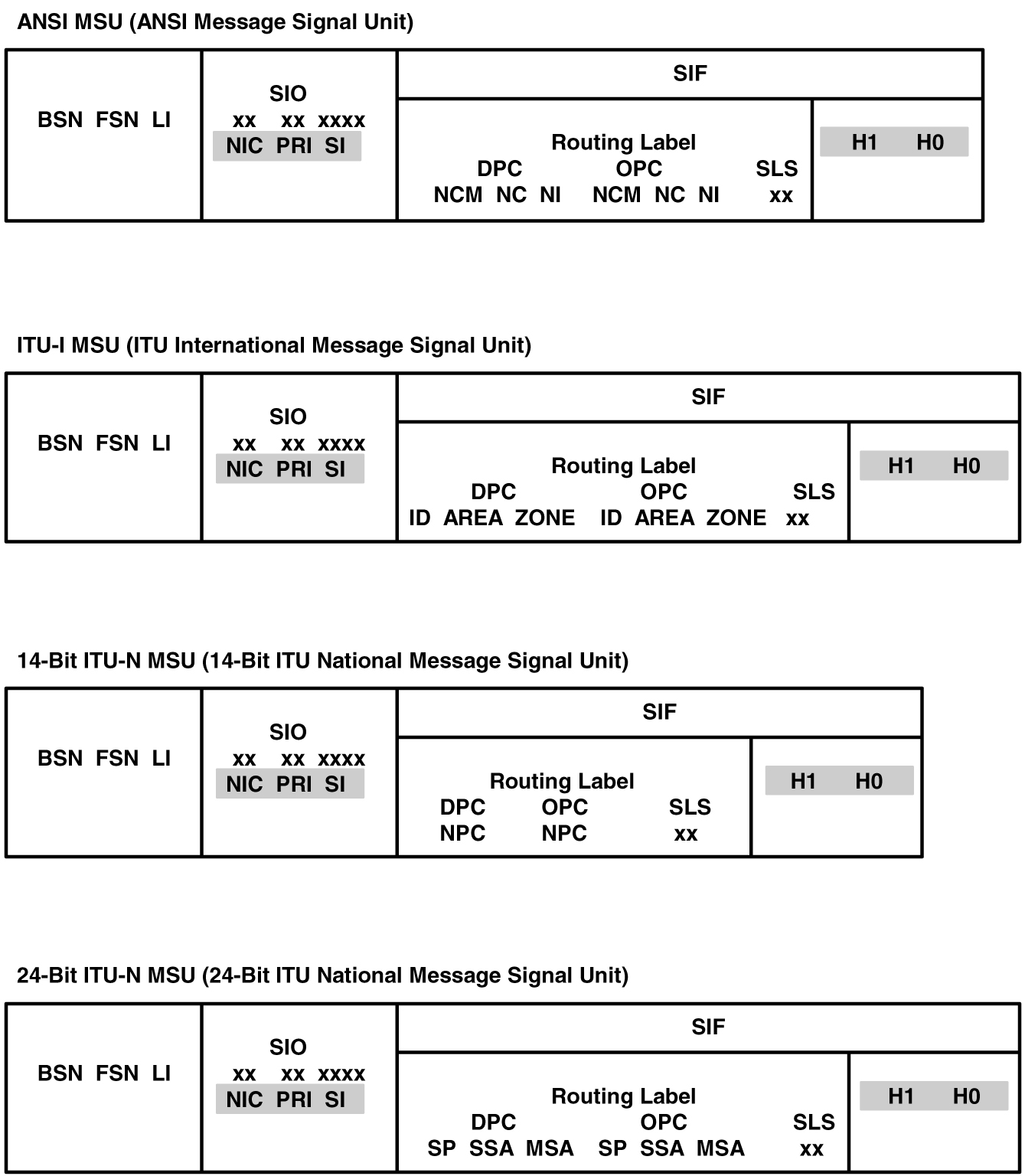

Specifying H0 and H1 Values
The
h0 and
h1 values must be specified if the
si value is 0, 1, or 2. If the
si value is 3 through 15, the
h0 and
h1 parameters cannot be specified.
The
h0 and
h1 parameters must be specified if
either parameter is specified.
The H0 and H1 heading code values can be a single value,
a range of values with the beginning and end of the range separated by double
ampersands (for example, a range of values from 2 to 9, 2&&9), or with
an asterisk (*). The asterisk specifies all possible values for the
h0 and
h1 parameters.
Table 10-3
shows the valid combinations of these parameter values.
