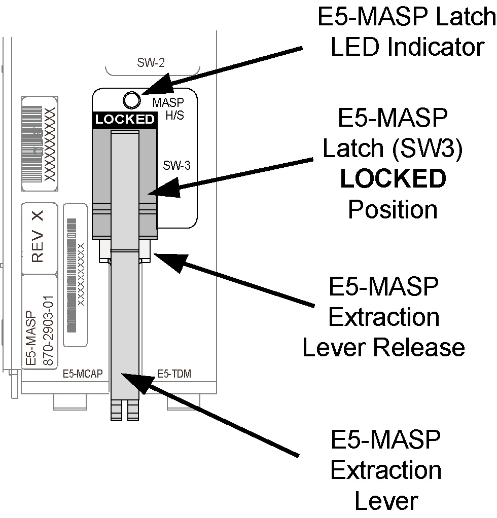

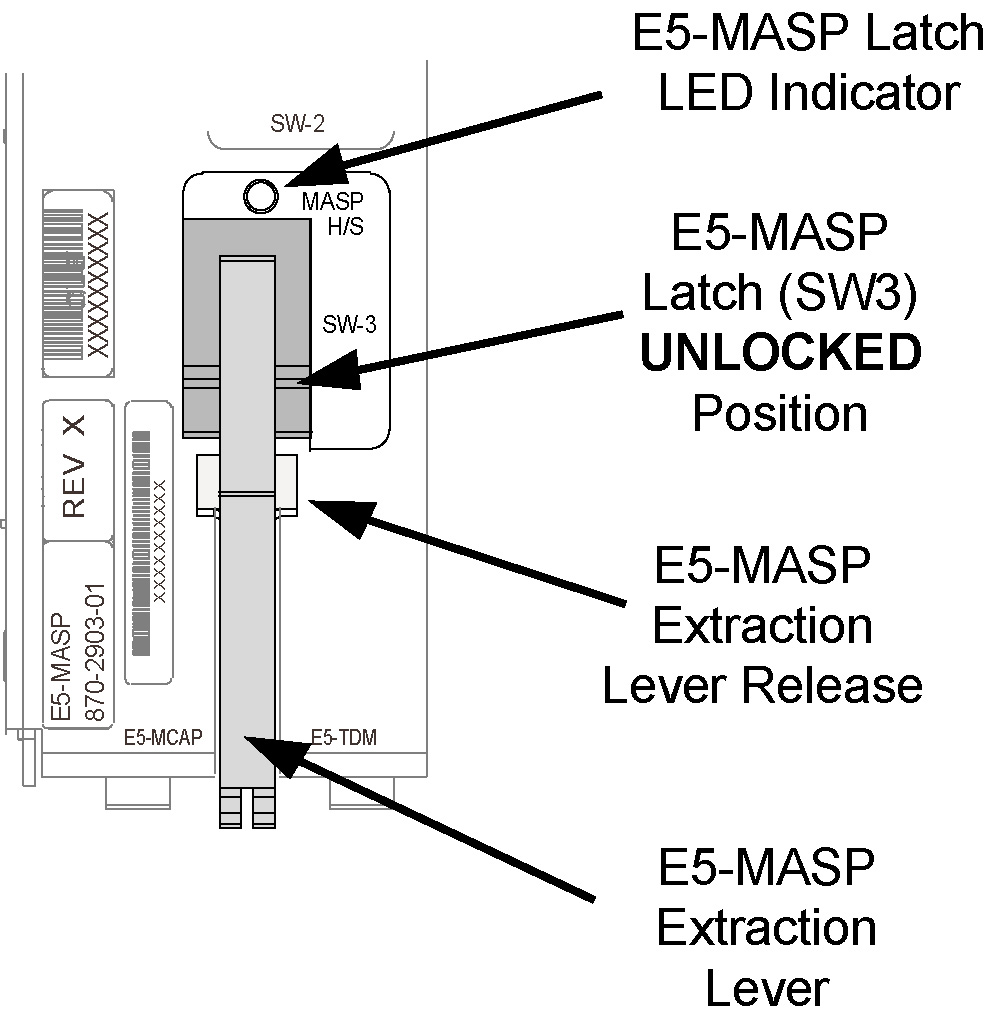

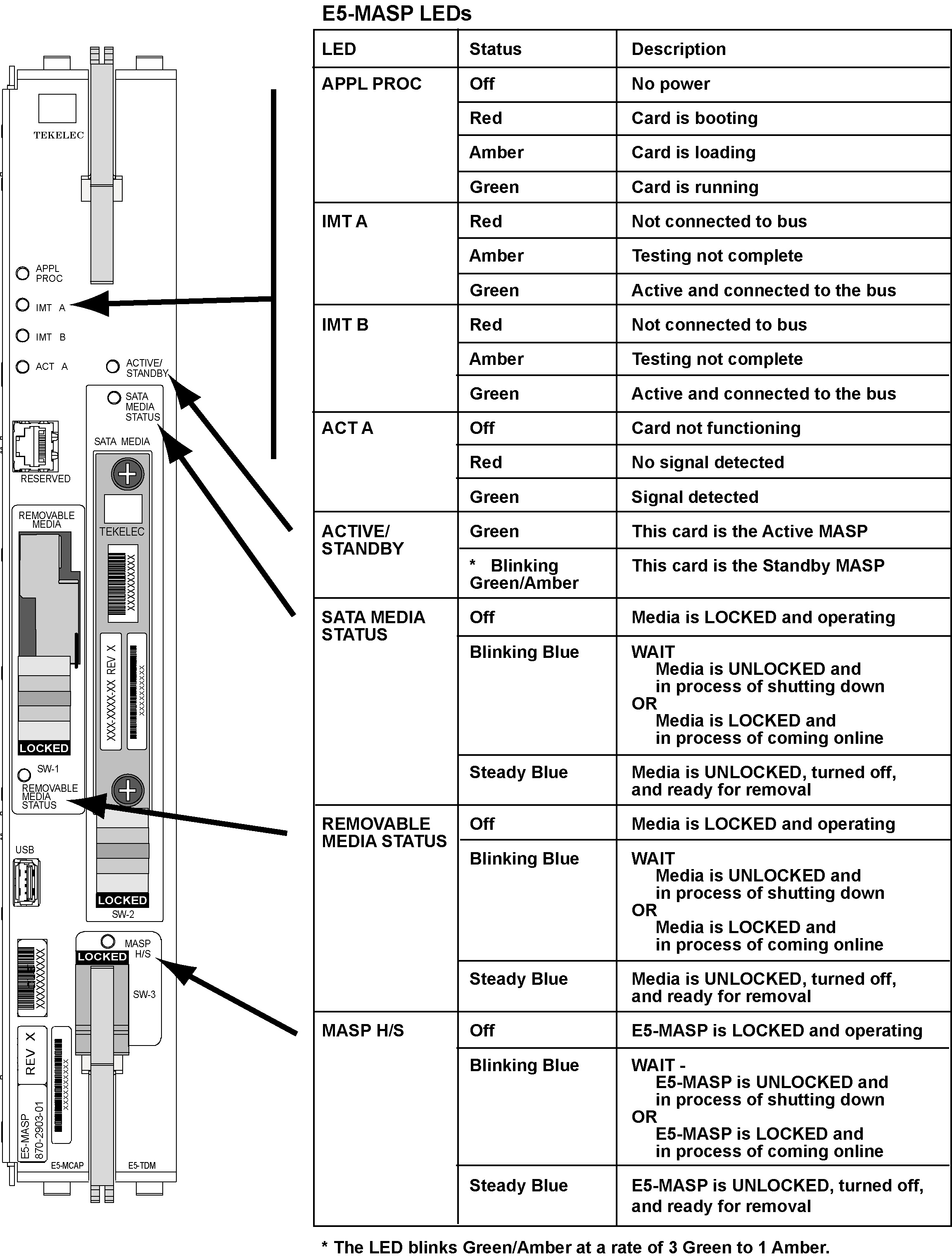

A.3 E5-MASP Card Replacement
This procedure is to replace an E5-MASP card. Before the E5-MASP is replaced, it must be verified that it is the standby MASP.
The E5-MASP (made up of the E5-MCAP and E5-TDM cards) contains the removable USB drive, the fixed disk drive, the terminal processor for the 16 serial I/O ports, and an interface to the maintenance disk and alarm (E5-MDAL) card.
Figure A-3 E5-MASP LEDs

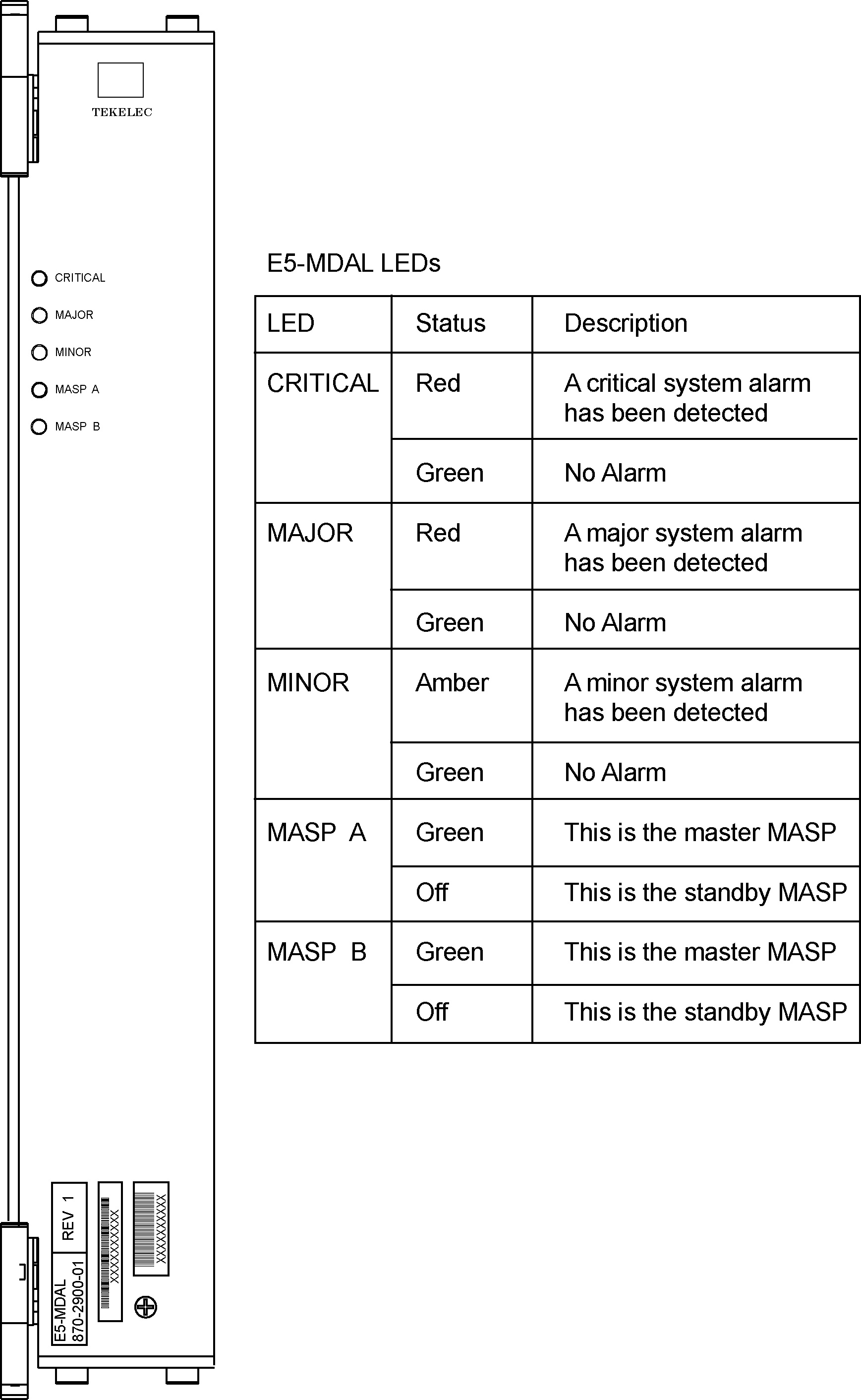

A.4 E5-MDAL Card Replacement
Description
The E5-MDAL (Figure A-4) provides for external alarm indicators, such as bells, horns and lamp indicators.
Figure A-4 E5-MDAL LEDs

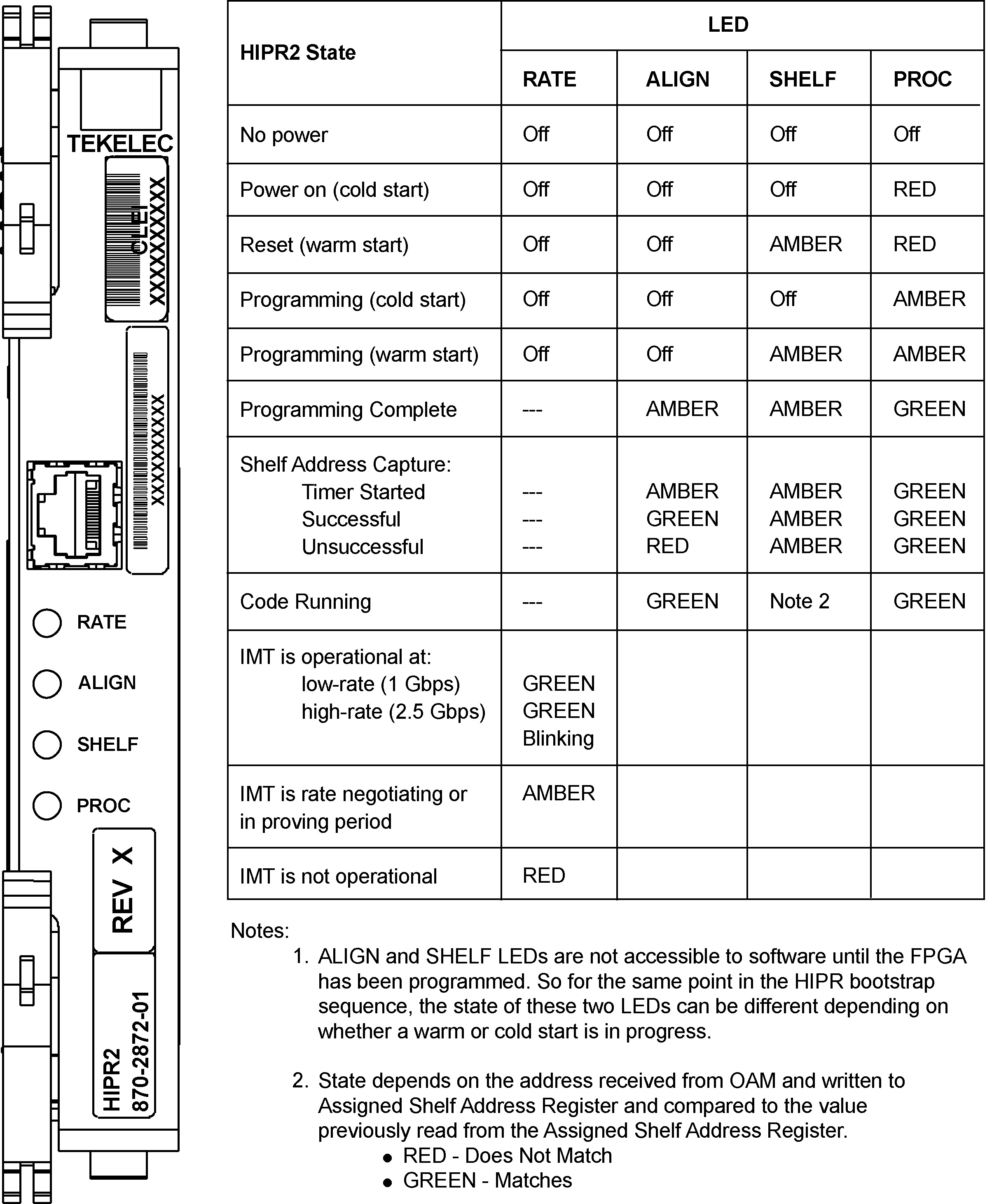

A.5 HIPR2 Card Replacement
Use this procedure to remove a High-Speed Inter-processor Message Transport Packet Router 2 (HIPR2) card.
Each shelf contains two HIPR2 cards, one for each IMT bus, that provide continuity of the IMT bus signals even with failed or missing circuit modules. LEDs on the HIPR2 (Figure A-5) indicate connectivity to the IMT
Figure A-5 HIPR2 LEDs

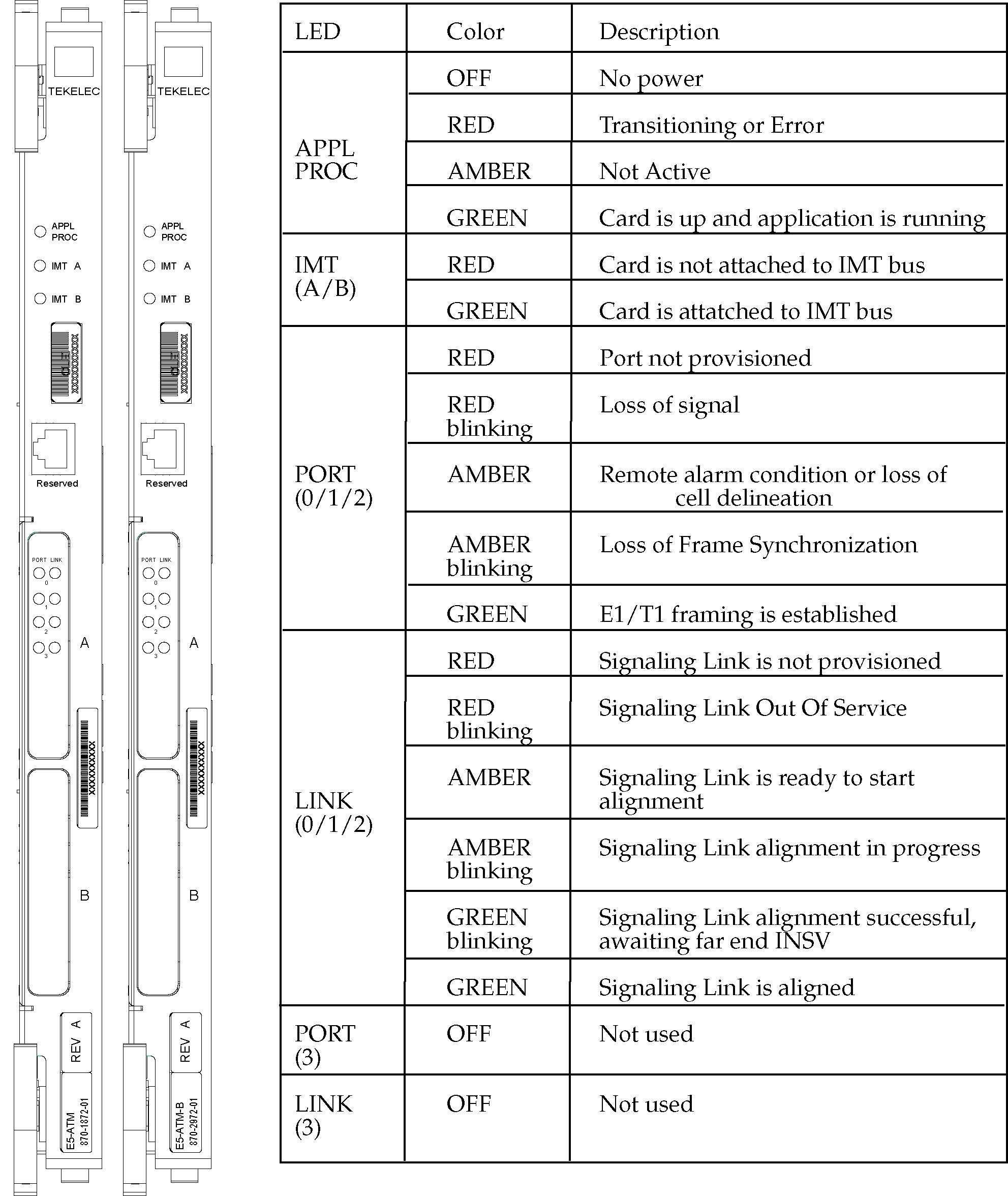

A.7 E5-ATM-B Card Replacement
This E5-ATM-B Module provides access to remote SS7, IP and other network elements, such as a Signaling Control Point (SCP). This card is equipped with an industry-standard ATM, or DS0 interface.
Figure A-6 E5-ATM-B LEDs

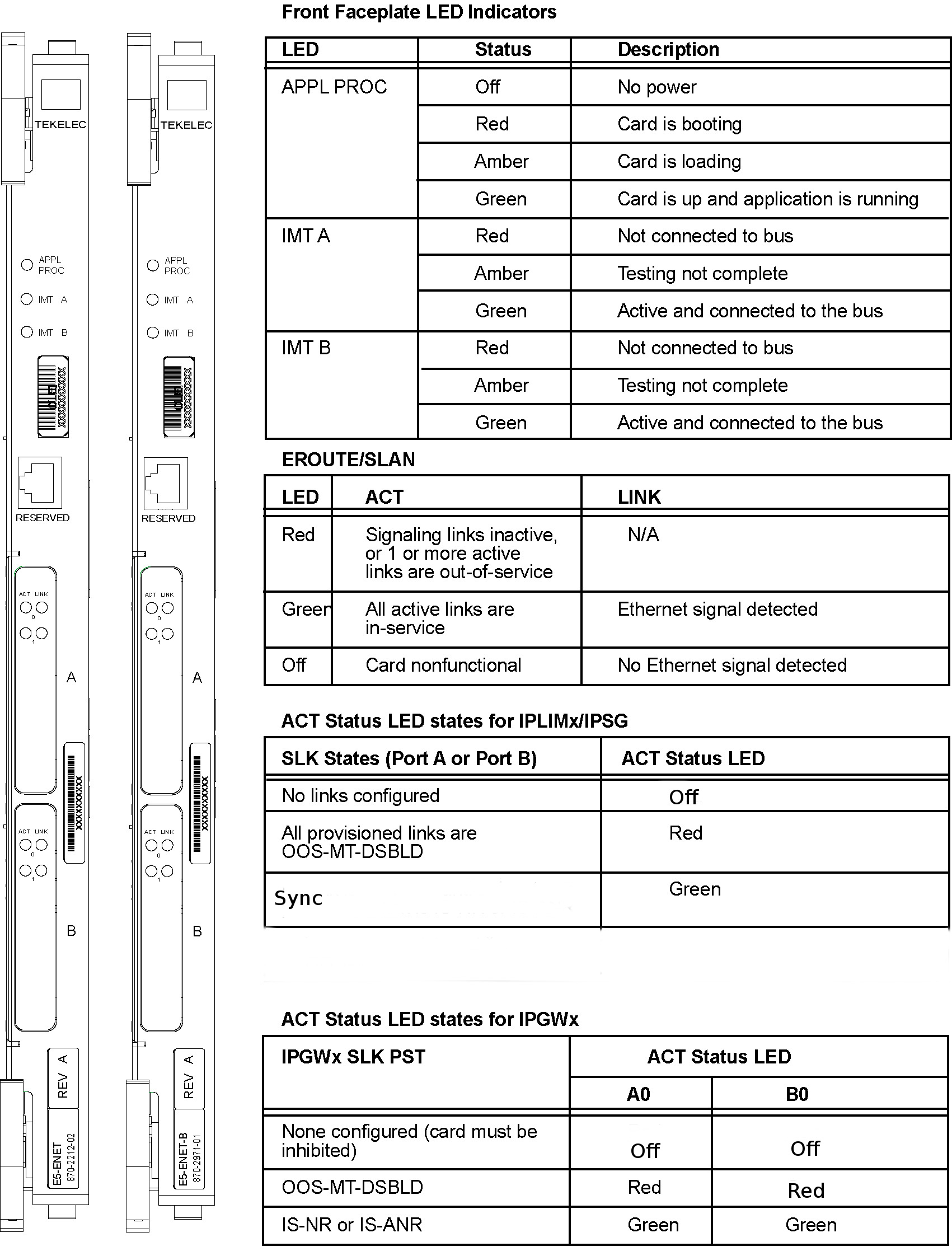

A.9 E5-ENET-B Module
The term E5-ENET refers to the E5-ENET-B (P/N 870-2971-xx).
The E5-ENET-b module (refer to Figure A-8) can run different applications. Removal and replacement procedures differ depending on the application.
If this card is removed, the link supported by this card becomes out of service.For removal and replacement procedures for a like-for-like card:
- If the E5-ENET-B card is operating with signaling interfaces such as IPLIM, IPGW or IPSG, refer to IP SIGTRAN on E5-ENET-B.
- If the E5-ENET-B card is operating with signaling interfaces such as EROUTE, refer to EROUTE on E5-ENET-B.
Figure A-8 E5-ENET-B LEDs
A.9.1 IP SIGTRAN on E5-ENET-B
Use this procedure to remove and replace an E5-ENET-B card running an application such as IPLIM, IPLIMI, IPGWI, SS7IPGW, or IPSG, or SLIC running the IPSG application.
See the "Conversion of SLIC Cards" section in Database Administration - System Management for 32-bit to 64-bit conversion and vice versa.See the "EAGLE Card Applications and GPLs" table in Database Administration - System Management for details on the flash and application GPLs that are run/required based on different card configurations.

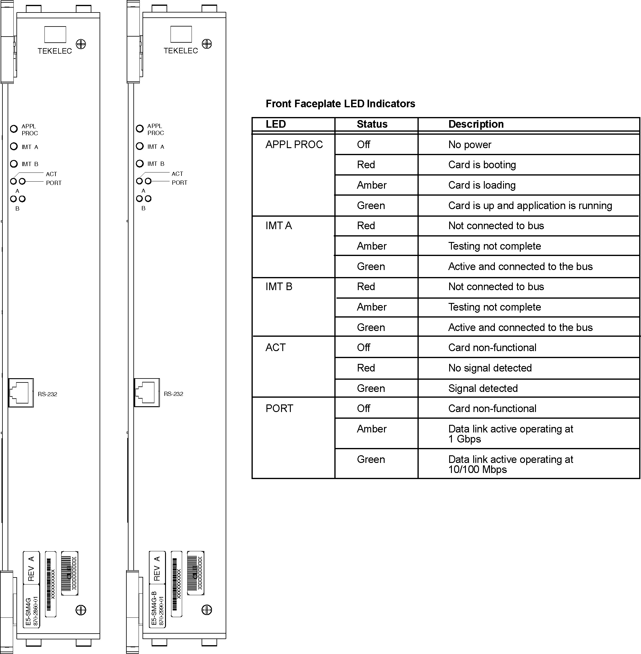

The term E5-SM4G refers to either the E5-SM8G-B (P/N 870-2990-01).
The E5-SM8G-B card is a database service module (DSM) designed to operate in the EAGLE shelf. The E5-SM8G-B is a replacement for the DSM card (P/N 870-1984-xx) and the E5-SM4G card. Ethernet ports connect to the EPAP to download the RTDB. Multiple cards are used to provide a means of load balancing in high-traffic situations. Each card contains an identical database. Furthermore, the E5-SM4G RTDBs need to be identical to the one maintained by the EPAPs.
See the "Conversion of SM8G-B Cards" section in Database Administration - System Management for 32-bit to 64-bit conversion and vice versa.Note:
If there are provisioning scripts, such as LARG data, the E5-SM4G replacement activity should be coordinated with the DB/Admin operations to avoid extended provision otherwise RADB resets may occur.A.12 E5-ENET-B Card Replacement

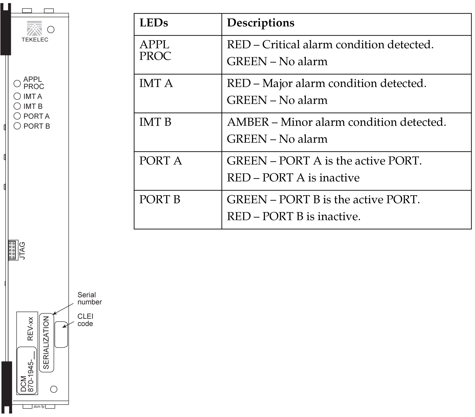

A.14 Database Communications Module (DCM)
The database communication module (DCM) (Figure A-10) provides access to a remote host for use by the STP LAN feature. The DCM consists of a 80486-based main assembly and an ethernet applique. Connection to a host is achieved through an ethernet LAN using the TCP/IP protocol.
If this card is removed, the TCP/IP data link supported by this card becomes out of service. Any data to be transmitted to the remote TCP/IP host connected by this TCP/IP data link is lost.
The DCM can only be inserted in the odd numbered card slots of the shelf. Slot 09 of each shelf contains the IPMX card; thus the DCM cannot be inserted in slot 09. The DCM can be inserted in the control shelf, but only in slots 01, 03, 05, 07, and 11. Slots 13, 15, and 17 refer to the extension shelf only. The DCM occupies two card slots, so the even numbered card slot adjacent to the odd numbered slot where the DCM has been inserted must be empty as shown in Table A-2. The DCM is connected to the network through the odd numbered card slot connector.

The Double-Slot Enhanced Database Communications Module is a version of the DCM that includes more main memory and better processing performance. The double-slot EDCM can be placed in any slot odd or even that is provisioned. Physically the next higher slot can not be provisioned for a card because of the double-slot EDCM card width.
Figure A-10 DCM LEDs

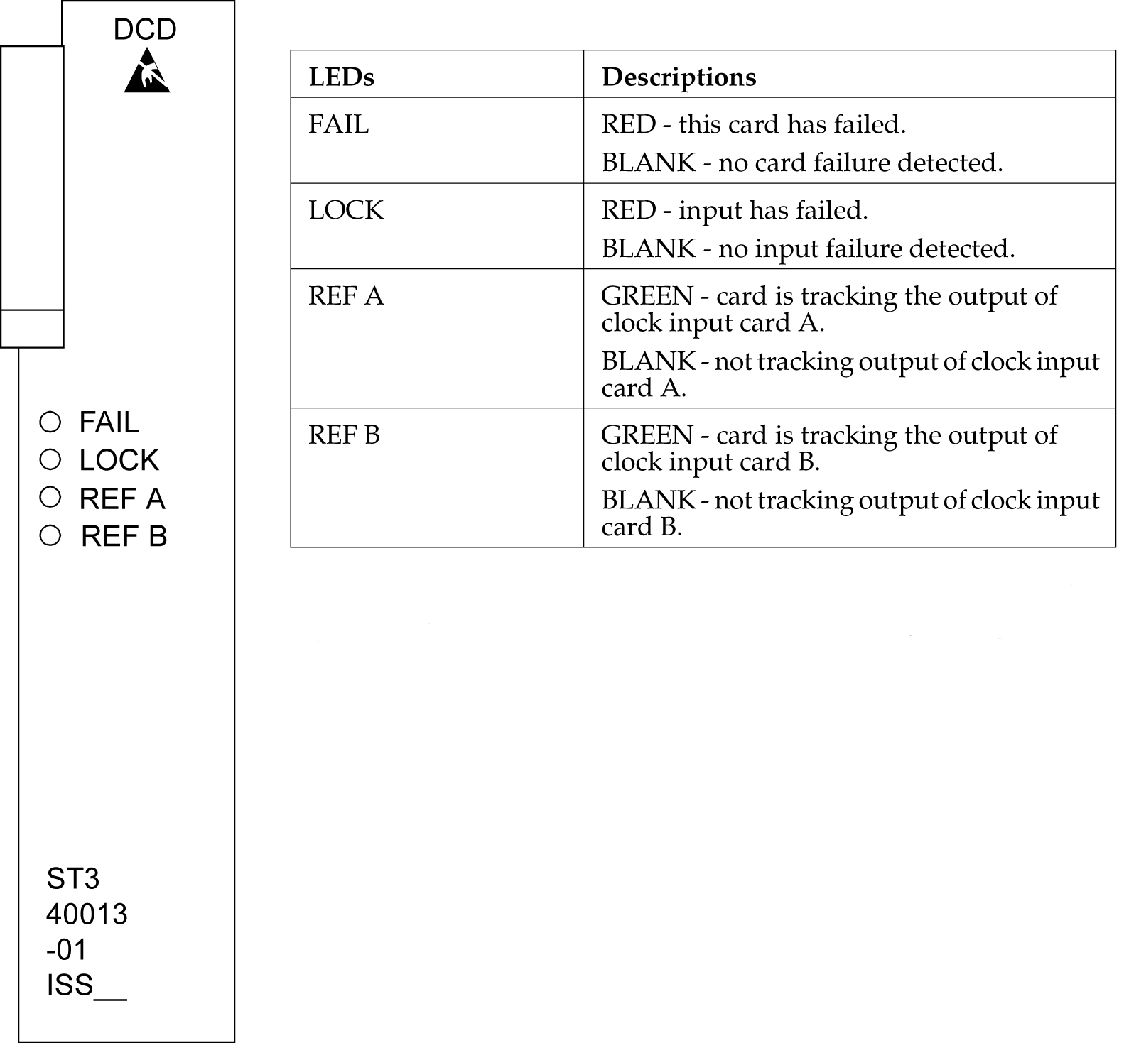

A.17.2 ST3 Card Replacement
Description
Use this procedure to replace ST3 cards. The only time an ST3 card should be replaced is if the FAIL lamp is lit, or if it is in the ST A slot and the LOCK or LOCK and FAIL lamps are not lit and the network elements receiving timing from the shelf are reporting slips. (However, the second condition is more likely a timing loop rather than a bad ST3 card.)
The ST3 card in slot B (ST B) in shelves equipped with ST3 clock cards may be removed from the shelf without any negative effect to the output, regardless if the ST3 has failed. If an ST3 is installed and not failed in slot A (ST A), it is the preferred source for the output cards. If you remove the card from the shelf, it may cause a hit to the outputs.Figure A-14 Holdover clock ST3 card LEDs
If the FAIL and LOCKLEDs are both illuminated, the ST3 is in holdover mode and the card has not failed.A.17.3 MIS Card Replacement

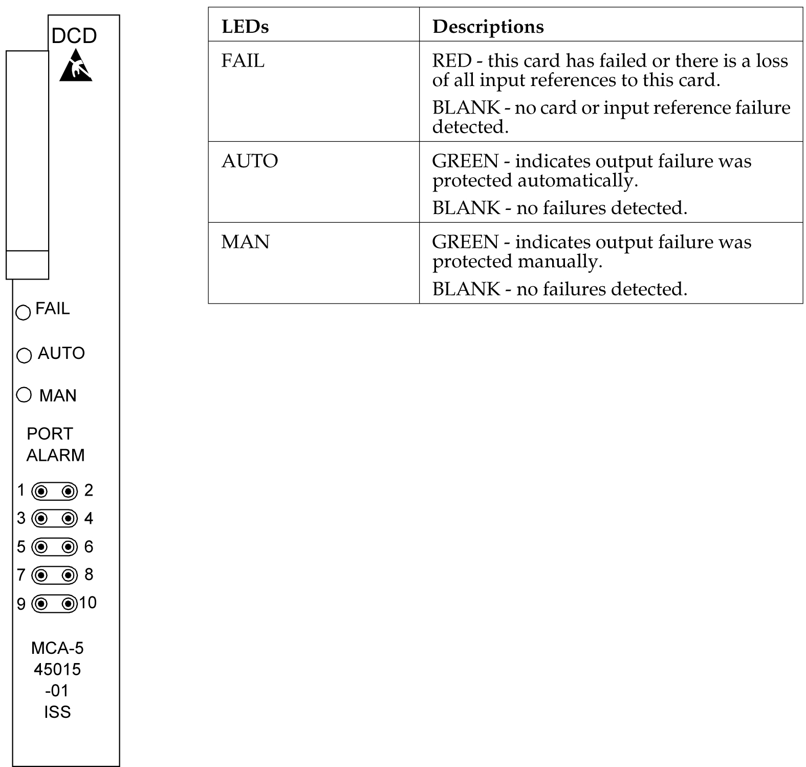

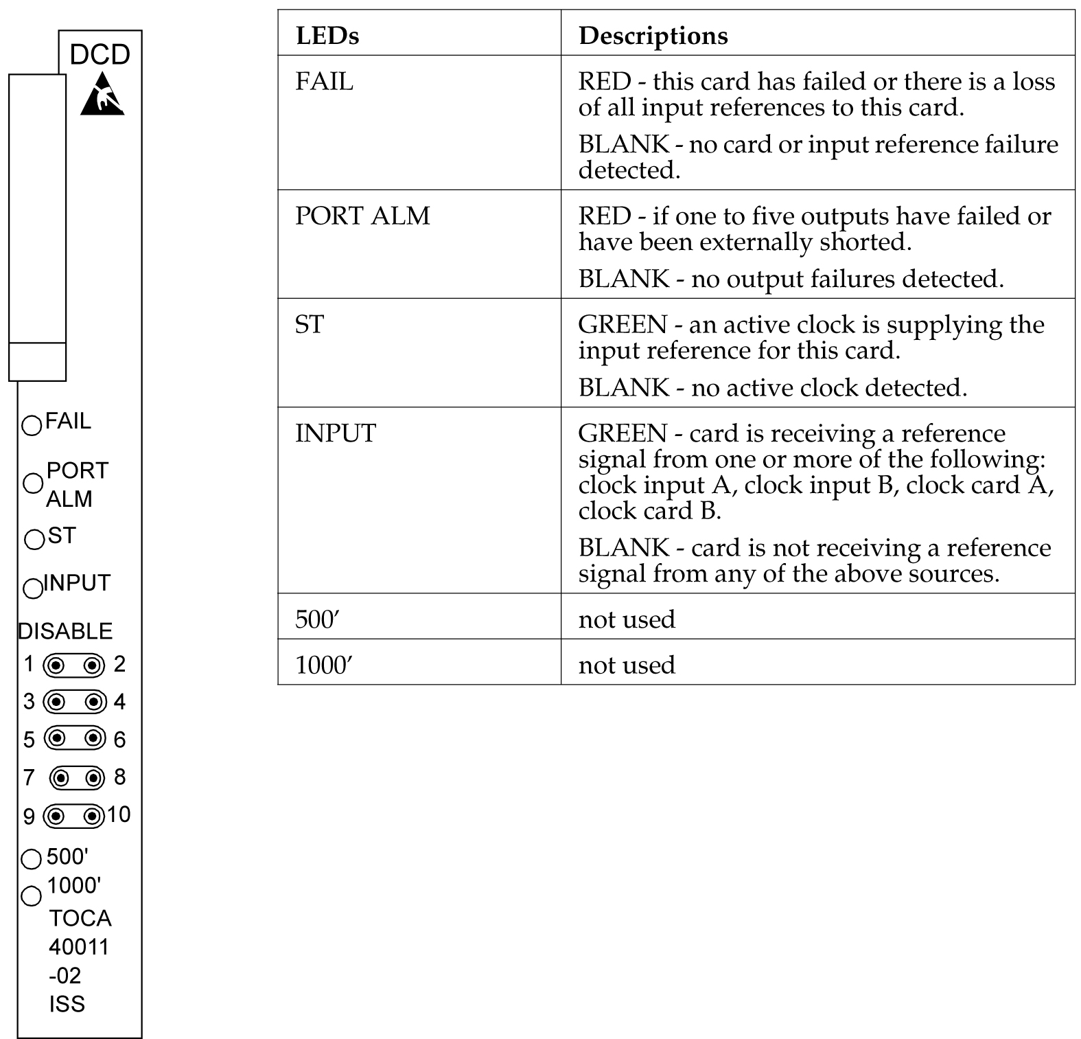

A.17.4 TOCA Card Replacement
When an MCA-5 is installed in the MCA slot, an HS protection switch automatically activates when the TOFAIL or PORTALM lamp is lit. If the TOPORTALM lamp is lit, you must determine whether it is actually a card port failure, or a shorted or unterminated cable external to the shelf. If you determine that the PORTALM is actually a port failure on the card, replace the TO card.
Figure A-16 Holdover Clock TOCA Card LEDs
Figure A-17 Holdover Clock MCA Card LEDs

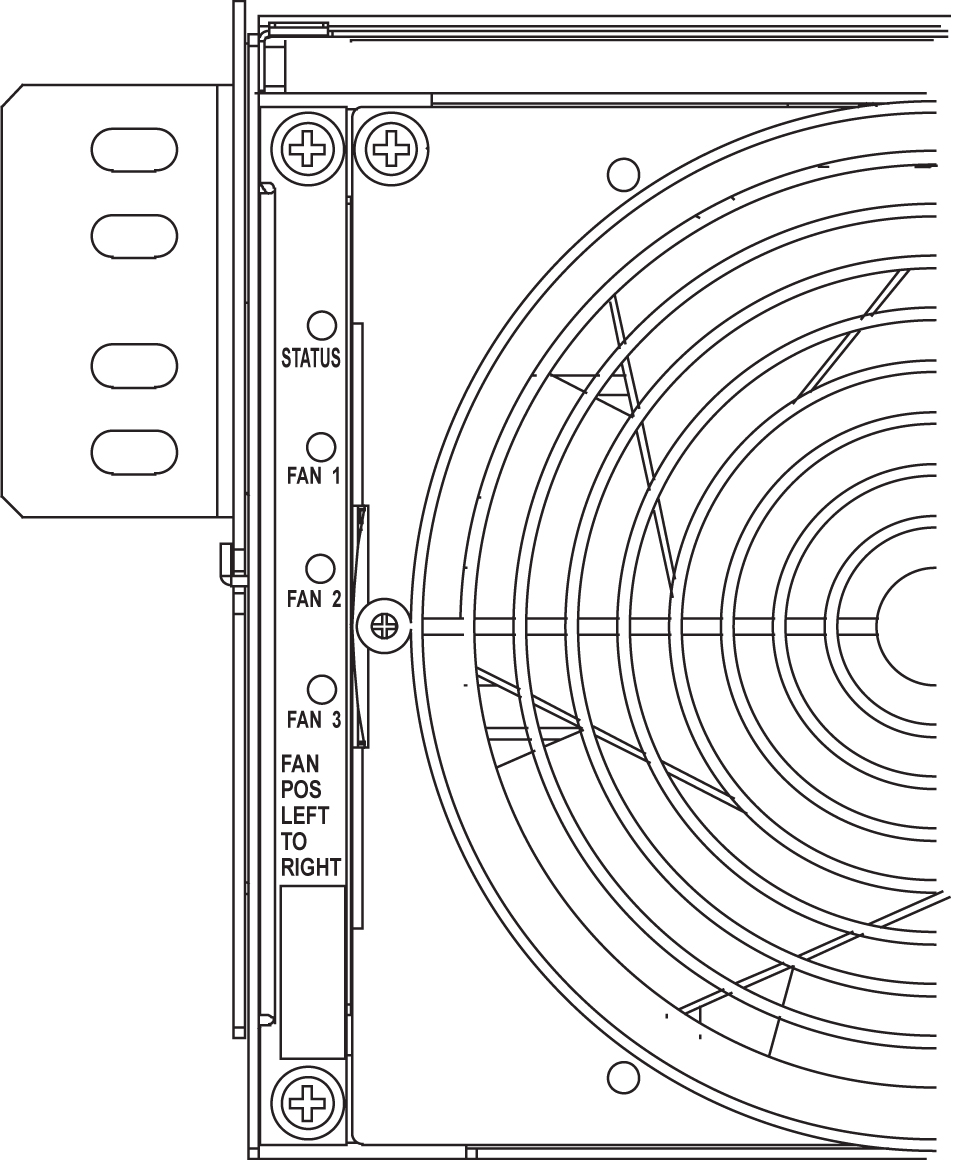

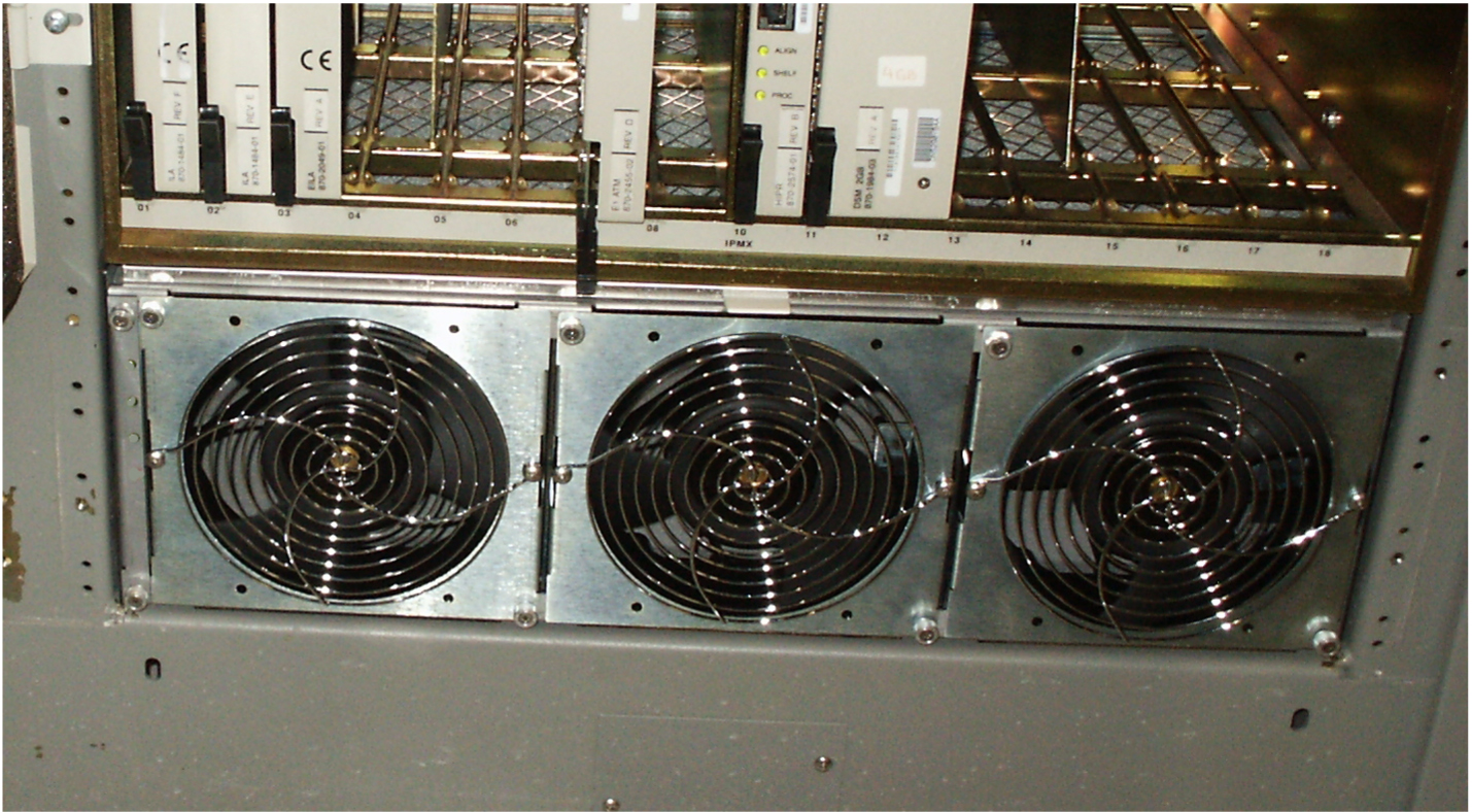

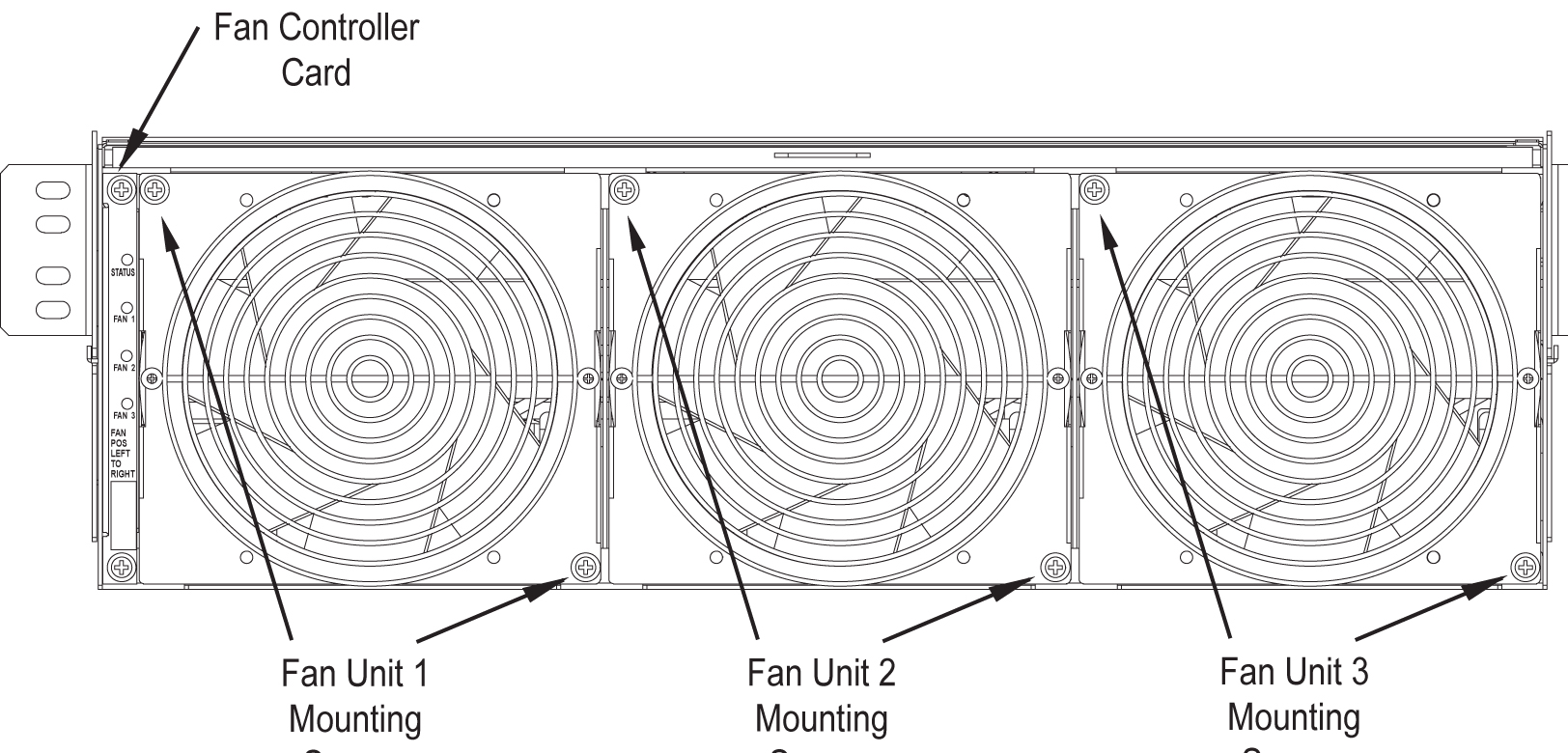

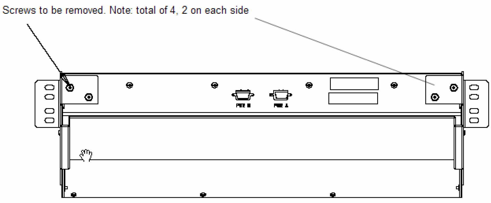

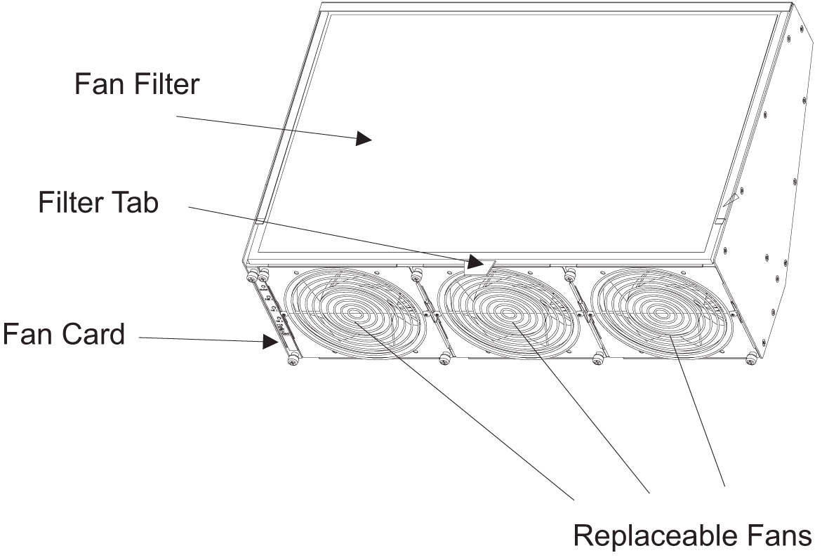

A.18 Fan Assembly P/N 890-0001-xx
The Fan Assembly P/N 890-0001-xx is used for cooling shelves in the EAGLE frame. The assembly includes 3 fan units and a controller card.
Caution:
Do not perform procedures to Replace Fan Assembly if the Fan Assembly is used to cool shelves with HCMIM or HIPR2 cards. contact the My Oracle Support (MOS).Refer to the following procedures to:
A.18.1 Replace the Fan Unit
Caution:
Be careful when removing fans. Fan blades are exposed along the sides and back of the units. The fan blade speeds of remaining fans will increase after any fan is removed.A.18.3 Replace Fan Assembly
Caution:
Do not perform this procedures if the Fan Assembly is used to cool shelves with HCMIM or HIPR2 cards. contact My Oracle Support (MOS).The following procedures are used to replace Fan Assembly P/N 890-0001-xx when it is used to cool shelves not populated with HCMIM or HIPR2 cards.

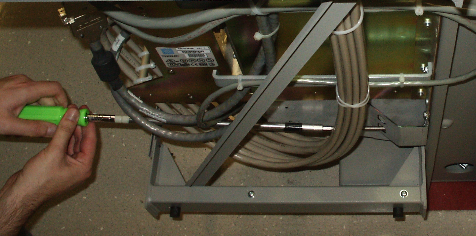

A.18.3.1 Procedure - Power Down the Fan Assembly
Use the following procedure to power down the fan assembly.

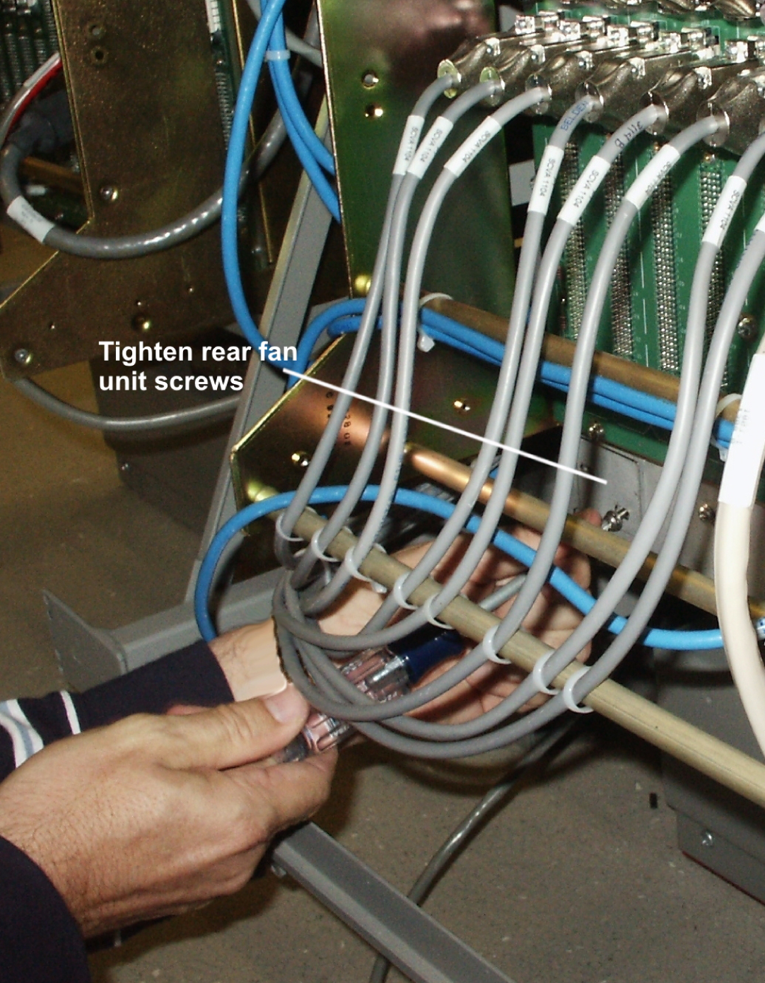

A.18.3.2 Procedure - Remove Fan Cables and Fan Assembly
Use the following procedure to remove fan cables and fan assembly.
A.18.3.3 Procedure - Install the Fan Assembly
Use the following procedure to install the fan assembly.
A.18.3.4 Procedure - Power Up the Fan Assembly
Use the following procdure to power up the fan assembly.
