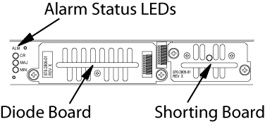

2.2.1 1U FAP P/N 870-2804-01
The 1U FAP (P/N 870-2804-01) is a low-profile unit that provides protected distribution of –48VDC power to the shelves in the frame. Allowing for the full population of a frame and for the failure of one primary supply, new installations of Control and Extension frames require two 60A feeds.
2.2.1.1 FAP Components
The FAP is composed of three field replaceable units, of which two can be hot-swapped.
Table 2-1 FAP Component Replacement
Component Replacement Requirements Part Number
Diode Board
Field replaceable
870-2806-01
Shorting Board
Field replaceable
870-2805-01
1U FAP
Field replaceable
(with service interruption)
870-2804-01
(includes Diode and Shorting Boards)
Diode Board
The diode board in the FAP contains power diodes and circuitry which allow one bus to pick up the entire load when there is a loss of input power on the other bus.
Shorting Board
The Shorting board allows the removal of the diode board without taking down the system. This permits periodic maintenance of the diodes without having to power down or remove the unit from the shelf. In the bypass position, both A and B power is connected to the fuse blocks so the diode board can be safely removed. The Shorting board has an LED which is off when the board is in normal operational mode and is green when in the bypass mode of operation.

2.2.1.3 Diode Testing and the Shorting Board
The Diode Board must be tested periodically. To test the Diode Board without powering down the entire EAGLE, peform the following procedures.
2.2.1.3.1 Maintenance Mode
This section describes how to place the Shorting Board into maintenance (bypass) mode. Maintenance mode allows the removal of the Diode Board without taking down the system.
Procedure — Shorting Board Maintenance Mode
  1. Check to verify the Shorting Board LED is not on, indicating the FAP is in normal mode.2.
  2. Locate two screws securing the Shorting Board in its slot (see Figure 2-2). Note the orientation of the Shorting Board LED. Turn the screws at each corner of the board to the left until they disengage.
    Figure 2-2 Shorting Board Faceplate, Normal Mode
    img/c_jumper_board_1u_sbops_mode_im-fig1.jpg
  3. Pull the board straight out of the FAP until the board is clear of the frame.
  4. Turn the Shorting Board over and reinsert the board into its slot. Note the orientation of the Shorting Board LED (see Figure 2-3).
    Figure 2-3 Shorting Board Faceplate, Maintenance Mode
    img/c_jumper_board_1u_sbmtc_mode_im-fig1.jpg
    The Shorting Board LED turns green and the fuse alarm LEDs turn red.
  5. Ensure the board is seated properly and tighten the two screws to secure the board.
  6. The Shorting Board is now in the maintenance (bypass) mode of operation.
2.2.1.3.2 Diode Board
This section describes how to remove and test the Diode Board.
Procedure — Remove the Diode Board
Use this procedure to remove the Diode Board for diode testing.
  1. Check to verify the Shorting Board LED is on, indicating the FAP is in maintenance (bypass) mode.
  2. Locate two screws securing the Diode Board in its slot. Turn the screws to the left until they disengage.
    Figure 2-4 Diode Board Faceplate
    img/c_1ufap_diode_board_location_maintmanual.jpg

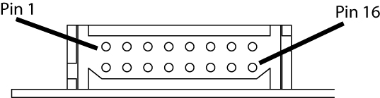

Procedure - Diode Testing
Use this procedure to test the power diodes on the Diode Board. A Digital Volt/Ohm Meter (DVM) with a Diode Setting is required. All testing is performed at the edge connector (J1) on the board.
Figure 2-5 Diode Board Edge Connector J1
img/c_1ufap_location_j1_maintmanual.jpg
  1. Set the DVM to test diodes.
  2. Connect the DVM positive (+) lead and negative (-) lead to the pins indicated for each power diode.
    Table 2-4 Power Diode Test Points
    Diode J1 Pin Positive (+) Lead J1 Pin Negative (-) Lead
    CR1 #1
    3
    16
    CR1 #2
    6
    16
    CR2 #1
    14
    1
    CR2 #2
    11
    1
    CR3 #1
    4
    16
    CR3 #2
    5
    16
    CR4 #1
    13
    1
    CR4 #2
    12
    1
    The DVM should indicate a short circuit (>0.1V, <0.2V). Record the measurement.
  3. Reverse the leads.
    The DVM should indicate an open circuit (OL). Record the measurement.
  4. If any measurements are in error, the diode board must be replaced.
  5. If the measurements are within acceptable parameters, reinstall the Diode Board.

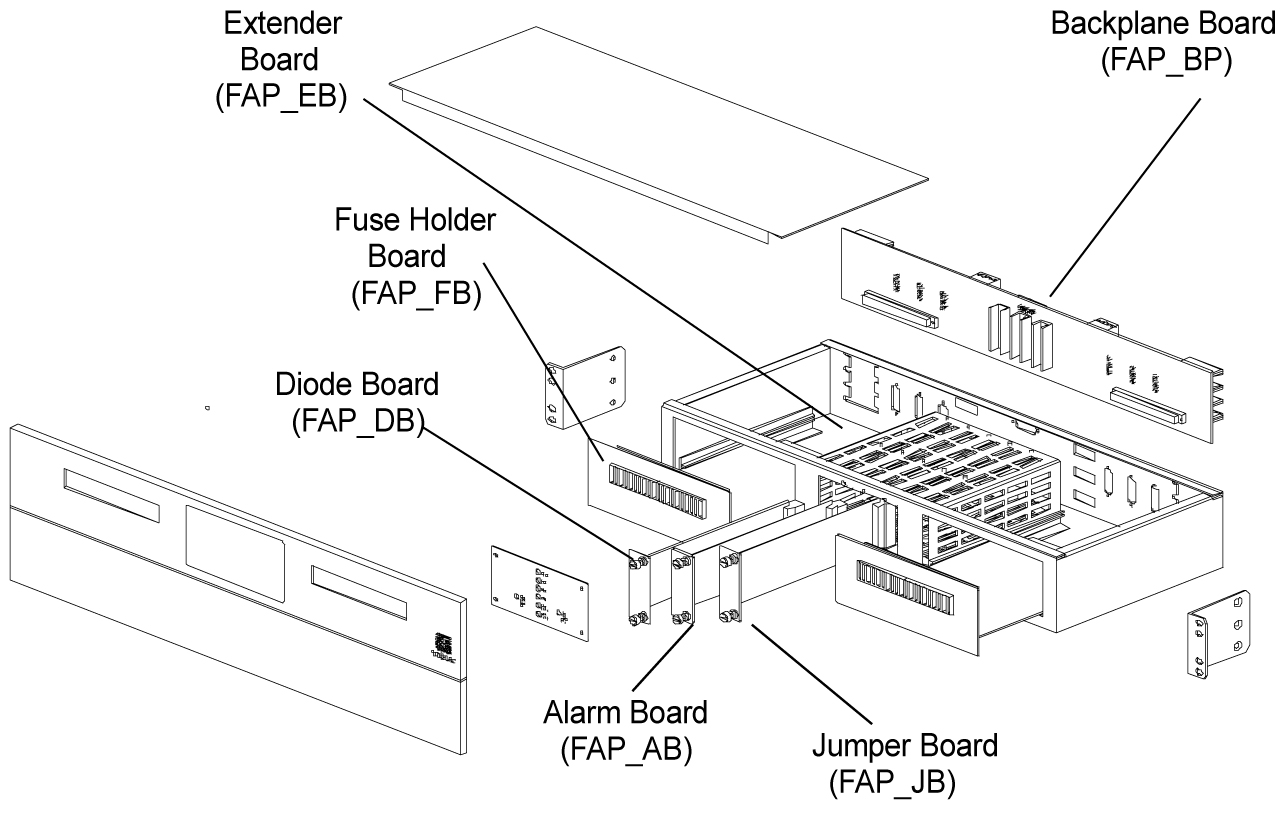

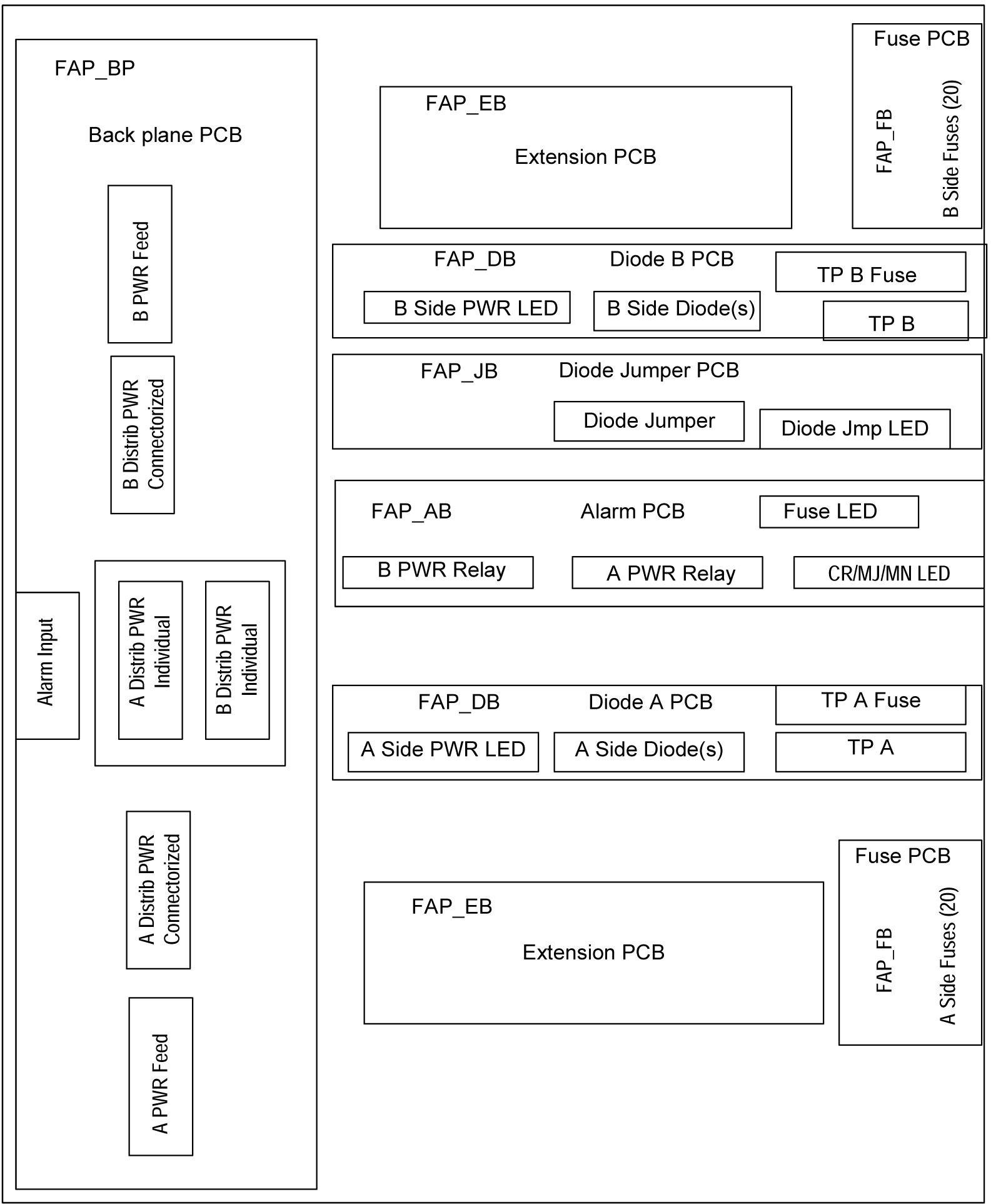

The FAP consists of nine printed circuit boards, each identified by an acronym on its label (see Figure 2-8):
  • Backplane (FAP_BP): Located inside the FAP unit, parallel to the back side of the FAP box.
  • Alarm board (FAP_AB): Located on the center-right of the front panel, set vertically inside the FAP unit, perpendicular to the front panel.
  • Diode boards (FAP_DB): Two boards located on the front panel, flanking the Alarm and Jumper boards on the left and right, and perpendicular to the front panel. Set vertically inside the FAP unit.
  • Extender boards (FAB-EB): Two boards located inside the FAP unit, parallel to the bottom of the FAP box, on the far right and left of the unit.
  • Fuse holder boards (FAP_FB): Two boards located inside and parallel to the front panel, on the far right and left of the FAP unit.
  • Jumper board (FAP_JB): Located on the center-left of the front panel, set vertically in the unit, perpendicular to the front panel.
Figure 2-8 Location of FAP Components
img/c_fap_components_maintmanual-fig1.jpg
Each of the FAP components has associated functions.
Figure 2-9 FAP Component Functions
img/c_fap_components_maintmanual-fig2.jpg
The FAP is composed of nine circuit boards. Eight of these circuit boards are field replaceable, and can be hot-swapped.

  1. Check to verify the OP/MAINT LED is green, indicating the FAP is not in maintenance mode.
  2. Unscrew the two thumbscrews securing the FAP jumper board and remove the board.
  3. On the jumper circuit board, move the jumper (the DB-26 male connector) from P71 to P72. Tighten the thumbscrews connecting the jumper to its mate, to ensure a good connection. This repositioning overrides the diodes, establishing a direct connection between input and fuse panels.
    warning:
    If fuses are blown, DO NOT continue with this procedure. Instead, contact My Oracle Support (MOS) at the appropriate number.
  4. Make sure the glass fuses are installed and verify they are “good” by using the multimeter to check for continuity across each of the glass fuses.
  5. Verify that two glass fuses are behind the P72 connector. If these fuses are not present, install them before continuing.
  6. Slide the jumper board back into the FAP and verify both of the following alarms display:
    • the OP/MAINT LED lights red on the FAP
    • an EAGLE fuse alarm displays on the terminal
      You may now remove either or both diode circuit boards without affecting EAGLE service.
    Using the jumper override negates the backpower protection usually provided by the diode board.
  7. Locate diode board A and unscrew the two thumbscrews securing the board. Remove the board from the FAP.
  8. Locate the diode to be tested. It has three pins and is attached to the large heat sink. The diode is labeled CR43.
  9. Set your digital multimeter to measure resistance.
  10. Measure the resistance between the center pin of the diode and either of the outside pins. Record this measurement.
  11. Measure the resistance between these same pins again, but switch the multimeter leads, so the positive lead is now on the opposite pin. Record this measurement.
  12. Compare the two measurements. If the diode is functioning properly, one reading should be less than 10K ohms and the other should be much greater.
    If both readings are above or below 10K ohms, the diode may have failed. Replace the failed board with a spare diode board.
  13. Repeat steps 9 through 11, measuring the resistance between the other outside pin and the center pin.
    This completes the test for diode board A.
  14. Repeat steps 6 through 12, using diode board B. This completes the test for diode board B.
  15. Reinsert the two functional diode boards. Tighten the thumbscrews on each board to secure it to the FAP.
  16. Unscrew the two thumbscrews securing the FAP jumper board and remove the board.
  17. On the jumper circuit board, move the jumper (the DB-26 male connector) back from P72 to its original position on P71. Tighten the thumbscrews connecting the jumper to its mate, to ensure a good connection. This repositioning returns the diodes to their original, non-maintenance position.
  18. Slide the jumper board back into the FAP. Verify the OP/MAINT LED lights green. The fuse alarm LED returns to green.
    The diode board testing procedure is completed.

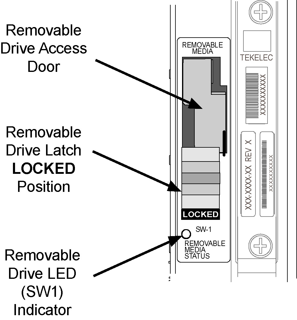

    The removable drive latch (SW1) is in the LOCKED position and the Removable Media Status LED on the E5-MASP is Off. Refer to Figure 2-10.
    Figure 2-10 Removable USB Drive LOCKED
    img/870-2903-xx_e5-masp_removable_drive_latch_locked.jpg

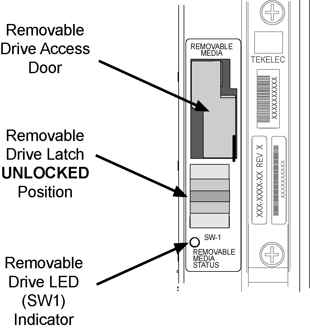

  2. Move SW1 from the LOCKED to the unlocked position and wait for the LED to indicate a steady blue state. See Figure 2-11.
    When SW1 is transitioned from locked to unlocked, the LED will flash blue to indicate the drive is unlocked and in process of shutting down.
    Caution:
    Removal of the drive prior to the LED indicating steady blue could result in drive corruption.
    Figure 2-11 Removable USB Drive UNLOCKED
    img/870-2903-xx_e5-masp_removable_drive_latch_unlocked.jpg
  3. When the LED indicates a steady blue state, the removable USB drive can be safely removed. The LED is off when the USB drive is fully ejected from the drive media.
    The USB drive can now be removed from the drive media.

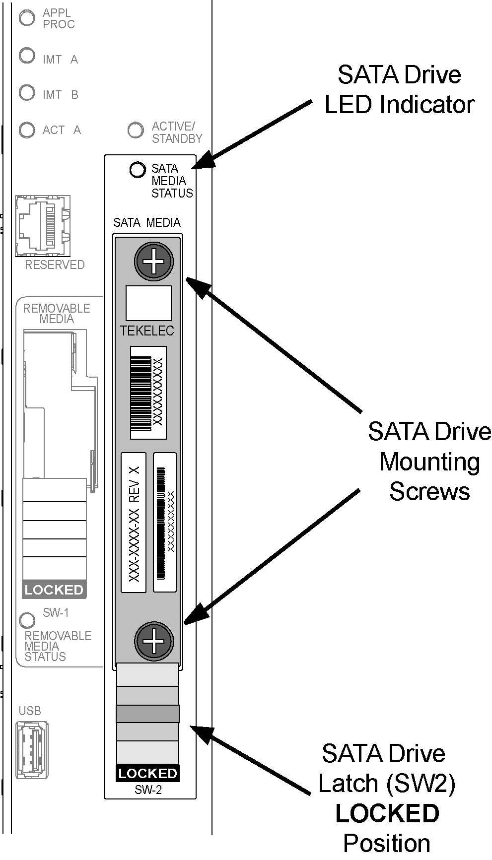

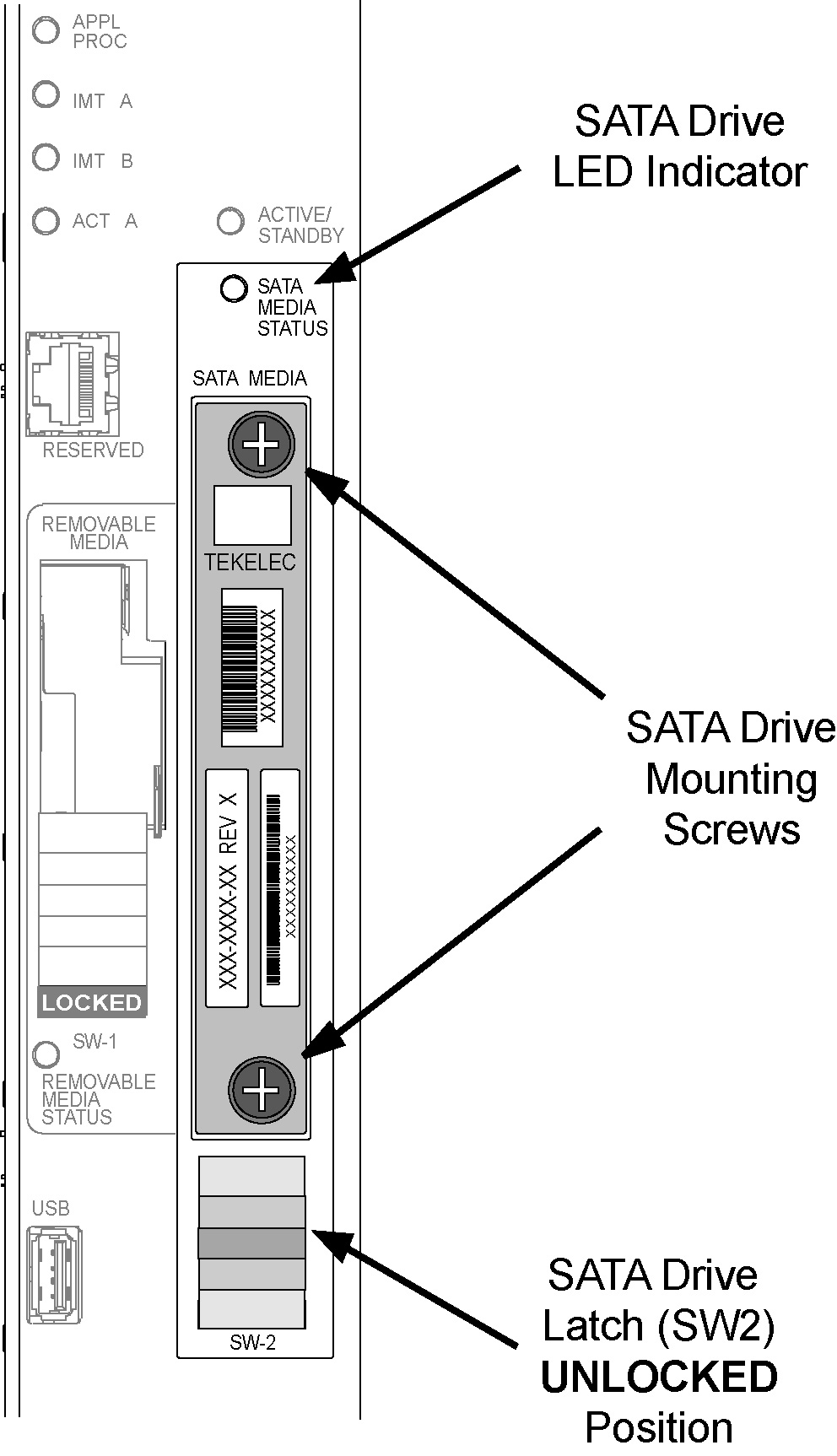

2.3.2 Fixed SATA Drive
Purpose:
This section is referenced in this user's guide by many procedures requiring the use of the fixed SATA drive in the E5-MASP card. The procedures found in this section are recommended procedures for handling the fixed drive in the E5-MASP card.
Requirements
  • The new SATA Drives to be installed should be at the current system release.
  • Before beginning this procedure, make sure there is a copy of the current release GPLs on a removable USB drive on-hand.
  • System backups should be performed prior to the start of this procedure. Refer to Daily Procedures.
  • You must be logged in to the EAGLE prior to performing this procedure.

  11. Verify that the SATA drive is locked in position and in use. Refer to Figure 2-12.
    The SATA drive latch (SW2) is in the LOCKED position and the SATA Media Status LED on the E5-MASP is Off.
    Figure 2-12 SATA Drive Locked

  12. Move SW2 from the LOCKED to the unlocked position and wait for the LED to indicate a steady blue state. See Figure 2-13.
    When SW2 is transitioned from locked to unlocked, the LED will flash blue to indicate the drive is unlocked and in process of shutting down.
    Caution:
    Removal of the drive prior to the LED indicating steady red could result in drive corruption.
    Caution:
    If locking switch is transitioned from locked to unlocked and the E5-MASP is in service, removal of the drive module will result in a card obit. All drive LEDs will blink red.
    Figure 2-13 SATA Drive UNLOCKED
    img/870-2903-xx_e5-masp_sata_drive_latch_unlocked.jpg
  13. When the LED indicates a steady blue state, the SATA drive can be safely removed. The LED is off when the drive is fully ejected from the drive.
    The drive can now be removed from the slot.

  3. Insert the removable USB drive labeled “Daily Backup” into the removable USB media slot. You can also use the USB storage media in the flush-mounted USB port of the MASP card for backups.
    Reference: Removable Drives

  6. Remove the removable USB drive from the removable USB media slot.
