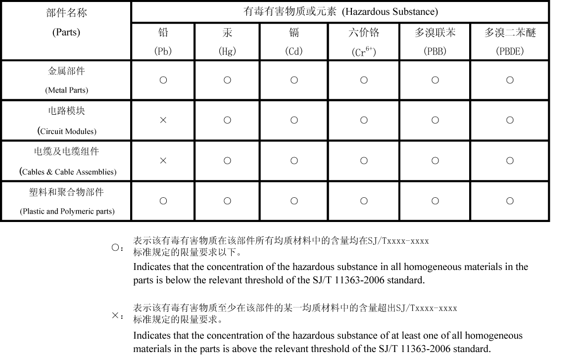

  • Relevent standards in SJ/T 11363-2006 for limits of certain hazardous substances.
    Figure 2-3 Hazardous Substances
    img/0-china-hazardous-substances-table-01.jpg

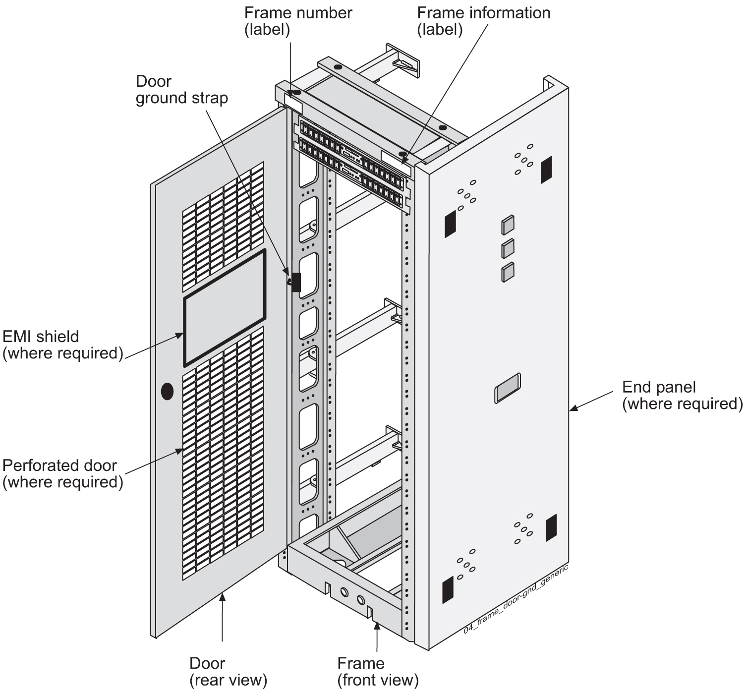

    For products installed in a frame, the doors installed are grounded to the frame through a two-hole lug ground wire and through a screw-down latch. Figure 2-4 shows a cutaway view example of an open frame door showing the door ground strap.
Figure 2-4 Door Grounding Strap Placement
img/r-grounding-power-requirements-t11-fig1.jpg
