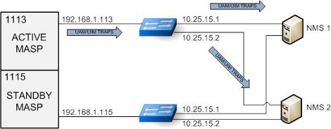

Data Flows
Under normal operating conditions, the Active MASP generates asynchronous traps which represent UIMs and UAMs. The traps are transmitted to one or two NMSs over the Active MASP IP link. Figure 3-2 example shows a typical network configuration for normal Eagle SNMP functions. The standby network configuration is available, so when a MASP switch of activity occurs, SNMP activity will be transmitted over its connections when the standby MASP becomes active.

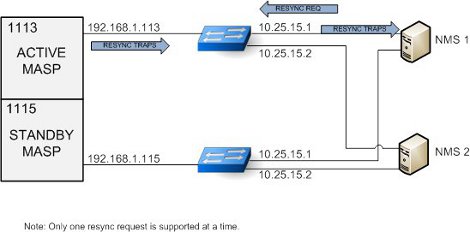

When an NMS becomes out of sync with the Eagle alarm status, the NMS may issue a SET request to initiate a resynchronization. The SET request is directed to the Active MASP only. Incoming synchronous EAGLE alarms and UIMs are buffered during an active resynchronization, and transmitted to the NMS once the resynchronization is complete in the same order they were received. The resynchAlarmTrap responses will be returned from the Active MASP. See Figure 3-3.
Figure 3-3 Resynchronization Request/Trap Flow
img/snmp_resync_req_trap_flow.jpg

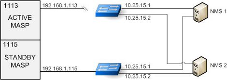

When the Active MASP IP link is inoperable, no asynchronous traps will not pass through the Standby MASP IP link, and resynchronization requests will not be handled by the Standby MASP. Because the alarm status is maintained on the Active MASP, only the Active MASP can transmit the UIM and UAM traps to the NMSs. If this situation occurs, either repair the IP link between the Active MASP and at the NMS, or switch MASP activity to the standby MASP. See Figure 3-4.
Figure 3-4 UAM/UIM Trap Flow with Active Link Down
img/snmp_trap_flow_active_link_down.jpg

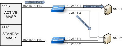

Asynchronous UAM/UIM trap flows when the Standby MASP link is down are identical to the normal data flows. An inoperable link on the Standby MASP does not interfere with normal data flows. See Figure 3-5.
Figure 3-5 UAM/UIM Trap Flow with Standby Link Down
img/snmp_trap_flow_standby_link_down.jpg
