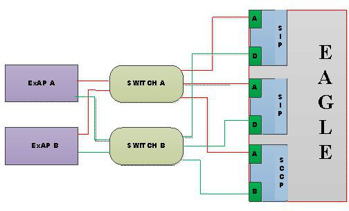

ExAP Interface
The SIP card connects to ExAP using port A. Download the RxDB data on the SIP card in same manner as on other Service Module cards.
The SIP NP feature performs lookup RxDB using Normalized DN. Perform lookup for RTDB, first on individual entries, and if no match is found, then on range DNs. See Figure 2-1.
Figure 2-1 SIP Card Interface with ExAP
img/sipexap.jpg
  • If the connection between the ExAP and a SIP card goes down, the SIP card will continue to receive and process the SIP messages using the stale RxDB.
  • If the connection between the ExAP and a SIP card goes down, in order to process SIP messages using an up-to-date RxDB, the user needs to manually change the cable to make an ExAP connection with another SIP card or ExAP switch. Alternatively, the user can inhibit the SIP card to force SIP messages to be processed by other SIP cards in the system.

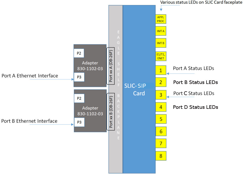

On the SLIC card, the Ethernet Interfaces 1 and 4 (mapped to ports A and D, respectively, are used for ExAP connectivity and Ethernet Interfaces 2 and 3 (mapped to ports B and C, respectively) are used for the Signaling Network. As shown in Figure 2-2, backplane DB26 ports A and B are labeled on the backplane for each slot of the shelf (that is, Port <slot number> A and Port <slot number> B). Backplane adaptors (part number 830-1102-03) are attached to backplane ports A and B. The adaptor connected to backplane port A supports the port A Ethernet interface through adaptor port P3, and the adaptor connected to backplane port B supports the port B Ethernet interface through adaptor port P3.
Figure 2-2 SLIC SIP Card - Ethernet Interface Connections and Status LEDs
img/slic_sip.jpg
Figure 2-2 also shows the status LEDs 1 and 3 that are on the SLIC faceplate, and their associations with the A and B Ethernet interface ports. The status LEDs on the SLIC faceplate are pictured in Figure 2-3.

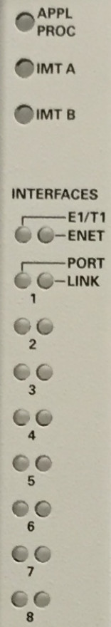

Figure 2-3 SLIC Faceplate Status LEDs
img/slic_no_lights2.jpg
Table 2-3 and Table 2-4 describe LED operations for the Ethernet Interfaces on SLIC cards.

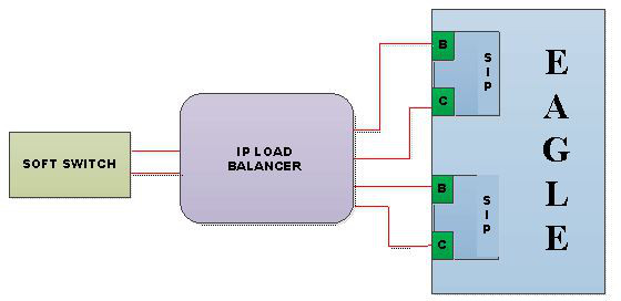

SIP Redundancy
Redundancy is divided into the signaling network side redundancy and private network side redundancy on either the E5-SM8G-B or SLIC.

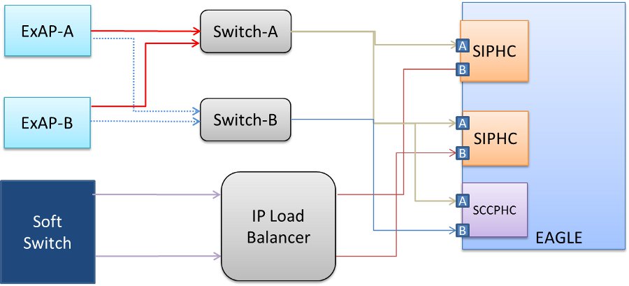

E5-SM8G-B Signaling Network Redundancy
An External IP Load Balancer provides Signaling side redundancy. It will provide both scalability and load sharing.
EAGLE supports multiple SIP Application cards. Each card has separate IP addresses and operates independently.
The IP load balancer will make connections with all SIP cards and load share the traffic. If one SIP card goes down, traffic currently being handled by that card will get lost. SIP Load Balancer will not use that card for load sharing traffic until the card is ready to handle traffic again.

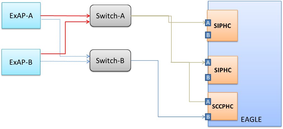

E5-SM8G-B Private Network Redundancy
The SIP Card connects to ExAP using a Private Network. Port A on the SIP card will be reserved for ExAP connection. There is no ExAP redundancy. If the connection to ExAP goes down, the SIP card continues to operate with the existing RxDB. Figure 2-4 shows signaling network and private network side redundancy.
Figure 2-4 SIP Redundancy
img/sip_redundancy.jpg

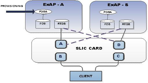

SLIC Private Network Redundancy
A SLIC card running the SIP application will connect to ExAP using ports A and D to support redundancy. Download the RTDB data in the same manner as on E5-SM8G-B cards.
The difference between the ExAP connectivity on a SLIC card and E5-SM8G-B card is that, upon the failure of one switch or port, the SLIC card starts data download via another switch or port in the same manner as data downloads for the SCCP application.
Failure of a port on a single SLIC card (out of many) will not cause the card to download via another port until all the cables are disconnected from the active EPAP.
Figure 2-7 SLIC Card Private Network Redundancy
img/c_sipnp_slic_private_redundancy.jpg
