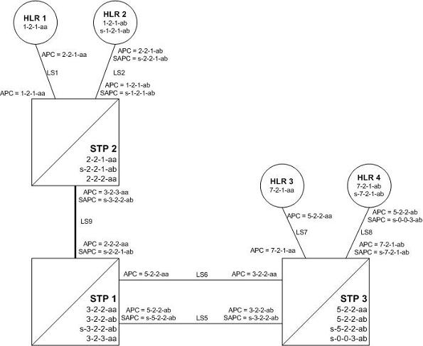

ITU National Duplicate Point Codes
This feature applies only to 14-bit ITU national spare and non-spare point codes.
This feature allows an EAGLE mated pair to route traffic for two or more countries that may have overlapping point code values. For example, in the network shown in Figure 2-3, both Country 1 and Country 2 have SSPs with a PC value of 2047.
Figure 2-3 Network Example #1

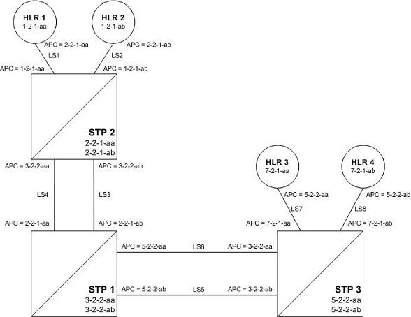

Group Codes
Users must divide their ITU-National destinations into groups. These groups will likely be based on Country. However, one group could have multiple countries within it, or a single country could be divided into multiple groups. The requirements for these groups are:
- No duplicate point codes are allowed within a group.
- ITU-National traffic from a group must be destined for a PC within the same group.
- The user must assign a unique two-letter group code to each group.
For example, in the network shown in Figure 2-4, Country 1 can only have 1 point code with a value of 2047. Traffic coming from SSP 2047 in Country 1 can only be destined to other nodes within Country 1. In this example, the user assigns a group code of 1 to Country 1, and a group code of 2 to Country 2.
When the user enters an ITU-National point code, they must also enter the group code, using the format “point code - group code”. This group code must be used for any command that uses an ITU-N point code.
For example, to provision the EAGLE for the network shown in Figure 2-4, the user would enter these commands:
ent-dstn:dpcn=2047-aa
ent-dstn:dpcn=2048-aa
ent-dstn:dpcn=2047-ab
ent-dstn:dpcn=2049-ab
ent-ls:lsn=LS1:apcn=2047-aa
ent-ls:lsn=LS2:apcn=2047-ab
ent-ls:lsn=LS3:apcn=2048-aa
ent-ls:lsn=LS4:apcn=2049-ab
Group Code aa
The following special rules apply to group code aa:
- ITU-N MSUs received on an ITU-I linkset are assigned group code of aa.
- ITU-N destinations entered before this feature is turned on are assigned group code of aa when the ITUDUPPC feature bit is turned on.
Normal Operation
When an ITU-N message arrives at the EAGLE, the EAGLE creates an internal point code based on the 14 bit PC in the message, and the group code assigned to the incoming linkset.
For example, when a message arrives on LS3 with DPC of 2047, the EAGLE maps that to an internal point code of 2047-aa, because LS3 has a group code of aa. The EAGLE then routes the message to LS1, which is the route for 2047-aa.
When a message arrives on LS4 with DPC of 2047, the EAGLE maps that to an internal point code of 2047-ab, because LS4 uses group code ab. The EAGLE then routes the message to LS2, which is the route for 2047-ab.
C Linksets
For each group defined, a separate C-linkset must be defined. This C-linkset is used as the alternate route for point codes in the group.
For example, in Figure 2-4, LSC1 is used for point codes in Group fr. Its adjacent point code is 6201-fr, and is used as the alternate route for 6217-fr, 6218-fr, and 6223-fr.
LSC2 is used for point codes in Group ge. Its adjacent point code is group 4169-ge, and is used as the alternate route for 6200-ge, 6209-ge, and 6217-ge.
Figure 2-4 Network Example #2
For example, to provision the EAGLE for the network shown in Figure 2-5, the user would enter these commands:
ent-dstn:dpcn=6201-fr (Mate's true PC)
ent-dstn:dpcn=4169-ge (Mate's secondary PC)
ent-dstn:dpcn=6217-fr (Group fr destinations)
ent-dstn:dpcn=6218-fr
ent-dstn:dpcn=6223-fr
ent-dstn:dpcn=6200-ge (Group ge destinations)
ent-dstn:dpcn=6217-ge
ent-dstn:dpcn=6209-ge
ent-ls:lsn=LSC1:apcn=6201-fr:lst=C (C linkset used by Group fr)
ent-ls:lsn=LSC2:apcn=4169-ge:lst=C (C linkset used by Group ge)
ent-ls:lsn=LSB1:apcn=6217-fr:lst=B
ent-ls:lsn=LSB2:apcn=6200-ge:lst=B
ent-rte:dpcn=6217-fr:lsn=LSB1:rc=10 (primary route for a Group fr destination)
ent-rte:dpcn=6217-fr:lsn=LSC1:rc=20 (alternate route for a Group fr destination)
ent-rte:dpcn=6217-ge:lsn=LSB2:rc=10 (primary route for a Group ge destination)
ent-rte:dpcn=6217-ge:lsn=LSC2:rc=20 (alternate route for a Group ge destination)

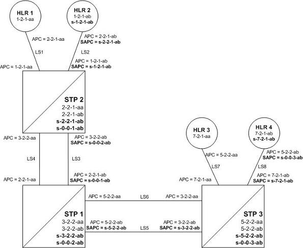

Conversion between ITU-N and ITU-I or ANSI
Each ITU-N destination and group code can have its own ITU-I or ANSI alias PC. Each ITU-I or ANSI node can be assigned one ITU-N destination. For conversion from ITU-I or ANSI to ITU-N to succeed, the ITU-N alias of the sending node must have the same group code as the destination's group code. So each ITU-I or ANSI node can only send and receive messages from one ITU-N group.
Figure 2-5 Network for Conversion
In Figure 2-5, SSP-N1 (2045-bd) is assigned ITU-I alias 1-6-1, and SSP-N2 (2045-xy) is assigned ITU-I alias 1-7-1. SSP-I1 is assigned ITU-N alias 2130-bd and SSP-I2 is assigned ITU-N alias 2131-xy. In this example, SSP-I1 can exchange traffic with nodes in group bd, but not nodes in group xy. SSP-I2 can exchange traffic with nodes in group xy, but not nodes in group bd.
SSP-I1 (1-5-1) can send to SSP-N1 by using the ITU-I alias 1-6-1, But if SSP-I1 tries to send to 2045-xy by using the ITU-I alias 1-7-1, conversion will fail, and the EAGLE will generate UIM 1091 (Indicating OPC conversion failed).
SSP-N1 can send traffic to SSP-I1, but SSP-N2 cannot send traffic to SSP-I1. SSP-N1 sends an ITU-N MSU with DPC set to 2130. The EAGLE assigns a group code of bd to the MSU based on the incoming linkset. The EAGLE then looks up 2130-bd, determines that this is an alias for ITU-I 1-5-1, and routes the MSU to SSP-I1.
If SSP-N2 sends an ITU-N MSU with DPC set to 2130, the EAGLE assigns a group code of xy to the MSU based on the incoming linkset. The EAGLE then looks up 2130-xy, does not find a match, and discards the MSU.
To provision the SSP-N1, SSP-N2, SSP-I1, and SSP-I2 in the network shown in Figure 2-5, the following commands are used:
ent-dstn:dpcn=2045-bd:aliasi=1-6-1
ent-dstn:dpcn=2045-xy:aliasi=1-7-1
ent-dstn:dpci=1-5-1:aliasn=2130-bd
ent-dstn:dpci=1-5-2:aliasn=2131-xy
ent-rte:dpcn=2045-bd:lsn=LSB1:rc=10
ent-rte:dpcn=2045-xy:lsn=LSB2:rc=10
ent-rte:dpci=1-5-1:lsn=LSB3:rc=10
ent-rte:dpci=1-5-2:lsn=LSB3:rc=10

Figure 2-10 shows an example network that is not using the ITU National and International Spare Point Code Support feature.

Figure 2-11 shows an example network. The items shown in bold are items that are added during this stage of the migration procedure.
The following steps are performed for each node shown in Figure 2-11, one at a time, as part of this stage of the migration procedure.
- Upgrade each EAGLE shown in Figure 2-11 to the software release that contains the ITU National and International Spare Point Code Support feature by performing the appropriate upgrade procedure.
- Enable the ITU National and International Spare Point Code Support feature on each EAGLE shown in Figure 2-11, by performing the Activating the ITU National and International Spare Point Code Support Feature procedure. Do not turn the feature on at this time.
Provisioning for the ITU National and International Spare Point Code Support feature can be performed once the feature is enabled. Message processing based on this feature is not performed until the feature is turned on. - Add a new true ITU-National spare point code in the self identification table of each EAGLE by performing the Adding a Point Code to the Self-Identification of the EAGLE procedure at each EAGLE. For example, add these point codes:
- Point code s-3-2-2-ab to STP 1
- Point code s-2-2-1-ab to STP 2
- Point code s-5-2-2-ab to STP 3.
- Add one secondary ITU-National spare point code to each EAGLE by performing the Adding a Secondary Point Code procedure. For example, add these point codes:
- Point code s-0-0-1-ab to STP 2
- Point code s-0-0-2-ab to STP 1
- Point code s-0-0-3-ab to STP 3.
- Add a secondary adjacent ITU-National spare point code (SAPC) to the linksets whose APCs have the “ab” suffix by performing the Configuring an ITU Linkset with a Secondary Adjacent Point Code (SAPC) procedure. For example, add these secondary adjacent point codes:
- SAPC s-0-0-1-ab for linkset LS3 in STP 1
- SAPC s-0-0-2-ab for linkset LS3 in STP 2
- SAPC s-5-2-2-ab for linkset LS5 in STP 1
- SAPC s-3-2-2-ab for linkset LS5 in STP 3
- SAPC s-1-2-1-ab for linkset LS2 in STP 2
- SAPC s-7-2-1-ab for linkset LS8 in STP 3.
This provisioning must be done before National Spare traffic can be routed over the linksets whose APCs have the “ab” suffix using the ITU National and International Spare Point Code Support feature. As a result of this provisioning, linksets LS2, LS3, LS5, and LS8 can support traffic to and from ITU-National spare point codes as well as ITU-National point codes.
- Provision the routes for the ITU-National spare point codes provisioned in step 5 by performing one of these procedures as required.
For example, provision a route to point code s-1-2-1-ab on LS3 at STP 1.
Figure 2-11 Stage One - ITU National and International Spare Point Code Support Feature Provisioned on All Nodes
After Stage One has been completed, as indicated in Figure 2-11, linksets LS2, LS3, LS5, and LS8 are capable of supporting traffic to and from both ITU-National and ITU-National spare point codes. Routing decisions, however, are still made using the Duplicate Point Code rules, as the ITU National and International Spare Point Code Support feature has not been turned on.

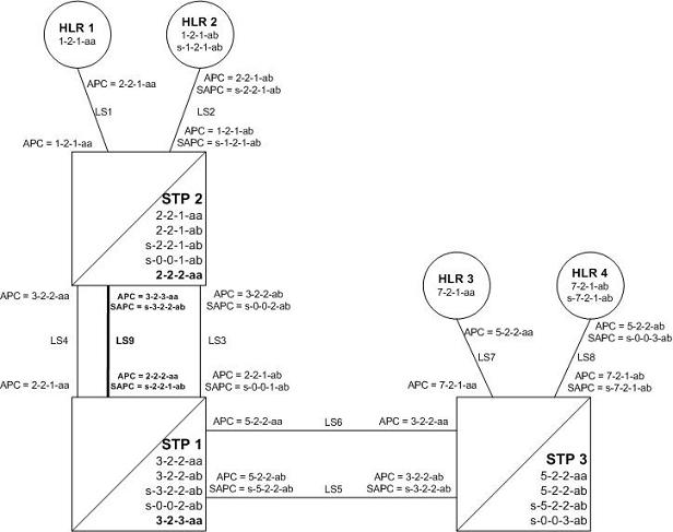

After stage one is completed for all nodes, the network continues to have the same linksets that it had before this process was started. The same messages are routed over the same linksets, except the new feature is used for routing on select adjacent nodes (STP 1 and STP 2 in this example). This is shown in Figure 2-12 when the feature is turned on for STP 1 and STP 2. Items in bold are added during this stage.
- Turn on MSU processing on STP 1 by turning on the ITU National and International Spare Point Code Support feature. Perform the Activating the ITU National and International Spare Point Code Support Feature procedure on STP 1 to turn the spare point code feature on.
At this point, messages arriving at STP 1 with the DPC 1-2-1-aa that contain the national spare network indicator value 3 ( NI=11binary) are routed using linkset LS3 with the new route provisioned in step 6 of Stage One of this procedure (point code s-1-2-1-ab on LS3 at STP 1).
Messages arriving with DPC 1-2-1-ab that contain the national network indicator value 2 ( NI=10binary) will continue to be routed using linkset LS4.
Since the ITU National and International Spare Point Code Support feature has not been turned on for STP 2 and STP 3, these nodes continue to route traffic according to the Duplicate Point Code feature rules.
- Turn on MSU processing on STP 2 by turning on the ITU National and International Spare Point Code Support feature. Perform the Activating the ITU National and International Spare Point Code Support Feature procedure on STP 2 to turn the spare point code feature on.
At this point, messages arriving at STP 2 with DPC 7-2-1-ab that contain the national spare network indicator value 3 ( NI=11binary) are routed using linkset LS5 with the new route provisioned in step 6 of Stage One of this procedure (point code s-7-2-1-ab on LS5 at STP 2).
Messages arriving with DPC 7-2-1-aa that contain the national network indicator value 2 ( NI=10binary) will continue to be routed using linkset LS6.
- Set the
nisparameter value for linkset LS3 tooffby performing Changing an SS7 Linkset . - Create secondary ITU-National point code 2-2-2-aa on STP 2 and secondary ITU-National point code 3-2-3-aa on STP 1 by performing the Adding a Secondary Point Code procedure on STP 1 and STP 2.
- Create a third linkset, LS9, that contains high-speed signaling links with these APC and SAPC values:
- The APC for linkset LS9 on STP 2 is 3-2-3-aa
- The APC for linkset LS9 on STP 1 is 2-2-2-aa
- The SAPC for linkset LS9 on STP 2 is s-3-2-2-ab
- The SAPC for linkset LS9 on STP 1 is s-2-2-1-ab.
- Adding an SS7 Linkset
- "Configuring an IPGWx Linkset" in Database Administration - IP7 User's Guide.
- "Adding an IPSG M2PA Linkset" in Database Administration - IP7 User's Guide.
- "Adding an IPSG M3UA Linkset" in Database Administration - IP7 User's Guide.
- Provision linkset LS9 to use high-speed signaling links by performing one of these procedures as requried:
- Adding an ATM High-Speed Signaling Link
- "Adding an IPLIMx Signaling Link" procedure in Database Administration - IP7 User's Guide
- "Adding an IPGWx Signaling Link procedure in Database Administration - IP7 User's Guide
- "Adding an IPSG M2PA Signaling Link" in Database Administration - IP7 User's Guide.
- "Adding an IPSG M3UA Signaling Link" in Database Administration - IP7 User's Guide.
- Change the routes on STP 1 to s-1-2-1-ab and 1-2-1-aa so that all National and National Spare traffic uses linkset LS9 by performing the Changing a Route procedure. At this point, incoming National Spare traffic to STP 1 still uses linkset LS3, and incoming National Spare traffic to STP 1 still uses linkset LS4 until the routes on STP 2 are changed so that all National and National Spare traffic uses linkset LS9.
- Provision routes on the adjacent nodes to include the new true and secondary point codes that were added to STP 1 and STP 2. Perform one of these procedures as required.
All traffic (National and National Spare) should now be flowing on linkset LS9.
Figure 2-12 Stage Two - All Traffic Merged onto a Third Linkset
In Figure 2-12, all traffic between STP 1 and STP 2 is routed over linkset LS9, using the national spare network indicator value 3 ( NI=11binary) and the national network indicator value 2 ( NI=10binary) to select the route. Note that linkset LS3 and linkset LS4 are not being used.

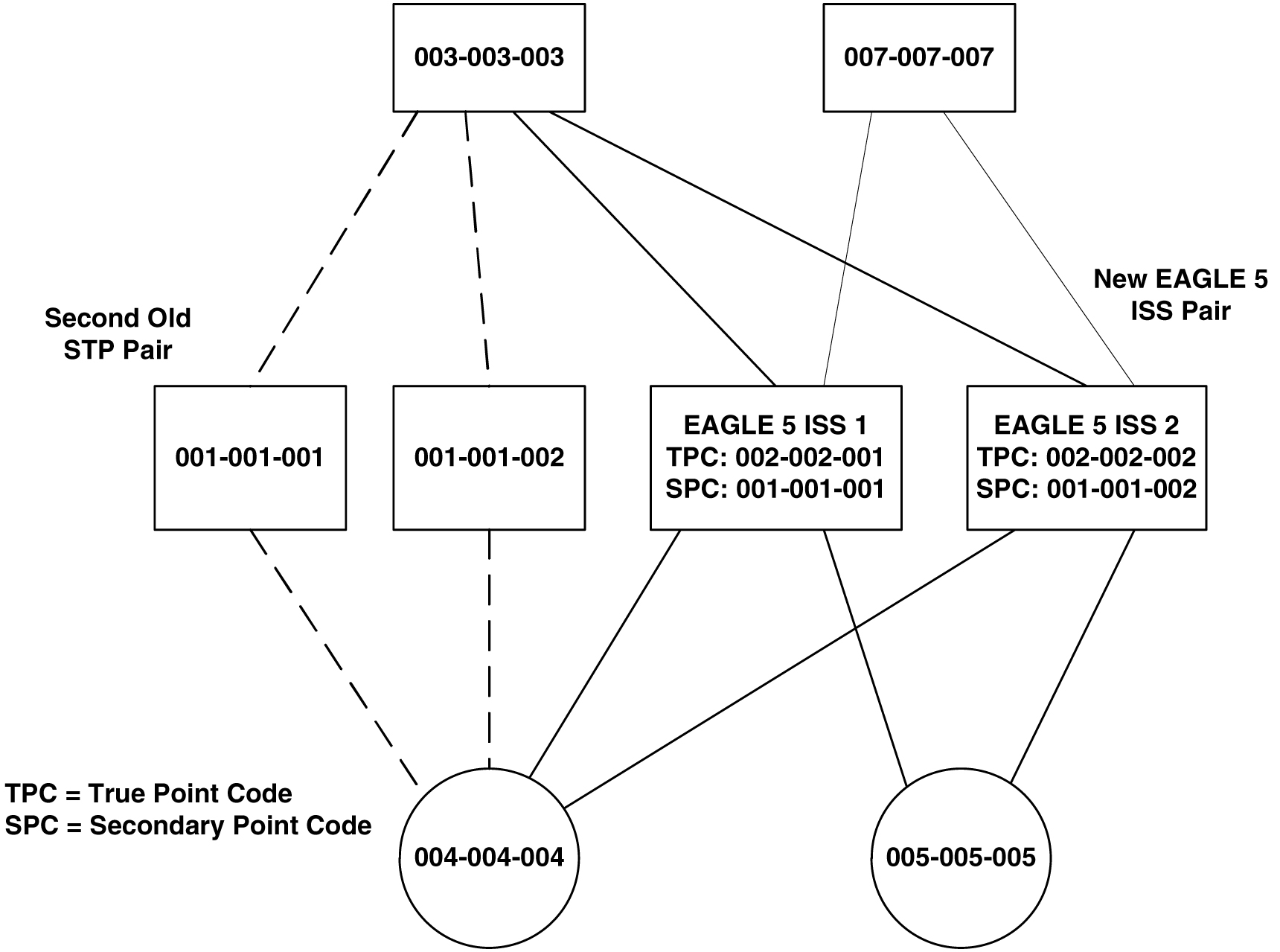

Replacing Two STP Pairs with One Pair
The following example shows how an EAGLE pair can replace two existing STP pairs. In this example, each EAGLE in the pair uses one true point code and one secondary point code.
As shown in Figure 2-14, a new EAGLE first replaces one existing STP pair. In this case, EAGLE's true point code is set to the true point code of the old STP. The adjacent nodes are cut over to the EAGLE pair. The adjacent nodes do not need to be reconfigured.
Figure 2-14 Replacing the First STP Pair
Next, a second STP pair is replaced with the EAGLE pair. As shown in Figure 2-15, an SSP and an STP are being “re-homed” from an old STP pair to a new EAGLE pair. In this example, the STP (003-003-003) is reconfigured with new routes to recognize that it is now connected to EAGLE 1 and EAGLE 2 instead of 001-001-001 and 001-001-002. STP 003-003-003, if not an EAGLE with Multiple Point Codes, may not be able to support more than one linkset to the same point code. See Multiple Linksets between Two Nodes section for a description of this capability. The interconnecting device (STP or SSP) can use either the TPC or SPC as the device requires.
At EAGLE 1, the user would configure the secondary point code 001-001-001, using the ent-spc command. The user would also configure a route to 001-001-002 over the C-linkset. The user would then configure point code 004-004-004 in the EAGLE's database to indicate that this point code uses the secondary point code 001-001-001, instead of the EAGLE's true point code (chg-dstn:dpc=004-004-004:spc=001-001-001. This last step would be repeated for all other adjacent SSPs and SCPs that are re-homed from the old STP Pair to the new EAGLE Pair.
Similarly, at EAGLE 2, the user would configure the secondary point code 001-001-002, and configure a route over the C-link to 001-001-001. The user would also configure point code 004-004-004 in EAGLE 2's database to indicate that this point code uses the secondary point code 001-001-002, instead of the EAGLE's true point code.
When EAGLE 1 receives a message from the SSP destined for 001-001-001, the EAGLE 5 ISS processes the message as if the message was sent to the EAGLE's true point code.
When EAGLE 1 generates a message (for example, network management, link test messages, or GTT messages) that is destined for 004-004-004, EAGLE 1 puts the OPC 001-001-001 in the message. When EAGLE 5 ISS 1 generates a message that is destined for 003-003-003 or 005-005-005, it puts the OPC 002-002-001 in the message. When EAGLE 1 generates GTT and SCMG messages that are destined for non-adjacent point codes, it includes the OPC 002-002-001 in the message.
Figure 2-15 Replacing a Second STP Pair

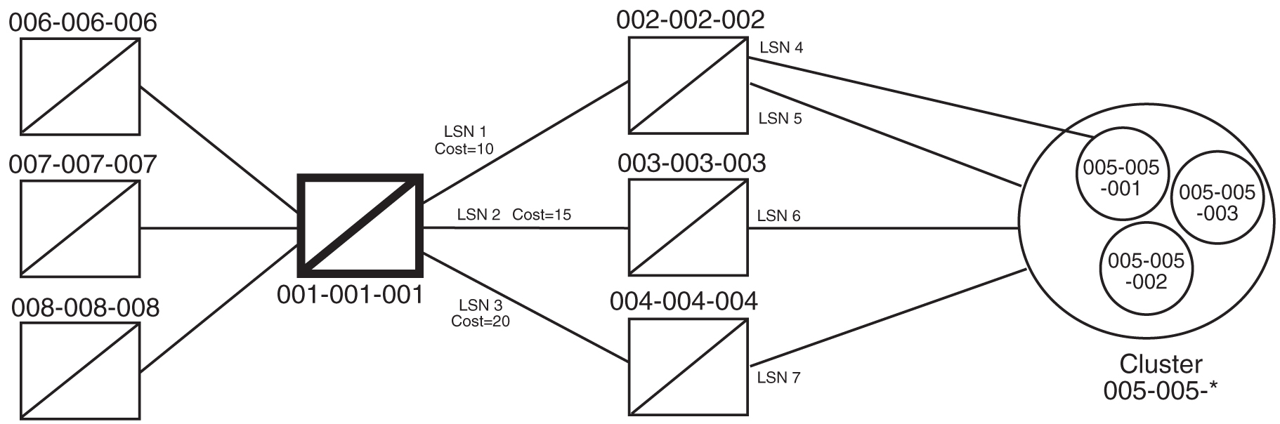

ent-ls: lsn=ls4:apc=4-1-6
ent-rte:dpc=4-1-0:lsn=ls1:rc=10
ent-rte:dpc=4-1-1:lsn=ls2:rc=10
ent-rte:dpc=4-1-5:lsn=ls3:rc=10
ent-rte:dpc=4-1-6:lsn=ls4:rc=10
ent-rte:dpc=5-5-1:lsn=ls1:rc=10
ent-rte:dpc=5-5-1:lsn=ls3:rc=10
ent-rte:dpc=5-5-5:lsn=ls2:rc=10
ent-rte:dpc=5-5-5:lsn=ls4:rc=10

Cluster Routing and Management Diversity Example
This section shows an example of the Cluster Routing and Management Diversity feature, and lists the network events affecting the EAGLE. This example is based on Figure 2-22 and Table 2-7.
Figure 2-22 Cluster Management
Table 2-7 Example Cluster Routing Information
| Route Table for Destination 005-005-001 | Route Table for Cluster 005-005-* | |
1 |
LSN 1, Cost=10 |
LSN 1, Cost=10 |
2 |
LSN 2, Cost=15 |
LSN 2, Cost=15 |
3 |
LSN 3, Cost=20 |
LSN 3, Cost=20 |
When the normal routes, linksets LSN 1 and LSN 2, become available, the EAGLE sends a preventive TFP for destination 005-005-001 and a preventive TCP for cluster 005-005-* to node 002-002-002, and starts routing messages to destination 005-005-001 and cluster 005-005-* using linkset LSN 1. The EAGLE broadcasts TFAs about destination 005-005-001 and TCAs about cluster 005-005-* to all other adjacent nodes.
- When linkset LSN 4 fails, node 002-002-002 sends a TFP for destination 005-005-001 to the EAGLE. Linkset LSN 4 is prohibited from carrying traffic from the EAGLE to destination 005-005-001. The EAGLE stops using linkset LSN 1 to send traffic to destination 005-005-001, performs forced rerouting, starts level 3 timer T11 for destination 005-005-001, and starts using linkset LSN 2 to send messages to destination 005-005-001. The EAGLE generates preventive TFPs about destination 005-005-001 to node 002-002-003. The preventive TCP for cluster 005-005-* sent to node 002-002-002 remains in effect.
When the level 3 timer T11 for destination 005-005-001 expires, TFRs are broadcast for destination 005-005-001 to nodes 004-004-004, 006-006-006, 007-007-007, and 008-008-008. Destination 005-005-001 is restricted.
- When linkset LSN 5 fails, node 002-002-002 sends a TCP for cluster 005-005-* to the EAGLE. Linkset LSN 5 is prohibited from carrying traffic from the EAGLE to cluster 005-005-*. The EAGLE stops using linkset LSN 1 to send traffic to cluster 005-005-*, performs forced rerouting, starts the level 3 timer T11 for cluster 005-005-*, and starts using linkset LSN 2 to send messages to cluster 005-005-*. The EAGLE sends preventive TCPs for cluster 005-005-* on linkset LSN 2. The EAGLE sends a TCR for cluster 005-005-* on linkset LSN 1, to allow cluster 005-005-* and destination 005-005-001 to send messages back to the EAGLE on linkset LSN 1. When the level 3 timer T11 for cluster 005-005-* expires, the EAGLE sends a TCR for cluster 005-005-* to nodes 004-004-004, 006-006-006, 007-007-007, and 008-008-008. Cluster 005-005-* is restricted.
- When linkset LSN 6 fails, node 003-003-003 sends a TCP for cluster 005-005-* to the EAGLE. The EAGLE performs forced rerouting, sends a preventive TFP for destination 005-005-001 and a TCP for destination 005-005-001 to node 004-004-004, and starts using linkset LSN 3 for sending messages to destination 005-005-001 and cluster 005-005-*.
- When linkset LSN 7 fails, node 004-004-004 sends a TCP for cluster 005-005-* to EAGLE. The EAGLE cannot send traffic to either destination 005-005-001 or cluster 005-005-*. The EAGLE broadcasts TCPs for cluster 005-005-* to nodes 002-002-002, 003-003-003, 004-004-004, 006-006-006, 007-007-007, and 008-008-008. Cluster 005-005-* and destination 005-005-001 are inaccessible.
- When linkset LSN 7 recovers, node 004-004-004 sends a TCA for cluster 005-005-* to the EAGLE. The EAGLE sends a preventive TCP for cluster 005-005-* to node 004-004-004, and starts using linkset LSN 3 to send traffic to cluster 005-005-*. The EAGLE sends a TCR for cluster 005-005-* to node 002-002-002. This allows cluster 005-005-* to send messages back to the EAGLE on linkset LSN 3. The EAGLE sends a preventive TCP for cluster 005-005-* to nodes 003-003-003 and 004-004-004. The EAGLE sends a TCR for cluster 005-005-* to nodes 006-006-006, 007-007-007, and 008-008-008. The EAGLE enables response method for destination 005-005-001, and starts a routeset test for destination 005-005-001 on linkset LSN 3. Cluster 005-005-* is restricted.
- When linkset LSN 6 recovers, node 003-003-003 sends a TCA for cluster 005-005-* to the EAGLE. The EAGLE performs controlled rerouting on cluster 005-005-*, sends a preventive TCP for cluster 005-005-* to node 003-003-003, and starts using linkset LSN 2 to send traffic to cluster 005-005-*. The EAGLE sends a TCR for cluster 005-005-* to node 004-004-004. The EAGLE starts a routeset test for destination 005-005-001 on linkset LSN 2.
- When linkset LSN 5 recovers, node 002-002-002 sends a TCA for cluster 005-005-* to the EAGLE. The EAGLE performs controlled rerouting, and starts using linkset LSN 1 to send traffic to cluster 005-005-*. The EAGLE sends a preventive TCP for cluster 005-005-* to node 002-002-002. The EAGLE broadcasts a TCA for cluster 005-005-* to nodes 003-003-003, 004-004-004, 006-006-006, 007-007-007, and 008-008-008. The EAGLE enables response method for destination 005-005-001, and starts a routeset test for destination 005-005-001 on linkset LSN 1. Cluster 005-005-* is allowed.
- In response to the routeset test, node 004-004-004 sends a TFA for destination 005-005-001 to the EAGLE. The EAGLE performs controlled rerouting, and starts using linkset LSN 3 to send traffic to destination 005-005-001. The EAGLE sends a preventive TFP for destination 005-005-001 to nodes 003-003-003 and 004-004-004. The EAGLE sends a TFR for destination 005-005-001 to node 002-002-002 that allows destination 005-005-001 to send messages back to the EAGLE on linkset LSN 1. The EAGLE broadcasts a TFR for destination 005-005-001 to nodes 006-006-006, 007-007-007, and 008-008-008. Destination 005-005-001 is restricted.
- In response to the routeset test, node 003-003-003 sends a TFA for destination 005-005-001 to the EAGLE. The EAGLE performs controlled rerouting and starts using linkset LSN 2 to send traffic to destination 005-005-001. The EAGLE sends a preventive TFP for destination 005-005-001 to node 003-003-003. The EAGLE sends a TFR for destination 005-005-001 to node 004-004-004.
- In response to the routeset test, node 002-002-002 sends a TFA for destination 005-005-001 to the EAGLE. The EAGLE performs controlled rerouting, and starts using linkset LSN 1 to send traffic to destination 005-005-001. The EAGLE sends a preventive TFP for destination 005-005-001 to node 002-002-002. The EAGLE sends a TFA for destination 005-005-001 to nodes 003-003-003, 004-004-004, 006-006-006, 007-007-007, and 008-008-008. Destination 005-005-001 is allowed.
