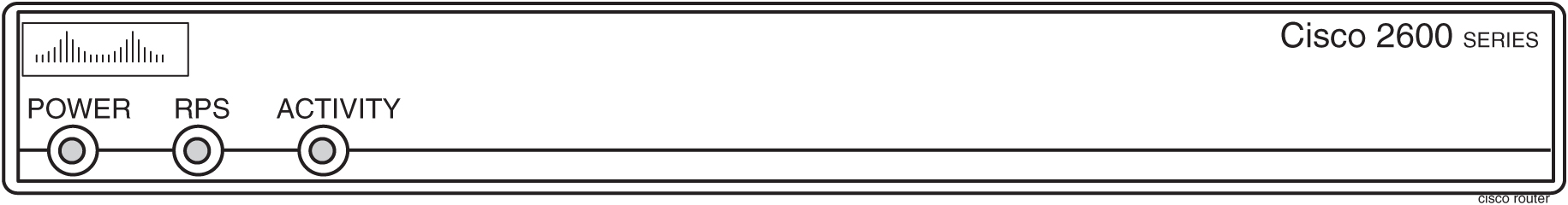

The isolation routers provide 10/100Mbps communications between the customer LAN or dedicated network and the IP7 Front End, hubs, and host servers. Figure 4-1 shows the front view of the routers and Table 4-1 describes the LED indicator functions on the front of the router.
Figure 4-1 Front View Routers
img/c_oem_based_networking_elements_hws-fig3.jpg
Table 4-1 Router Front LEDs
LED Description
PWR
Indicates when power is present to the router and the power switch is in the ON position.
RPS
(Always OFF)
Off when the redundant power supply is not present.
On redundant power supply is present and functional.
Activity
Off-No network activity
Blink-Network activity

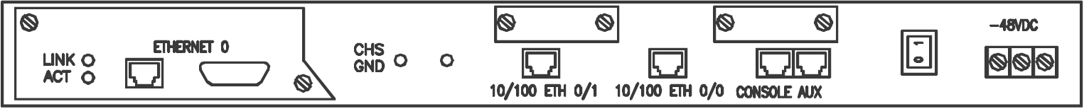

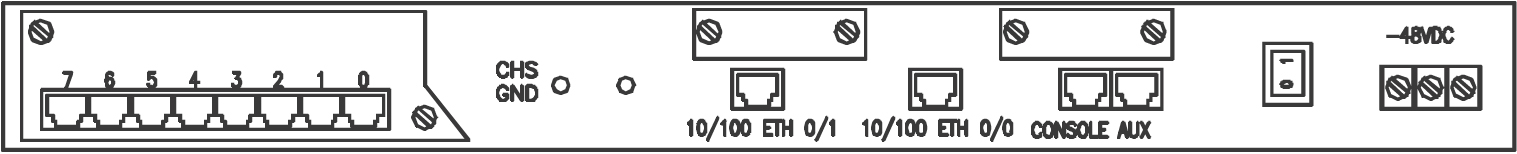

Figure 4-2 and Figure 4-3 show rear views of the Isolation and Dial-In routers. Link (LNK) and activity (ACT) LEDs are located near each ethernet port at the rear of the routers. Table 4-2 describes the LED indicators on the rear of the routers.
Figure 4-2 Rear View Isolation Router
img/c_oem_based_networking_elements_hws-fig4.jpg
Figure 4-3 Rear View Dial-in Router
img/c_oem_based_networking_elements_hws-fig5.jpg
Table 4-2 Router Rear LEDs
LED Description
LNK
Indicates link is established to far end connection.
ACT
Blink-indicates data activity on the link.

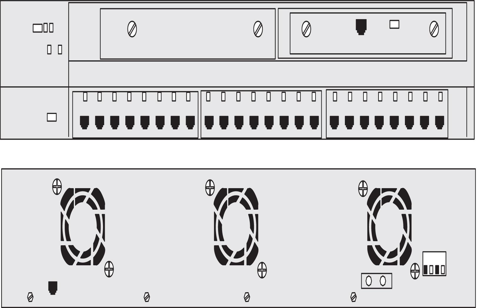

The following section provides an overview of the Ethernet LAN switches used in some OEM products. The ethernet switches cross-connect the components in the frames functioning as an internal Local Area Network (LAN). The switches support 24 auto-sensing 10/100Mbps ports each.
Figure 4-4 illustrates the front and rear of the Ethernet switch.
Figure 4-4 Ethernet Switch
img/r_ethernet_switches_1_hws-fig1.jpg
Table 4-3 describes the LEDs located on the front of the switches.
Table 4-3 Ethernet Switch LEDs
LED Description
System
Green-Indicates when power is present to the switch and the power switch is in the ON position.
Amber-Indicates power is present but system is not functioning properly
1 and 2
Indicates expansion boards WS-X2932-XL are installed and functioningLED 1 (Left board)LED 2 (Right board)
RPS
(Always OFF)
Redudant power supply is not configured
Pressing theMODE switch on the front of the WS-C2924-XL-EN changes the per-portLED indications to the following.
STAT (port status) Default
Off-No link.
Solid green-Link present.
Flashing green-Activity. Port is transmitting or receiving data.
Alternating green/amber-Link fault. Error frames can affect connectivity, and errors such as excessive collisions,CRC errors, and alignment and jabber errors are monitored for a link-fault indication.
Solid amber-Port is not forwarding. Port was disabled by management or an address violation or was blocked by Spanning Tree Protocol (STP).
After a port is reconfigured, the portLED can remain amber for up to 30 seconds asSTP checks the switch for possible loops.
UTL (utilization)
Green-The LEDs display backplane utilization on a logarithmic scuffle all port LEDs are green, the switch is using 50 percent or more of its total bandwidth capacity. If the right-mostLED is amber, the switch is using less than 50 percent of its total bandwidth. If theLED to the left of the right-mostLED is amber, the switch is using less than 25 percent of its total capacity, and so on.
FDUP
(port full-duplex)
Off-Port is operating in half duplex.
Green-Port is operating in full duplex.
100 (port speed)
Off-Port is operating at 10 Mbps.
Green-Port is operating at 100 Mbps.

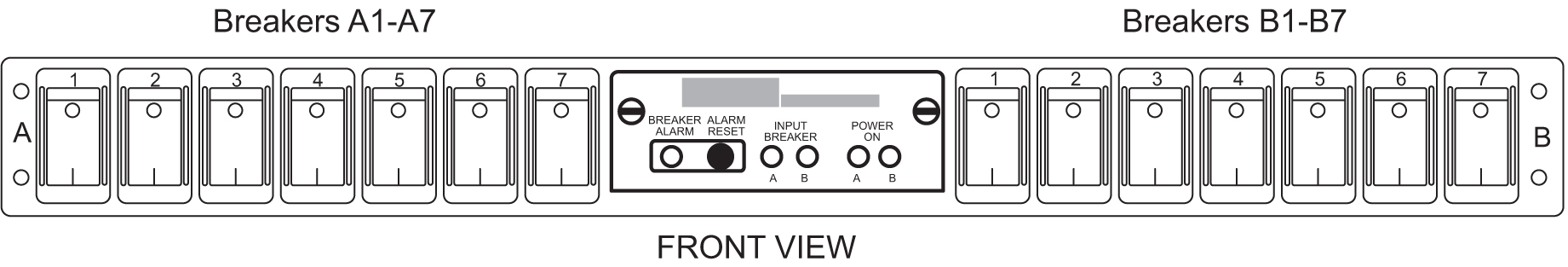

Figure 4-5 shows the details of the front view of the breaker panel
Figure 4-5 Telect Breaker Panel Front View
img/r_breaker_panels_1_hws-fig1.jpg

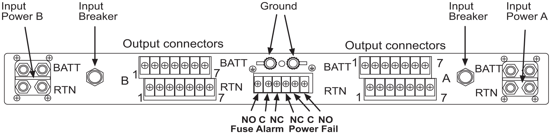

Figure 4-6 shows the rear details of the breaker panel.
Figure 4-6 Telect Breaker Panel Rear View
img/r_breaker_panels_1_hws-fig2.jpg

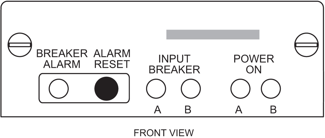

Figure 4-7 provides details of the alarm panel on the Telect Breaker Panel.
Figure 4-7 Telect Breaker Panel Alarms
img/r_breaker_panels_1_hws-fig3.jpg
Table 4-4 lists the status LEDs on the Telect Breaker Panel.
Table 4-4 Breaker Panel LEDs
LED Color Description
Power On A
Green
Lights whenever Side A is receiving input power (LED will remain lit even if the input breaker has tripped)
Power On B
Green
Lights whenever Side B is receiving input power (LED will remain lit even if the input breaker has tripped)
Breaker
Alarm
Red
Lights whenever an output circuit breaker has tripped or turned off
Input Breaker A/B
Green
Lights whenever Side A/B is receiving input power (Not lit if input breaker is tripped)
If all breakers are not turned on, the alarm LED will light. To turn off the alarm LED, press RESET and the alarm LED will reset and turn off.
