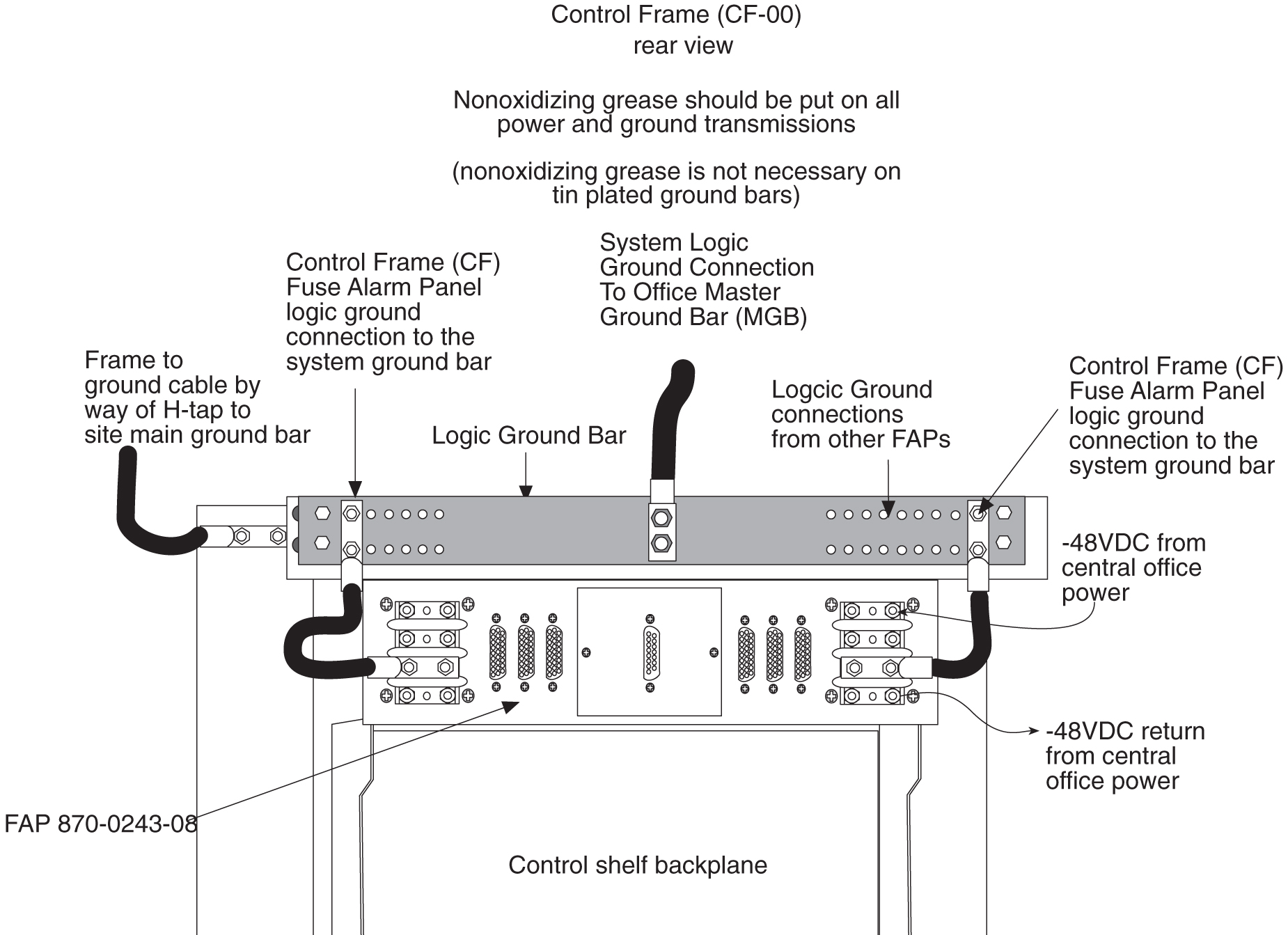

Non-oxidizing grease will be applied to all lugs terminated on a copper system ground bar. Refer to Figure 5-1.
The power return grounding path is the return path for all –48VDC loads in the system. This path is isolated from other system grounds and connects to the rest of the central office through the –48VDC return connections located on the Fuse and Alarm Panel (FAP) of each frame.
The frame/chassis ground path provides a low impedance connection for all metal parts of the entire system, including the frame, doors, card cages, and end panels. Each frame/chassis connection within the system lineup terminates to the frame and connects to the main ground bar by way of Htaps, #6 American Wire Gauge (AWG) to 1/0 cable.
The logic ground path provides a common voltage reference point between all circuit boards of an system. Each connection terminates to the system ground bar on the control frame.
The frame/chassis and logic ground paths are both noncurrent carrying paths.

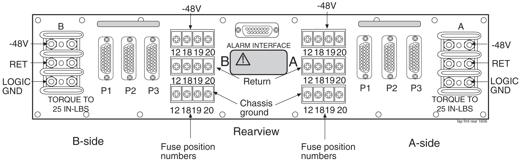

warning:
The power (-48 VDC) and return connections of FAP (P/N 870-0243-08) and (P/N 870-1606-xx) are physically reversed at the input terminal. See Figure 5-1 and Figure 5-2 for wiring information.
Figure 5-1 Logic Grounding with FAP (P/N 870-0243-08)
img/r_grounding_hws-fig1.jpg
Figure 5-2 Logic Grounding with FAP (P/N 870-1606-xx/870-2320-xx)
img/r_grounding_hws-fig2.jpg

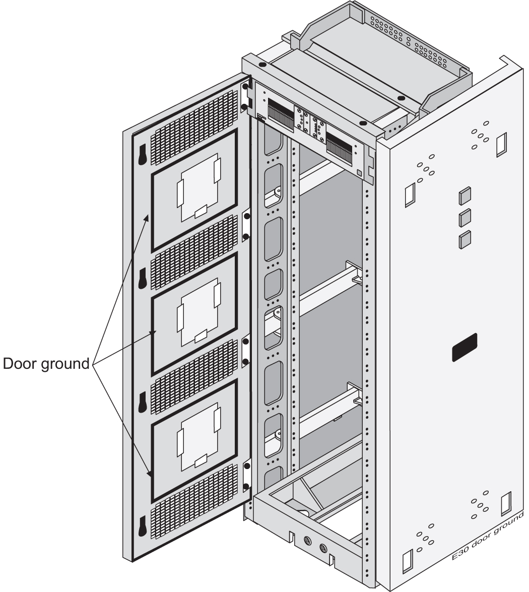

The doors installed are grounded to the frame through a double lug ground wire (see Figure 5-3) and through a screw-down latch.
Figure 5-3 Door Grounding
img/r_grounding_hws-fig3.jpg
