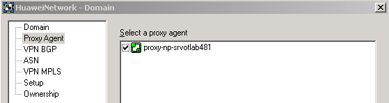

Review the Domain dialog box. On the Proxy Agent property page, identify the proxy-np-host_name object, where host_name is the name of the host.
Verify that the Network Processor is installed on that host.
When it appears in the Proxy Agent dialog box, the Network Processor is confirmed as a registered component in the IP Service Activator object model.
Verify that the following check box is selected.
proxy-np-proxy_agentwhere proxy_agent is the name of the proxy agent.
If not, select the check box, as shown in the following image.
When the check box is selected, it confirms the Network Processor assignment as a Proxy Agent for that domain.

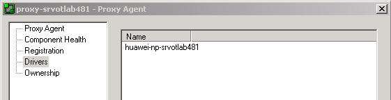

Right-click the Network Processor and select Properties.
The Proxy Agent dialog box for the Network Processor opens. On the Drivers property page, note that the cartridge is listed on the right (for example, huawei-np-srvotlab481).

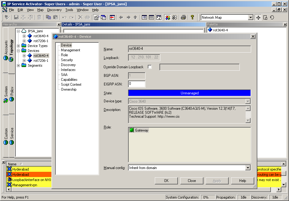

On the Topology tab, double-click the network cloud to see the discovered device.
Each discovered device is listed under the network cloud. The device also appears in the Details pane, on the Network_Name tab.
Right-click the device and select Properties.
The Device dialog box appears.
The Device property page lists the type and a description of the discovered device.

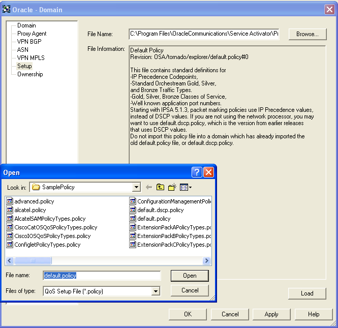

To load configuration policies into IP Service Activator:
On the Global Setup window, select a domain from the Hierarchy pane.
Right-click on the Domain and from the pop-up menu, select Properties.
On the Domain dialog box, select the Setup property page.
Click Browse.
Select the .policy file you want to load, and click Open.
Click Load.
The configuration policy loads and a confirmation dialog is displayed.
