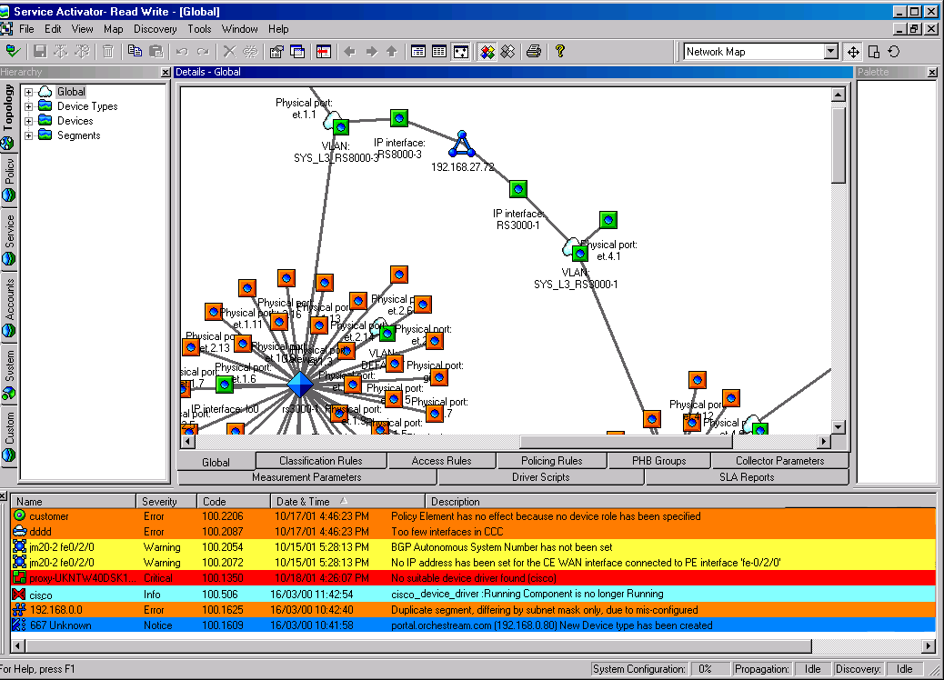

Best practice: Check the current faults pane, as shown in Figure 6-1, after committing each transaction and correct errors that are reported.
Figure 6-1 IP Service Activator GUI: Current Faults Pane
Description of "Figure 6-1 IP Service Activator GUI: Current Faults Pane"
The pane displays information, warning, and error messages. Most of these messages result from network discovery or data validation.
Table 6-4 describes how the background color of a message indicates its type:
Table 6-4 Recognizing Error Message Types
| Color | Description |
Red |
Critical faults requiring intervention: failure of an IP Service Activator component or a serious problem with a device. |
Orange |
Errors: serious faults in the policy system, but not in a system component. |
Yellow |
Warnings, such as validation errors. |
Blue |
Notices: some user action is required. |
Cyan |
Information only: no user action required. |

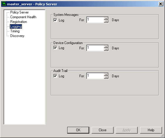

To set up or change the settings for all system logs:
On the System tab, select the Master Server object.
Select Properties from the pop-up menu.
Select the Logging property page.
For each log (System Messages, Device Configuration, and Audit Trail), select the Log check box to specify that relevant events are logged. Specify the number of days (in the range 1 to 28) for items to remain in the log before being discarded.
Click OK.
To set up or change the settings for a specific system log:
On the System tab under the System Logs folder, select the object whose log details you want to set.
Select the Log check box to specify that relevant events are logged. Specify the number of days (in the range 1 to 28) for items to remain in the log before being discarded.
Click OK.

Messages are color-coded.
Faults are color-coded according to severity:
Critical faults appear on a red background.
Errors appear on an orange background.
Warnings appear on a yellow background.
Notices appear on a blue background.
Info messages appear on a cyan background
Clears appear on a green background.
Messages appear on a white background.

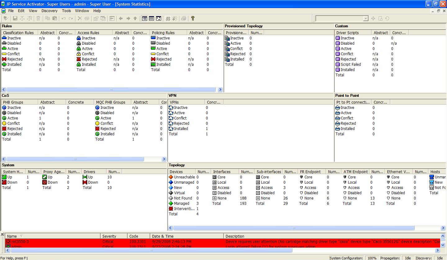

Viewing the Current Status of IP Service Activator
IP Service Activator provides the following status views:
The statistics summary pane summarizes the status of PHB groups, policy rules, CCCs, and VPNs and can be displayed as a dockable toolbar in any window.
The system statistics window provides a single-screen status summary: system components, policy rules, PHB groups, VPNs and CCCs, and network devices.
To view the statistics summary pane:
From the View menu, select Statistics Summary.
For PHB groups, policy rules, VPNs, CCCs and driver scripts the pane displays the number of each object with the following status:
Inactive: Object has been created but has not been propagated to the network processors.
Disabled: Object has been disabled.
Active: Object has been propagated to the network processors.
Conflict: Object conflicts with an existing object or has failed validation.
Rejected: One or more of the objects failed to install.
Failed: Network processor experienced a failure.
Installed: Object that has been installed on the designated device.
Mismatched: Configuration in IP Service Activator for this concrete does not match the configuration on the designated device.
Uninstalled: Object has been uninstalled. This can mean that the object is not currently active on the device (for example, because the date and time limitations do not apply at present) or the object has been deleted or disabled by a user.
UninstallFailed: Object remains on the device, and its concrete is disabled in the GUI. (A fault may be raised.)
To view the System Statistics window:
From the View menu, select System Statistics.
The System Statistics window is displayed in the figure below.
For current classification rules, access rules, and policing rules, the window indicates the number of abstract (parent) and concrete rules that are Inactive, Disabled, Active, Changed, Conflict, Rejected, or Installed.
For PHB groups, the screen indicates the number of abstract (parent) and concrete rules that are Inactive, Disabled, Active, Changed, Conflict, Rejected, or Installed.
For VPNs and CCCs, the screen indicates the number of concrete VPNs or CCCs that are Inactive, Active, Conflict, Rejected, or Installed
For system components (hosts, network processors, and cartridges) it indicates the number that are Up or Down.
For devices, it indicates the number that is currently in each state: Unreachable, Unmanaged, New, Not Found, Managed, or Intervention Required.
For interfaces, it indicates the number of interfaces whose role is Core, Local, Access, Disabled, or None.
The Interfaces pane shows the number of interfaces or sub-interfaces assigned to each role. If an interface has no sub-interfaces, its role assignment is added to the count. If an interface has one or more sub-interfaces, each sub-interface role is counted and the role of the parent interface is not.
For hosts, it indicates the number that are New, Unmanaged, or Not Found.
