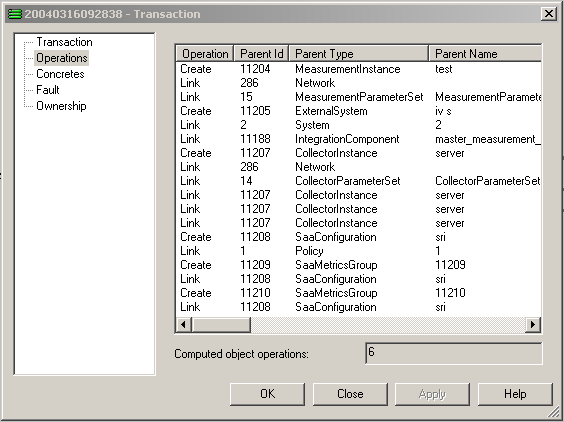

Reviewing Transactions
When a problem is encountered, it is helpful to review the transaction to identify the problem.
To review a transaction:
Click the System tab in the hierarchy pane.
Expand the Transactions folder.
Right-click on either the Committed Transactions or the Scheduled Transactions folder.
You can also right-click on the Transactions folder and perform the search at a higher level.
Select Find From Here from the pop-up menu.
The Find dialog box appears.
Enter search criteria in the Find What field and click Find.
Search results appear in the Find dialog box.
Right-click on the desired transactions and select Properties to open the transaction's dialog box.
From the transaction dialog box, you can also review all information related to the transaction.
You can also search for transactions from the Tools menu. Select Find to open the Find dialog box.

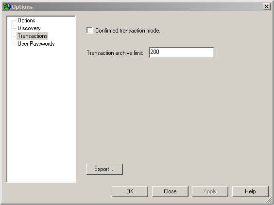

Exporting Transactions
If you want to send information on the transaction to Oracle GCS, you can export the details of the transaction to a text file.
To export all transactions:
Select Options from the Tools menu.
The Options dialog box appears.
Select the Transactions property page.
Click Export to export the transactions to a text file.
The Save As dialog appears.
Enter a filename for the text file and click Save.
To export a single transaction:
Locate the single transaction that you want to export. If needed, refer to the procedure "Reviewing Transactions".
Right-click on the transaction in the Find dialog box and select Properties from the pop-up menu to open the transaction's dialog box.
From the Transaction property page, click Export to export the transaction to a text file.

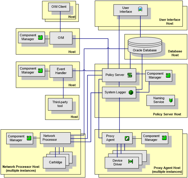

Component Distribution and Communication
In a standard deployment, components are distributed across multiple host machines. Components communicate with each other using CORBA (Common Object Request Broker Architecture) with the CORBA naming service coordinating inter-component communication.
An Oracle Database stores the system, topology and policy data generated within the system. The policy server and user interface components communicate with the database.
Figure 9-1 outlines the distribution of major components and shows the connections between them. All connections except those to the Oracle Database use CORBA.
Figure 9-1 Standard Configuration of Component Distribution and Communication
Description of "Figure 9-1 Standard Configuration of Component Distribution and Communication"
All IP Service Activator components communicate with the naming service and these connections are therefore not shown.

Users cannot execute the Shutdown All or Startup command from the user interface to shut down or start up components on the host machine
Information on component states is not reported to the system logger
System Logger
The system logger receives messages from the policy server and proxy agent and details of component status from the component manager. It stores the information that it receives in the system database.
Effects of Failure
If the system logger fails, proxy agent and policy server faults and component status details are not passed on to the database and they are silently dropped.
Policy Server
The policy server is the central component of IP Service Activator. It coordinates access to the database from the user interface components, performs network topology discovery, and validates and transmits policy configurations to the proxy agents.
The policy server maintains the current state of the system, stored in the database – operations with the database are transaction controlled to maintain consistency.
Effects of Failure
If the policy server fails while saving a transaction to the database, when it restarts it returns to the system state as it was before the most recent successful save.
By default, data that is saved by a user is queued by the policy server before being saved to the database. If there is a large number of users accessing the database, users may lose changes that appeared to be saved in the user interface. Running the user interface in confirmed transaction mode reduces the likelihood of lost data, but slows a user's progress in the user interface. In this mode, changes cannot be made in the user interface until the policy server notifies the component that a transaction's changes have been saved to the database. For more information on confirmed transaction mode, see IP Service Activator User's Guide.
If the policy server fails while propagation is in progress, on restart it re-propagates the most recent saved configuration to the proxy agents. This may take some time to complete.
If components try to contact the policy server while it is down, they continue to attempt contact until the policy server is back on line. An error message is logged by the components reporting on the loss of connectivity.
Users may enter changes via the user interface while the policy server is down but may not save or commit transactions. When connectivity is reinstated, the object model maintained by the user interface component is synchronized with that maintained by the policy server and changes may be saved to the database.
Network Processor
The network processor manages communication to and from devices through cartridges. Within the context of IP Service Activator, it performs the conversion of user changes to the configuration of IP Service Activator objects into a set of CLI commands for delivery to devices.
The network processor and cartridge architecture is extensible and scalable. Support for new services and devices can be added by creating and deploying new cartridges and cartridge components.
Within the context of Configuration Management, the network processor manages the flow of information from a configuration policy (or configlet) to a device, again by performing the conversion of configuration commands into a set of CLI commands for delivery to the device.
Effects of Failure
When the Network Processor fails, the component manager raise a fault and attempts a restart.
In-process audits, backups, restores, and repairs are not carried forward and will not resolve - you will have to re-submit them.
Service changes which were not yet in the communication phase, will be eventually pushed when the Network Processor comes back online.
If the failure occurred during a period when a device was actually being configured, the commands will be re-issued. For devices which ignore configuration commands that are re-applied, you might see faults indicating a write-failure to the device if the device reports back a warning that the configuration already existed. These can be ignored since the original commands were applied, and the re-application does not change any configuration settings on the device. On transaction-oriented devices (such as some Juniper devices) this behavior will not occur.
If there is not enough virtual memory allocated to the Network Processor, you could experience a series of failures and restarts. This can also be caused by an incorrect Network Processor configuration (e.g. missing cartridge files, message files, etc.)
If you see repeated failures, check the logs.
If you are having trouble getting the affected Network Processor to restart, consider moving your devices to another Network Processor.
Log Reader
The log reader collects logging information from multiple IP Service Activator components and stores it in a normalized format in the Oracle Database. The log schema is compliant with log4j.
Any third-party product which supports log4j can be used to interact with the logging data.
Effects of Failure
The log reader can scavenge logging information that was created while it was unavailable. As long as the individual component log files have not rolled over, there should be no loss of logging information.
User Interface
There is no component manager installed on the user interface host machine. Therefore, the user must restart the user interface if it fails. On restart, the user interface retrieves information about the object model from the policy server.
Effects of Failure
Any transactions that were not saved before the component failed are lost.
Event Handler
The event handler collects, filters and delivers details of faults and other events occurring anywhere in the network managed by IP Service Activator and can notify external systems of these events. The events could be, for example, a new device has been discovered, a site has been put into a VPN, or the ability to provision a device has been lost.
The event handler can be configured to output information to a file, through SNMP traps, or through the CORBA API.
The event handler processes each active event collector and checks the events that have occurred within the collector's scope against those that have already been forwarded to the relevant third-party systems. Any outstanding events are sent to the third-party systems.
Effects of Failure
If the component fails, on restart it retrieves the EOM and details of subscribed events. This information is stored in the database or the SubscribedEvents.log file in the WorkingData directory, depending on whether a direct connection has been set up between the event handler and the database.
Events which occur while the event handler is down will not have their associated notifications sent to the third-party, external systems, nor will these messages be sent once the event handler is available again. This could have different implications depending on the external system and the type of event.
OSS Integration Manager (OIM)
The OIM provides an API to Operational Support Systems (OSSs), enabling IP Service Activator to be integrated with third-party software, such as billing, monitoring and fault management systems. The OIM enables automated or programmatic control of IP Service Activator's service provisioning facility.
If the OIM fails, the component manager automatically attempts to restart the component:
If the policy server is running (and it is the correct version), the OIM starts and connects to the policy server.
If the policy server is not running, the OIM attempts to connect to the policy server every five seconds.
If an incorrect version of the policy server is running, the OIM fails to start and does not make any further attempt to connect to the policy server. However, the component manager continues to restart the OIM and only stops its automatic restart of the component if the OIM fails three times.
Effects of Failure
If the OIM fails, the Command Line Interface (CLI) gives no immediate indication of the failure. However, when the next command is entered, the CLI recognizes that the OIM session that it was connected to is no longer available. The CLI attempts to reconnect three times. On reconnection, the OIM prompts for the user name and password. If the CLI fails to reconnect after three attempts, the CLI closes.
Any scripts that are running when the OIM fails will stop.
CTM Server Component
The CTM Server acts as a back-end repository for Configuration Templates for CTM clients.
When the CTM Server is unavailable, CTM clients cannot perform CTM work.
Any instantiations of templates that are already in the IP Service Activator system are still processed and their commands pushed onto the target devices.
There is a provision in the Configuration GUI to manually set the CTM server port.
Tacc Module Server Component
The TACC module server component acts as a centralized collector for all TACC requests and responses. Whenever a network-touching component crosses a threshold, it sends a confirmation request to the TACC module server.
The TACC server will then relate information to all TACC clients that have subscribed to the server. Approval or denial of the request are passed from the client back to the server and then back to the originator to accept or deny the action.
Effect of Failure
No TACC services (such as subscriptions) are available while the server is not running. The TACC clients will raise errors.
Network processors cannot contact the TACC server and revert to thresholding functionality instead of using TACC functionality, and immediately fail the transaction in progress at the time of the TACC server failure.
Hardware Failure
In most cases, there are multiple IP Service Activator components on a host machine. The exception is the user interface host, where only the user interface component is installed. A hardware failure therefore generally causes a number of components to fail simultaneously. This raises the issue of component startup order.
About the Component Manager and the Restart of Managed Components
On all hosts, if set to start automatically upon system start, the component manager restarts when the host is restarted. The component manager will also restart any managed components on the host on which it resides.
If the component manager is not set to start automatically upon system start, it will have to be manually restarted. It will then restart its managed components.
Policy Server Host
The naming service and component manager restart automatically if run as services. Otherwise they must be started manually. The component manager subsequently restarts the policy server and system logger.
User Interface Host
The user interface component is the only IP Service Activator component running on the host machine. Therefore, if the host fails there are no component startup order issues to be considered. The user interface component's behavior is described in "User Interface".
