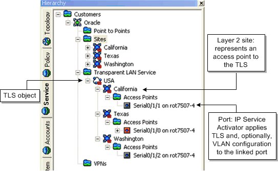

A TLS is represented by a TLS object in the client, and the edge points of the TLS are represented by layer 2 site objects. Each layer 2 site is linked to one or more ports that indicate where IP Service Activator will apply TLS configuration.
Figure 7-2 illustrates how a TLS is represented in the Hierarchy pane.
IP Service Activator represents a layer 2 port as an interface object in the client. In the descriptions that follow, the term ‘interface' is used when referring to TLS setup through the client.
IP Service Activator applies the concept of port and “port and VLAN"-based entry criteria both to the TLS object and the layer 2 sites that are linked to it:
A port-based TLS consists of a number of port-based layer 2 sites.
A “port and VLAN"-based TLS consists of a number of “port and VLAN"-based layer 2 sites.

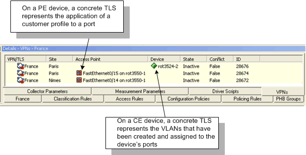

You can view concrete TLSs for:
A port on a PE device represents the application of a TLS service to a specific port
A TLS represents the points in the network at which TLS configuration has been applied
In the Details pane, select the VPNs tab to view details of the TLS configuration that applies to the port on PE devices.
