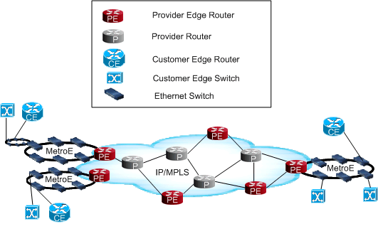

Figure 6-1 illustrates the configuration of VLAN in a Metro Ethernet network.
Figure 6-1 VLAN Configuration in Metro Ethernet Network
Description of "Figure 6-1 VLAN Configuration in Metro Ethernet Network"
Depending on physical distance, a Metro Ethernet network may be small or large. A small Metro Ethernet network can be a single switch (or two for redundancy if placed in parallel), each connected to their own PE interface on a PE router.
Metro Ethernet network can have 30, 40, 50, or more switches in it depending on the number of customers. Where multiple customers connected to the same Metro Ethernet network, need to configure separate VLANs on the Metro Ethernet network to provide transport from the Metro Ethernet network to the IP/MPLS core.

Figure 6-1 illustrates ring topology. This topology is more efficient for provisioning and maintaining because of fewer connections than a mesh topology. The advantage is if one device fails, traffic can go through the other side of the ring.
In a large service provider scenario, a Metro Ethernet ring can connect to one or more smaller, secondary Metro Ethernet rings to further extend the geographic stretch (or reachability) to remote customers.
This topology can have a single link to a single switch for the secondary ring to reach smaller customers.

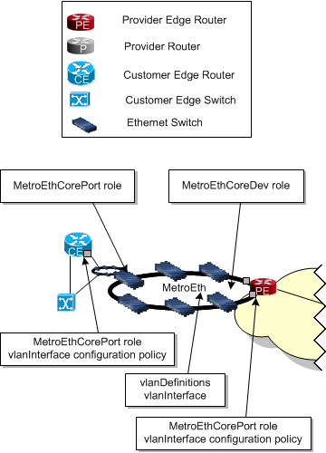

Example of VLAN Role Assignment
Consider a single Metro Ethernet ring.
Figure 6-2 illustrates the application of VLAN role and configuration policies.
Figure 6-2 Application of VLAN Role and Configuration Policies
Description of "Figure 6-2 Application of VLAN Role and Configuration Policies"
To assign VLAN roles and configuration policies as in Figure 6-2:
In the IP Service Activator client, take the devices that are in the Metro Ethernet network and group them into the same network (for example, MetroEth).
Create a custom role called MetroEthCoreDev to identify devices that are included in the MetroEth network.
For information on creating a role, see IP Service Activator User's Guide.
Apply the MetroEthCoreDev role to all devices in the MetroEth network.
Create another custom role called MetroEthCorePort to identify trunk ports.
Apply the MetroEthCorePort role to each trunk port.
Apply the vlanDefinitions configuration policy to the MetroEth network and apply the role MetroEthCoreDev.
All devices in the network will receive the VLAN configuration specified by the vlanDefinitions configuration policy.
Apply the vlanInterface configuration policy to the MetroEth network and apply the role MetroEthCorePort.
All trunk ports in the network will receive the VLAN interface configuration specified by the vlanInterface configuration policy.
The CE access port must be configured either as a trunk port or an access port as follows:
If configured as a trunk port, the MetroEthCorePort role is applied to the interface, which will cause the vlanInterface configuration policy to be applied. In this case, traffic travelling out of this port onto the Metro Ethernet network is tagged with a VLAN ID.
If configured as an access port, the port can handle traffic destined for multiple VLAN IDs. The traffic traveling out of this port onto the Metro Ethernet network is not tagged with a VLAN ID—this happens on the device in the Metro Ethernet network to which it is connected.
Configure the port on the PE which connects to the Metro Ethernet network as either an access or trunk port similar to CE access port configuration.
