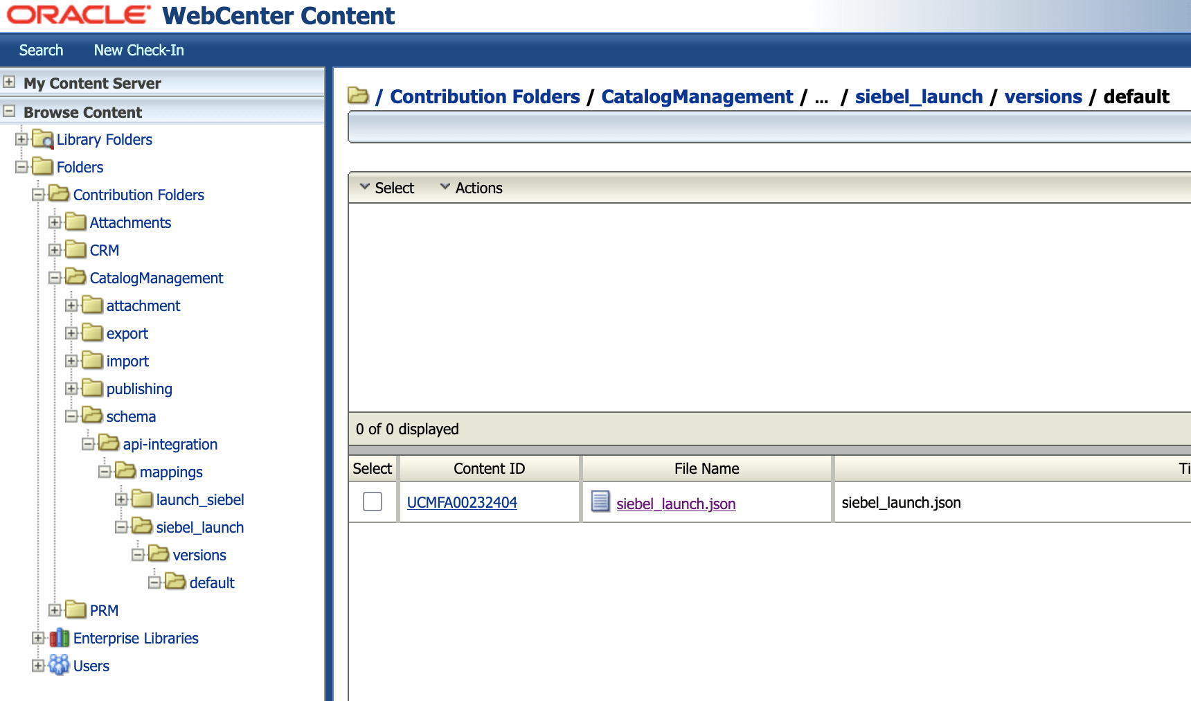

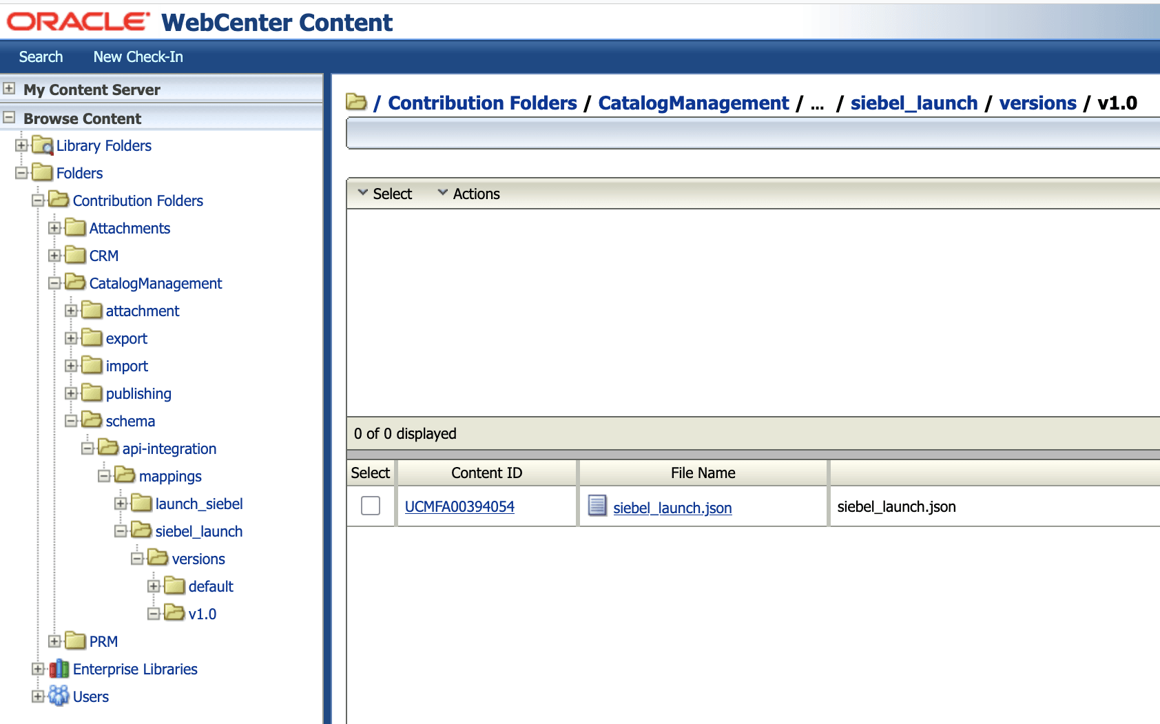

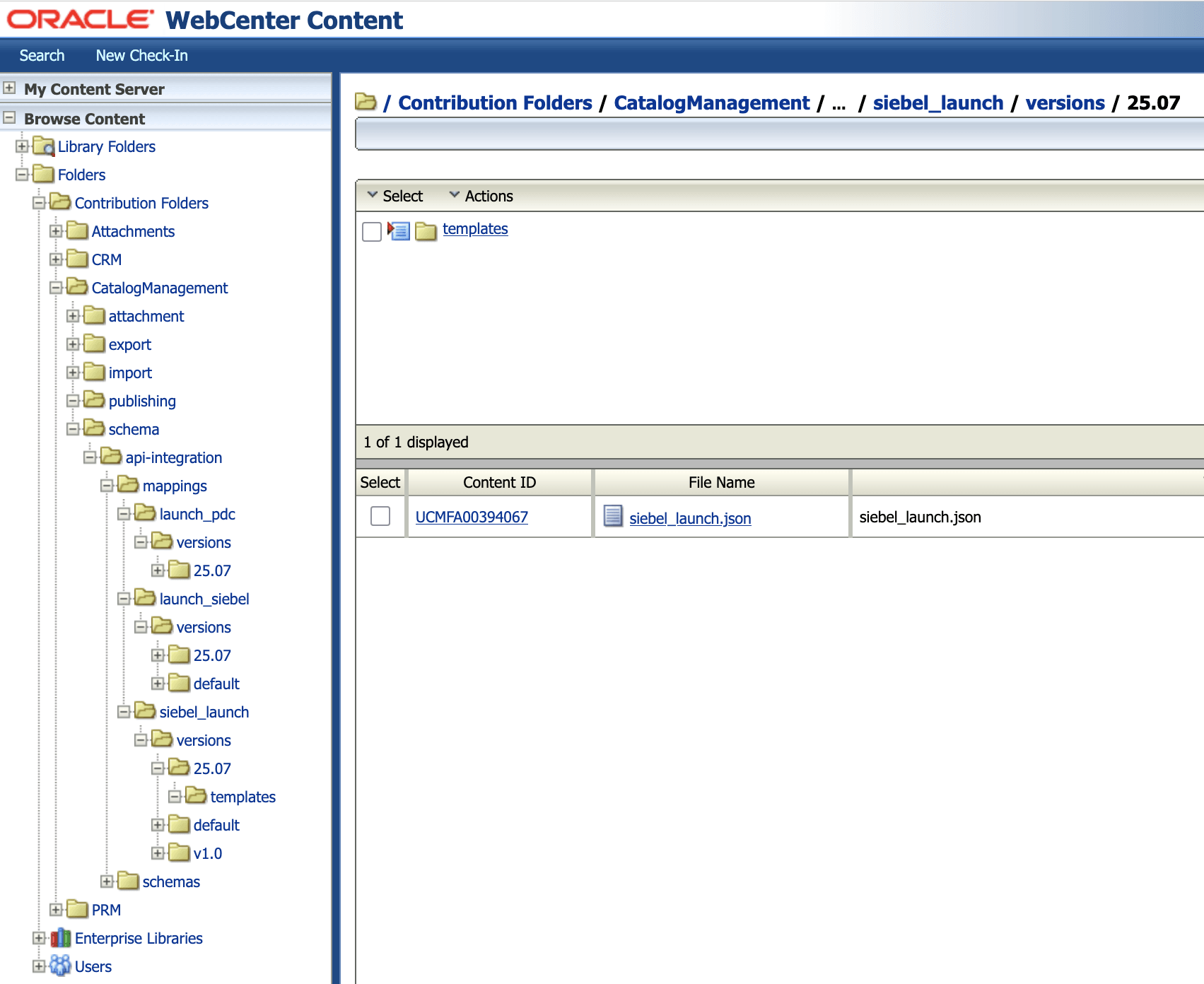

Managing Mapping File Versions
Oracle ships the three seeded grammar files:
  • One-time migration: The siebel_launch.json file that contains the mapping with source as Siebel and target as Launch.
  • Publish to Siebel: The launch_siebel.json file that contains the mapping with source as Launch and target as Siebel.
  • Publish to PDC: The launch_pdc.json file that contains the mapping with source as Launch and target as PDC.
You can retrieve the seeded mapping file using the following command:

Figure 6-1 Default Version Folder in Fusion Content Store
Let's say environment is upgraded to next available release (current + 1) with LaunchX services. In this case, Oracle would again ship the seeded mapping file corresponding to (current + 1) release and any mapping extension done in the previous release needs to be redone again on the top of the seeded file shipped by Oracle for (current + 1) release. Follow the below steps to make the changes seamlessly.
  • Get the mapping file with extension changes done in current release from Fusion "Content Store" default version folder using below endpoint.
    GET - {{FA_APIGW}}/mappingSchema/cx/industry/apiIntegration/v1/mappingSchema
    • Headers to be passed:
      • X-Source-System : <<sourceName>>
      • X-Target-System : <<targetName>>
      FA_APIGW in the endpoint is Fusion Application API Gateway.
  • Verify the response of the above GET endpoint. It should have all the mapping extension done in current release. Save the response of the above GET endpoint to a file in your local machine.
  • Create a folder with another version say v1.0 in Fusion "Content Store" having backup of the above saved mapping file with added extensions using below endpoint:
    PUT - {{FA_APIGW}}/mappingSchema/cx/industry/apiIntegration/v1/mappingSchema
      • X-Version : v1.0
    • Body to be passed:
      • File : <<file saved in earlier step to be uploaded here>>
    Figure 6-2 Version 1.0 Folder in Fusion Content Store
  • Invoke the below endpoint and create mapping files and templates shipped by Oracle for next release (current + 1) in Fusion "Content Store". The response status code for endpoint should be 200 with no response body. See Figure 6-3 for Content Store structure for changes done after the endpoint is run successfully. This endpoint creates a new folder under versions with name taken from VERSION file shipped as part of mapping service. The release version is stored in the VERSION file. For example 25.01, 25.04, 25.07, 25.10, and so on.
    Endpoint : {{FA_APIGW}}/mappingSchema/cx/industry/apiIntegration/v1/loadSeedFiles
    Method Type: GET
Figure 6-3 Version 25.07 Folder in Fusion Content Store
