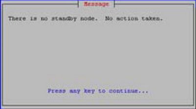

LSMS4015|14:58 Oct 22, 2005|xxxxxxx|Notify:Sys Admin - Heartbeat failureUntil the standby server returns to STANDBY state, automatic switchover is not possible, and if manual switchover is attempted, the
lsmsmgrtext interface displays a warning indicating that there is no standby mode and no action is taken.Figure 6-1 Unable to Switchover to Standby

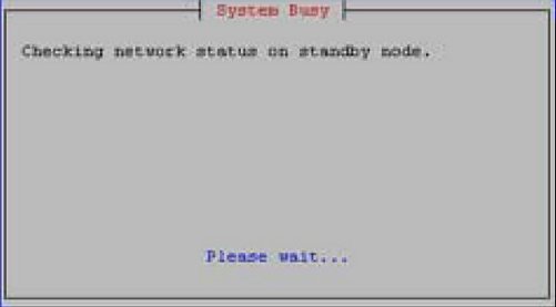

If the active server detects that a critical network interface has failed, the active server determines whether any critical network interfaces are considered to have failed on the standby server:
If any critical network interfaces are considered to have failed on the standby server, the active server continues in the ACTIVE state; it does not switch over.
If all critical network interfaces are responding to pings on the standby server, the active server switches over to the standby server and posts the following notifications:

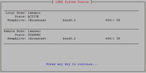

Using the lsmsmgr Interface to Determine the Server Status
Use the following procedure to determine the status of both servers.
Using the hastatus Command to Determine the Server Status
To use the command line to determine the state an individual server, perform the following procedure.

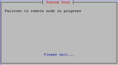

Manually Switching Over from the Active Server to the Standby Server

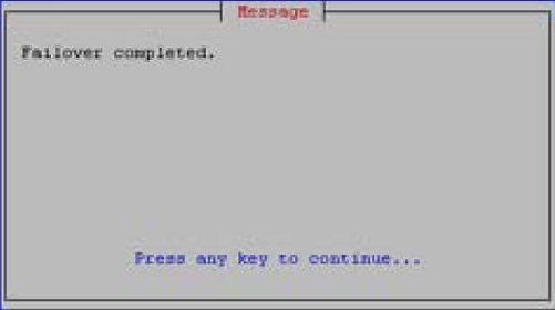

When there is a failure on the active server, or at other times for testing, you can use the lsmsmgr interface to manually switch over to the standby server, as described in the following procedure.
The server that was previously in STANDBY state is now in ACTIVE state, and the server that was previously in ACTIVE state is now in UNINITIALIZED "INHIBITED" state.
As soon as possible, perform the procedure described in “Starting a Server” to change the state of the server that is in UNINITIALIZED "INHIBITED" state to STANDBY state so that it is available if automatic switchover is needed or if manual switchover is desired.Inhibiting a Standby Server

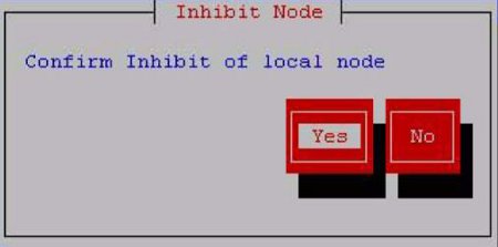

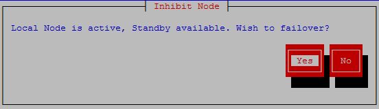

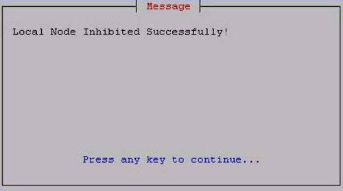

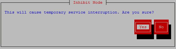

Occasionally (for example, before powering down), it may be necessary to inhibit the standby server.
Inhibiting the active server results in switchover, as described in “Manually Switching Over from the Active Server to the Standby Server”.Use the following procedure to inhibit the standby server.
Do not allow this server to remain in UNINITIALIZED "INHIBITED" state any longer than necessary. As soon as possible, perform the procedure described in perform the procedure described in “Starting a Server” to change the state of the server to STANDBY state so that it is available if automatic switchover is needed or if manual switchover is desired.Starting a Server
A server in UNINITIALIZED "INHIBITED" state cannot run the LSMS application and is not available as a standby server. Use the following procedure to change the state of a server from UNINITIALIZED "INHIBITED" to a state where it is available to run the LSMS application.
