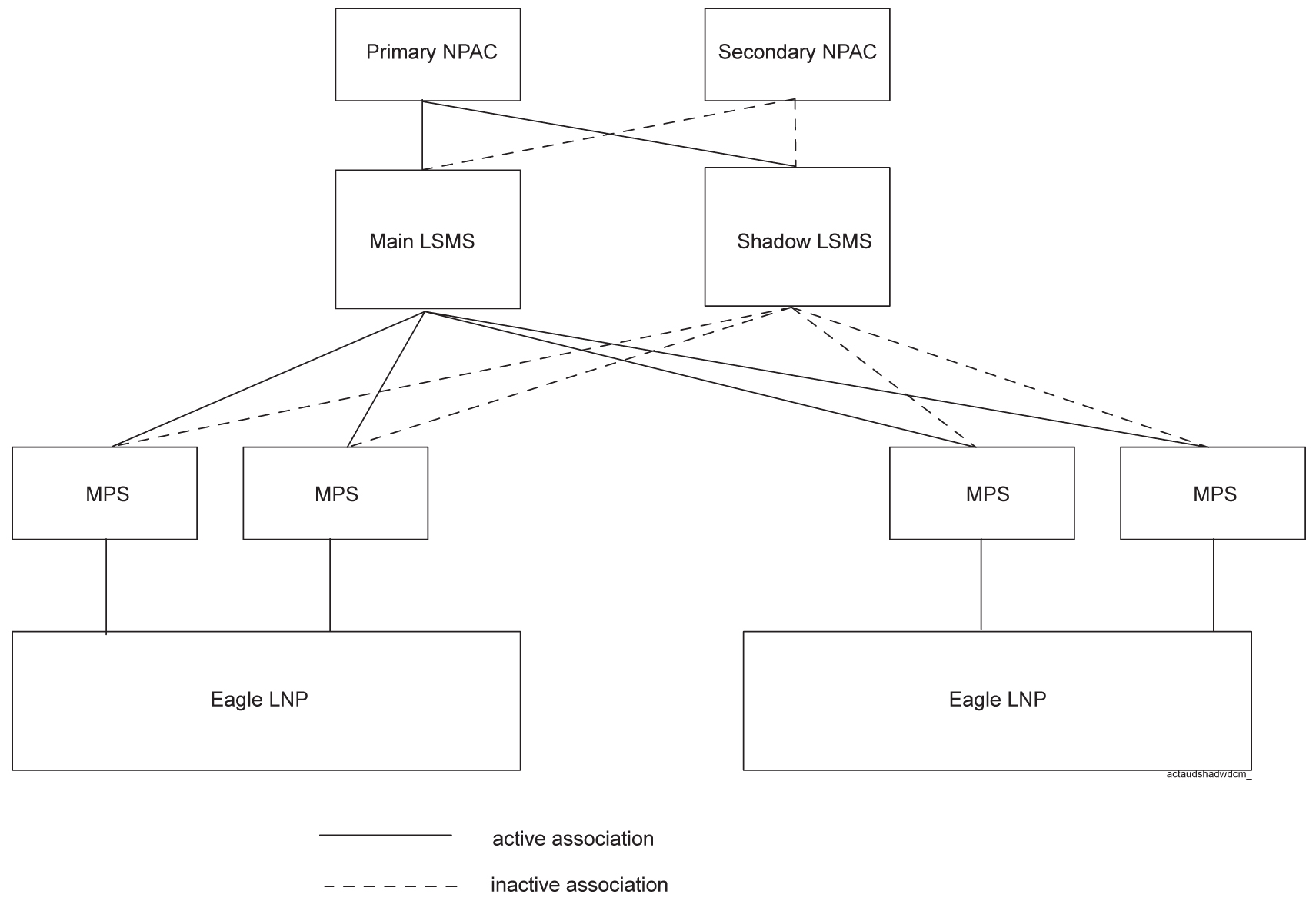

Using an Active Shadow
Figure 7-1 shows the configuration of a main LSMS that uses an active shadow as its backup.
An active shadow LSMS is an entire LSMS that is active and has active associations with each NPAC from which the LSMS needs data (only one NPAC is shown in Figure 7-1).
Figure 7-1 Overview of Main LSMS and Active Shadow LSMS
img/c_choosing_a_disaster_backup_strategy_mm-fig1.jpg
The disaster recovery backup strategy for this configuration provides the least out-of-service time for the LSMS. The recovery procedures for this strategy are described in Performing Disaster Recovery with an Active Shadow LSMS.

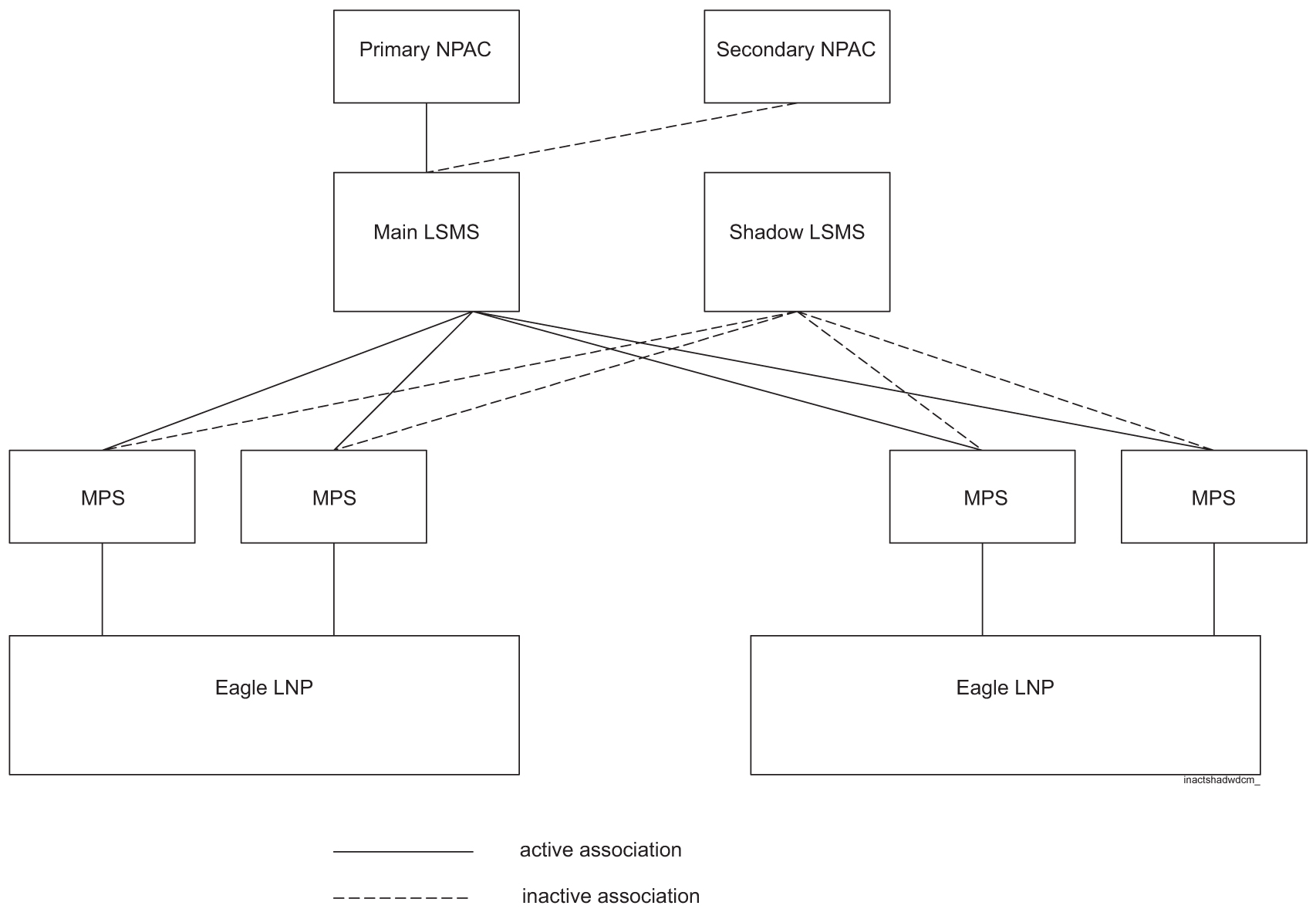

Using an Inactive Shadow
Figure 7-3 shows the configuration of a main LSMS that uses an inactive shadow as its backup.
The shadow LSMS does not maintain active connections with the NPACs that supply data to the main LSMS. However, disaster recovery is still more feasible than using no shadow, especially for disaster situations in which the physical site of the main LSMS is damaged (such as fire or natural disaster).
Figure 7-2 Overview of Main LSMS and Inactive Shadow LSMS
img/c_choosing_a_disaster_backup_strategy_mm-fig2.jpg
With this configuration, during disaster recovery you need to restore all databases from the NPAC. The recovery procedures are described in Performing Disaster Recovery with an Inactive Shadow LSMS.

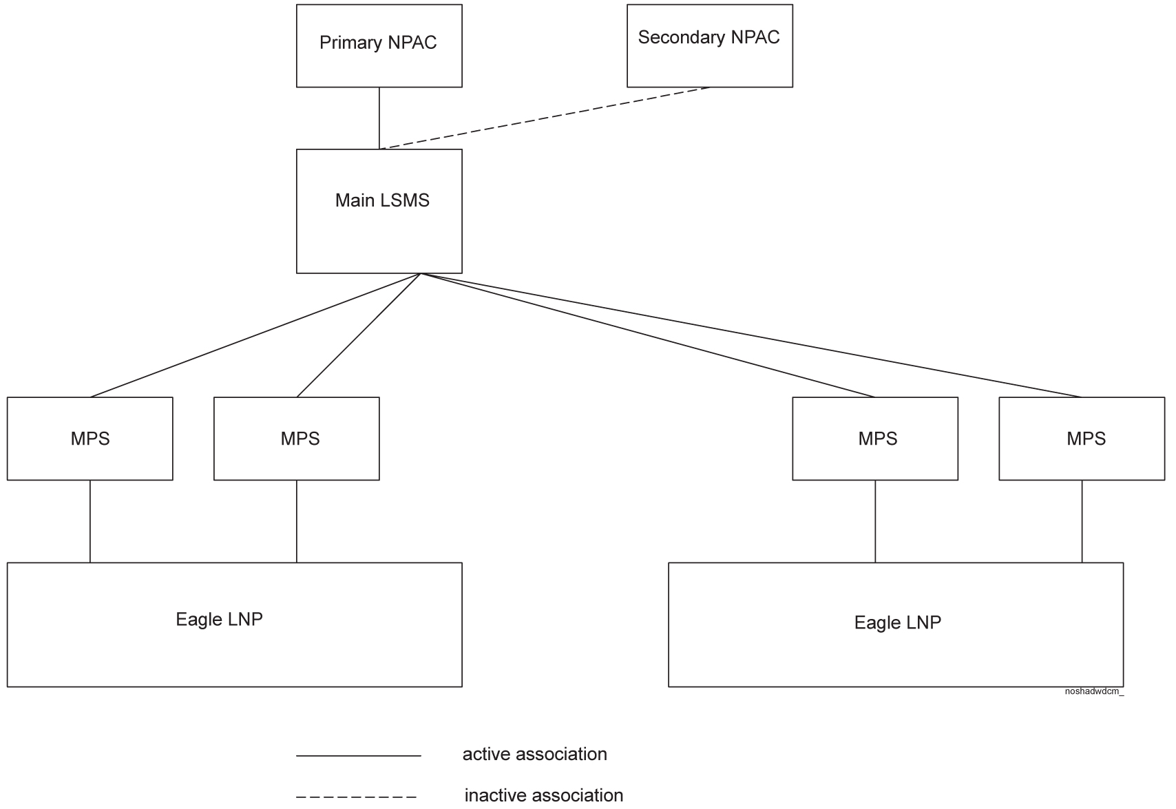

Using No Shadow
Figure 7-3 shows the configuration of a main LSMS that has no shadow as its backup.
Figure 7-3 Overview of Main LSMS without a Shadow LSMS
img/c_choosing_a_disaster_backup_strategy_mm-fig3.jpg
When no shadow LSMS exists, disaster recovery requires immediate repair of the main LSMS and its physical site, and then restore all databases from the NPAC. The recovery procedures are described in Performing Disaster Recovery without a Shadow LSMS.

In this disaster backup strategy, you have no physical backup for the LSMS. In a disaster situation, you must restore the main LSMS. Having no shadow can result in a very long recovery period in serious disaster situations, such as fire or natural disaster.
In addition to the assumptions listed in “Preparing for a Disaster Situation”, the following conditions are assumed for this procedure:
  • The main LSMS is restored at the same physical site. If another site is used, you must perform site survey and preparation as you do for any initial LSMS installation. For more information about installing LSMS, refer to Application B Card Hardware and Installation Guide.
  • A network connection exists between the restored main LSMS and each NPAC and network element.
Perform the procedures shown in Table 7-4 to restore the main LSMS when a disaster occurs.
Table 7-4 Recovery Procedures When No LSMS Shadow Exists
No shadow In the order shown, perform the following recovery procedures:
1, 2
Contact the unresolvable-reference.html#GUID-646F2C79-C167-4B5A-A8DF-7ED0EAA9AD66 to arrange repair or replacement of the LSMS. Oracle will dispatch technicians who will perform repairs, return the LSMS to operational status, and perform recovery acceptance tests.
3
Contact each NPAC from which the LSMS needs data to request which files will be needed to download to the shadow LSMS. It is recommended that the request be for all NPAC files dated from one hour before the time shown on the backup tape.
4
FTP data from NPAC and import it into the LSMS (see Downloading Files from an NPAC to the LSMS).
5
Start the LSMS GUI (association with each NPAC is automatically attempted).
6
If any locally provisioned data needs to be added, add it.
7
Perform the procedures in “Reconnecting Network Elements”.
8
If the disaster outage has lasted for 7 days or less, for each network element, perform a time-range audit (specify the start time to be one hour before the outage occurred) and a full-range audit of DGTT, OGTT, and NPA Splits. For information about performing audits, refer to “Audit and Optional Reconcile from the LSMS GUI” in the LNP Database Synchronization User's Guide.
(If the disaster outage has lasted more than 7 days, perform a complete bulk download to each network element. For information about performing bulk downloads to network elements, refer to the LNP Database Synchronization User's Guide.)
9
If any query servers are installed, for each directly connected query server, perform the procedure in “Reload a Query Server Database from the LSMS”.
