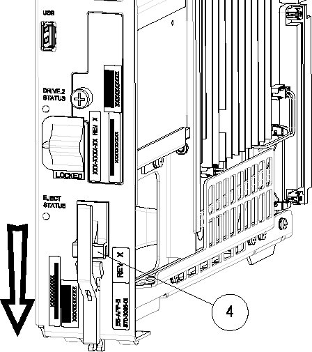

  1. On the E5-APP-B card, slide the Ejector switch (4) up to the UNLOCKED position (see Figure 9-1).
    Caution:
    When the Ejector switch goes from locked to unlocked and the E5-APP-B card is in service, the card will halt.
    Figure 9-1 E5-APP-B Card Eject Hardware Switch, UNLOCKED
    img/card-eject-1.jpg
  2. WAIT for the E5-APP-B Eject Status LED to go from blinking red to a steady red.
    When the Eject Status LED is steady red, the E5-APP-B card is in shutdown state.
    If the Ejector switch is put into the LOCKED position now, the E5-APP-B card will reboot.

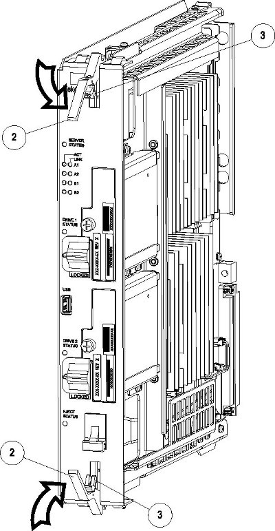

  3. Grasp the upper and lower card Inject/Eject (I/E) lever release (3) just underneath the I/E lever, and press it to meet the I/E lever. This is the mechanical interlock for the card.
    See Figure 9-2
    Figure 9-2 E5-APP-B Card UNLOCKED
    img/card-eject-2.jpg
  4. While holding the I/E interlock and lever, pull the levers (2) away from the shelf until they are parallel to the floor.
  5. Remove the E5-APP-B card from the EAGLE shelf.

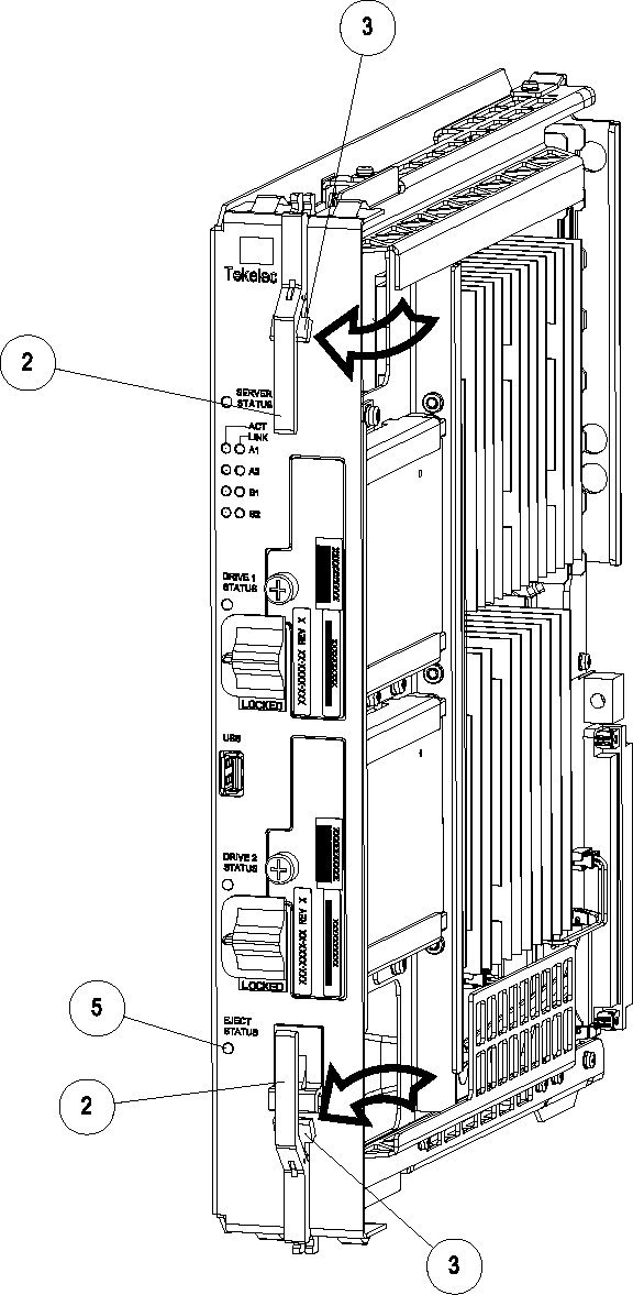

  1. While holding the I/E interlock and lever, pull the levers (2) away from the card until they are parallel to the floor.
    Figure 9-3 illustrates the angle of the interlocks and levers just before inserting E5-APP-B Card into the EAGLE shelf.
    Figure 9-3 E5-APP-B Card UNLOCKED
    img/card-unlocked.jpg
  2. Insert the E5-APP-B card into the EAGLE shelf.
    Carefully align the edges of the card with the top and bottom card guides. Then, push the card along the length of the card guides until the rear connectors on the card engage the mating connectors on the target shelf backplane.
  3. Push in the top and bottom inject/eject clamps (see Figure 9-4).
    Figure 9-4 E5-APP-B Card Inject Levers
    img/card-inject-1.jpg
    This locks the card in place and ensures a strong connection with the pins on the target shelf backplane.

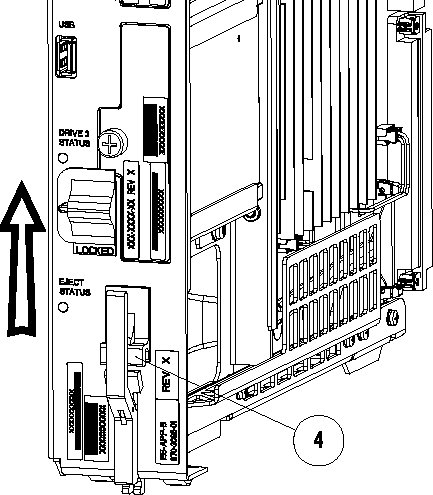

  4. Slide the E5-APP-B Ejector switch (4) down to the LOCKED position (see Figure 9-5).
    When the Ejector switch goes from UNLOCKED to LOCKED, the E5-APP-B Eject Status LED blinks red as the E5-MASP card goes online.
    Figure 9-5 E5-APP-B Card Inject Hardware Switch, LOCKED
    img/card-inject-2.jpg
  5. WAIT for the E5-APP-B Eject Status LED to go from blinking red to off.

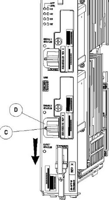

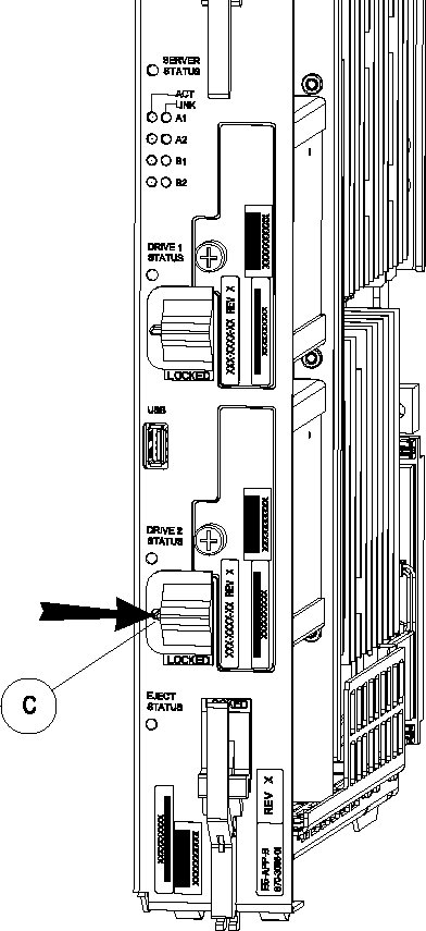

  1. Verify that the drive module is locked in position and in use.
    The switch lock release (C) is in the LOCKED position and the Status LED on the E5-APP-B card is OFF.
    Move the switch lock release (C) to the "released" position by pressing in the direction indicated. Refer to Figure 9-6.
    Figure 9-6 Drive Module Released
    img/ssd-eject-1.jpg

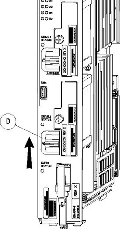

  2. Move drive module locking switch (D) from the LOCKED to the unlocked position and wait for the LED (B) to indicate a steady red state. See Figure 9-7 and Figure 9-8, respectively.
    When drive module locking switch (D) is transitioned from locked to unlocked, the LED will flash red to indicate the drive is unlocked and in process of shutting down.
    Figure 9-7 Drive Module UNLOCKED
    img/ssd-eject-2.jpg
    Caution:
    Removal of the drive prior to the LED indicating steady red could result in drive corruption.
    Figure 9-8 Drive Module Status
    img/ssd-eject-3.jpg
  3. When the LED indicates a steady red, the drive module can be safely removed.

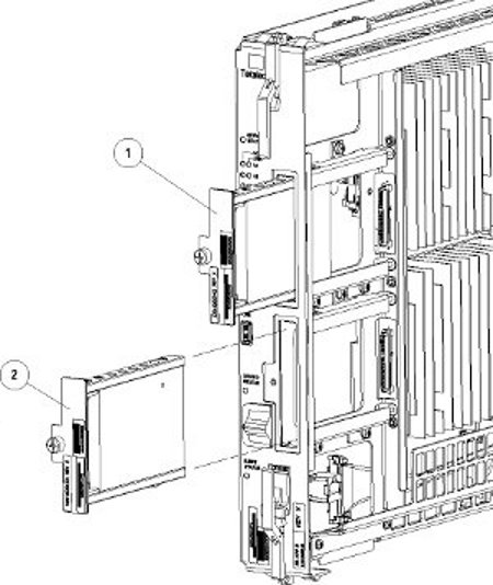

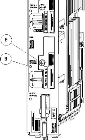

  4. Loosen the drive module screw (E) (see Figure 9-8).
  5. Grasp the screw (E) and pull the drive out slowly until it is free from the card (see Figure 9-9).
    Figure 9-9 Drive Module Removal
    img/ssd-eject-5.jpg

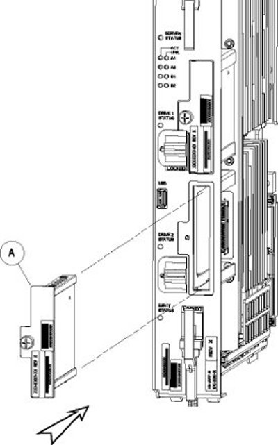

  1. Slide a new drive(s) module into the drive slot on the card (see Figure 9-10).
    Figure 9-10 Drive Module Replacement
    img/ssd-inject-1.jpg
  2. Gently push the drive (A) in slowly until it is properly seated.
  3. Tighten the mounting screw until the Drive Status LED is in a steady red state ((B), from Figure 9-8).
