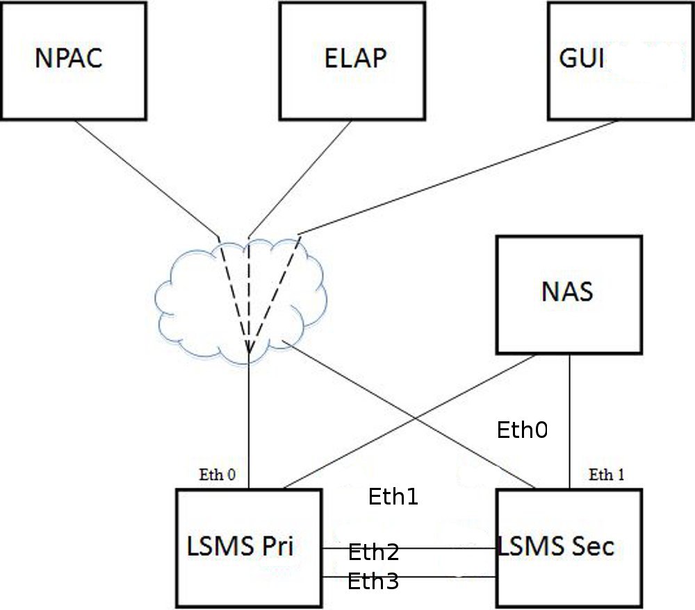

    The following figures and tables show E5-APP-B configuration. Figure 2-2 shows how to connect cables to the server in a single subnet configuration and Table 2-1 defines the physical port assignments.
A single subnet network configuration is recommended due to the ease of configuration and maintenance.
Figure 2-2 Physical Port Assignments - E5-APP-B Single Subnet Configuration
Table 2-1 Physical Port Assignments - E5-APP-B Single Subnet Configuration
LAN Interface Connections Speed
Eth0 NPAC, ELAP, GUI, EMS, SSH Gigabit Ethernet
Eth1 Direct connect to NAS Gigabit Ethernet
Eth2 Direct connect to Mate for Heartbeat and MySQL replication Gigabit Ethernet
Eth3 Direct connect to Mate for Heartbeat and MySQL replication Gigabit Ethernet
The NAS is directly connected with the LSMS in the single subnet configuration. The NAS is configured using dhcp.
Eth0 is used to configure the NPAC, ELAP and APP (GUI/SSH).

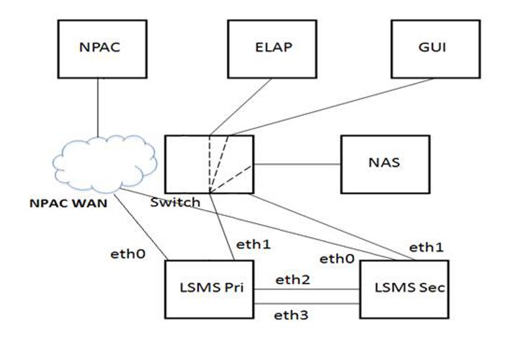

  • Segmented network: each server requires eight Ethernet connections and nine IP addresses (one for the VIP address and six for the clouds)
    There are more switch/router ports required to enable the segmented configuration, which the customer is required to provide. The local switch needs one port for each LSMS Primary, Secondary and NAS. For E5-APP-B, Eth1 is no longer physically connected to the NAS. Eth1 must connect to a local switch for proper NAS performance. The dedicated switch ports must be set to 1Gbps.
    Figure 2-3 shows how to connect cables to the server in a segmented configuration and Table 2-2 defines the physical port assignments.
Figure 2-3 Physical Port Assignments - E5-APP-B Segmented Configuration
Table 2-2 Physical Port Assignments - E5-APP-B Segmented Configuration
Eth0 NPAC Gigabit Ethernet
Eth1 NAS, ELAP, GUI, EMS, SSH, Query Server, SNMP Gigabit Ethernet

The NAS is connected to Eth1 via switch. The NAS is configured using dhcp.
The two aliases of Eth1 are Eth1:0 and Eth1:1, respectively.
Eth1:0 is used to configure APP (GUI/SSH via switch).
Eth1:1 is used to configure ELAP via switch.

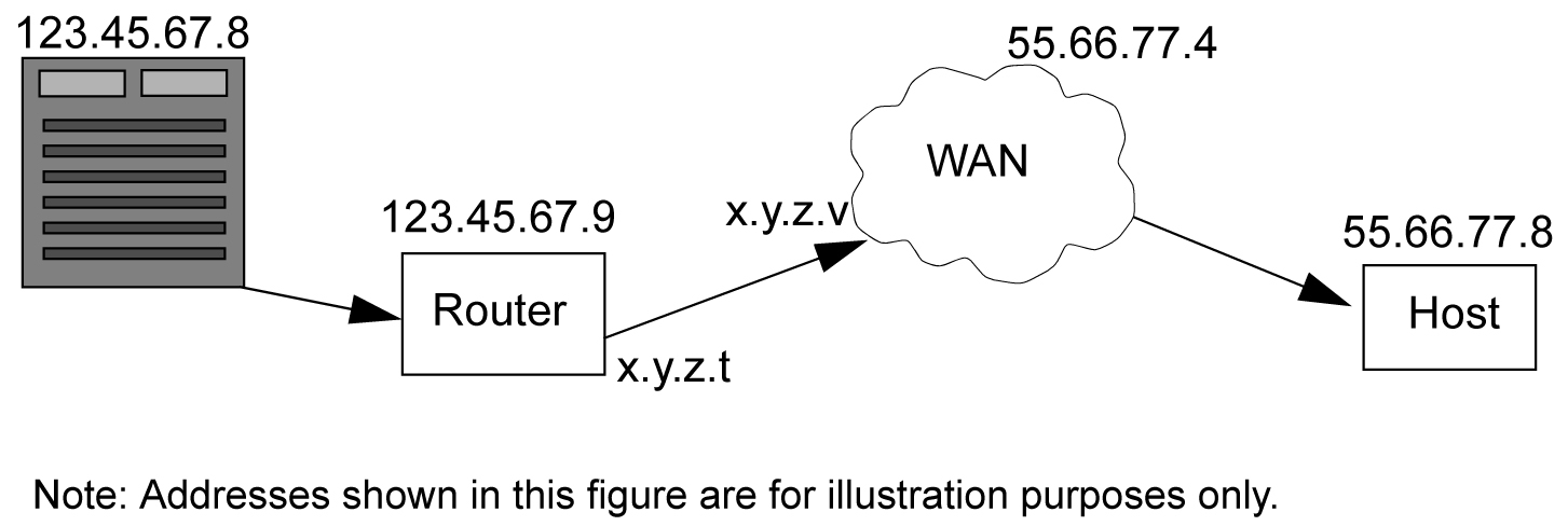

2.3.6 Adding Additional Routes
If you use a multiport router or an Ethernet switch in your network, it is your responsibility to ensure that the network connection receiving packets for the destination end (typically the NPAC or EMS networks) has an address on the same subnet as each interface. Figure 2-5 illustrates the routing methodology.
Figure 2-5 LSMS Interface Routing in a Segmented Configuration

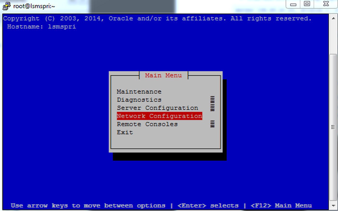

  2. From the Main Menu, select Network Configuration and press Enter.

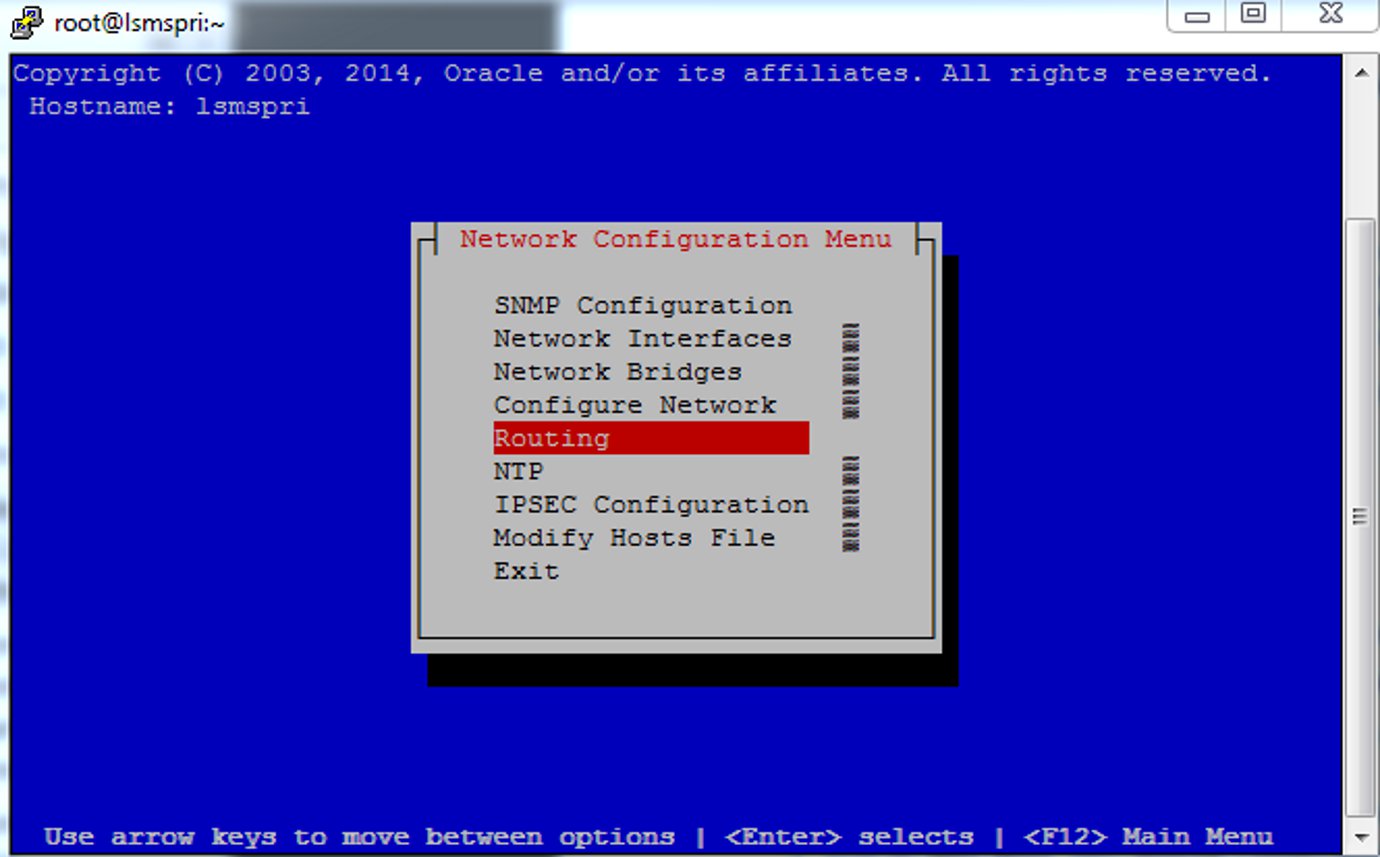

  3. From the Network Configuration Menu, select Routing and press Enter to display the existing routes.
    Figure 2-7 Selecting the Routing Menu
    img/t_adding_additional_routes_config_fig3.jpg

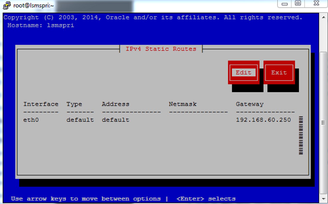

  4. Examine the current routes on the system.
    Consider any additional routes you may wish to add, and click the Edit button to start adding other routes.
    Figure 2-8 Displaying Current System Routes

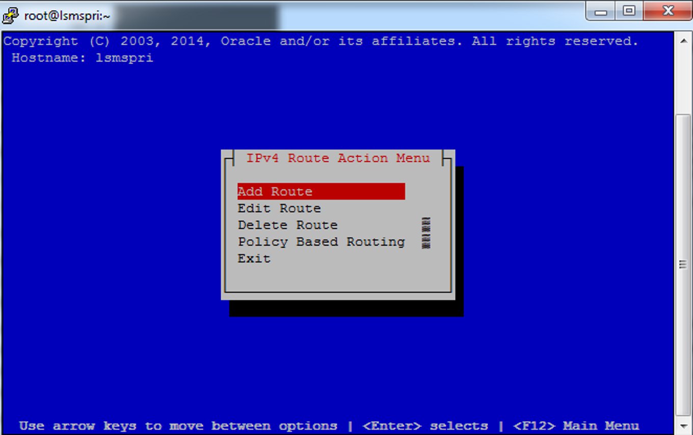

  5. When you want to add another route, press the Edit button and see the Route Action Menu.
    Select the Add Route button and press Enter.

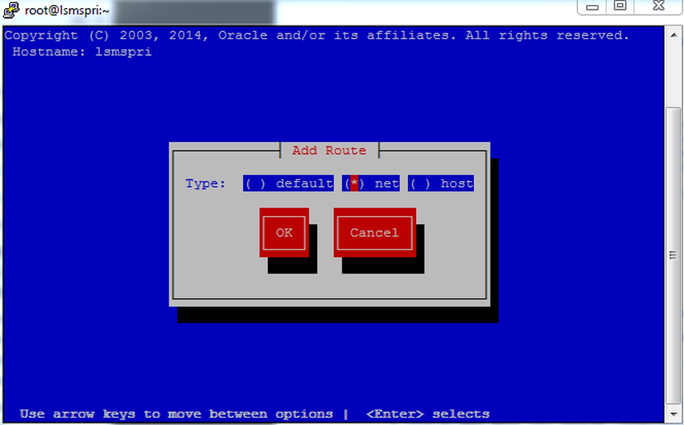

  6. In the Add Route screen, you can select the ( )net or ( )host entry by pressing the space bar, and press the OK button to bring up the screen to add a new route.

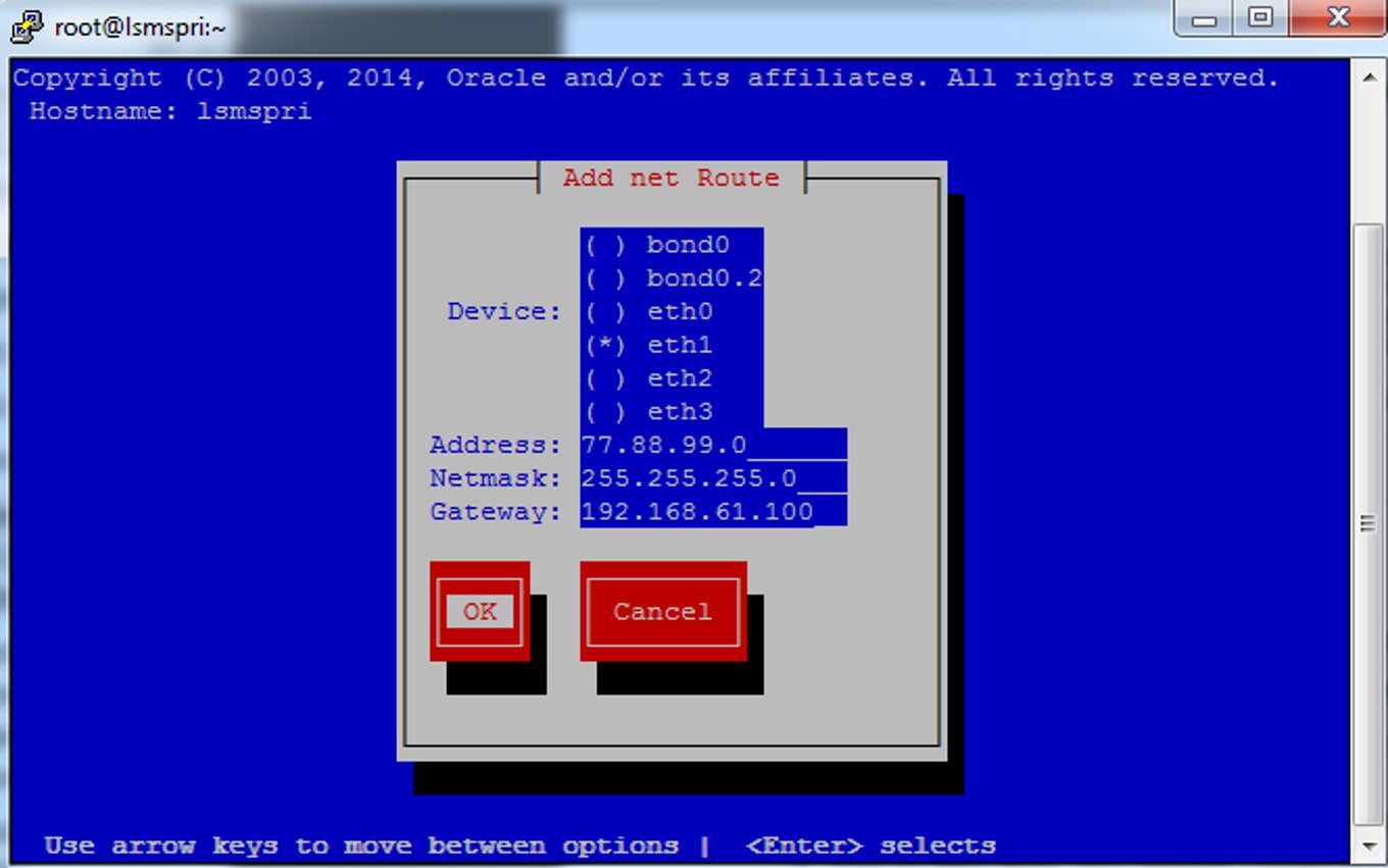

  7. In the Add net Route screen, you can define the server port, Address, Netmask, and Gateway for the new route you are adding.
    Select the device port to be used, and then fill in the additional fields in the display.
    Figure 2-11 Displaying the Add net Route Screen
  8. Figure 2-12 shows the fields you defined to add the new route.
    Review and be certain your entries are accurate. When you are satisfied with this entry, click the OK button to accept your newly defined route.
    Figure 2-12 Entering a New Add net Route Screen

    Figure 2-13 Returning to the Route Action Menu Screen
  10. When you press Exit on the preceding screen, the system displays the currently defined routes, including the one you just entered.
    At this point you can click Edit to change existing routes or click Exit to return to the Network Configuration Menu.
    Figure 2-14 Selecting the Network Configuration Menu

  9. Figure 2-21 displays the confirmed data for the configuration.
    When the configuration is completed, enter q to quit and then y to confirm.
    Figure 2-21 Entering a New Add net Route Screen
    You will return to the Network Configuration menu.
