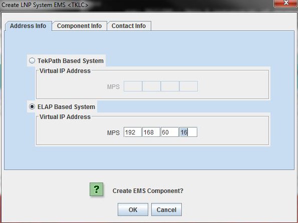

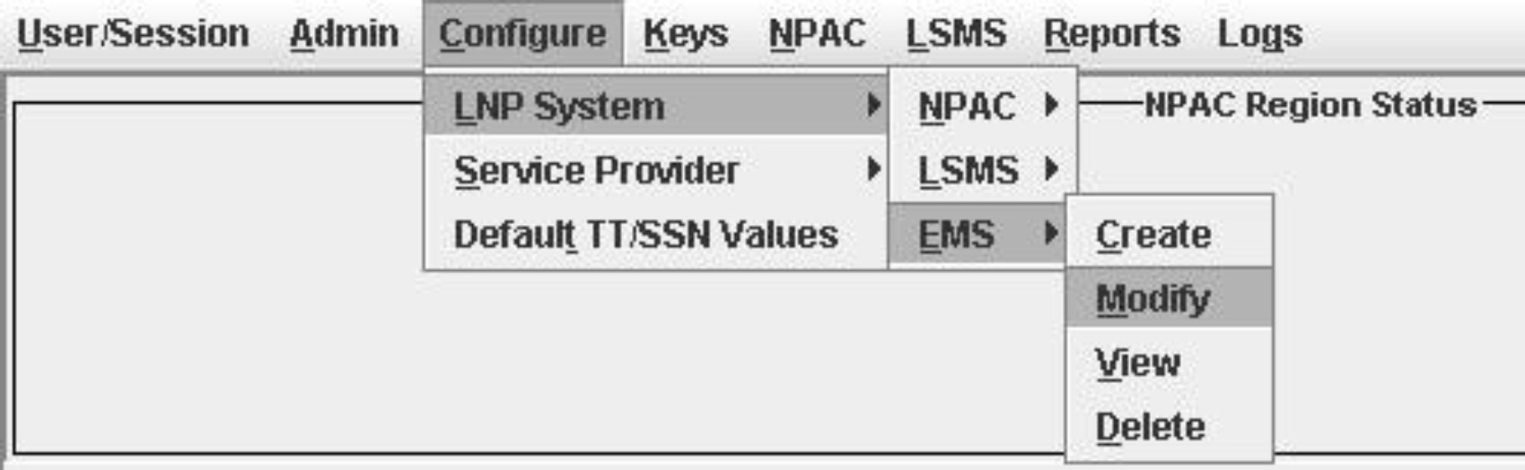

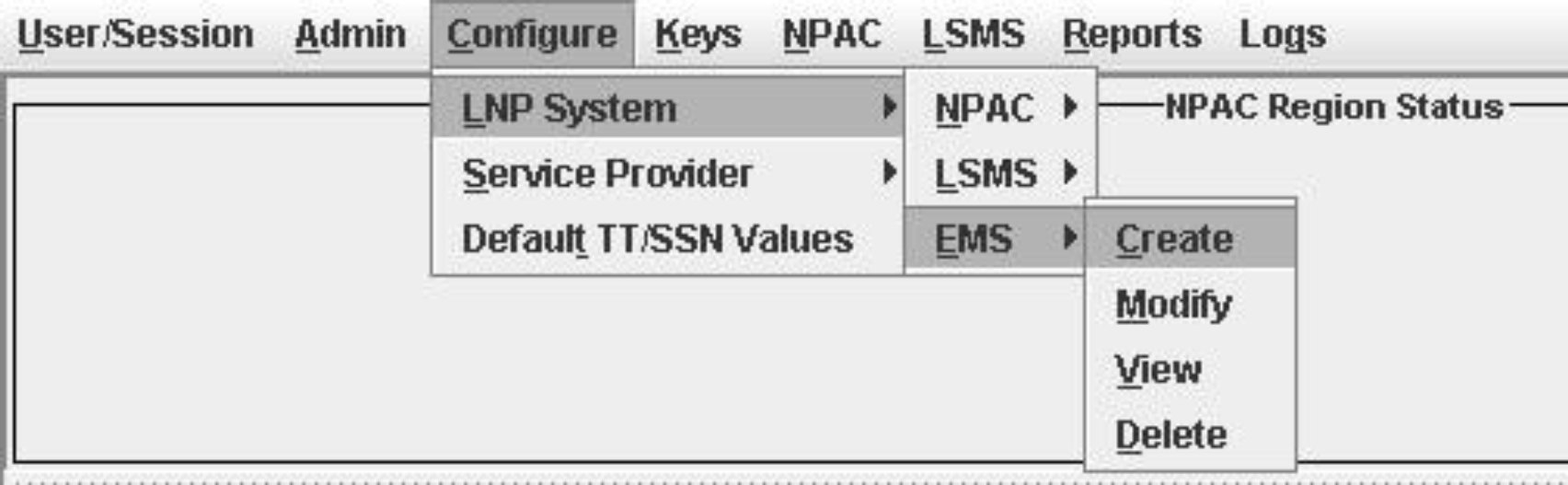

For each EMS to be supported, create an EMS component by performing the procedure Creating an EMS Configuration Component.

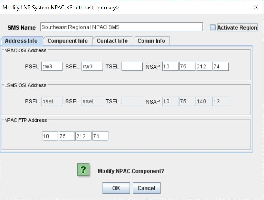

4

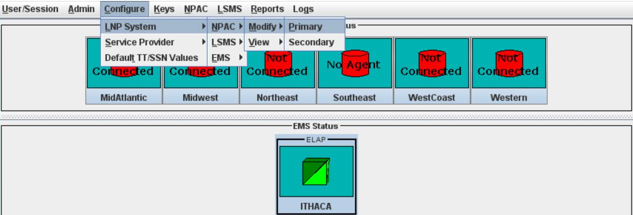

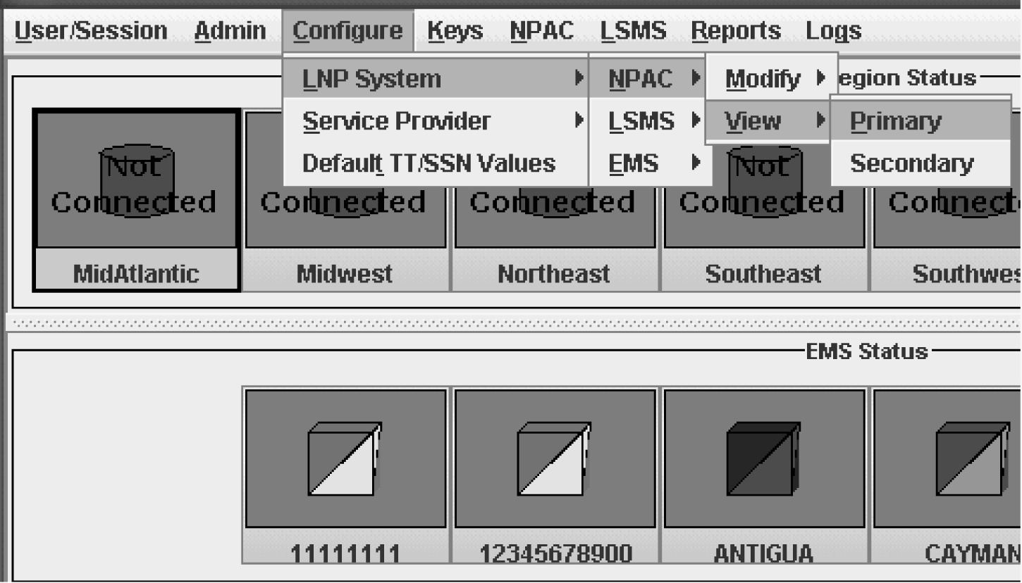

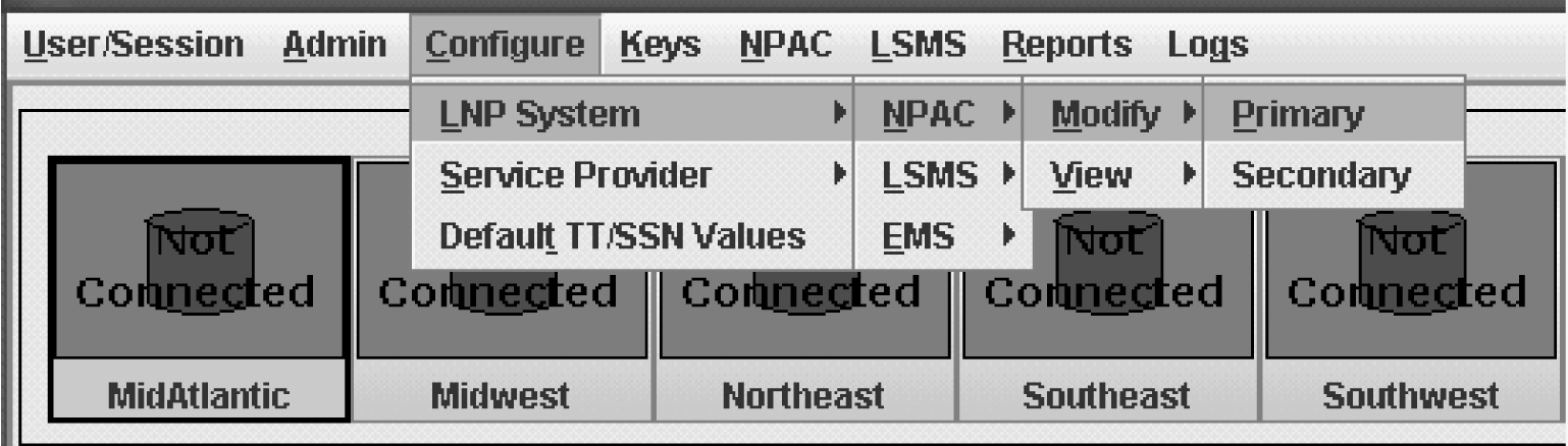

Select Configure, and then LNP System, and then NPAC , and then Modify, and then Secondary to create a secondary NPAC component and enter the information described in “Modifying an NPAC Component”. Ensure that the Activate Region checkbox is empty.
For the Component ID field, a value that is one greater than the value entered in the procedure in row 5 is suggested.

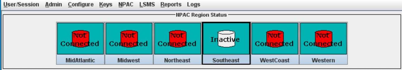

5

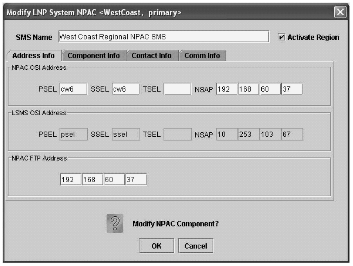

Click the icon that corresponds to this region so that the icon is highlighted, and select Configure, and then LNP System, and then NPAC , and then Modify, and then Primary to create a primary NPAC component. Enter the information described in “Modifying an NPAC Component”.
Ensure that the Activate Region checkbox is filled in. When you click the OK button, the sentry utility will automatically attempt to associate with the NPAC.

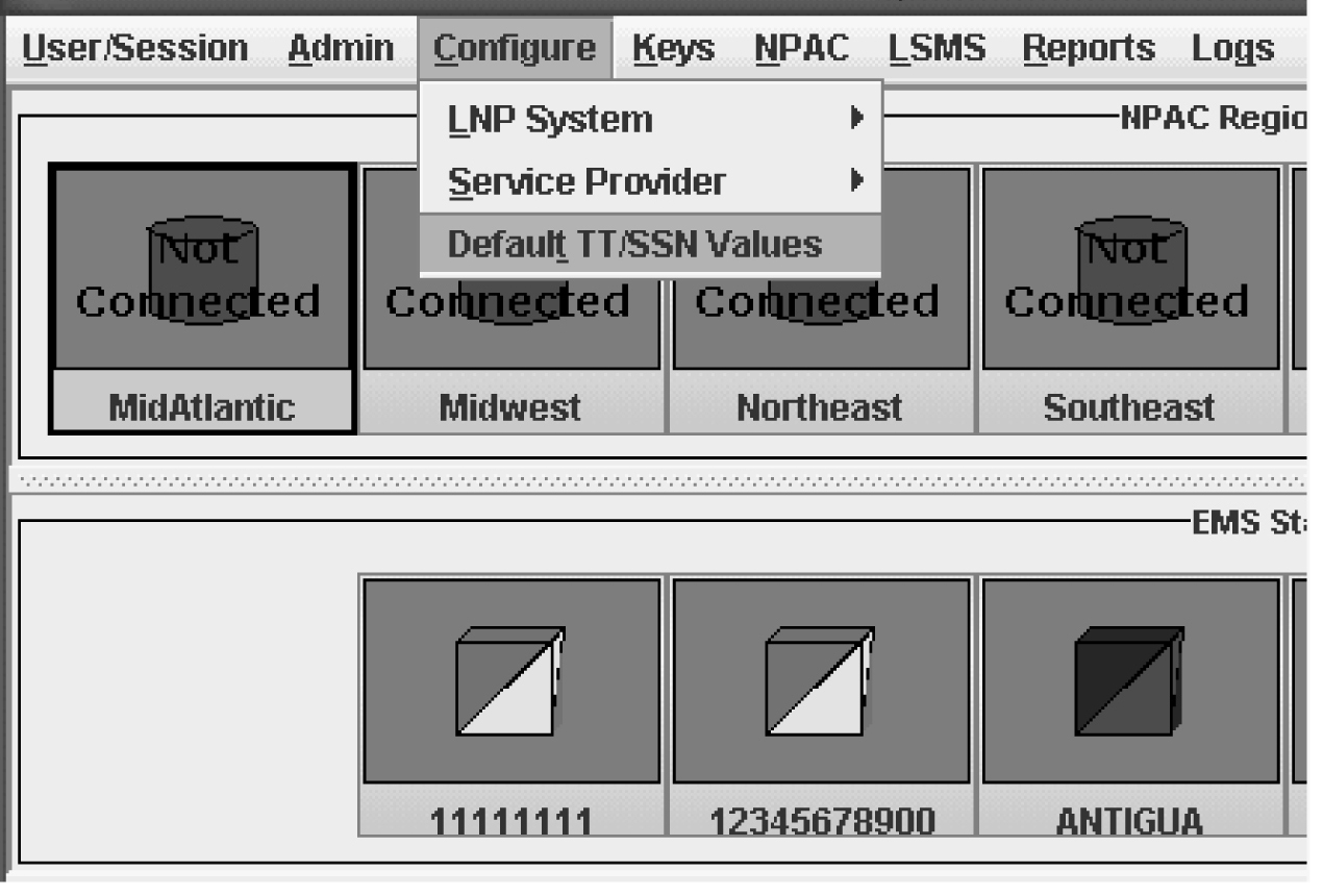

To add service provider contact information into the LSMS database, use the following procedure.
  1. Log in as a user in the lsmsadm or lsmsall group.
  2. From the LSMS Console window, select Configure, and then Service Provider, and then Create.
    Figure 3-1 Configure Service Provider Selection

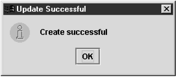

  6. When finished, click OK to apply the changes and return to the LSMS Console window, or Apply to apply the changes and remain in the current window.
    Click OK in the message window:
    Figure 3-3 Create Successful
    Create Successful

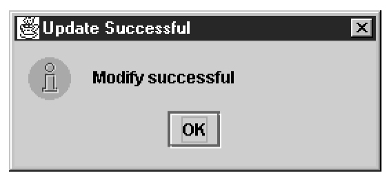

  5. When finished, click OK to apply the changes and return to the LSMS Console window, or Apply to apply the changes and remain in the current window.
    Figure 3-5 Modify Successful
    Modify Successful

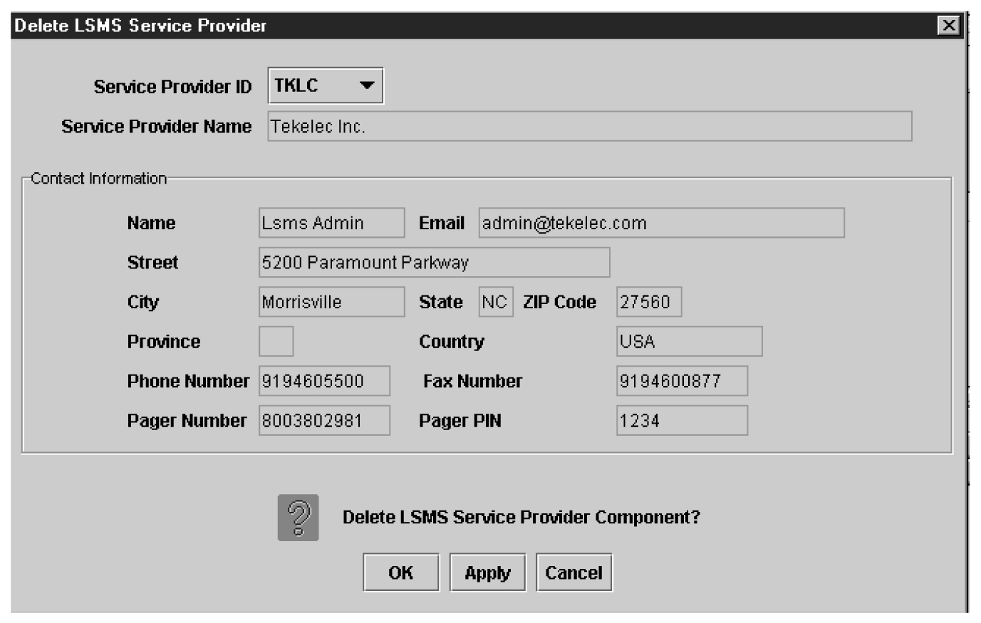

3.3.4 Deleting Service Provider Contact Information
To delete service provider contact information, use this procedure.
  2. From the LSMS Console window, select Configure, and then Service Provider, and then Delete.
    Figure 3-7 Delete LSMS Service Provider Window
  3. If the Service Provider that you wish to delete is not displayed in the Service Provider ID field, click the down arrow to the right of that field and select the Service Provider ID that you wish to delete.
  4. Verify that this is the Service Provider that you wish to delete.
    In either case, the Delete Confirmation window displays.
    Figure 3-8 Delete Confirmation Window
  6. Click Yes or No to end this procedure.

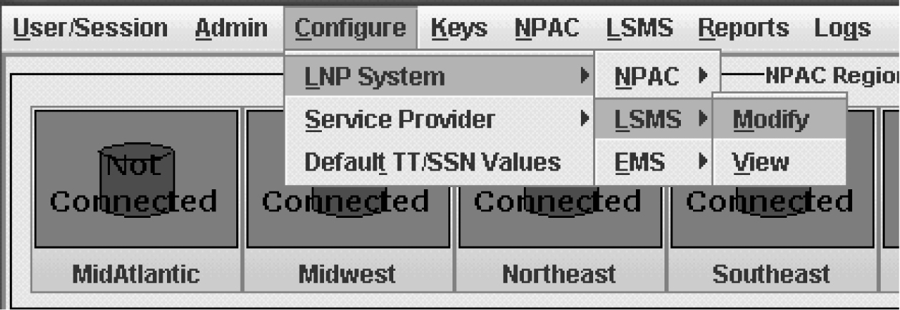

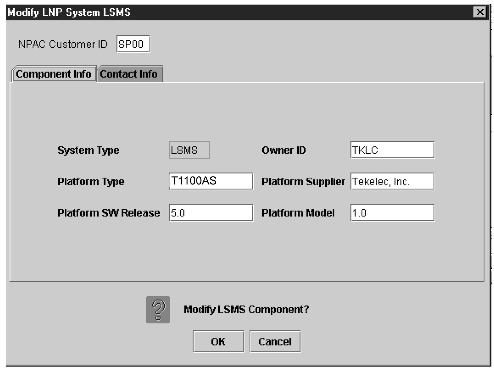

3.4.1 Modifying LSMS Configuration Components
Use the following procedure to create or modify LSMS configuration components.
  2. From the main menu, select Configure, and then LNP System, and then LSMS, and then Modify.
    Figure 3-9 LNP System Menu – Modify LSMS

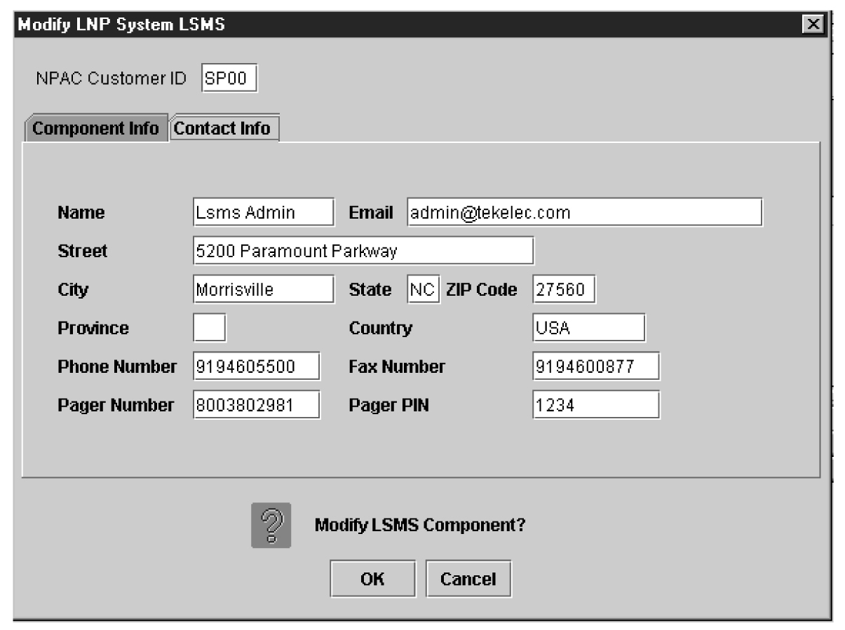

    The Modify LNP System LSMS window displays. In this example, the Primary was selected. The window usually opens with the Component Info tab displayed; if the Component Info tab is not displayed, click its tab to display it.
    Figure 3-10 Modify LNP System LSMS Component Info Tab

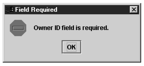

  3. In the NPAC Customer SPID field, enter the identification (four alphanumeric characters) by which the LSMS owner is known to the NPACs.
    This required field will be used when the LSMS associates with the NPAC.
  4. Enter the LSMS Component Info data as follows (all fields in the Component Info tab must contain data):
    • Owner ID – ID of the LSMS owner (maximum 20 alphanumeric characters)
    • Platform Type – hardware platform of the LSMS (maximum 20 alphanumeric characters)
    • Platform Supplier – name of the supplier of the LSMS hardware platform (maximum 20 alphanumeric characters)
    • Platform SW Release – release level of the software running on the LSMS platform (maximum 20 alphanumeric characters)
    • Platform Model – model number of the LSMS platform (maximum 20 alphanumeric characters)
  5. Click the Contact Info tab.
    Figure 3-11 Modify LNP System LSMS Contact Info
    img/t_lsms_configuration_components_config_fig3.jpg
  6. All fields in the Contact Info tab are optional.
    If you wish to enter LSMS Contact Info data, do so as follows:
    • Name – name of the person to contact for LSMS information (maximum 40 alphanumeric characters)
    • Email – email address of the LSMS contact person (maximum 60 alphanumeric characters)
    • Street – street address of the LSMS contact person (maximum 40 alphanumeric characters)
    • City – city address of the LSMS contact person (maximum 20 alphanumeric characters)
    • State – state address of the LSMS contact person (two-letter uppercase abbreviation).
      If you use the Province field, enter -- (the default).
    • ZIP Code – postal zip code of the LSMS contact person (five numeric characters)
    • Province – province of the LSMS contact person (two-letter uppercase abbreviation).
      If you use the State field, enter -- (the default).
    • Country – country of the LSMS contact person (maximum 20 alphanumeric characters)
    • Phone Number – phone number of the LSMS contact person (ten numeric characters required)
    • FAX Number – FAX number of the LSMS contact person (ten numeric characters required)
    • Pager Number – pager number of the LSMS contact person (ten numeric characters required)
    • Pager PIN – pager PIN number of the LSMS contact person (ten numeric characters maximum)

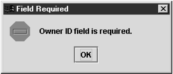

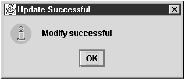

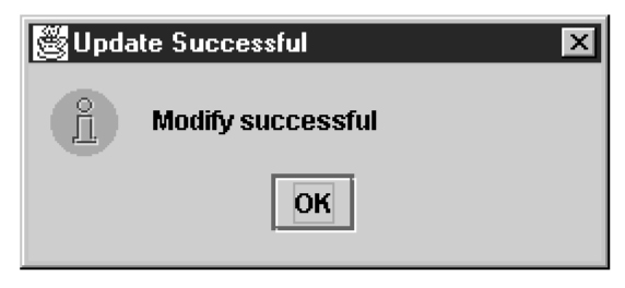

  7. When finished, click OK to apply the changes.
    • If the following message appears, click OK in the message window and the GUI will return to the main console window.
      Figure 3-12 Modify Successful
      img/t_lsms_configuration_components_config_fig4.jpg
    • If a message similar to the following appears, a mandatory field is empty or a field is not properly configured.
      Figure 3-13 More Fields Needed
      img/t_lsms_configuration_components_config_fig5.jpg
      Click OK in the message window and correct the appropriate field. Repeat this step until the message in Figure 3-12 displays.

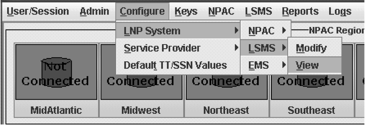

  2. From the main menu, select Configure, and then LNP System, and then LSMS , and then View.
    Figure 3-14 LNP System Menu – View LSMS

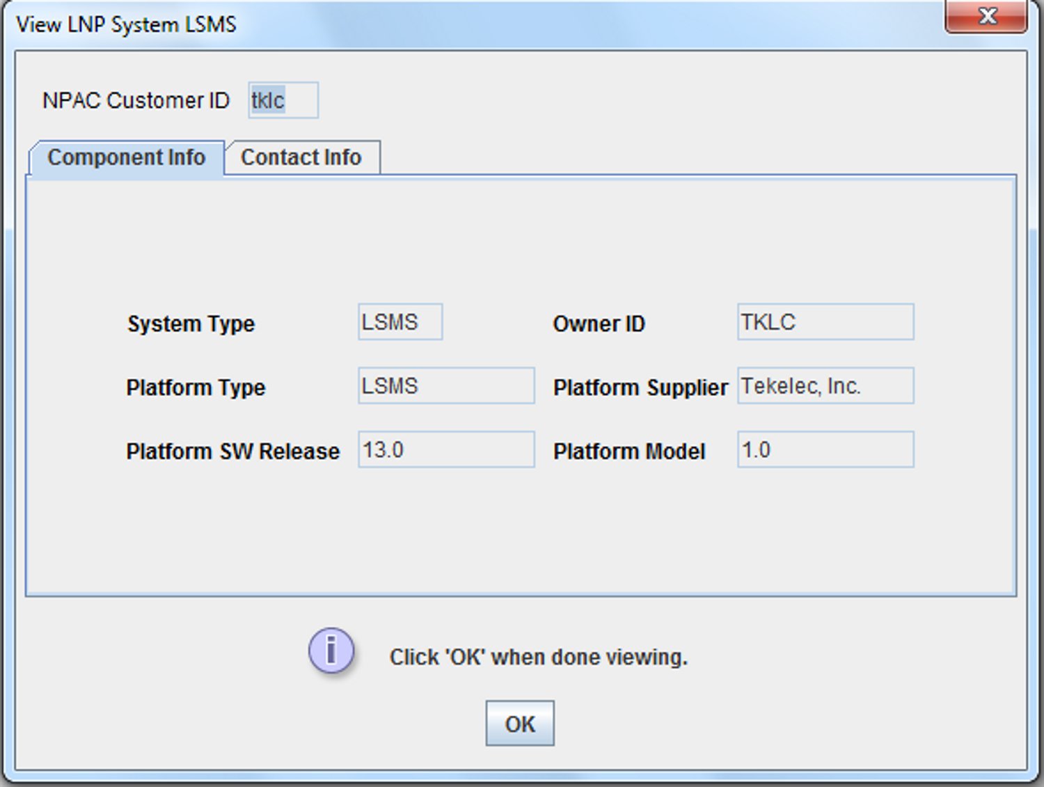

    img/t_viewing_a_configured_lsms_component_config-fig1.jpg
    The View LNP System LSMS window displays. The window usually opens with the Component Info tab displayed.
    Figure 3-15 View LNP System LSMS Window
  3. To view a different tab, click on the tab.
    For information about the fields displayed in any of the tabs, see their description in the procedure defined in Modifying LSMS Configuration Components.
  4. When finished viewing this window, click OK to return to the main LSMS console window.

3.5.1 Creating an EMS Configuration Component
For each network element to be supported by the LSMS, create an EMS configuration component using the following procedure.
For each EMS configuration created, you must perform a bulk download to the associated EMS/network element. Refer to the LNP Database Synchronization User's Guide for bulk loading procedures.
  1. Log into the LSMS as a user in the lsmsadm or lsmsall group.
  2. From the LNP System menu, shown in Figure 3-16, select Configure, and then LNP System, and then EMS, and then Create.
    Figure 3-16 LNP System Menu – Create EMS
    img/t_creating_an_ems_configuration_component_config-fig1.jpg
    The EMS Configuration Component window, Figure 3-17 displays. The window usually opens with the Address Info tab displayed; if the Address Info tab is not displayed, click its tab to display it.
    Figure 3-17 Create LNP System EMS Address Info Tab
    img/figure-37-ems-address-info.jpg
  3. Ensure that the radio button for an ELAPMPS or a TekPath MPS is selected. For an ELAPMPS (ELAP version 7 or older), enter the IP addresses for MPS A and MPS B (enter a value from 0 to 255 in each of the first three octets and a value from 0 to 254 in the forth octet). For a TekPath MPS, enter the IP address for MPS A only.
    The LSMS no longer supports connections to OAPs.
  4. Select one of the following radio buttons for the Verify MPS with PING field to specify whether the LSMS uses PING to monitor the connectivity between the LSMS and the MPS.
    With either selection, the LSMS always monitors connectivity with the keep alive function.
    • Enabled to monitor the MPS by sending PINGs over the UDP port. This selection requires an additional port to be open (which can be a security concern), but supports previously available function.
    • Disabled to monitor the MPS using only the keep alive function. This selection reduces the number of ports required to be open inbound to the ELAP network. Security is increased when the number of open ports is decreased.
    The LSMS/EMS PING Enhancement feature provides the following functionality:
    • Prevents intermediate devices (for example, routers and switches) from closing idle HSOP connections
    • Detects low level network faults that were previously not detectable using the TCP/IP stack alone.

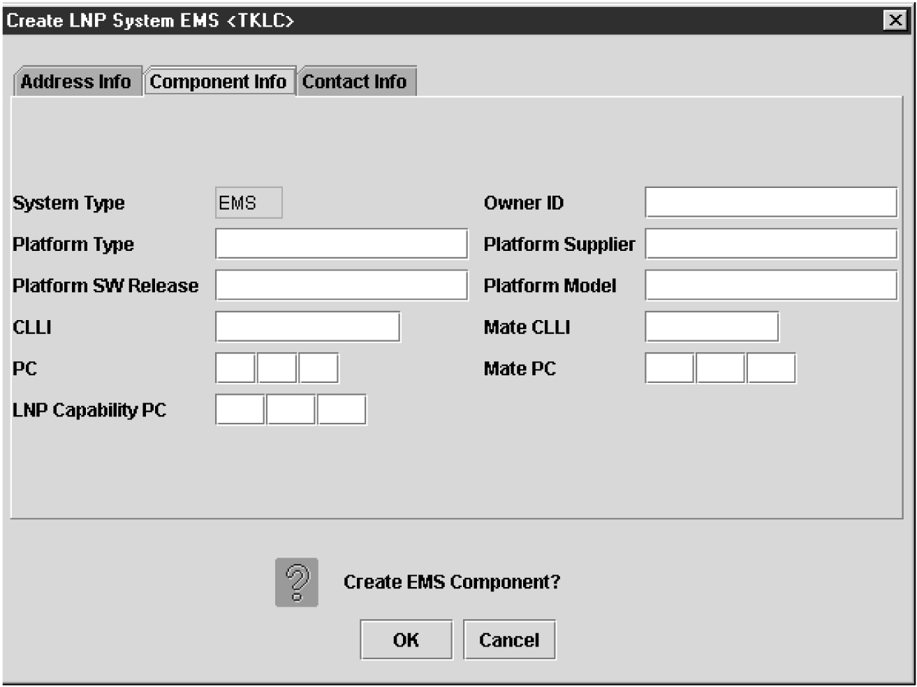

  5. Click the Component Info tab, shown in Figure 3-19.
    Figure 3-18 Create LNP System EMS Component Info
    img/c_creating_an_ems_configuration_component_config-fig3.jpg
  6. Enter the Component Info data as follows (all fields in this tab must contain data):
    • Owner ID – ID of the network element owner (maximum 20 alphanumeric characters)
    • Platform Type – hardware platform of the network element (maximum 20 alphanumeric characters)
    • Platform Supplier – name of the supplier of the network element hardware platform (maximum 20 alphanumeric characters)
    • Platform SW Release – release level of the software running on the network element platform (maximum 20 alphanumeric characters)
    • Platform Model – model number of the network element platform (maximum 20 alphanumeric characters)
    • CLLI – CLLI code of the network element (maximum 11 numeric and uppercase alphabetic characters)
    • Mate CLLI– CLLI of the mate EMS component (maximum 11 numeric and uppercase alphabetic characters)
    • PC – point code of the EMS component (must contain three 3-digit octets; first octet must have a value from 1 to 255; last two octets must have a value from 0 to 255; second octet must not be 001 if the first octet has a value from 1 to 5)
    • Mate PC – point code of the mate EMS component (must contain three 3-digit octets; first octet must have a value from 1 to 255; last two octets must have a value from 0 to 255; second octet must not be 001 if the first octet has a value from 1 to 5)
    • LNP Capability PC – LNP capability point code of the network element (must contain three 3-digit octets; first octet must have a value from 1 to 255; last two octets must have a value from 0 to 255; second octet must not be 001 if the first octet has a value from 1 to 5)

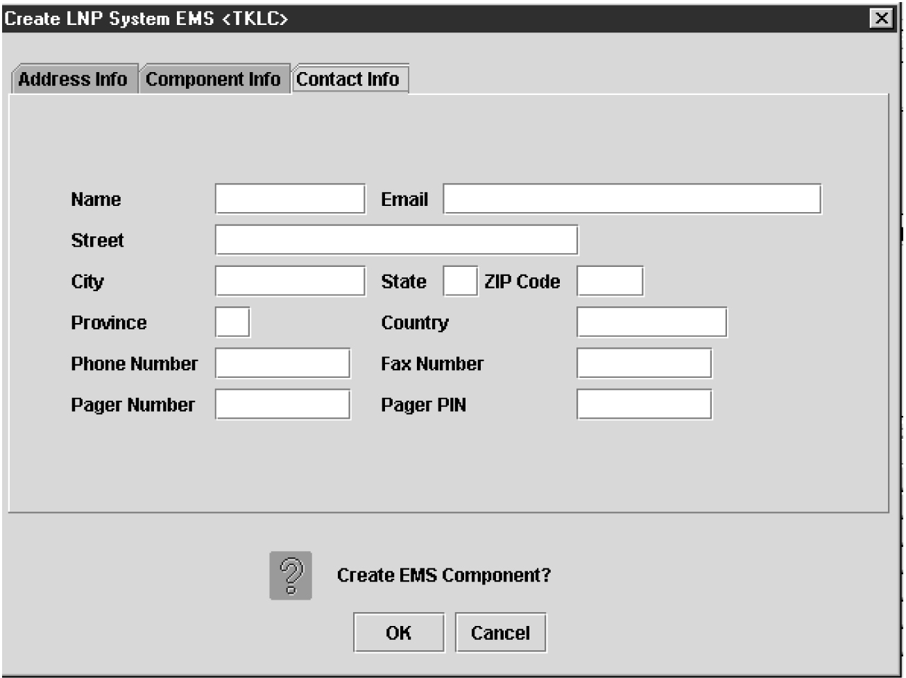

  7. Click the Contact Info tab, shown in Figure 3-18.
    Figure 3-19 Create LNP System EMS Contact Info
    img/c_creating_an_ems_configuration_component_config-fig4.jpg
  8. All fields in this tab are optional. If you wish to enter the Contact Info data, do so as follows:
    • Name – name of the person to contact for network element information (maximum 40 alphanumeric characters)
    • Email – email address of the network element contact person (maximum 60 alphanumeric characters)
    • Street – street address of the network element contact person (maximum 40 alphanumeric characters)
    • City – city address of the network element contact person (maximum 20 alphanumeric characters)
    • State – state address of the network element contact person (two-letter uppercase abbreviation). If you use the Province field, enter -- (the default).
    • ZIP Code – the postal zip code of the network element contact person (five numeric characters)
    • Province – the province of the network element contact person (two-letter uppercase abbreviation). If you use the State field, enter -- (the default).
    • Country – country of the network element contact person (maximum 20 alphanumeric characters).
    • Phone Number – phone number of the network element contact person (ten numeric characters required).
    • FAX Number – FAX number of the network element contact person (ten numeric characters required).
    • Pager Number – pager number of the network element contact person (ten numeric characters required)
    • Pager PIN– pager PIN number of the network element contact person (ten numeric characters maximum)
  9. When finished, click OK to apply the changes.
    • If the Update Successful dialog, Figure 3-20 appears, click OK. The GUI returns to the main console window.
      Figure 3-20 Update Successful Dialog
      img/c_creating_an_ems_configuration_component_config-fig5.jpg

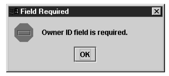

    • When a mandatory field is empty or a field is not properly configured, the Field Required Figure 3-21 dialog displays.
      Figure 3-21 Field Required Dialog
      img/c_creating_an_ems_configuration_component_config-fig6.jpg
      Click OK and correct the appropriate field.
      Repeat this step until you receive an Update Successful notification.
3.5.2 Modifying an EMS Configuration Component
To modify an existing EMS configuration component, use the following procedure.

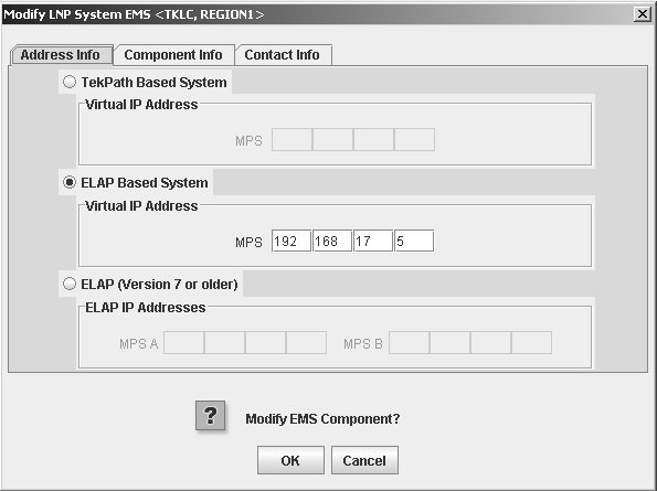

  2. Click the EMS status icon for the EMS you wish to modify so that the icon is highlighted.
  3. From the Main Menu, select Configure, and then LNP System, and then EMS, and then Modify, as shown in Figure 3-22.
    Figure 3-22 LNP System Menu – Modify EMS
    img/t_modifying_an_ems_configuration_component_config-fig1.jpg
    The Modify LNP System EMS window, Figure 3-23, appears.
    Figure 3-23 Modify LNP System EMS Window
    img/c_modifying_an_ems_configuration_component_config-fig2a.jpg
  4. Modify the EMS data as required.
    See Creating an EMS Configuration Component for detailed field information.
  5. Click OK.

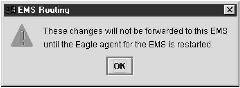

    The EMS Routing dialog appears, Figure 3-24 .
    Figure 3-24 EMS Routing Dialog
    img/t_modifying_an_ems_configuration_component_config-fig3.jpg
    Click OK.
    The Update Successful dialog displays, Figure 3-25.
    Figure 3-25 Update Successful Dialog
    img/t_modifying_an_ems_configuration_component_config-fig4.jpg
You have completed this procedure.

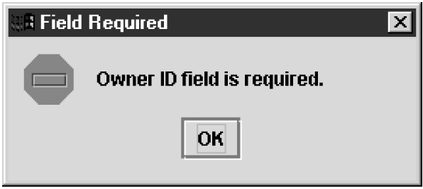

If a mandatory field is empty or a field is not properly configured, the More Fields Needed message is displayed, Figure 3-26.
Figure 3-26 More Fields Needed Dialog
img/t_modifying_an_ems_configuration_component_config-fig5.jpg

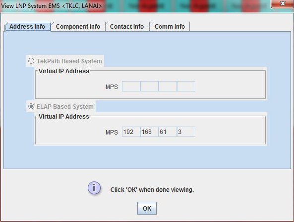

    The View LNP System EMS dialog displays, Figure 3-27.
    Figure 3-27 View LNP System EMS Dialog
    img/figure-47-view-ems.jpg
  4. Click on any of the tabs to view additional information.
    For more information about the meaning of the fields on any of the tabs, see Creating an EMS Configuration Component.
    You cannot modify information in any of the tabs.
  5. When finished viewing, click OK.

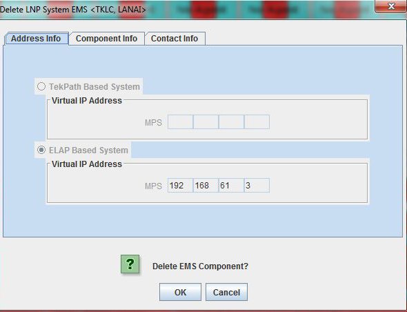

3.5.4 Deleting an EMS Configuration Component
To delete an EMS configuration component, use the following procedure.
  2. Click the EMS Status icon for the EMS you wish to delete (highlight the icon).
  3. From the Main Menu, select Configure, and then LNP System, and then EMS, and then Delete.
    The Delete LNP EMS dialog displays, Figure 3-28.
    Figure 3-28 Delete LNP System EMS Dialog
    img/figure-48-delete-ems.jpg
  4. View the information in this window to verify that this is the EMS you wish to delete.
    Click on any of the tabs to view additional information. For more information about the meaning of the fields on any of the tabs, see Creating an EMS Configuration Component. You cannot modify information in any of the tabs.
  5. Click OK or Cancel.
    • If you click Cancel, you are returned to the LSMS console window.

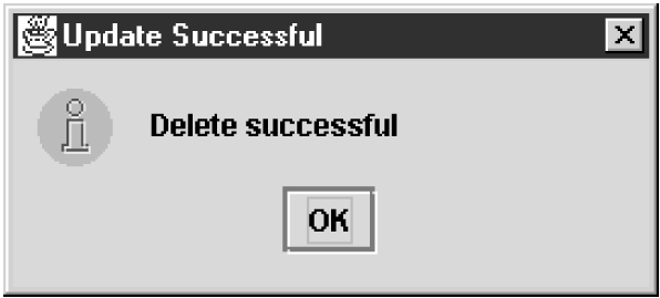

    • If you click OK, the Update Successful dialog displays, Figure 3-29.
    Figure 3-29 Update Successful Dialog
    img/t_deleting_an_ems_configuration_component_config-fig2.jpg
  6. Click OK.

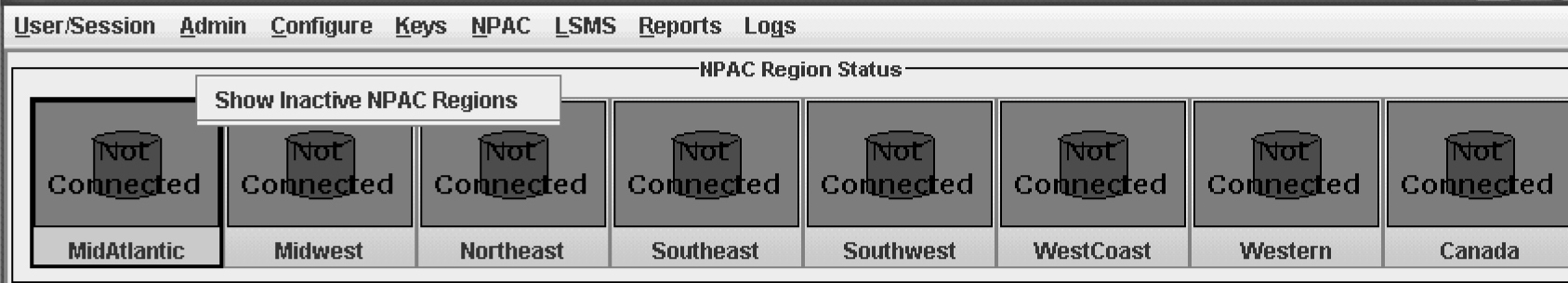

    (Otherwise, skip to step 4.) Right-click anywhere in the NPAC status area; the pop-menu shown in Figure 3-36 displays.
    Figure 3-36 Displaying Inactive Regions
    img/t_modifying_an_npac_component_config_fig1.jpg
  3. Click a region for which you have purchased support.
    The main console window displays.
    Figure 3-37 NPAC Status Icons Displayed
    img/t_modifying_an_npac_component_config_fig2.jpg
  4. Click the icon that represents the NPAC you wish to create or modify so that the icon is highlighted.
  5. From the main menu, select Configure, and then LNP System, and then NPAC , and then Modify, and then Primary or Configure, and then LNP System, and then NPAC , and then Modify, and then Secondary.
    Figure 3-38 LNP System Menu – Modify NPAC
    img/t_modifying_an_npac_component_config_fig3.jpg
    The Modify LNP System NPAC window displays. In this example, the Primary was selected. The window usually opens with the Address Info tab displayed; if the Address Info tab is not displayed, click its tab to display it.
    Figure 3-39 Modify LNP System NPAC Address Info Tab
    img/t_modifying_an_npac_component_config_fig4.jpg
  6. Enter the SMS Name which represents the name by which the NPAC knows this region (maximum of 40 characters)
  7. Click the Activate Region checkbox to make this region active.
    Ensure that you have loaded the keys for this region before performing this step. When the Activate Region checkbox is checked, the sentryd process will automatically launch the NPAC agent for this region and attempt to associate with the NPAC. If the keys have not been loaded, the association will fail.
  8. Enter the Address information as follows (all fields in the Address Info tab, except the TSEL fields, must contain data):
    Changes on this tab will take effect only after you reassociated with the NPAC.
    • Enter the NPAC OSI Address elements with values that you have obtained from the NPAC:
      • PSEL – presentation address (one to four alphanumeric characters)
      • SSEL – session address (one to four alphanumeric characters)
      • TSEL – transport address (zero to four alphanumeric characters)
      • NSAP – network address.
        This value is the IP address of the NPAC. Example: For an IP address of 198.89.35.235, enter 0xc65923eb, as shown below:
        Table 3-3 Decimal to Hexadecimal Conversion
        Decimal
        198
        89
        35
        235
        Hexadecimal
        0x
        c6
        59
        23
        eb
    • The display of the LSMS OSI Address elements is for your information (user input is not accepted for these elements):
      • TSEL – this field must be blank
      • NSAP – network address. Enter rk6
    • Enter the NPAC FTP address as follows:
      • FTP Address – the FTP address (IP address) of this NPAC component (enter a value from 0 to 255 in each of the first three octets and a value from 0 to 254 in the fourth octet)

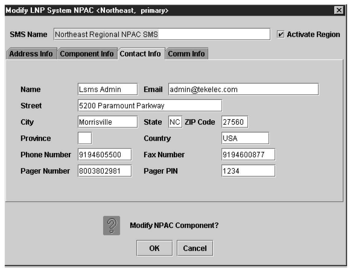

  11. Click the Contact Info tab.
    Figure 3-41 Modify LNP System NPAC Contact Info
    img/t_modifying_an_npac_component_config_fig6.jpg
  12. All fields in the Contact Info tab are optional.
    If you wish to enter NPAC Contact Info data, do so as follows:
    • Name – name of the person to contact for NPAC information (maximum 40 alphanumeric characters)
    • Email – email address of the NPAC contact person (maximum 60 alphanumeric characters)
    • Street – street address of the NPAC contact person (maximum 40 alphanumeric characters)
    • City – city address of the NPAC contact person (maximum 20 alphanumeric characters)
    • State – state address of the NPAC contact person (two-letter uppercase abbreviation).
      If you use the Province field, enter -- into this mandatory field.
    • ZIP Code – postal zip code of the NPAC contact person (five numeric characters)
    • Province – province of the NPAC contact person (two-letter uppercase abbreviation).
      If you use the State field, enter -- (the default) into this mandatory field.
    • Country – country of the NPAC contact person (maximum 20 alphanumeric characters)
    • Phone Number – phone number of the NPAC contact person (ten numeric characters required)
    • FAX Number – FAX phone number of the NPAC contact person (ten numeric characters required)
    • Pager Number – pager number of the NPAC contact person (ten numeric characters required)
    • Pager PIN – pager PIN number of the NPAC contact person (ten numeric characters maximum)

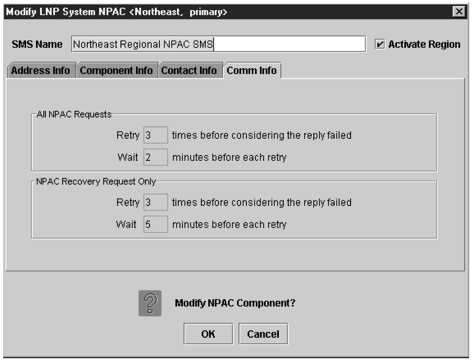

  13. The Comm Info tab is for display purposes only to provide the following information.
    You cannot modify these fields.
    Figure 3-42 Modify LNP System NPAC Communication Info
    img/t_modifying_an_npac_component_config_fig7.jpg
    • All NPAC Requests
      • Retry—How many times the LSMS will retry a request that the NPAC fails to respond to
      • Retry—How long the LSMS will wait for the NPAC respond to a request
    • NPAC Recovery Request Only
      • Retry—How many times the LSMS will retry a recovery request that the NPAC fails to respond to
      • Retry—How long the LSMS will wait for the NPAC respond to a recovery request
  14. When you are finished, click OK to apply the changes and return to the LSMS Console window.
  15. When finished, click OK to apply the changes.
      Figure 3-43 Modify Successful
      img/t_modifying_an_npac_component_config_fig8.jpg
      Figure 3-44 More Fields Needed
      img/t_modifying_an_npac_component_config_fig9.jpg
      Click OK in the message window and correct the appropriate field. Repeat this step until the message in Figure 3-43 displays.

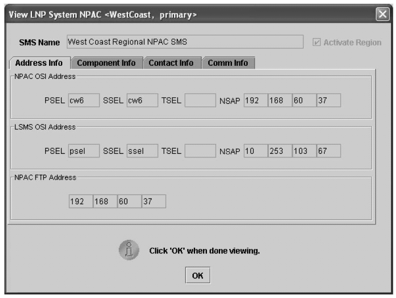

3.7.3 Viewing a Configured NPAC Component
To view configured NPAC component information, use the following procedure.
  1. Log in as a user in the lsmsadm, lsmsuser, lsmsuext, lsmsview, or lsmsall group.
  2. Click the icon that represents the NPAC you wish to view so that the icon is highlighted.
  3. From the main menu, select Configure, and then LNP System, and then NPAC , and then View, and then Primary or Configure, and then LNP System, and then NPAC , and then View, and then Secondary.
    Figure 3-45 LNP System Menu – View NPAC
    img/t_viewing_a_configured_npac_component_config-fig1.jpg
    The View LNP System NPAC window displays. In this example, the Primary was selected. The window usually opens with the Address Info tab displayed.
    Figure 3-46 View LNP System NPAC Window
    img/t_viewing_a_configured_npac_component_config-fig2.jpg
  4. To view a different tab, click on the tab.
    For information about the fields displayed in any of the tabs, see their description in the procedure defined in “Modifying an NPAC Component”.
  5. When finished viewing this window, click OK to return to the main LSMS console window.

  3. Deactivate the region from the LSMS GUI:
    Modify the NPAC configuration:
    Figure 3-47 LSMS Console
    LSMS Console
    Uncheck Activate region and press OK
    Figure 3-48 Modify LNP System NPAC
    The NPAC region status will get changed to Inactive.
    Figure 3-49 NPAC Region Status
    NPAC Region Status

3.8 Modifying Default TT/SSN Values
If desired, use the following procedure to modify the default Translation Type (TT) and SS7 Subsystem Number (SSN) values for a given GTT group. Using default settings can simplify the amount of data entry required when creating Default GTTs and Override GTTs (for information about managing Default GTTs and Override GTTs, refer to the Database Administrator's Guide).
  1. Log in as a user in the lsmsadm, lsmsall, or lsmsuext group (if you are logging in as a user in the lsmsuext group, you are authorized to modify only Default TT/SSN values for GTT groups that are assigned to the SPID you used when you logged in).
  2. From the main menu, select Configure, and then Default TT/SSN.
    Figure 3-50 Modify Default TT/SSN Values
    img/t_modifying_default_tt_ssn_values_config_fig1.jpg
    The Default TT/SSN Values window displays.

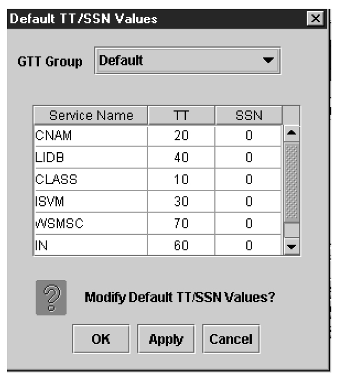

  3. If the GTT Group whose default values you wish to modify is not displayed in the GTT Group field, click the down arrow at the right of the field and select the desired GTT Group.
  4. To change any TT or SSN value, click in the desired table cell; the cell is highlighted while the rest of the row displays in a darker shade, as shown in the example in Figure 3-52.
    Figure 3-52 Changing Default TT/SSN Values
    img/t_modifying_default_tt_ssn_values_config_fig3.jpg
    The TT and SSN values must be as follow:
    • TT —Range 1–255
    • SSN —Range 0–255, excluding 1 (0 indicates no SSN translation)
  5. Repeat 4 for any other TT or SSN values that you wish to change.
  6. When you are finished, click Apply to apply the changes and stay in this window, or click OK to apply the changes and return to the LSMS Console window.
    Figure 3-54 More Fields Needed
    img/t_modifying_default_tt_ssn_values_config_fig5.jpg
    Click OK in the message window and correct the appropriate field. Repeat this step until the message in Figure 3-53 displays.

3.9.1.1 Creating an NPAC Association Using GUI
To create an NPAC association with the LSMS using the GUI, perform the following procedure:
  1. Log in to LSMS as a member of the permission group that is authorized to perform this operation.
  2. Click the icon that represents the NPAC that you wish to associate with; then right-click and select Associate.
    Figure 3-55 Associate with NPAC
    img/t_creating_an_npac_association_using_gui_config_fig1.jpg
    When the LSMS has finished associating with the NPAC, the NPAC status icon displays the text “Associated.”
