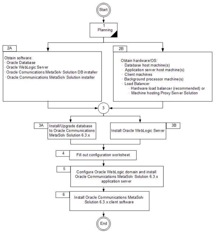

This section provides an overview of the installation process. The chapters that follow provide full information on each step. Figure 1-1 shows the high-level installation process.
Figure 1-1 Overview of the MSS Installation Process
Description of "Figure 1-1 Overview of the MSS Installation Process"

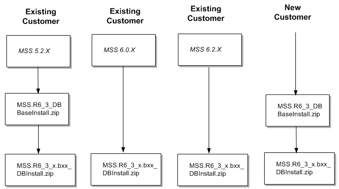

The upgrade path for the MSS database differs from the path for the application server. This section explains the upgrade path for each component.
Database Upgrade Path
Figure 1-2 shows the upgrade path for the MSS database if you are on a pre-6.3.x version.

Basic Installation Steps
Each of the steps shown here for installing MSS contains additional tasks and information that you must know to proceed with the installation. The chapters in this book discuss each basic step.
Plan the installation by completing the following tasks:
Plan for the hardware and software you will need to implement MSS.
See MetaSolv Solution Planning Guide for information on minimum technical requirements.
Complete the pre-installation checklist in this chapter.
The checklist contains planning tasks that should be done before you begin the installation process.
Obtain the appropriate hardware and software.
Prepare the database and application server environments by completing the following tasks:
Install Oracle Database. See "Software Requirements" for information on required software versions.
Install the MSS 6.3.x database.
To complete this step, you must run the appropriate MSS database scripts. If you do not currently have the recommended release of the database installed, see "Setting Up The MSS Database" for information on getting your database to the current release level so that you can apply the current maintenance release.
Install third-party software on machines that will host the application server.
To complete this step, you must:
Install Oracle WebLogic Platform on each machine hosting MSS. You can install your system in different configurations, but each machine must have Oracle WebLogic software installed. See "Software Requirements" for information on required software versions.
Complete the worksheets that define properties for the installation machines.
Worksheets are included for each installation configuration type that MSS provides. The worksheets let you identify, in advance, information that is needed during the installation.
Install and deploy MSS on the Oracle WebLogic application servers by completing the following tasks:
Create the Oracle WebLogic domain and define the administration server and its clustered servers, or the single server.
When you create the domain and define the server(s) that belong to the domain, the Oracle WebLogic software creates the necessary files on the servers you indicate.
Install and deploy MSS.
Run the installer to copy MSS files to every machine that will host Oracle WebLogic application server(s).
In the situation where the administration server is on a separate machine, it is not necessary to load MSS on that machine.
Deploy MSS from the single server or administration server to the managed servers.
Install on the client workstation.
You must perform an initial client installation to perform post-installation tasks that require the use of the client.
Install the client on a workstation.
See "Installing The Client Workstation" for more information.
Install utilities or any other MSS components.
Complete the post-installation tasks.
Tasks include:
Loading graphics to the database from a utility program.
Running a client utility to determine the health of the database.
Customizing the application with your company logo (optional).
Setting up user authentication.
