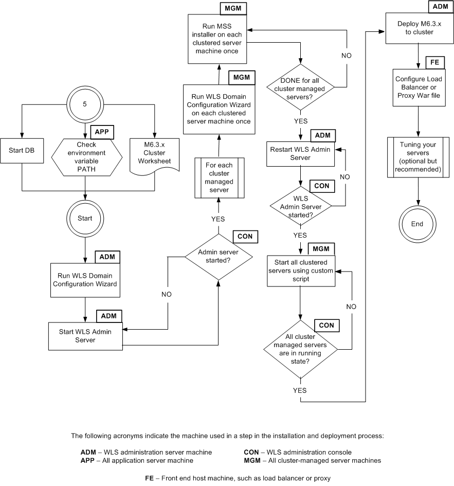

Figure 5-1 shows the detailed process for a clustered server installation.
Figure 5-1 Installing a Cluster-Managed Server
Description of "Figure 5-1 Installing a Cluster-Managed Server"
Figure 5-2 shows an example configuration. This installation includes two clustered managed servers (mslv01 and mslv02), an administration server, and a hardware load balancer or Proxy server used for load balancing. To see complete information on the data for the installation, refer to the worksheet examples.
Figure 5-2 Example Cluster-Managed Server Configuration
Description of "Figure 5-2 Example Cluster-Managed Server Configuration"

Installing and Deploying MSS
You must run the installer and install MSS on each machine that will host a clustered server.

To install and deploy MSS, do the following:
From MSLV_Home, enter the following command:
java -jar MSS.RreleaseNumber.bbuild_AppServerInstaller.jar
where releaseNumber is the MSS software release version and build is the build number. For example:
java -jar MSS.R6_3_1.b74_AppServerInstaller.jarThe Select MetaSolv home directory window appears.
From the Look In list, select a directory in which to store the installer files then click Select.
A directory named installer is automatically created in the selected directory. Oracle recommends choosing your MSLV_Home directory for this task.

The Oracle Communications MetaSolv Solution Installation window appears.
Click Next.
The Oracle Communications MetaSolv Solution Installation - Choose Install Type window appears.
Select Full Installation on WebLogic Server with JAX-WS Domain and click Next.
The Oracle Communications MetaSolv Solution Installation - Full Select Server window appears.
Do the following:

The Oracle Communications MetaSolv Solution Installation window appears with the domain and any servers in the domain appearing in the left pane.
In the tree view on the left, select the check box next to the server you want MSS installed on.
Tabs appear in the right pane for information to be entered for the selected cluster.

When all tabs have correct information for the single server, click Next.
The Installation Summary window appears.
After checking the information in the summary for accuracy, click Install.
The installer installs the appropriate MSS files to the server. When the files are installed, the location of the startup file created for the server is displayed.
Do not exit the installer.
Note the location of the startup file for the application server.
If the installation type is SSL then perform step 12 for each managed server.
