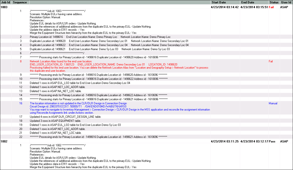

View Log Results Section
The View Log Results section displays the log information that you search for.
Figure 6-2 shows the View Log Results section.
Figure 6-2 View Log Results Section
Description of Figure 6-2 follows
Description of "Figure 6-2 View Log Results Section"

The View Log Results section displays the following information for each job in the order listed:
  • The job ID.
  • The specific option you select for every job under the I want to find area on the Criteria tab.
  • The resolution option that you select in the Resolution Options area on the Results tab.
  • All the preferences that you set on the Preferences tab.
  • All the primary end user locations/addresses.
  • All the duplicate end user locations/addresses.
  • Lists the modified tables for each duplicate end user location/address that is processed.

Searching for Log Information
To search for log information:
  1. Do one of the following:
    • On the secondary toolbar, click the View Log button.
    • From the Options menu, select View Log.
      The View Log Search section is displayed.
  2. In the Job Id field, enter the unique identifier for the job.
  3. In the Log Details field, enter any keyword pertaining to the log information that you want to search.
  4. In the From Date field, enter the date from which you want to search the log information.
  5. In the Through Date field, enter the date until which you want to search the log information.
  6. From the Status list, select any one of the following job status:
    • Pass
    • Fail
    • Manual
  7. Click Search.
    The log information is displayed in the View Log Results section.
